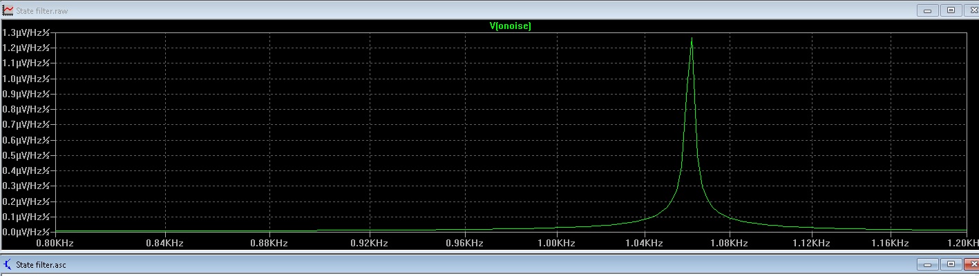

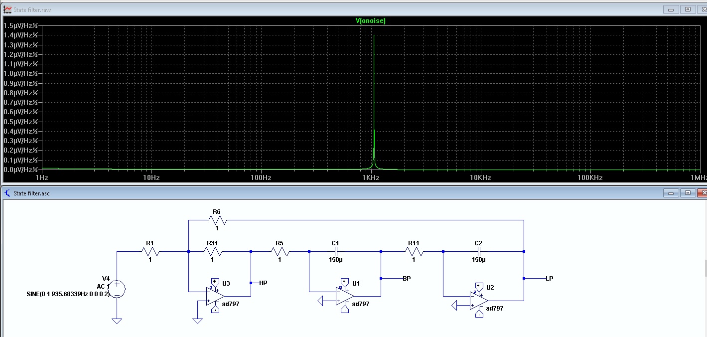

One thing I love about spice is no smoke.
Here it is normalized but scaled for frequency.
Not really practical though.
Can't find an option in LTspice for noise on a dB scale.

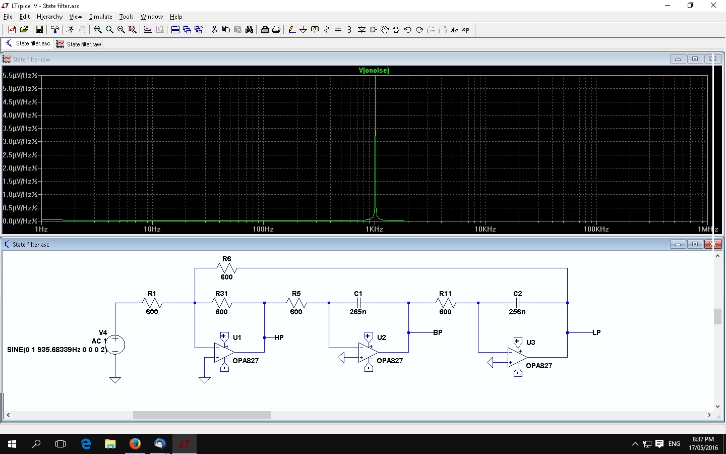

Dave you can build an SVF with your chosen values and test that before going the full length.
Keep in mind that the amplifier is loaded by a capacitor. The distortion tests Samuel and the manufacture did where with resistor loads. A fast op amp like the AD797 might have trouble at such low Z. Even rf oscillations so small that there hard to see on a scope will cause a rise in distortion. Sometimes it's just settling issues.

Yes, this is possible so I checked Samuel's op-amp test data (p.24) and the AD797 drives 600 ohms with practically no increase in distortion. That has been the basis of my decision to keep the impedance at around 600.
There is a small loss of gain from the load, need to analyse the trade-off for this.

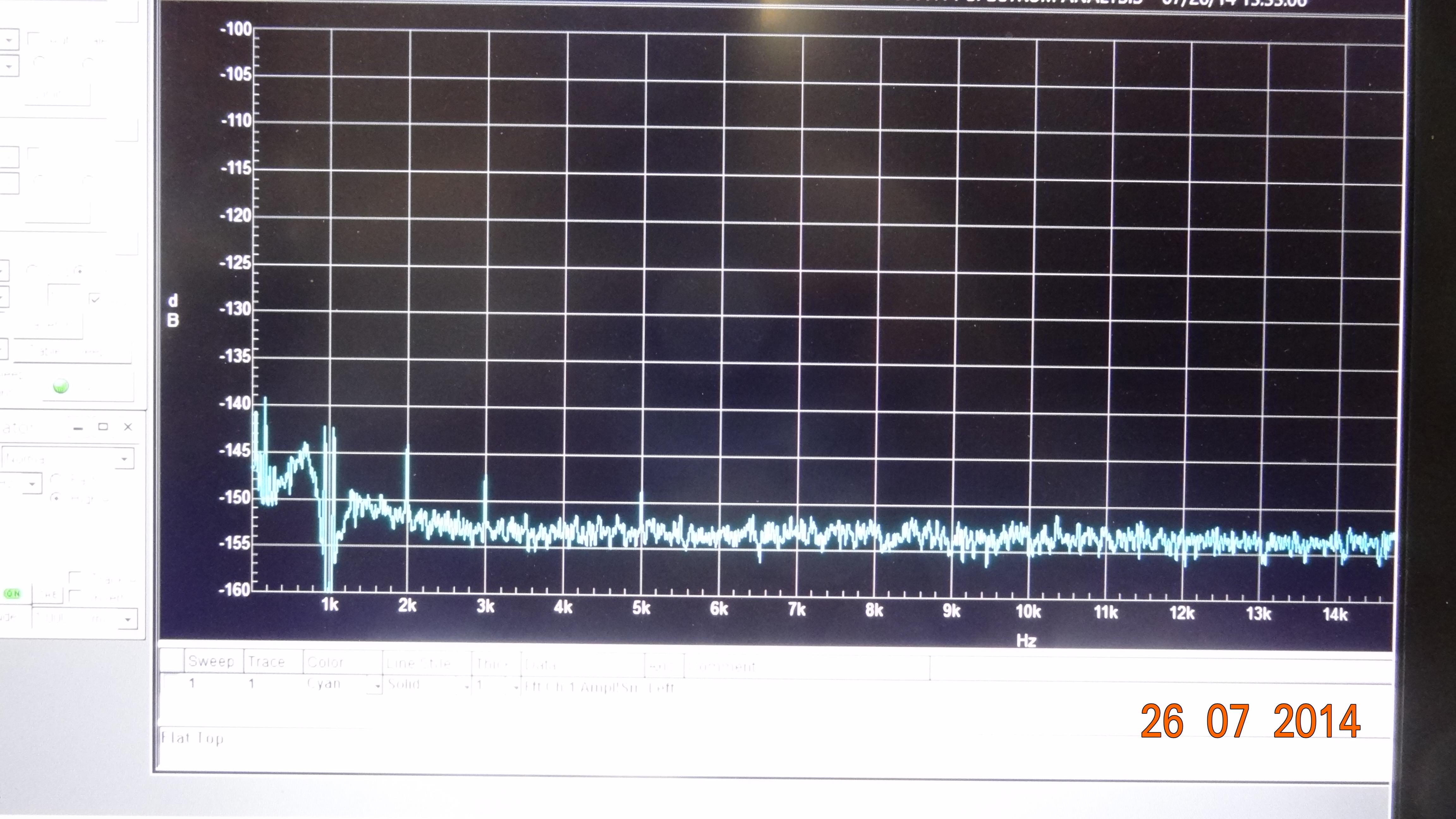

Just a reminder of what I can do here --- this is davids generator, two years ago, using the Faraday shield and battery power also under the shield:
And, I still see differences in pcb material/dielectric.... now with pcb in shield also.
THx-RNMarsh
Interesting, how did you attenuate/filter the 1k fundamental (I suppose at least 1V) to -140dB while not affecting the harmonics? 50-60-70-80dB attenuation is usual, the rest to the noise floor is the analyzer dynamic range.
Anything else is irrelevant. With synchronous (or time, if you prefer) averaging, if enough time is allowed, one could bring the noise floor to the background noise of the universe.
From where I sit, you don't have to wipe the egg off your face with the PCB dielectric measurements.
Edit: -170dB noise floor with a 16bit HP boat anchor that you could get today for about the same price as an average sound card: http://www.diyaudio.com/forums/soli...tware-thd-sine-generating-13.html#post4170130
yes, the notch is very deep. You can check out that info talked a lot around here regarding the ShibaSoku 725 for your answer.
or check with Audio Precision.
THx-RNMarsh
Original sample of pcb looks like a brown material (phenolic?) vs an FR4. The phenolic changes C by -11% from 100Hz to 100KHz. While the FR4 changes -3%. The Df is X10 lower from 100-100KHz with FR4.
