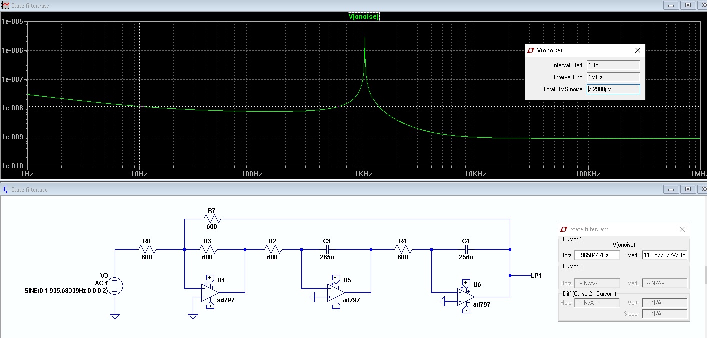

I tried ploting 20*log(V(onoise)) but the result doesn't make sense.
Simply switch the Y axis to logarithmic, and use an appropriate range (e.g. 1 nV/rtHz to 100 nV/rtHz).
Noise very close to the fundamental is not of much interest, as it is supressed by the leveling loop and the notch filter of the analyzer.

I would hope that the noise models for these opamps are solid, but know that distortion modeling is not. Does anyone have any sort of validation wrt this? (Noise model vs measurements)
At least davada's sims seem to match the datasheets more closely.
Only if the spice model explicitly says about modelling the noise performance (they usually do, for devices with guaranteed noise performance). Otherwise, 99% percent of the commonly available opamp models are stupid macromodels, good for AC analysis only. I've seen such macromodels that were unable to correctly simulate a DC servo!
If I recall correctly, a notable exception is the LME49710/LM4562 model, which is component level.
Ad797, OPA827 on a log scale.
Not sure about LTSpice, but in my simulator it is NTOT(ONOISE) where ONOISE is the output node as defined in the .NOISE macro.
In LTspice it's V(onoise).
