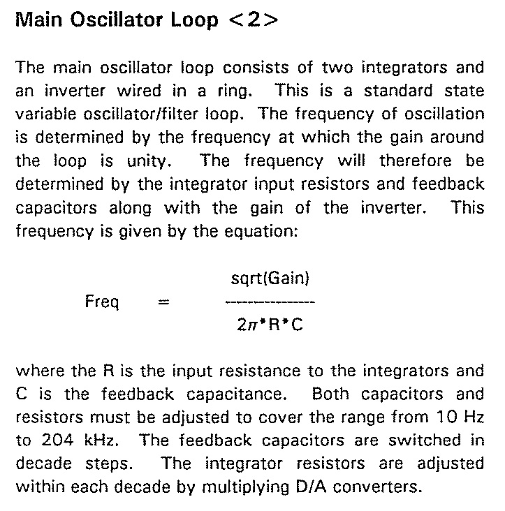

Dave what are calling a gain of minus two in the 505. Are you referring to the ratio of R1517 and R1512?
If these resistances are equal then fc = 1/2PIRC.
If not equal then fc = sqrt(gain) / 2PIRC
The 505 also has the frequency vernier and there is additional feedback through R1609, R1519, R1516. And other funky stuff.
Dave here is a snippet from the SYS1 manual.
The gain at the inverting stage is just a frequency set. No other reason.

Dave...to the ratio of R1517 and R1512?
R1517 and R1612 I think - it's a poor typeface.
As you say, there's a bit of other stuff but it's about a factor of 2.
This does determine the frequency but also makes the V at the integrators unequal, not quite optimal for THD + N.
The Sys 1 has R2502 and R3504. also a bit of other stuff for frequency trim but close to 1.

I went with the unity gain. The Mdacs are precision devices. The caps are matched so the output levels are very close to same.
