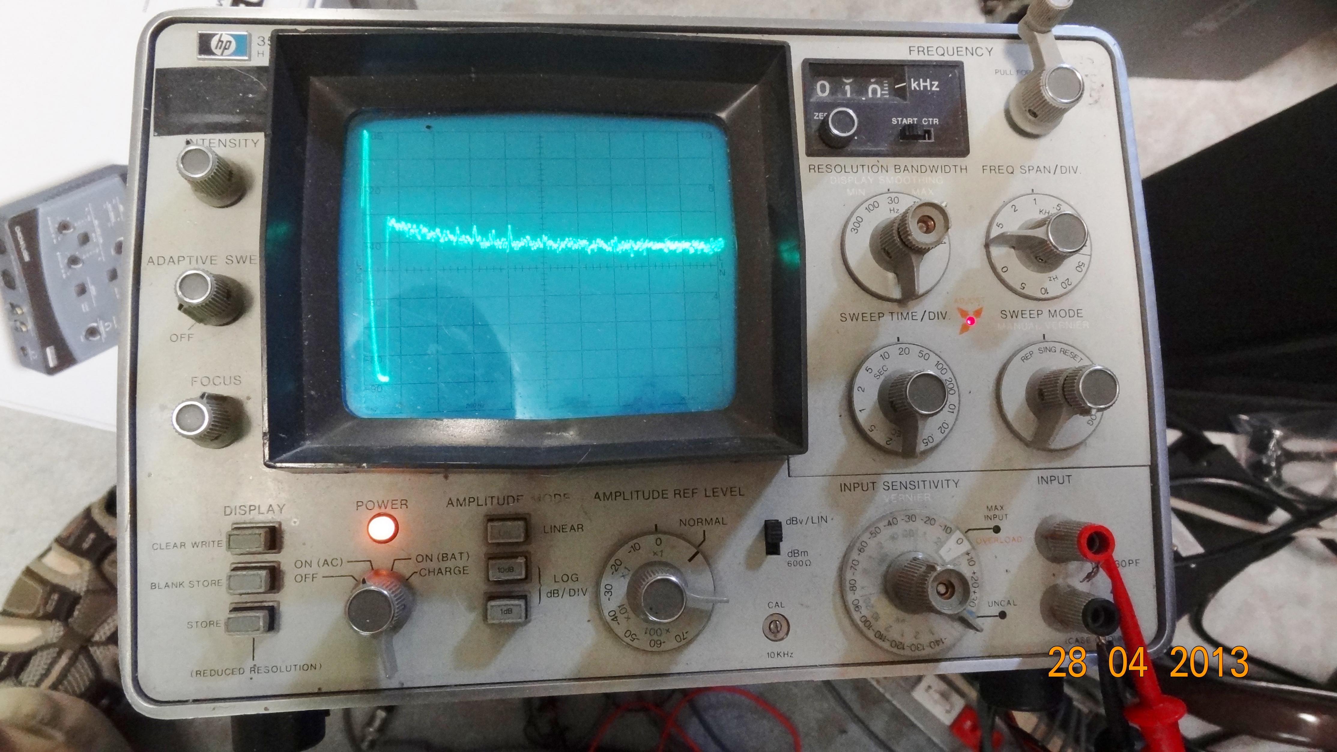

The plot indicated that the fundamental has been nulled to -150 dB. That is exceptional under the best of conditions. Victor has mentioned the use of a marker to verify the distortion amplitudes. I think it makes sense when these are such low levels.
Thats about right, i think. davada's did as well, i believe.

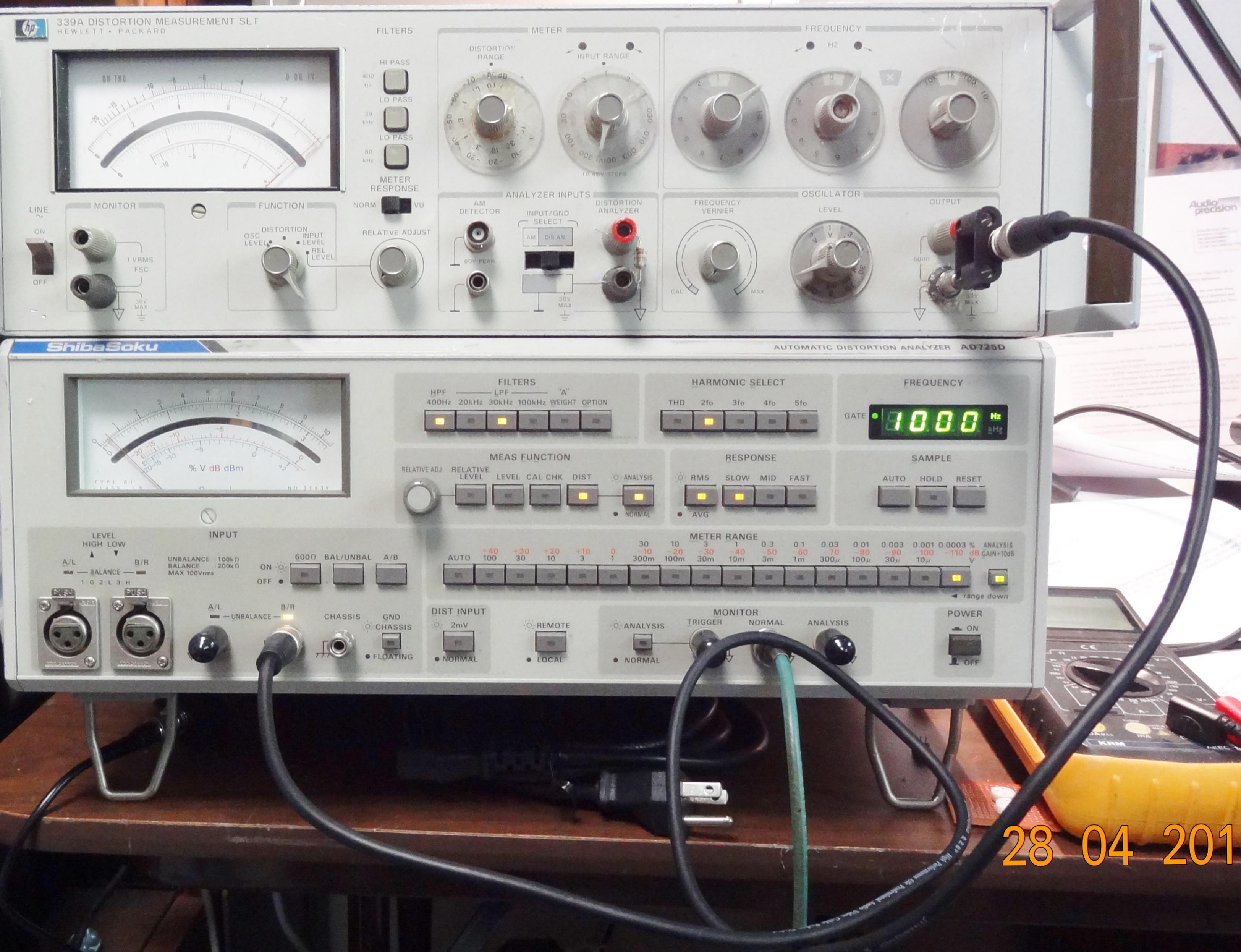

I took the modified HP 339A back over to the ShibaSoku 725 analyzer and remeasured it and it agrees within +/- 3dB for 2h and 3H. Then i retuned the 339A for just one freq (1KHz) and was able to null the harmonics below the residual of the 725 and cant see any harmonics any more -- into the noise of the 725 floor/system.... even gone when looking at the monitor output with the HP spectrum analyzer. But typically it is then much worse at 10KHz. So, I had left it at a compromise tune... all harmonics from 100-10KHz are below .0001% thd.

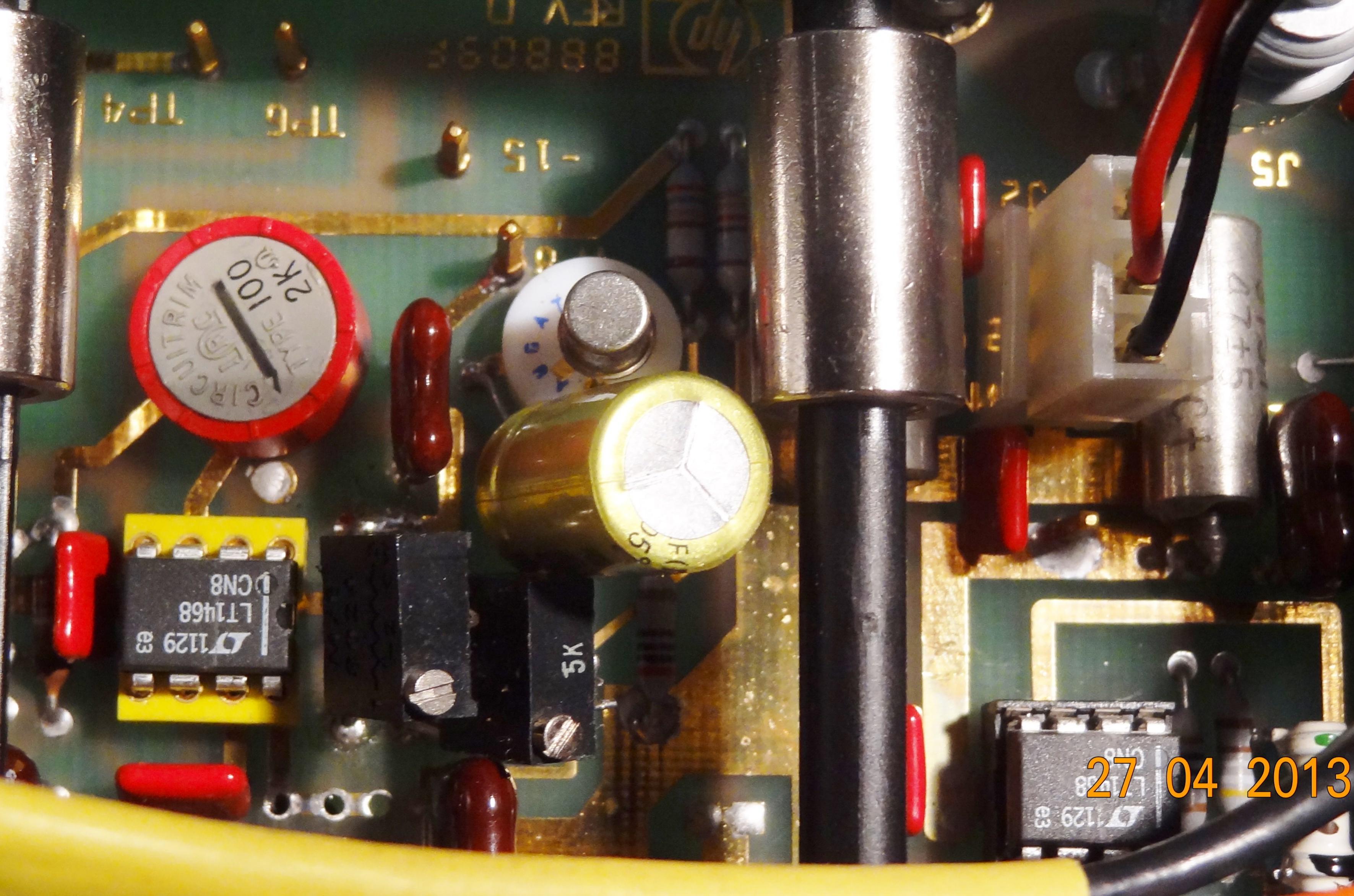

Of course I have replaced just about every IC and part in the signal path and also in the analyzer and placed trimmers where there were fixed R's. Etc.

Rick I could never get the null much below -125dB. maybe -130dB for brief amount of time but then it would climb back up to -120dB or so and settle there. I've never measured the 339a distortions that low. If one harmonic dropped it was at the expense of the other increasing between 2nd and 3rd. I could get either down lower than -130dB and that's about what others measure as well.
THD of -125-130dB is par for the upgrades. And that is very, very good. That is the THD I get typically. I trim three R's.... The series R to the jFET gate, the shunt R from gate to drain and the agc. The individual harmonics from the 725 show lower levels than THD, of course. But the caps and other parts have to be selected also for lowest distortion and cleaned contacts etc. etc. etc. I'm using LT1468 in most places.

What did you do on the analyzer side to get the null that low and the harmonics that low?
In general, replaced all caps with film and 105C NP types and all opamps with various makes and models that worked best in each location/function and 20-turn trimmers in place of single turn etc etc.
Dick Moore has done this before we did with similar results in THD from a 339A. www.moorepage.net
But -150dB does seem like a lot.
-RNM
40 dB is a lot of improvement. Setting the null would be very very touchy at -150 dB.
You are assuming. Didnt know what the number actually was... just that it was more than -110dB. yes, it was a bit touchy but with a fine trim with 28 turns it isnt so touchy as you think. With the stock single turn it is Very touchy and unstable.
I just plugged the qa400 into the distortion monitor port and that is what it said. i can double check someday later. Even if somehow the system was off by 10 or 20dB (!), it would still be a very deep null number. But then the distortion numbers would be that far off as well. The null is VERY deep on mine.
[ for modders -- the opamp for the Notch Amp U3 is a OPA1641]

I was reading back from the QA400. if 0 dB on the scale was -80dB and the center of the null is -70dB on the display, that's -150dB. My 725 only gets to about -130 dB on the monitor output at best. I have never got much past -120 dB with any of my other analyzers and then any variations in anything knock it all askew again.
My understanding with the 725 is that it used 3 notch filters and reached -160dB.
