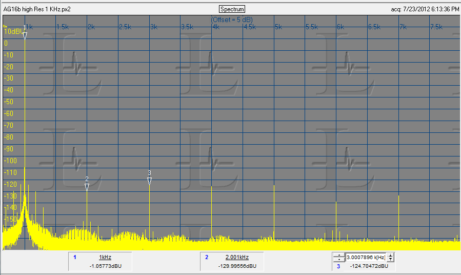

Richard:
I have a demo board for the AK5394A and have wrested some pretty exceptional results. To be clear I don't think anyone has implemented the summing trick on the ADC's in commercial products. The AK5394A and AK5388 can both be used as can others. The effective equivalent is the "melt noise" synchronous averaging in the QA400. The EMU 1212 is pretty expensive and would still need revisions to get the most from.
I can lend the AK5394A board and the TI 4222 equivalent if you want. I can also provide direction on getting results. You will need something with an SPDIF in to use them and software etc. Attached is the best I have managed from it (actually it is a little better at lower levels but you bang into the noise floor pretty quickly).

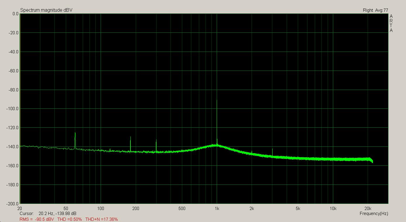

Oh by the way the SVO now extends out to 110kHz,
Here is the 1kHz now. ARTA says this is 0.000015% THD if that's possible or even believable. This is at maximum resolution 44.1ksps @ 131072 points.
More work to be done though.
