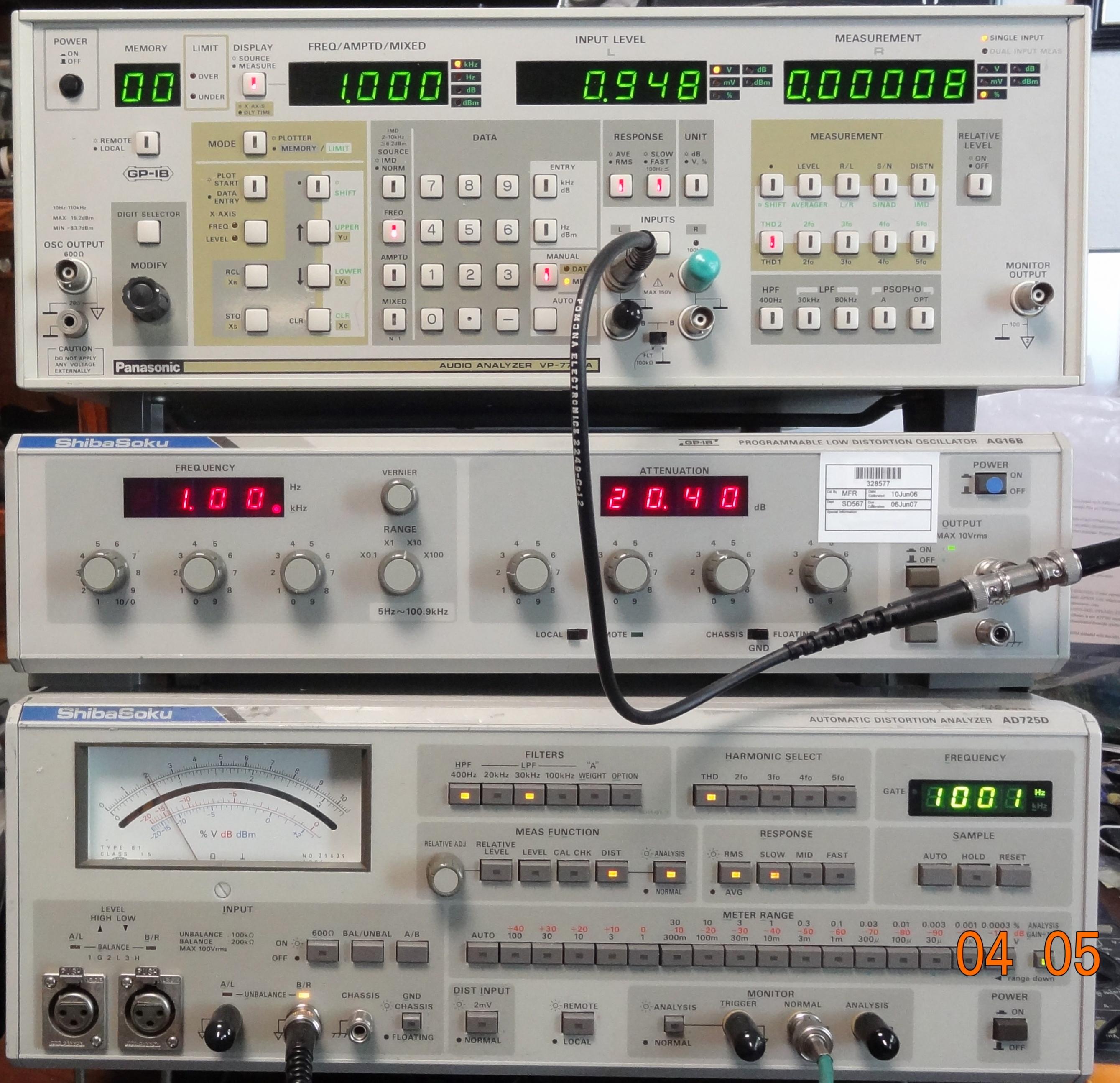

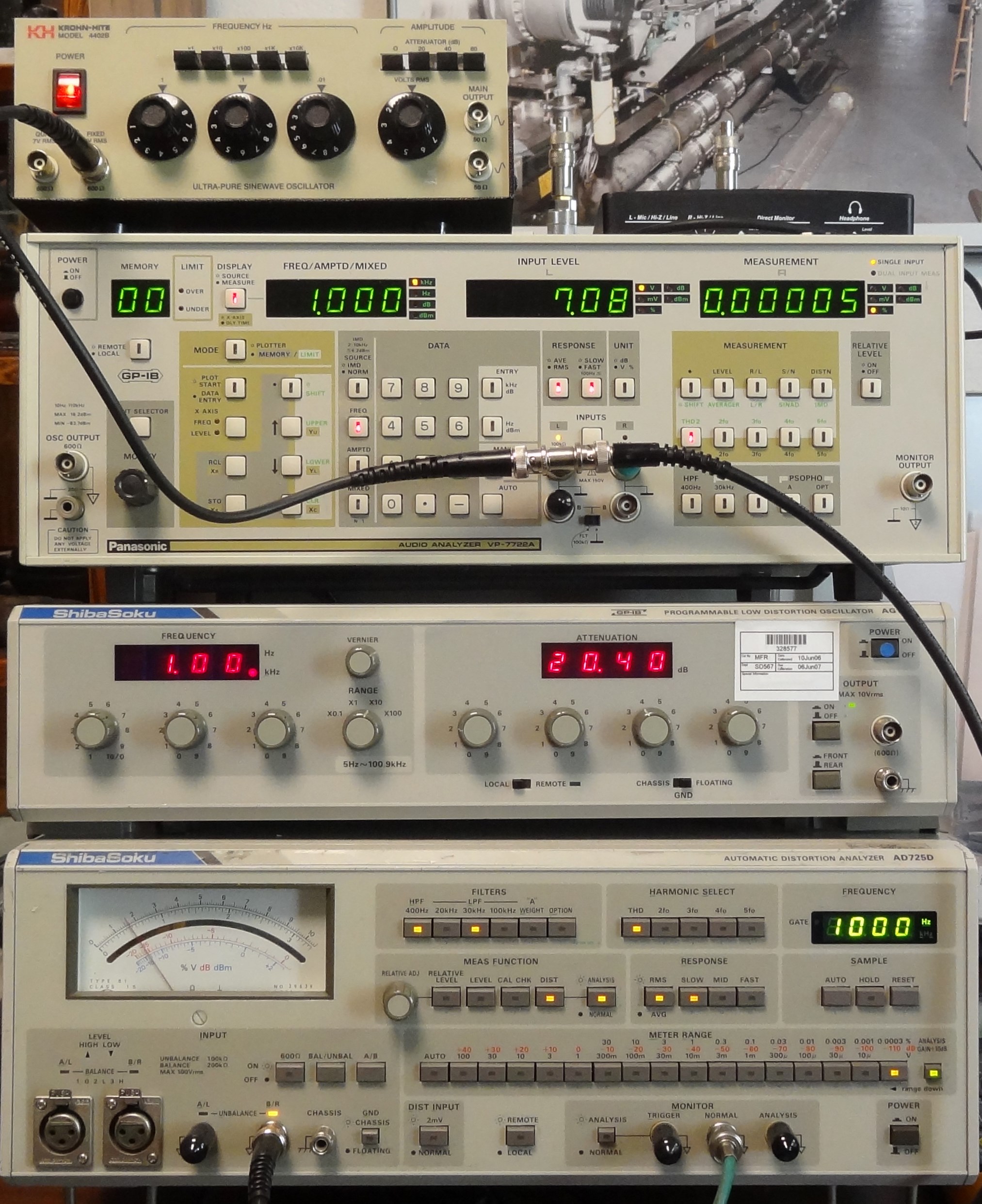

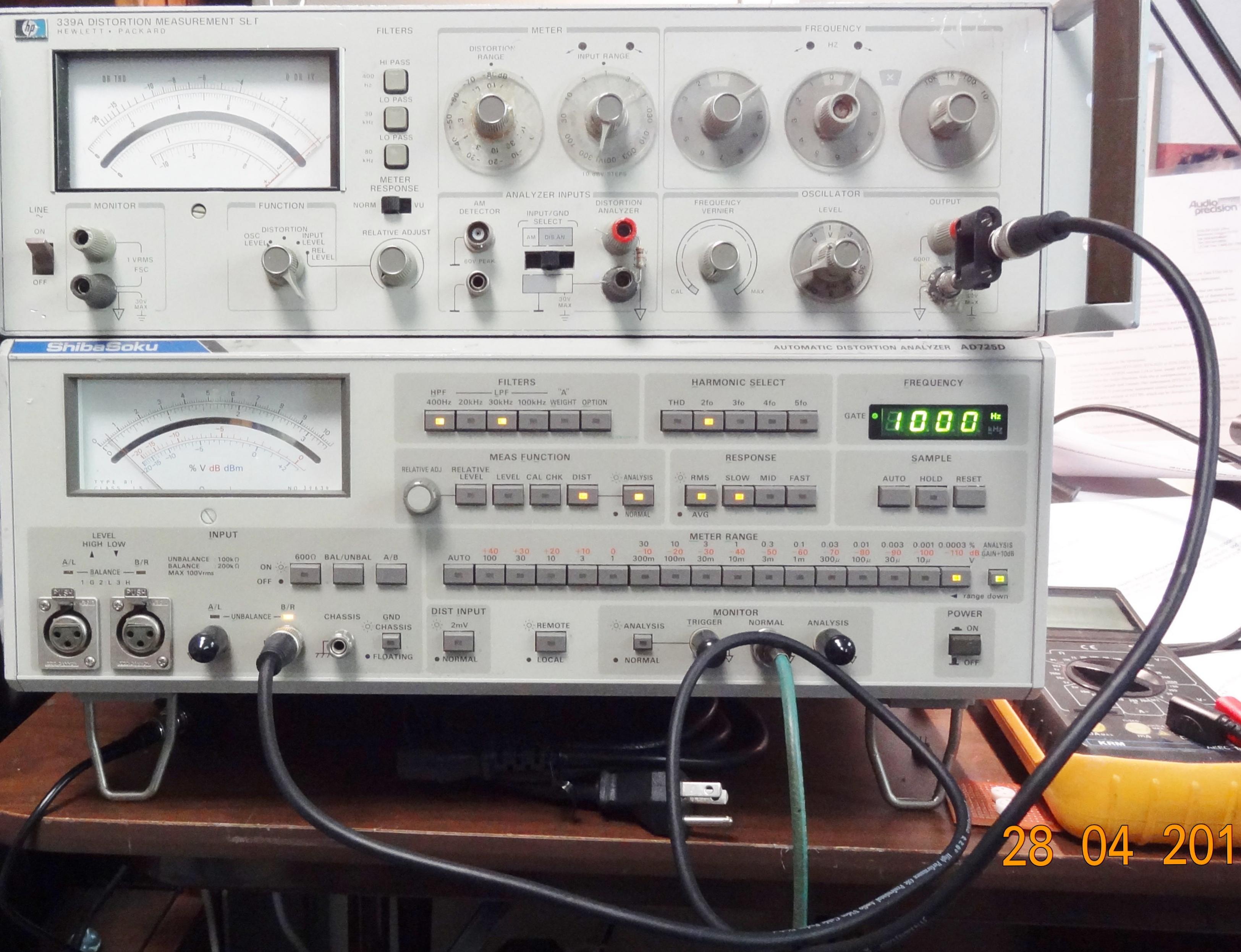

Here is what can be done just by modifying existing oscillators -- advantage -- multiple freqs, and other functions (measured via analog/dsp analyzers):
4402B thd.JPG KH 4402B
339A.jpg HP-339A tuned into the dirt
AG16B.jpg ShibaSoku AG16B
Thx-RNMarsh

I'm not clear about your scale here 0 dBFS is equal to 200 mVrms. Do you mean if you input 200mV into the sound card AudioT reads 0dB?

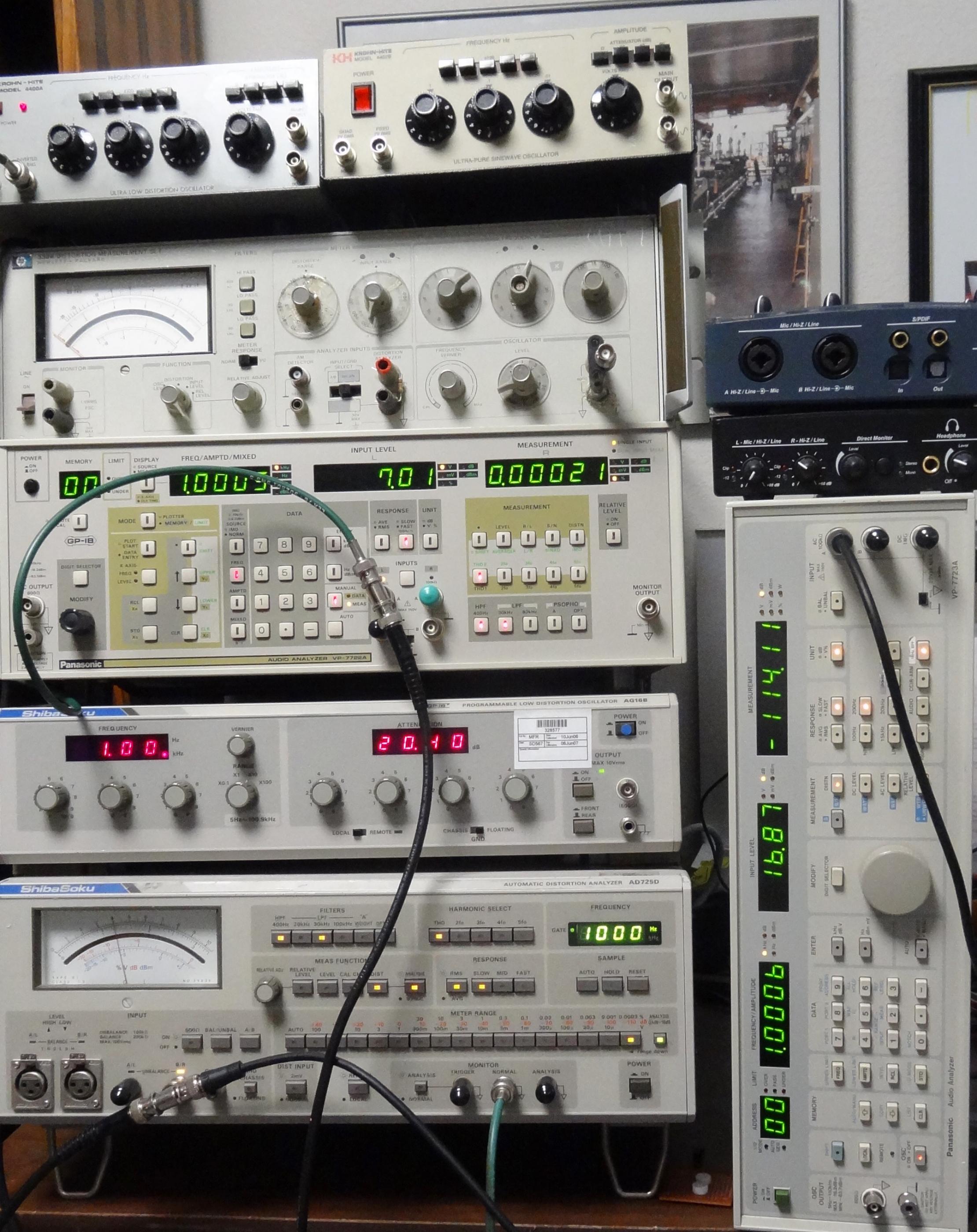

Having a number of analyzers and generators at hand now, there are different results depending on the residuals from notching the fundemantal, fundamental rejection Q and noise etc. Then, there are the filters with different slopes and different freqs some times.
The analyzer on its side (Panasonic -National- VP-7723A) has different filters than the others.... 100Hz, 200Hz (no 400Hz) and 15KHz, 20KHz, 22KHz and 30KHz, for example. The 15KHz would be used when measuring and tuning FM tuners/multiplex circuits to reject the 19KHz pilot from the THD reading results..
So, when comparing the THD/N or S/Noise numbers, sometimes there are differences in readings which can be quit a few dB apart.
KH4400A.jpg Source: KH4400A
Thx-RNMarsh

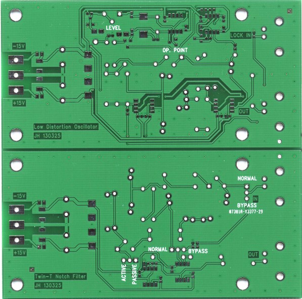

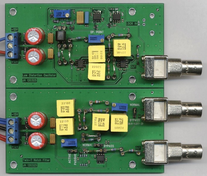

I have built an A/D converter board based on the CS5381. The whole board is running off a regulated 5V supply.
One of the channels has a full scale range of 2Vrms, using an LME49721 for the input buffer.
The other channel has a full scale range of 200mVrms, using an OPA1612 for the input buffer/(10x)gain stage. So yes, 200mVrms into the "sound card" (ADC board) gives a 0dB result on the PC.
I used to 200mV input in this case, since it has the lowest noise level and had sufficient headroom to handle the residual output of the notch filter.
@RNMarsh
I do have a few spare PCB's at hand. If you are interested, just let me know.
Here are a couple of pictures of the PCB. The mounted PCB looks a bit untidy, mainly due to the sockets used for the passive leaded components.
The "missing" SMT component at the bottom is the extra op-amp needed to turn the notch filter into an active filter.
The "missing" BNC connector at the top is for an injection-lock option, which I have not tested yet.

JensH;3479069 @RNMarsh I do have a few spare PCB's at hand. If you are interested said:
yes, I would like to try it and compare it to other measurement systems.
Would like more info on how you intend to use the injection-lock option.
