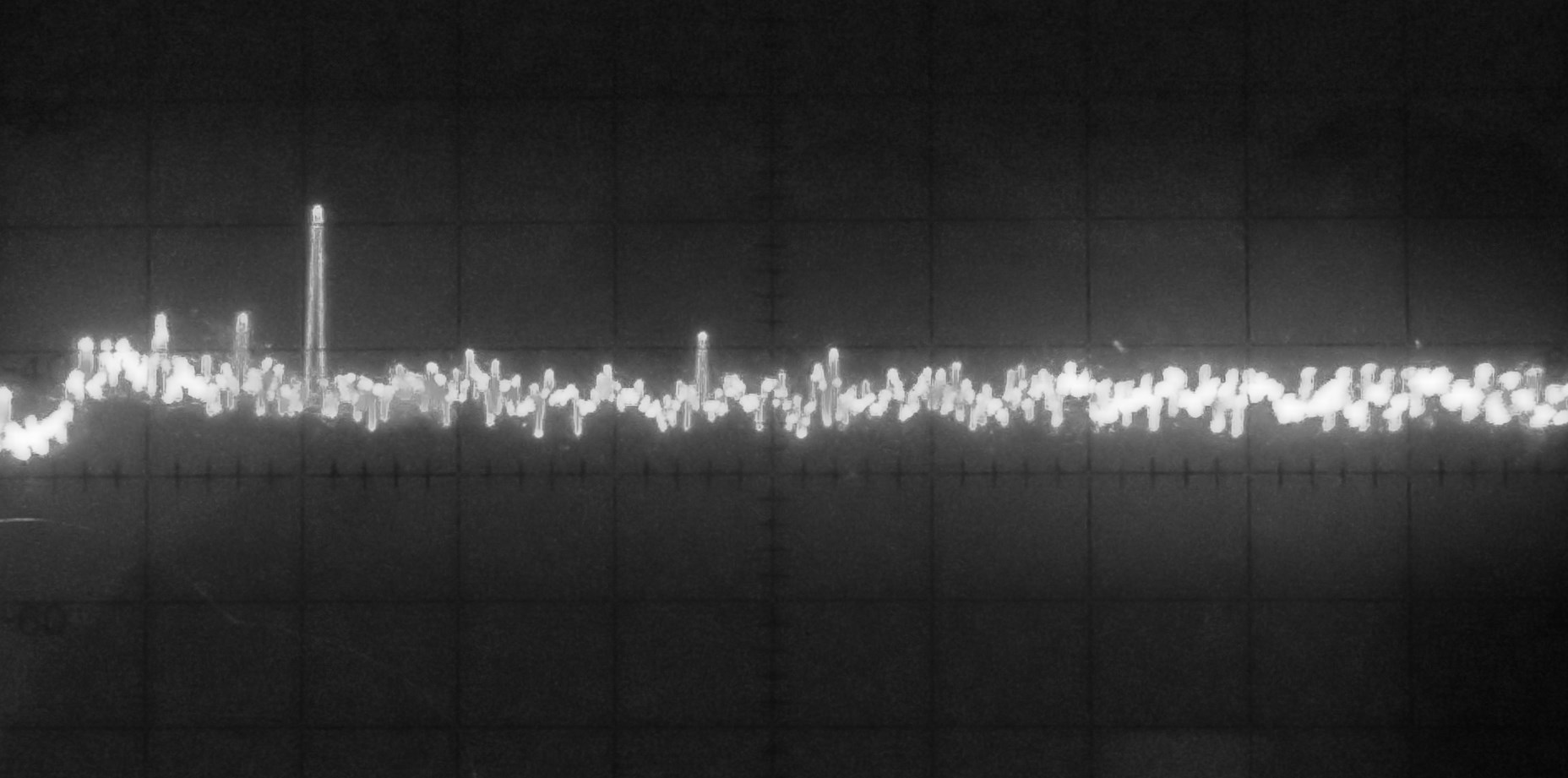

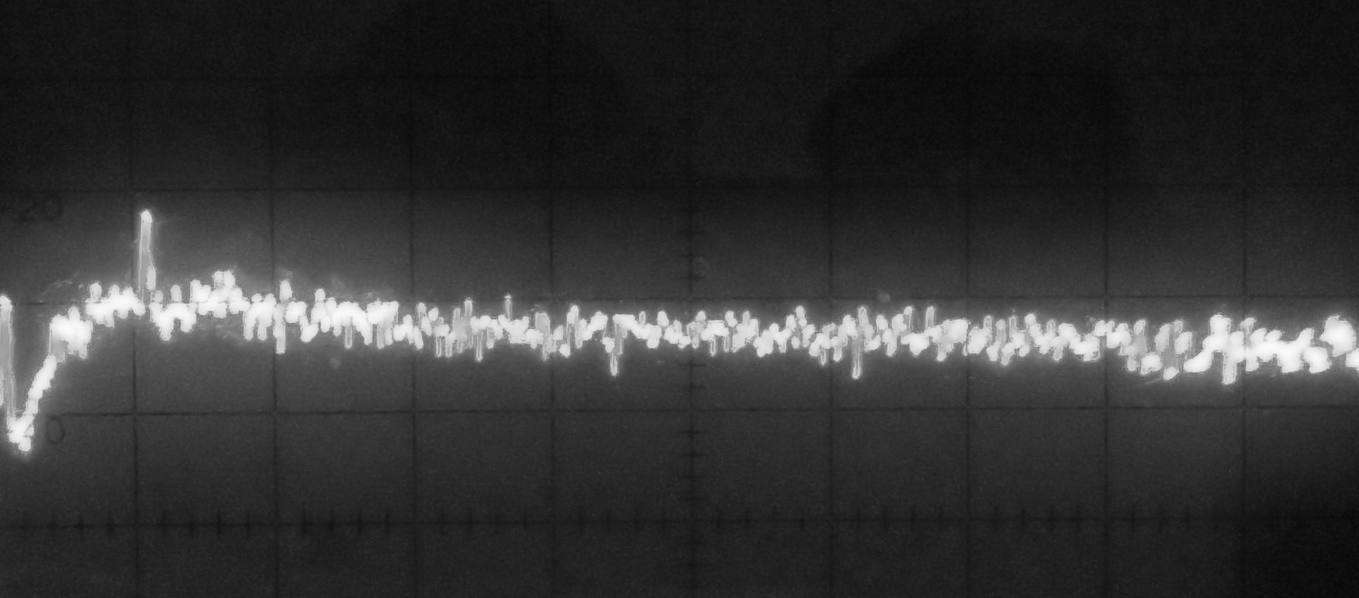

Just as a DUT (amplifier) can increase its distortion with high Z input sources, so might other circuits -- osc and notch filters. And the Zo of the notch filter (unbuffered) going into the DUT can be giving 'false' numbers which wouldnt exist with a very low Z source. Like-wise the osc and notch can interact to produce poorer results than anticipated.
Here is something also interesting.... I have compared the THD of two analyzers using the same source generator. They gave similar THD figures but as you can see in the photos.... one is showing a 2H dominant and the other its a 3H !!! Now how can i tell there isnt some sort of timing error in setup display (didnt change any settings)...
Both can indicate the level of the individual harmonic I choose. And as the residual display showed, the analyzer indicated the Harmonic which was highest was the one shown via the residual monitor output port.
Impedance interaction with generator z on the analyzer inputs?? I tried adding 1K in series with each analyzer input but the Harmonic level and freq disnt change.
Got any ideas... cockpit error or ??

I get the same thing with my measurements. All it takes is making a small insignificant change in the measurement path and the second and third H can change places in terms of there level. Sometimes the second melts away proportionally with the rise in 3rd. Explain this. At these infinitesimal levels I'm never sure of what I'm measuring.
There is some phase shifting apparently happening somewhere.... between the notch phasiness and harmonics a confusion in the dsp analyzer portion at certain phase angles. ?
But note - mine is from 2 different analyzers..... they are each fixed on their harmonic and it didnt change... each analyzer sees something the other doesnt. Might be related to your phenomenon, though. Or is the 2H beating with the residual 1H to produce a 3H?
-RNM
