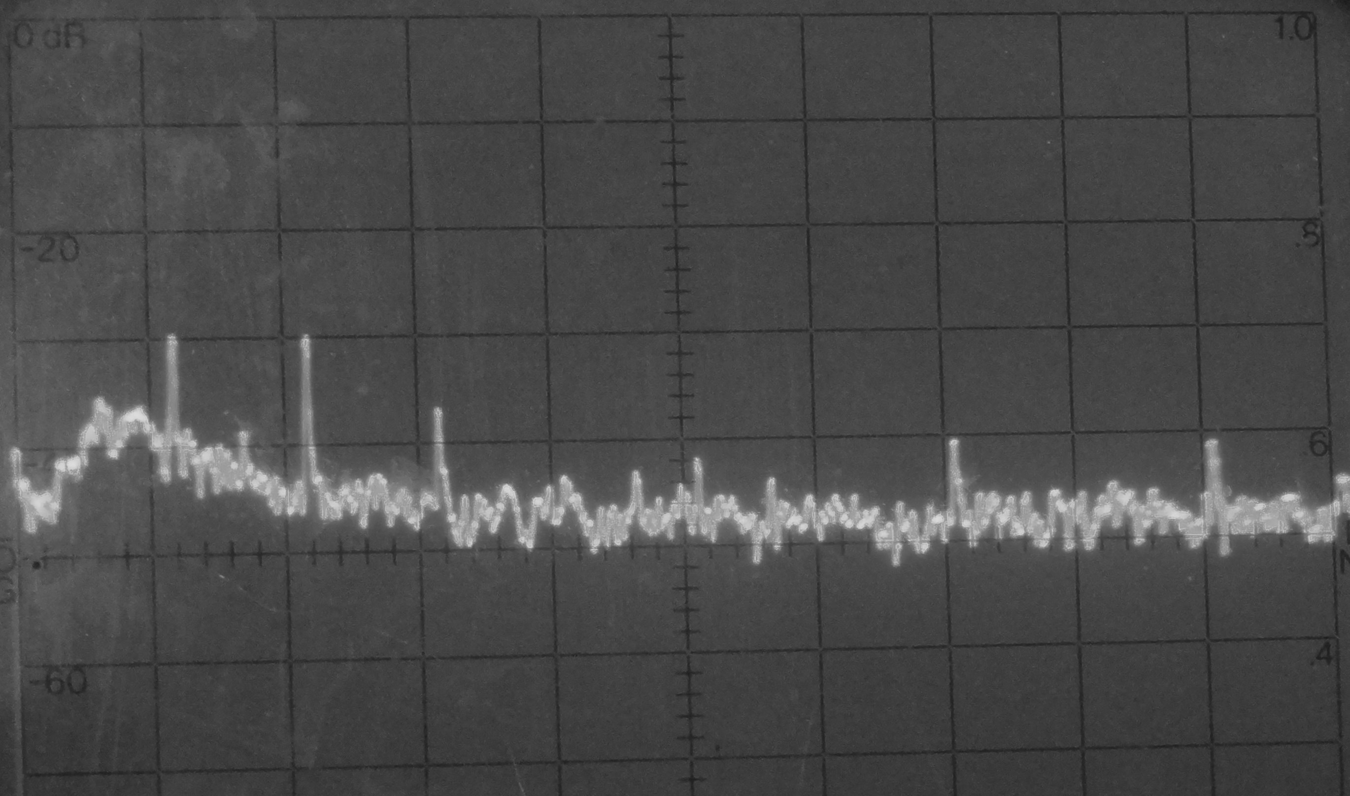

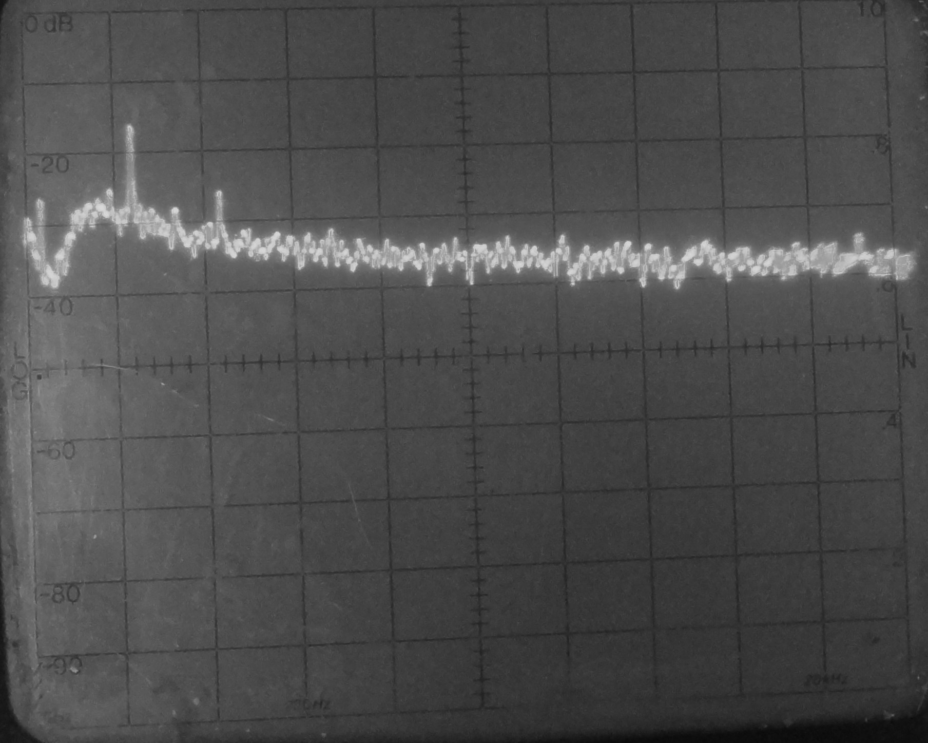

Here is something also interesting... I have compared the THD of two analyzers using the same source generator. They gave similar THD figures but as you can see in the photos... one is showing a 2H dominant and the other its a 3H! Now how can I tell there isnt some sort of timing error in setup display (didn't change any settings)...
Both can indicate the level of the individual harmonic I choose. And as the residual display showed, the analyzer indicated the Harmonic which was highest was the one shown via the residual monitor output port.
Impedance interaction with generator z on the analyzer inputs? I tried adding 1K in series with each analyzer input but the Harmonic level and freq disnt change. Got any ideas... Cockpit error or?
Now we're getting somewhere! As you've now discovered yourself (apparently external interventions didn't help 😉), a distortion analyzer does have its own distortion contribution, which interacts with the DUT. And that's not limited to input/output impedance interactions. The distortion contribution of the analyzer is not some sort of offset which we can measure and then subtract out, as done for a DC voltage measurement. The distortion contribution is a very strong, and complex, function of the operating conditions of the analyzer (frequency, level, range settings, source Z, amount of RF interference present etc.). This all is way too complex, and sufficiently inconsistent, to model. So the best bet is to design a (probably passive) notch filter which one can expect to perform much better than the oscillator under test. That's of course a classic chicken-egg problem--to verify the notch filter you need an oscillator with known much better distortion performance, and vice versa.

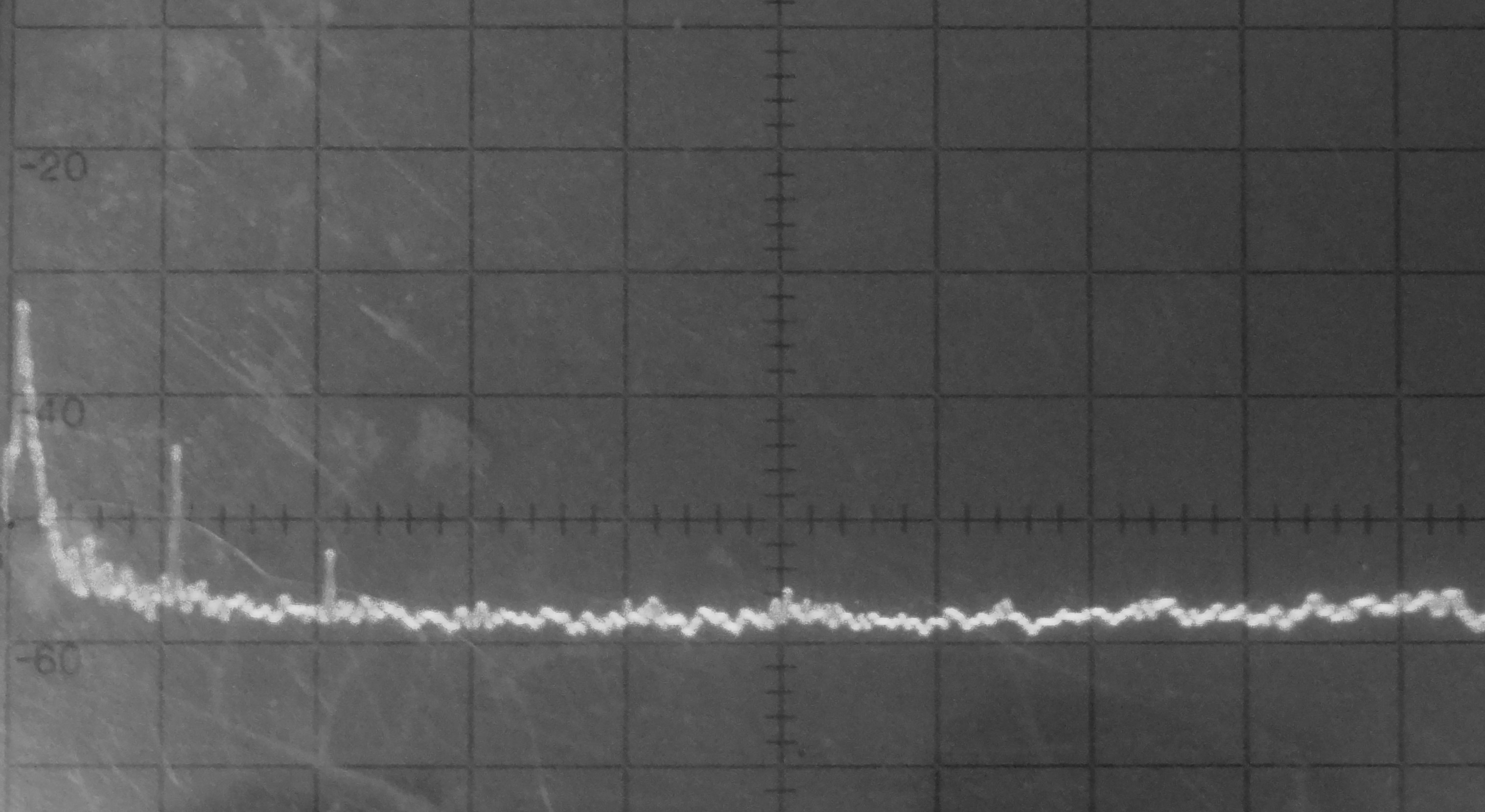

Analyzer compared
Here is the THD+N from the same signal generator and looking at two different THD analyzers' residual output/monitor ports.
First is from Panasonic VP-7722A, second is from ShibaSoku AD725D analyzer;
Thx-RNMarsh

Demian.... it isnt relavent to these pictures. You only need to see the 3H is lower in some analyzers -compared to the 2H. It could be 10% THD... or .001% THD it doesnt matter.
[I also did as you suggested already and pointed out some interactions with that signal a few lines back.]
Here, I dont care what the absolute levels are. I am showing differences in the recovered Harmonic levels for the same input voltage/source/freq.
If the 2H and 3H do not have the same relationship in level to each other then what are some of the possible explanations for it ?
With the 725, the 2H and 3H are at similar levels to each other. With the other analyzers, the 2H is much higher than the 3H.

If the 2H and 3H do not have the same relationship in level to each other then what are some of the possible explanations for it?
Well, I'm quite desperate as I've tried to explain this issue probably half a dozen times now... Apparently I can not phrase this good enough. Surely this text (page 44ff) does better:
http://cds.linear.com/docs/en/application-note/an43f.pdf
In particular make sure you follow the section on "Distortion Measurement Accuracy".
