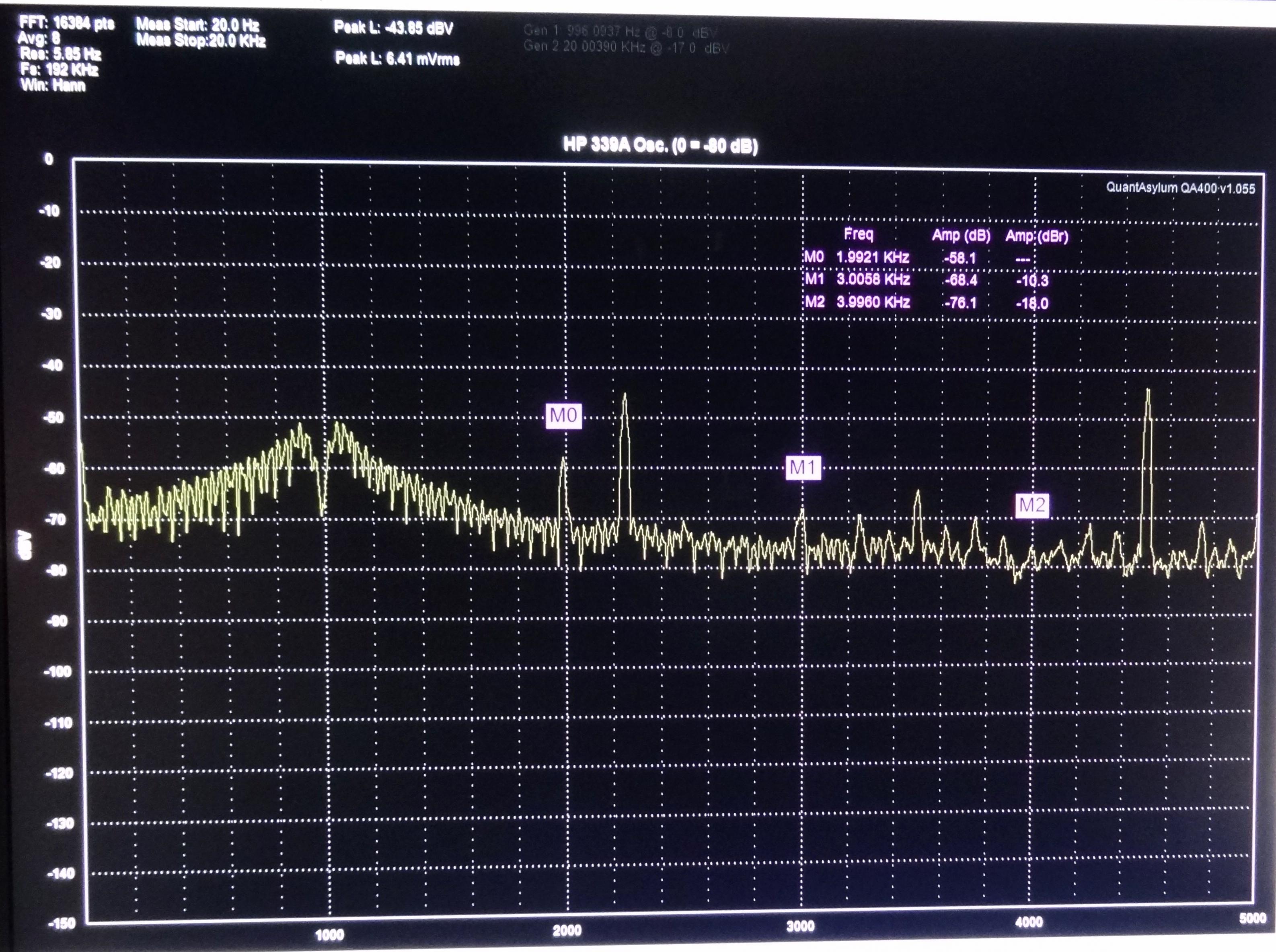

Once upon a time... when we were modifying an HP-339A for lower distortion, someone asked to see an FFT of the harmonics. here it is at 1 volt out/1 KHz out of the monitor port to the QA400 FFT. I just got this QA400 working on one PC -- I havent yet tried to see where the multiples of 2.25KHz are coming from but as you can see the harmonics from the 339A 1 KHz fundamental are labelled as MO (2H) etc. Note the 0 = -80dB full scale (I didnt do the x10 mod that davada did):
-138 and -148dB for 2H and 3H... ...

Hi Rick,
I'm not clear about what you're measuring this on. Is it the monitor output of the 725?
No. I already did that earlier with 725 and an HP 3580A Spectrum Analyzer. This is from the monitor output of the HP 339A into the QA400.

Once upon a time... when we were modifying an HP-339A for lower distortion, someone asked to see an FFT of the harmonics. here it is at 1 volt out/1 KHz out of the monitor port to the QA400 FFT. I just got this QA400 working on one PC--I havent yet tried to see where the multiples of 2.25 kHz are coming from but as you can see the harmonics from the 339A 1 KHz fundamental are labelled as MO (2H) etc. Note the 0 = -80 dB full scale (I didnt do the x10 mod that davada did):
-138 and -148 dB for 2H and 3H...
Not sure I follow. You're measuring the output of the modified 339A oscillator section by feeding it to the analyzer section of the 339A, and then the residual monitor output to the QA400?
Samuel
