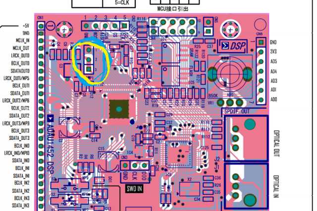

I finally started playing with the Lusya ADAU1452/AD1938 boards, thanks for the help provided so far. When looking at new devices, I always try to understand the circuit fully, because usually that helps in figuring out what a board can do
I started from the manufacturer schematic and PCB, provided in this forum. The ADAU1452 circuit is identical to the PCB, while the schematic for the AD1938 codec board is not the same as the PCB. I was struggling to understand how is it possible than an AD1938 could support multiple I2S and conversion frequencies by changing a jumper (JP3: 1-3 close for 96KHz I2S, 1-2-3 close for 48KHz I2S, 1-2-3 open for 48KHz TDM, and finally 2-3 close for 96/192KHz TDM and 192KHz I2S). The similar Analog Digital ADAU1452 Eval board requires HW modifications and SPI programming to change how the AD1938 works.

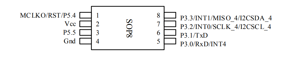

Then I finally realized that IC16 must be a programmed microprocessor that sends the correct configuration to the AD1938 based on JP3, and using the SPI pins on the AD1938 (pins that, in the schematic, are shown as connected to GND, which is most definitely not the case)
The chip used is part of the STC8F1K08S2 family (using an 8 bit 8051 core, more than enough for sending SPI configuration to another chip), and the specs can be found here STC8F1K08S2 DATASHEET, full programming documentation for he chip are here http://www.stcmicro.com/datasheet/STC8F-en.pdf. I'm including also the pinout for the specific chip used in the codec board
What is interesting is that in the future it's possible to easily remove the STC microprocessor and use the pads to connect the STTM32F103 on the main board to the SPI pins of the AD1938. The STM32 onboard breaks out a secondary SPI port plus 4 generic I/O pins (marked as RX/TX1 and RX/TX2, and those can easily be used for the AD1938, while the ADAU1452 is already connected to the primary SPI port on the STM32. So it would be easy to use the onboard STM32 to program both the ADAU1452 and AD1938.
One of the things I would like to do once I learn more, is to have the ADAU1452 work at the same frequency as the I2S signal. At the moment, the ADAU1452 uses the ASRC to ensure that any I2S signal can be converted to the internal frequency. When using a USB to I2S interface that supports multiple formats, there can be conversion artifacts, especially upconverting 44.1KHz to 48KHz (or multiples). Ideally, if the source is encoded at 44.1KHz, the best option is to use the ADAU1452 and AD1938 at 44.1KHz as well. We could use the MCLK signal from a board like the Amanero Combo384, but changing the core frequency on the ADAU1452 requires a reboot. Using the STM32 to properly reboot the ADAU1452 and set the correct values for the signal frequency would make it possible
When I have a quiet moment, I will capture the SPI signals between the STC micro and the AD1938, to see what settings the manufactures is using for the various AD1938 frequencies. Since it requires having a logic analyzer on a running circuit (and in the lower board), I need to make sure I don't fry the STC chip, because that would be next to impossible to replace (even assuming I can find the right STC chip and buy the programmer, there would be no way to get the source code for that chip)

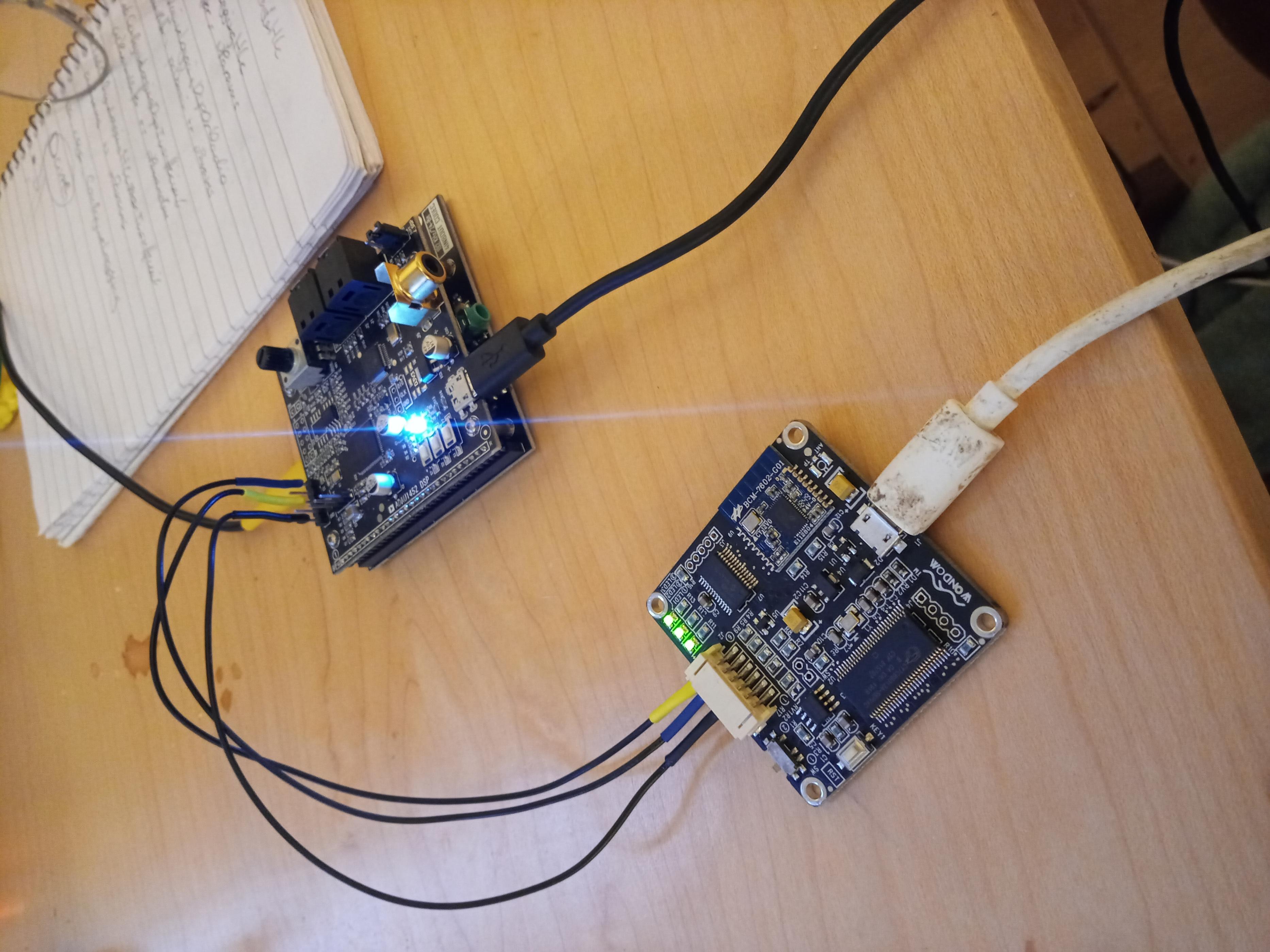

Got this board recently and hooked up a Sure ICP via I2C to program it.
Made a quick demo and uploaded to the board - it works! And the performance is much better than expected.
I had the issue that I couldn't get it to save to the EProm. Tried uploading via the DSP. I looked at the schematic and saw that my boards resistors corresponded to the SPI configuration so I selected to upload via SPI from the DSP. Still Didn't work.

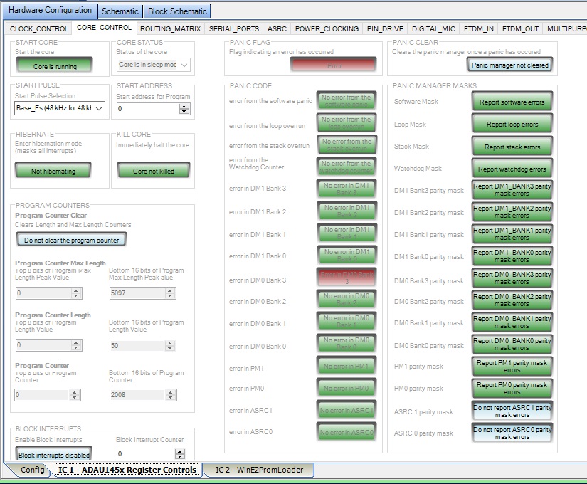

THEN I changed the USB block to SPI on the EProm, this doesn't seem like it would change anything but it seems I successfully wiped the EProm. Trouble is my board now boots into an error condition. Help!!!
Pics below.
Cheers.

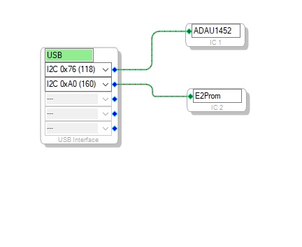

Thanks for the response, this doesn't work and I think it's because I'm using the Sure ICP3 which is I2C only. Surely that means trying to set the E2Prom connection in the USB block to SPI is Invalid?
As in, are we trying to load the data into the E2Prom directly from the USB device? Or have I misunderstood?
I'm currently trawling the datasheet to work out how to operate the chip manually from SigmaStudio, I think if I can do that then I can get the 1452 into a state which it is capable of receiving the program by itself.
How does the startup register control relate to the program designed in SigmaStudio?
I have Lusya board and Sure ICP3. Have you put jumper on the pins 1 and 2 of SIP1 header before powering the board?
In USB block: ADAU1452-I2C 0x76, E2prom-SPI 0x1 (in "properties" set to SPI Mode 3). Write latest compilation through DSP

Thanks guys for clearing it up! This morning I unplugged everything and started a fresh project, booted with the jumper on the self-boot header and uploaded my program. It worked. Wrote to the E2Prom and checked the E2Prom memory - Succeeded!
My test program is a 2khz generator fed to the output. I saw the tone on ARTA but then.. it turned off. Then back on again, then off etc. Not sure what the problem is now, perhaps the board is encountering an error and resetting itself.
