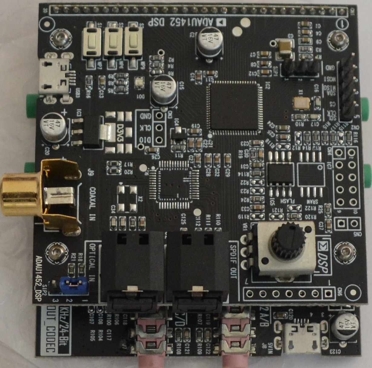

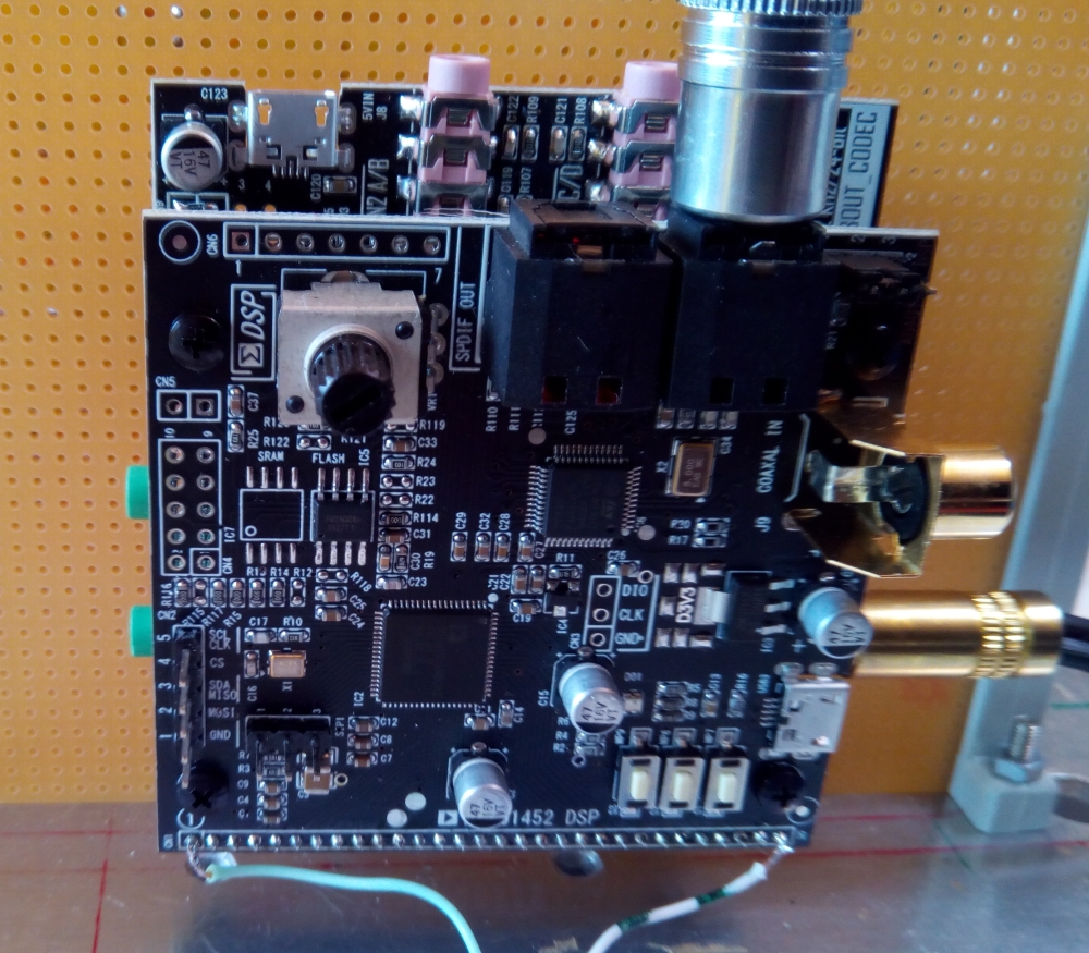

Good day to you all,
I am working with an ADAU_1542_DSP and AD_1938_CODEC board.Programming with I2C works well. I have been able to make some adjustments to the "original configuration" of "ADAU1452_192tdm/I2C.dspproj".I found a lot of help for this in this forum. Unfortunately, I don't know Chinese. But bit by bit you can understand the programming.
I've captured my setup in the picture.
1 Left tweeter/midrange (Wondom TAMP2100)
2 Right tweeter/midrange (Wondom TAMP2100)
1 SUB Left/Right (Wondom TAMP2100)
4 Loudspeaker protection (DC and plops) 2x3 relay channels optocoupler
5 Voltage/current 2 Meanwell EPP-150-27, 1 No Name power supply 24V 10A (for SUB).
6 Power supply for preamplifiers (DSP, speaker protection, 6 channel volume control etc.). Talema transformer 2x9V 25VA
7 ADAU_1542 board
Cable for signal transmission not connected in the picture.

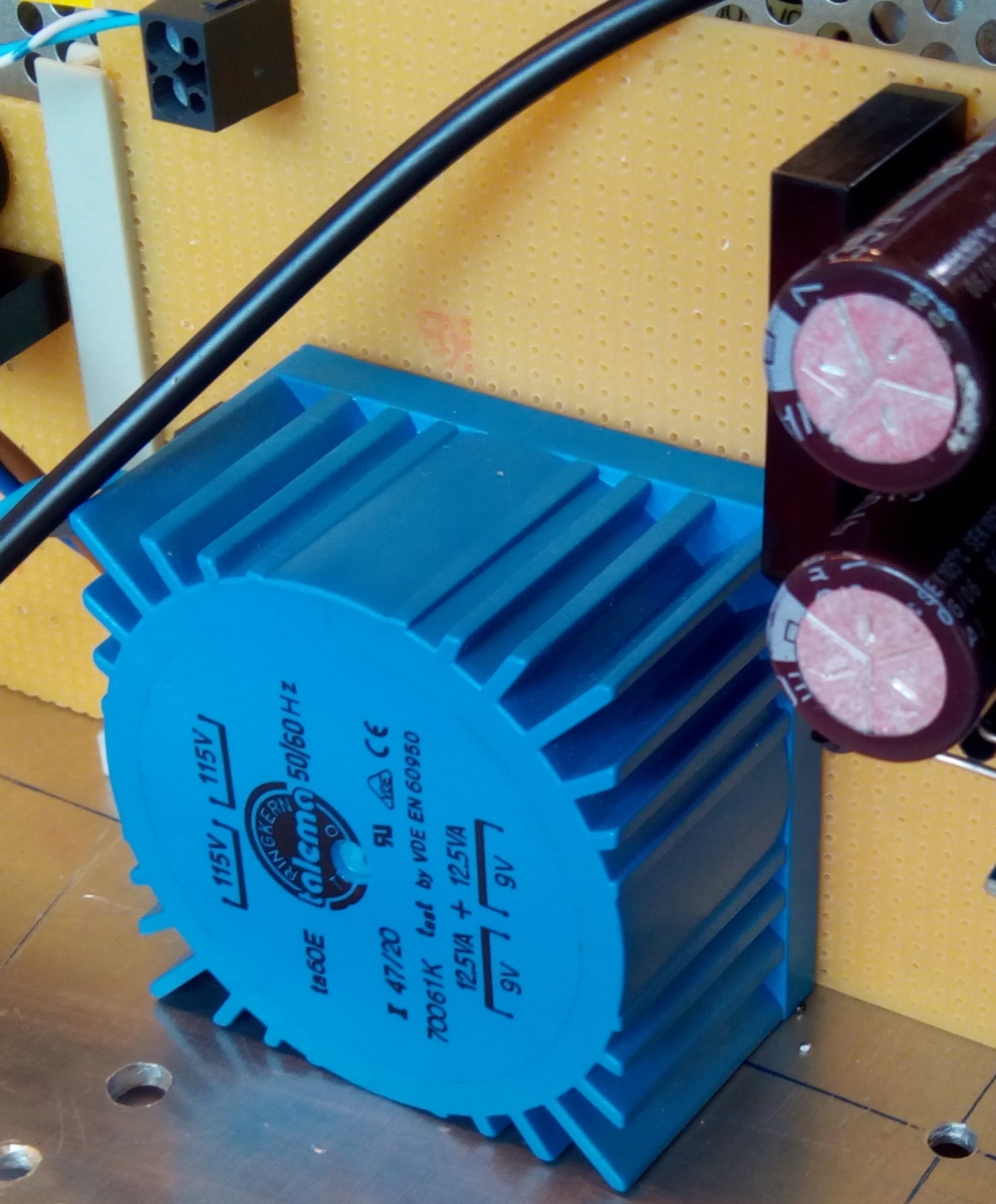

I soldered the power supply for the DSP from the transformer (rectifier/capacitor) via a StepUpConverter to pins 1 (5V) and 2 (GND). The voltage for the loudspeaker protection comes from the second winding. Also unregulated via rectifier/capacitor. The protection circuit has a 7912 regulator. The volume control would be supplied with 2x9V symmetrical AC voltage.
Can I do it this way, or should I rather use a USB port to supply the DSP? And if so, which of the two?
And now comes my problem: I have a slight noise. Really very quiet. A slight analogue noise would be normal for me. This is to be controlled by a 6 channel volume control with PGS2311 before the power amplifiers.
But very quietly in the background I have a beeping. Maybe 1 Khz. I'll have to try the oscilloscope.
Do you have any suggestions for the wiring of the grounding? The power supply units and the power amplifiers are connected to a common ground point on the protective earth.

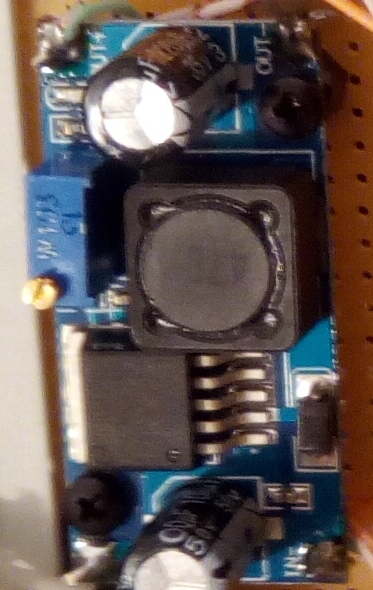

@blubbervill, 3 things come immediately to mind, in order of relevance
- The step up module you use is known to be horrible quality. Use a high quality 5V power supply with minimal ripple
- You have too many analog and digital boards and components into a too small enclosure with no visible shielding. Think of having the DSP inside a metallic cage (with good ventilation, that board can get really hot)
- Even after all of this, a very faint noise is inevitable with a cheap board like this. The analog portion (AD1938) is designed for low cost, not high quality and minimal noise
For me it sound really good... but its only subjective...
Someone with the proper insturments could measure the ADC performance and DAC. Spec wise they are respectable.
Specs of the chips are respectable. Actual performance in this type of board is actually notably worse. Designing low noise circuits is very hard. In this case, designing a board that can be used at different clock speeds, would require optimizing input and output filters for each frequency (which is not possible in our case)
The actual performance depends on which input you use (in my case some inputs are noisier than others), the clock frequency used, input and output device impedance, power supply, additional filtering, etc. And I'm willing to bet really good money that every individual board behaves slightly differently, due to the cheap components used with different components tolerances
Put it another way, you will need to measure your specific case once you define everything else around it.
I would not use this board (the AD1938 portion, I mean) to build truly high quality audio devices. This is a great board to play with and learn, then use the ADAU1452 portion only and a really good ADC or DAC, optimized for your specific use. the ADAU1452 board, being 100% digital, will be able to work with much higher quality AD/DA components with no appreciable decrease of quality. Keep in mind that any DSP, by its nature, will never be measured as good as a highly optimized DAC, with precision clock, since the DSP engine itself will modify the digital signal by design and introduce measurable jitter. But, then again, i's what we need the DSP to do: modify the signal 🙂

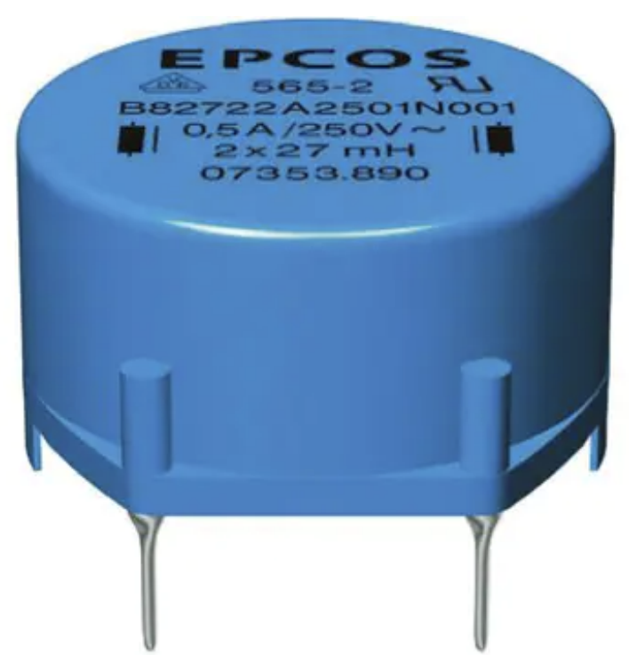

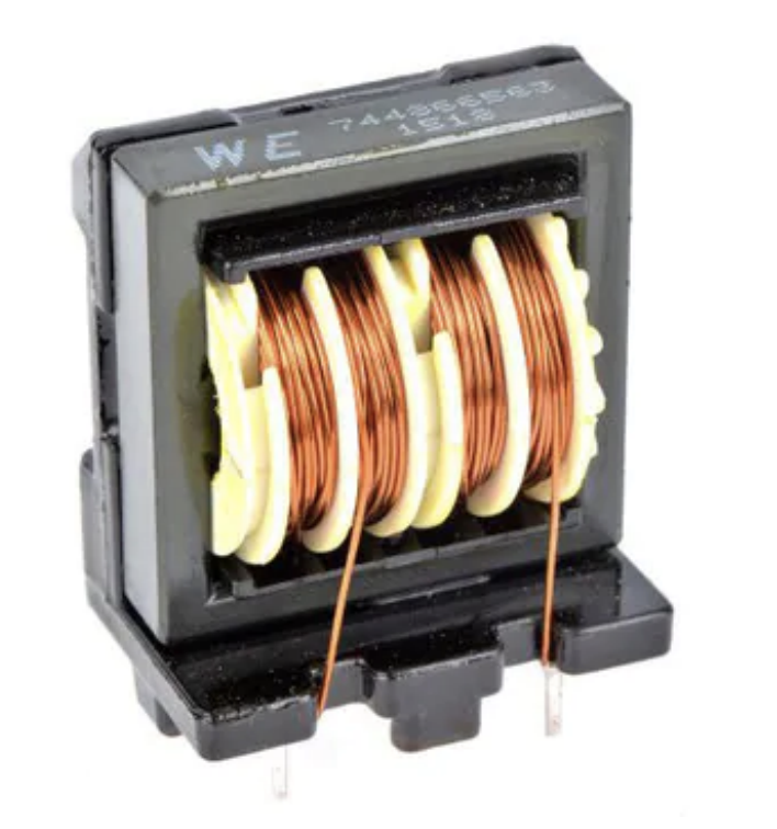

Are you electrically connect the each aluminum brace boards?
If the each boards are well designed, you can try to insert the huge common-mode chokes for each board's power supply cables.
Something like this...

The aluminium plates on which the amplifiers are mounted are connected to the common earth point. I realise that everything is close together. But it is a test.
The amplifiers, i.e. the WONDOM TAMP2100 are very quiet without connecting cables at the input. But not completely.
I'm not designing the ultimate high-end system. But it really surprised me what quality can be achieved with the ADAU1542 and the CODEC board. Or rather with what I have put together.
The DSP and the DA-converters should always work at a high level for a good signal/noise ratio. That's why a volume control is planned in front of the power amp inputs. This could be done with PGS2311 or, if there is noise, with a relay.
I just wasn't sure where the DSP board is supplied with power. Solder the supply to pins, or use one of the two USB connections. But that doesn't seem to have any influence.
I just removed the two MeanWell EPP-150-27s from the installation. The cheap power supply is now the only power supply for the output stages. The quiet beeping is gone. Previously, I had connected a MeanWell power supply unit as the only power supply for the power amplifiers in the system. This resulted in distinct (loud) whistling. What I don't understand. (???)
Then I played with the power supply for the DSP board. LM317, LM2596 or now XL6009 makes no audible difference in terms of noise. Everything is minimal.

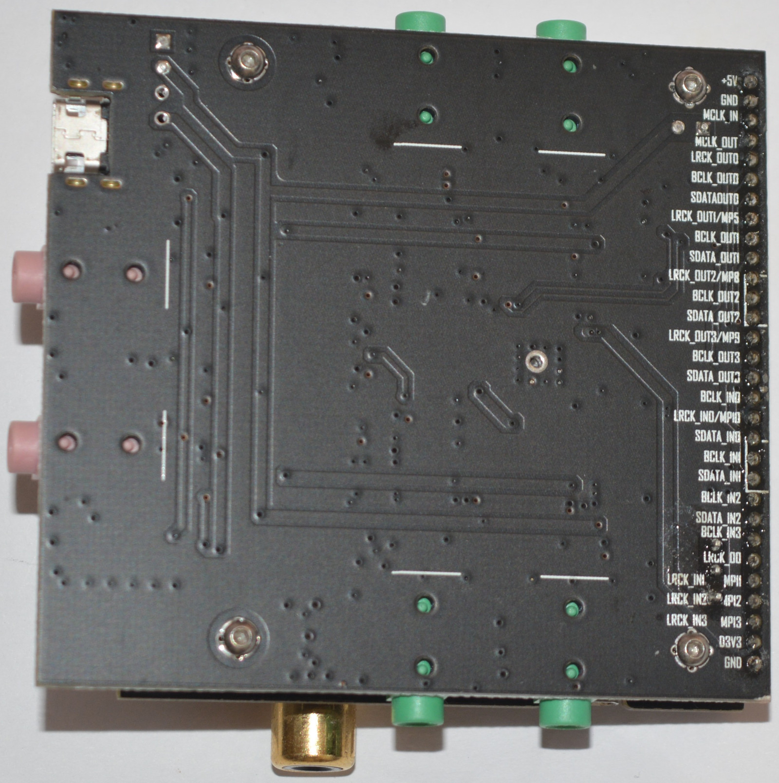

Does anyone have the drawing for the ADAU1452 board? The DSP board, with dimensions for mountingholes and the pins going down to the AD1938 board?

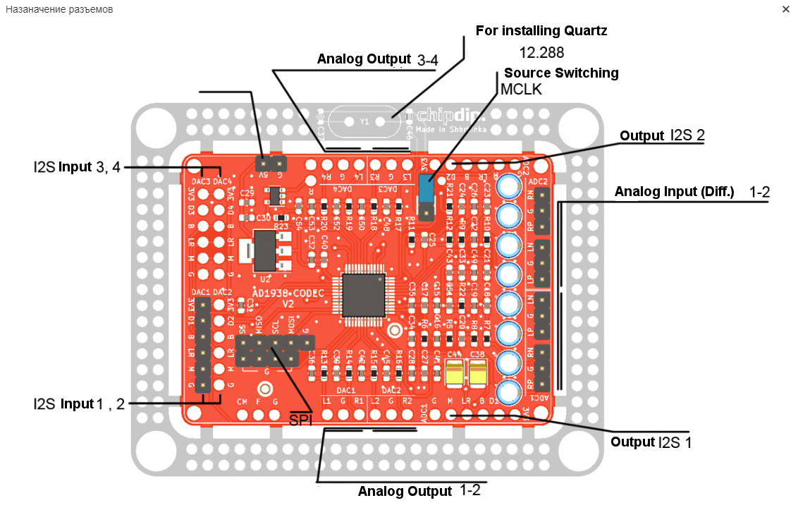

I would like to make a sort of replacement board for the AD1938, with a pinsocket for the ADAU1452 board, maybe add decent low noise powersupply/powersupplies for the DSP-board(if possible without too much modification to the board) and U.FL connectors plus Molex KK(or similar).
Sort of a breakout board for the pinheader of the DSP-board, possibly with better powersupply(the pcb space is there, as it would match the size of the AD1938 board more or less, why not use it).

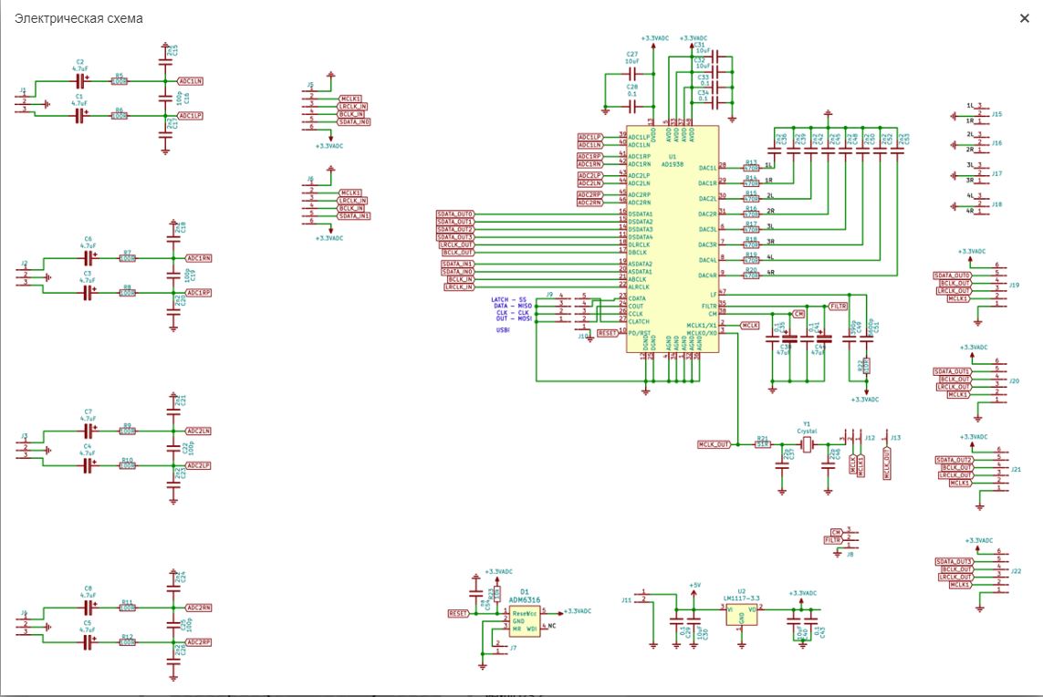

I need help programming the AD1938 CODEC which I've got from chipdip.ru (by the way, tahnks drMorder!)
You se... I am trying to connect two AD1938 in "daisy chain" mode to one ADAU1452 DSP, but I am stuck...
The first thing I want to do is to config the hardware registers on both codecs so they can work in "daisy chain". For that I am using USBi and Sigma Studio (SPI).
USBi is properly connected and detected by Sigma Studio. I am using SPI, so MISO, MOSI, SS and SCL are used between USBi and AD1938. Also, 5volts are provided to the codec.
When I choose "Get Current Settings from Chip" all AD1938 settings go to default (all muted, disabled, power down, etc.). After that I modify all the settings and choose "Write Current Settings to Chip". Everything seems to be written to the chip, as my capture screen shows the blocks write, and "Downloaded" is shown on the right bottom corner. So far so good.
To verify that settings where written to codec, I now set "Get Current Settings from Chip" , which should show all the settings I made previously, but instead all goes -again- to default (all muted, disabled, power down, etc.).
I posted this on AD EngeneerZone and the thankful DaveThib offered me some insight, but I am still stuck and not being able to program the AD1938CODEC using SPI.
DaveThib suggest the SS pin on the codec needs to be a pull up resistor on it to keep the codec from going into standalone mode. I am not very technical, but that means that I have to connect the SS pin to 5volts output with a 10kOhm resistor, correct? I've tried this but got the same results.
Then found this page: Stand-alone Modes on the AD193x audio CODECs - Documents - Audio - EngineerZone
