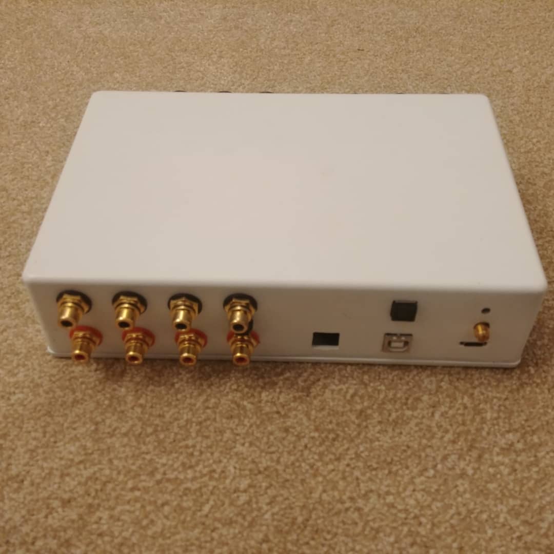

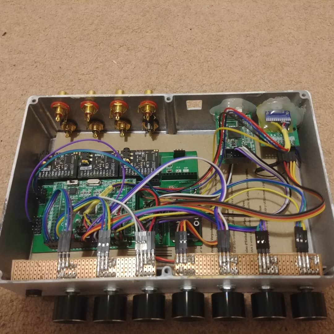

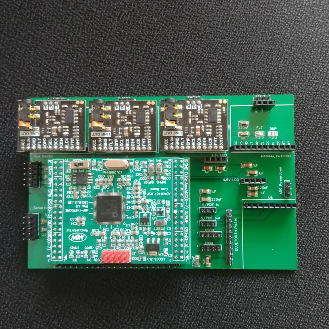

Prototype DSP
Thought I'd post a few pics of my prototype based on the ADAU1467 core board.
I designed a pcb to connect it up to the following :-
Inputs
2 x USB I2S (only 1 connected at the moment)
SP/DIF
Bluetooth I2S
ADC pcm1802
Outputs
4 x Pcm5102a DACS (3 populated at present)
Jumpers/pins to allow use of alternative LDOs for analogue sections
Jumpers for 7 rotary encoders for volume (main, sub, 5 inputs) plus aux ADCs that I use for mute.
Other pins broken out on headers.
Future development includes ESP32 for remote control
The board isn't perfect, but it works and is easy to assemble with just a soldering iron as the SMD caps are 1206
I made the mistake of thinking MP1 and MP3 were usable, so had to use alternatives from the aux header instead. (They're used for the self boot EEPROM)

My efforts on making a breakout board for the core boards has been stalled for a while now as I've done other DIY projects, and I have a DCX2496 as well as two working FreeDSP classic boards (and the ADAU1452/ADAU1466, black boards w/out the u-controller).
Anyway, nice work!

I recently purchased an ADAU1467 core board as well as the corresponding 8 input 8 output base board with the analog inputs and outputs. I'm having a little bit of a problem with trying to get SigmaStudio to recognize this. I have a Sure or Wondom ICP3 (similar to the Dayton Audio ICP1). This programmer appears not to support SPI, so I'm using I2C.
I ran some wires to the core board, and plugged it in. When attempting to load the sample program, SigmaStudio says "Active, Downloaded" for a second, then back to "Comms failed". The program is not loaded correctly.
If I disconnect the I2C lines, it doesn't do this, and stays at comms failed. I have already configured the strapping resistors for I2C operation per the included schematic.

Yes, could just be the I2C address. You can also try to probe the I2C address pins and check how they are set.I'd suggest trying all of the I2C address options in turn, to see if the board simply has a different address than expected.
A bit hard to guess what could be wrong without some documentation. We can guess but the schematic may reveal some interesting things if you can share it.
I have the ADAU1467 core board and Sure programmer, it works fine.Hi all,
Wondering if anyone else has had any luck getting this to work with I2C or whether I need to buy a USBi that supports SPI. The programmer works fine with an ADAU1701 board from Sure/Wondom (the JAB5).
Thanks!
Programming is identical to the adau1452, see my instructions further back in the thread. Try programming it not plugged in to the other board, you might have power issues. Not sure what you've done with regard to resistors, I didn't change anything and it just worked.
I picked up 3 of these board combos last year May. Been using them 96k without a problem, up to now. With the boards vertical, the 1938 had no issues.Well there is a poor, single AMS117-33 powering everything: ADAU1452, AD1938, STM32F103 and all other analog chips. The ADAU1452 alone can use more than 500mA, the AD1938 is ~200mA when fully powered, it's unclear how much the STM32 is using, let's say 50mA. Just just these 3 chips, we can use 750mA, out of an AMS117 that is rated for 800mA. Touch the AMS117 when running, and you'll see how hot it gets. Other chips get pretty hot, too, and there isn't a lot of air circulation or heat sinks on the board/copper planes
Pretty much everything on the Lusya board is operating outside of specs. It's very cheap and easily available, but not exactly a well designed board.
As a test, you can try disconnecting the AD1938 board and use only the ADAU1452. If yo don't have problems in that case, your root cause is the AMS117 being maxed out. If you still have problems, it's very likely not a power/heat issue
However, all of a sudden, each of them, within a month of eachother, has started 'jamming up'... they run fine, either downloaded or eeprom based, and then randomly stop processing. The led turns on a dim white when this happens. Resetting the boards does the same thing.
Yes, checked the output of the voltage regulator, its within spec. Also have removed the 1938 board.... and the dsp still all of a sudden just stops. The dsp's have never run hot, btw, always cool.
Any ideas given what folks have seen that might cause this?
