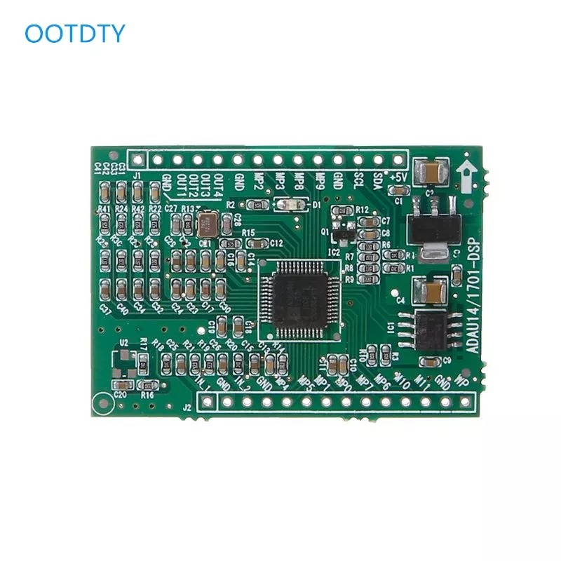

HiI'm using ESP32 to program ADAU1401 over the WiFi. GitHub - hasaranga/SigmaESP32: ADAU1401 Wireless Access using ESP32
Are you using this board from attached image in your setup?
I'm also using MCUdude's library with esp8266 but had no luck to talk to adau1401 via i2c...
Nevermind, it was the code line missing problem, everything working now.Hi

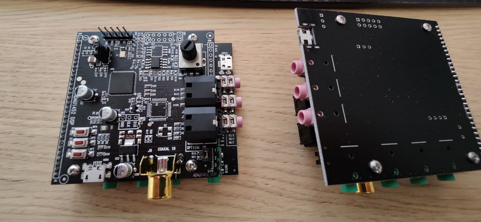

Hi all, I've got the ADAU1452 board as in the photos from fackamoto this morning, and I can get sound in and out of the DSP with no problems. I can also run the 1kHz test program when the LED is blue, but I can't get it to run my program. Am I missing something with the LED colour and the three switches? I'm trying to just run the reverb block in SigmaStudio and it says it's compiling and downloading correctly, but it's not doing anything. Ii'm getting the clean signal with the LED red, 1kHz sine wave when it's blue, and no sound when it's green.
Have the same board, ADAU1452_DSP with CS42448 piggyback, this board does not integrate the MCU_STM32F103C8T6. Also purchased the programmer from the same vendor Nvarcher.That DSP canot connect directly to PC thru USB. You need the programmer and SIGMASTUDIO to upload the correct project.
Was not able to connect with programmer using the "SPI" pins. I've instantiated the 1452 from the SigmaStudio and tried to "read all registers" with no reaction. Is there a walkthrough for this board somewhere?
Will appreciate help.
