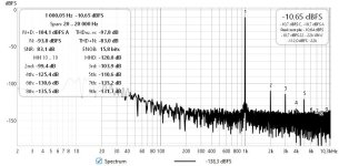

But I could live with frobek's results. But don't see how it is possible without a 1.88 Volt DC out of AD codec. Then 1 volt peak to peak is possible
But the spec sadly says: "Each output pin has a nominal common-mode dc level of 1.5 V and swings ±1.27 V for a 0 dBFS digital input signal." https://www.analog.com/media/en/technical-documentation/data-sheets/ad1938.pdf
So then with digital DC insert on signal, it is possible with 2,77 Volt max. And 0.77 Volt peak to peak for signal into 1612. That is on the limit of enough.
frobek has -6dBFS input on his ADC
I probably didnt mention before but I swapped opamps to OP1662. Measured signal was slightly lowered in DSP to avoid both codec and opamps clipping. Same board, codec supply connected to DSP board USB supply:
