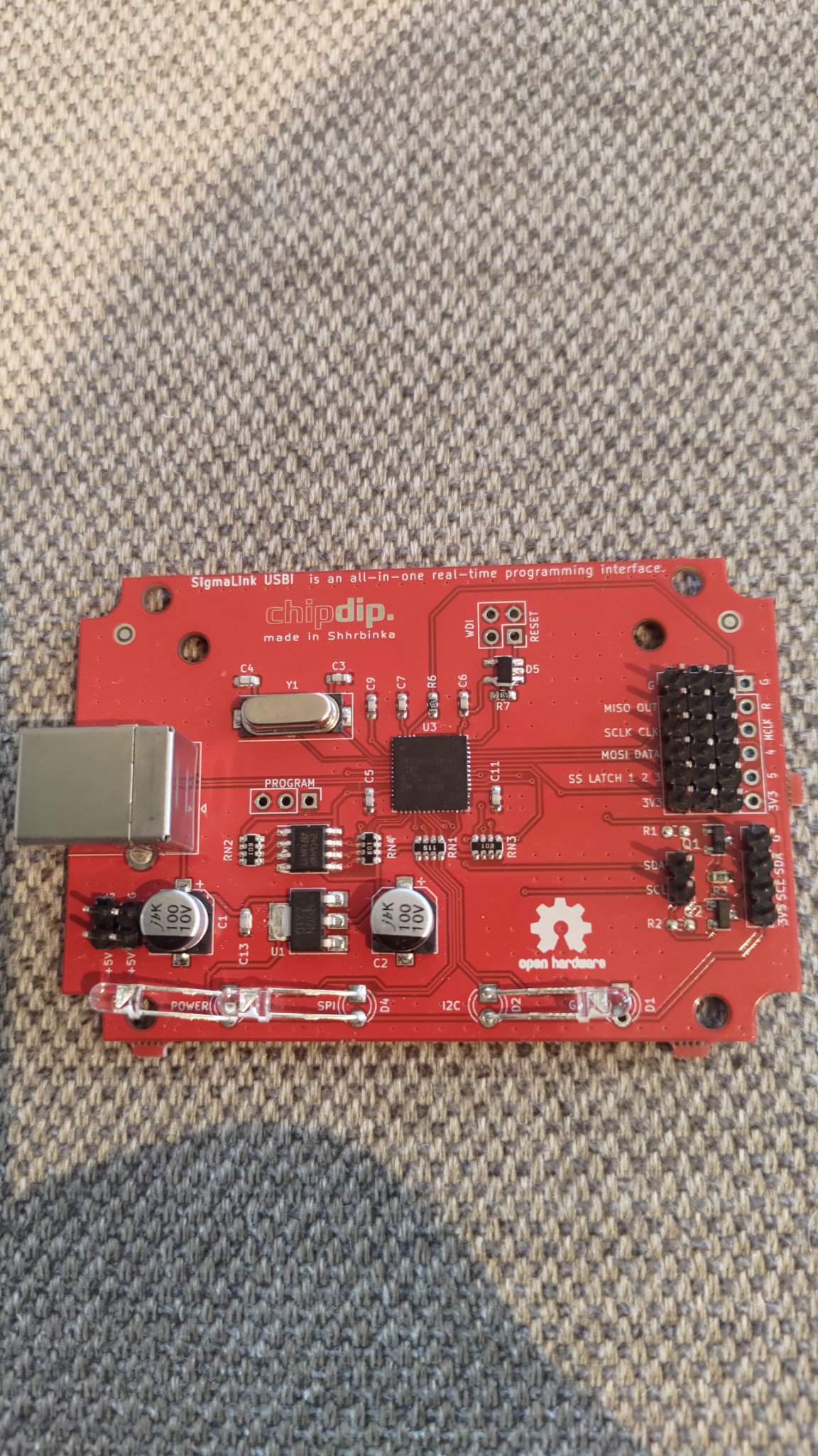

I'm sitting here with a SigmaLink USBi from; https://www.chipdip.ru/product/sigmalink-usbi?from=suggest_product
My challenge is to communicate/program with this and the ADAU1452.
I also have this, it is a good one.My challenge is to communicate/program with this and the ADAU1452.
Just connect 3 wires from the right bottom header - sda, scl, gnd

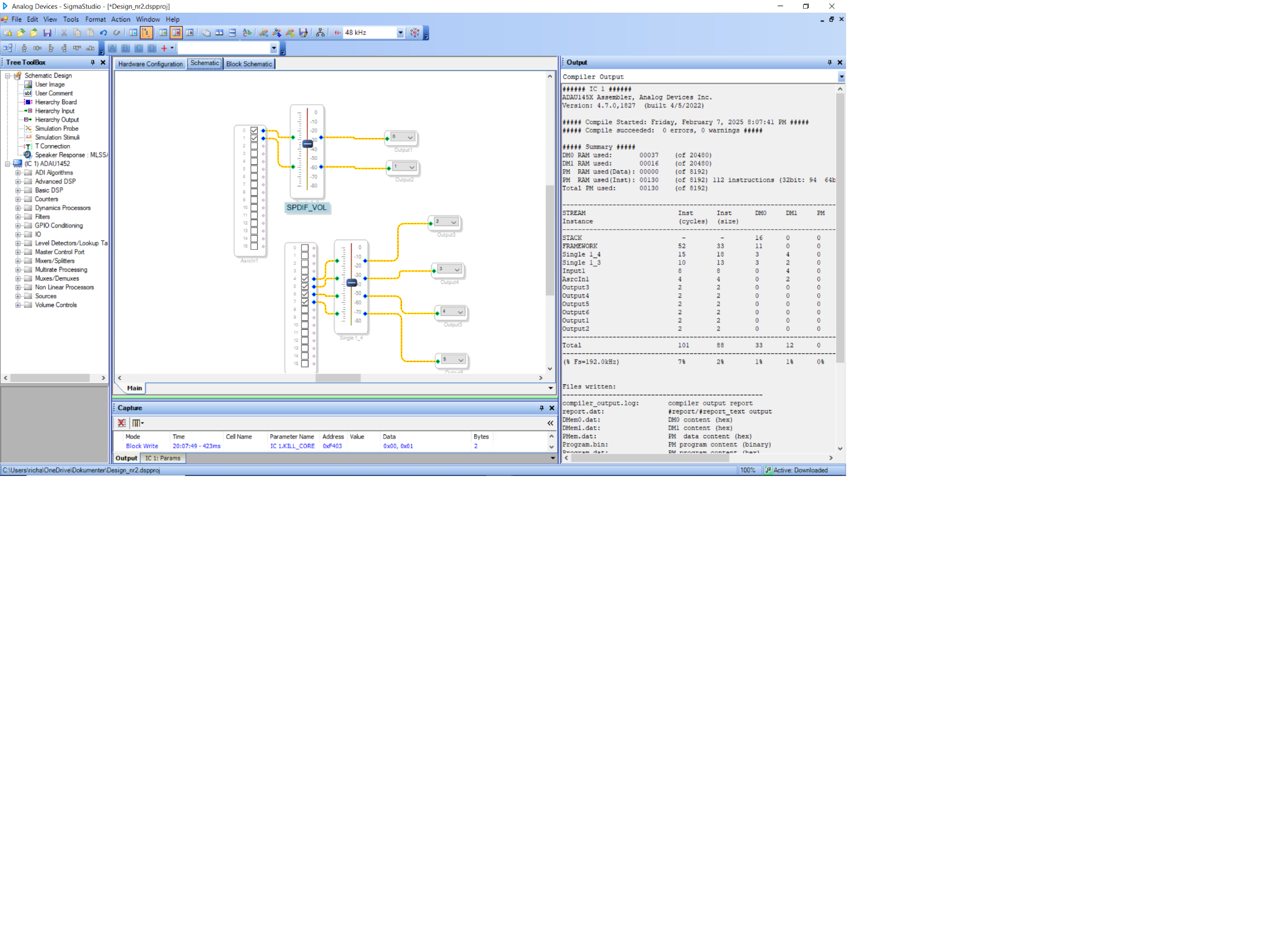

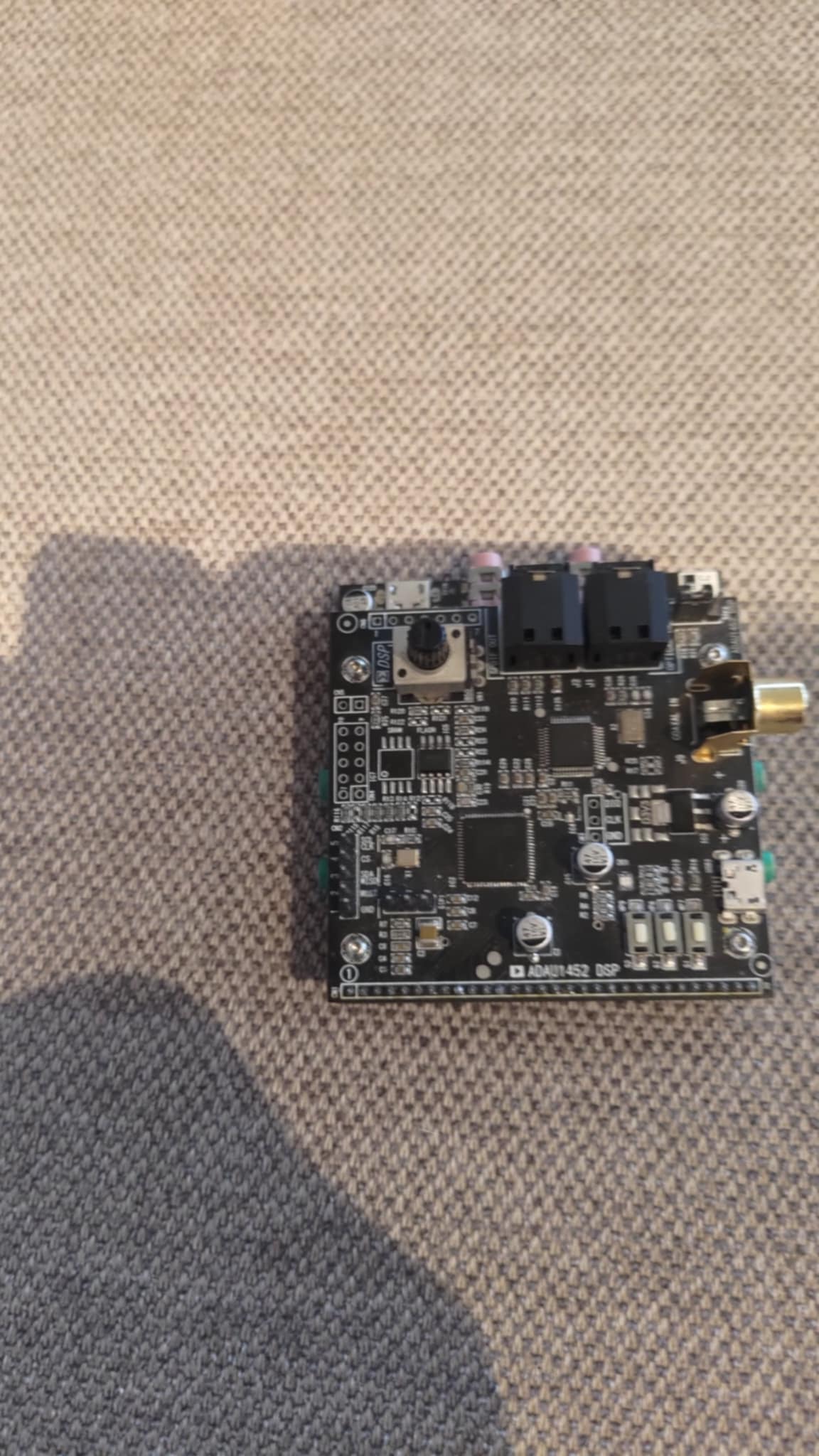

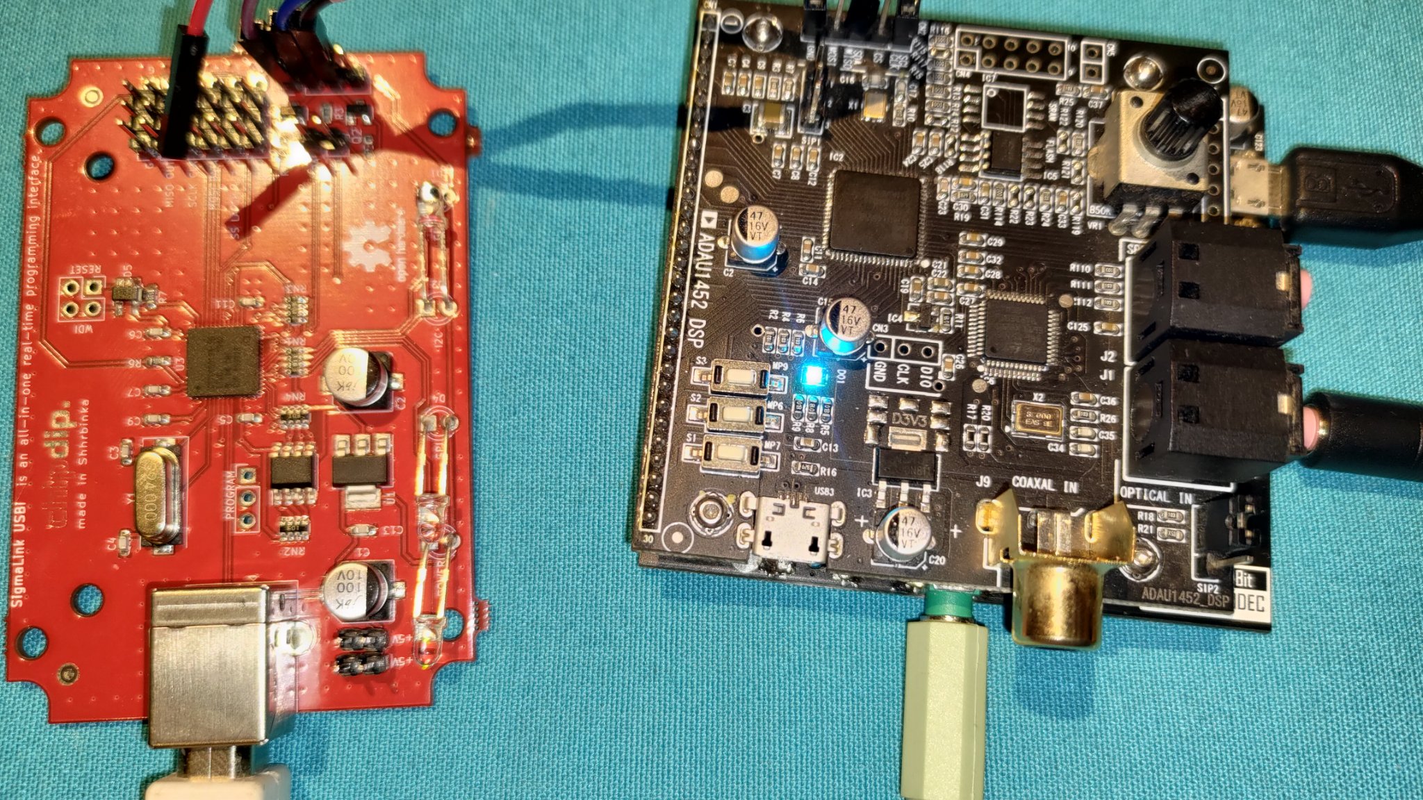

I have now managed to communicate with the ADAU 1452 after installing the driver according to 3e Audio's installation procedure for Windows 10. I have no sound, so I assume there is something wrong with the program. But I have a very flashing LED on the ADAU 1452. I don't really know what I'm doing wrong. Using input 1 and analog output 2/3. Input is an Android mobile phone and output is a Mini USB speaker.

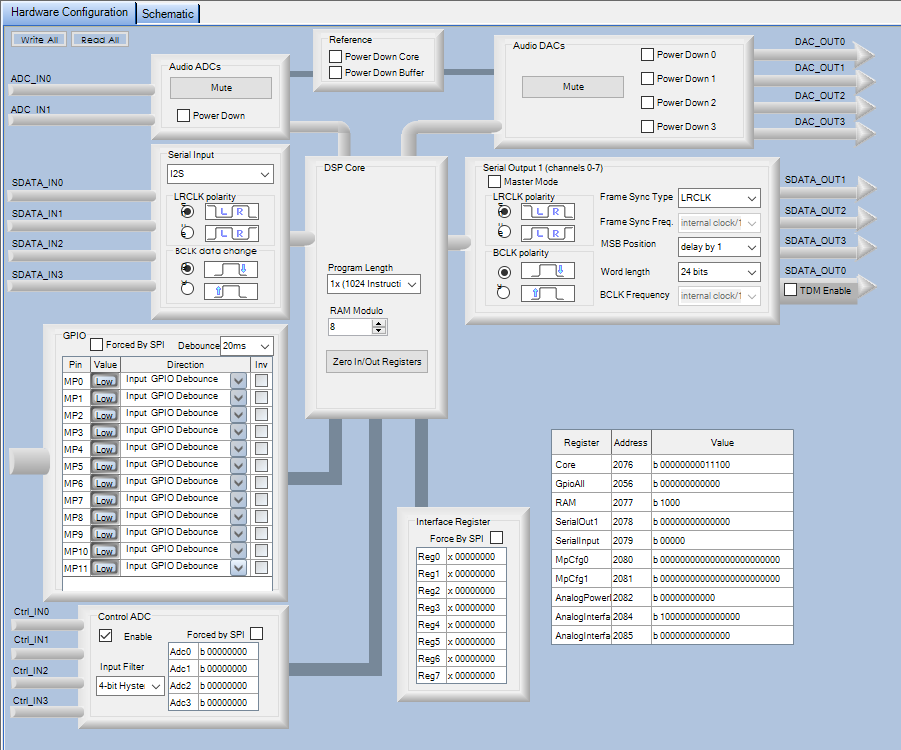

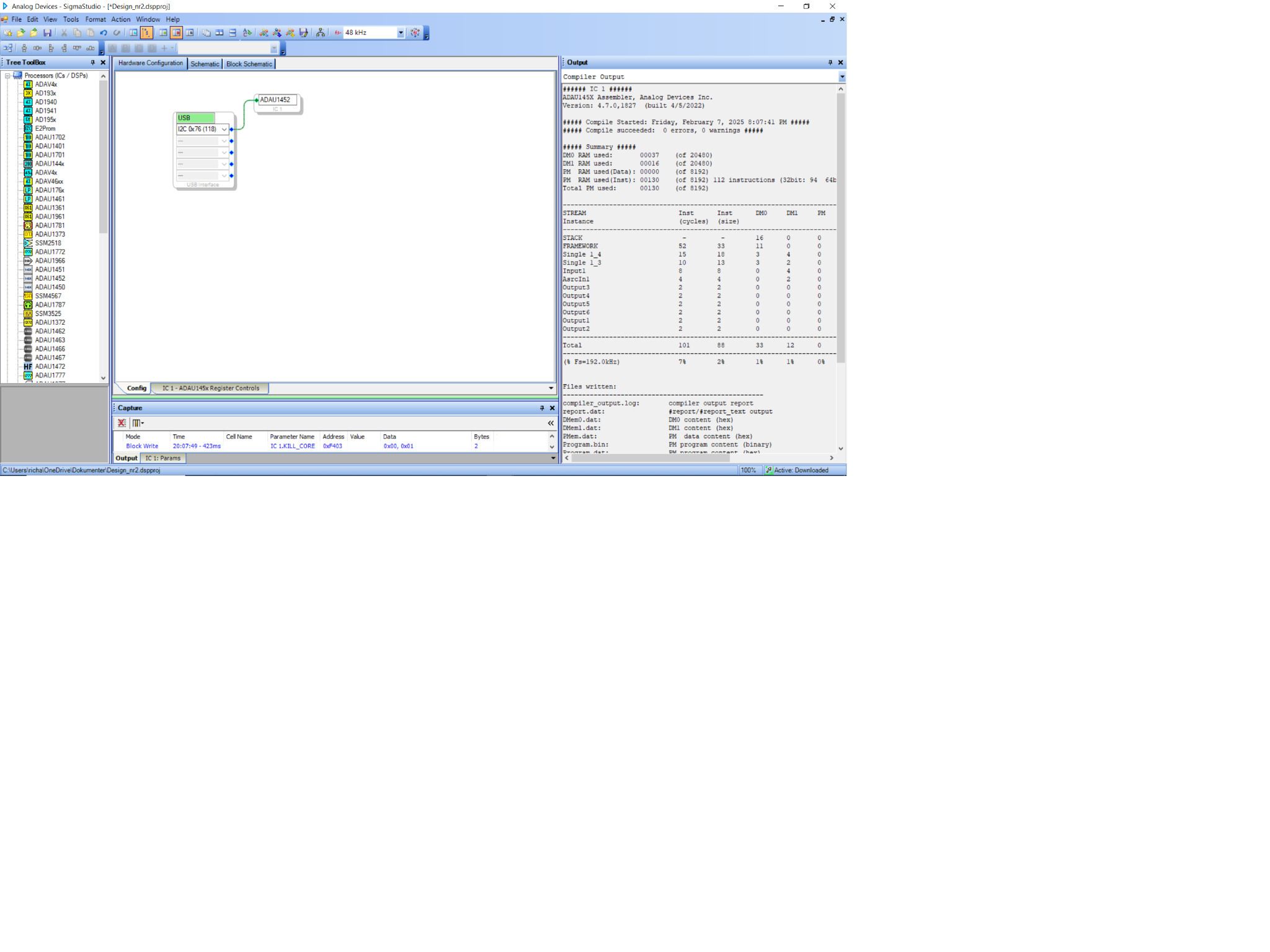

Attaching schematic and hardware config.
You are using digital input?
Input 0 and 1 are for SPDIF input. from 2, 3, 4 and 5 are analog input.

You can use my last project to see if all is correct. There you have automatic switch between SPDiF and analog 3/4, all outputs are used. If SPDiF is valid LED is RED if not LED i's blinking and signal is taken from analog input. There is crossover that you can omit. This project is working properly on my desk. I set 96kHz as AD1938 works better with lower frequencies.I have no sound, so I assume there is something wrong with the program.

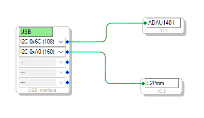

These are the configs:
The board is the cheap green one with the ADAU1401 DSP:
ADDR1 is tied to 3.3V via pull-up resistor, ADDR0 is connected to GND, so the I2C address is 0x6C.

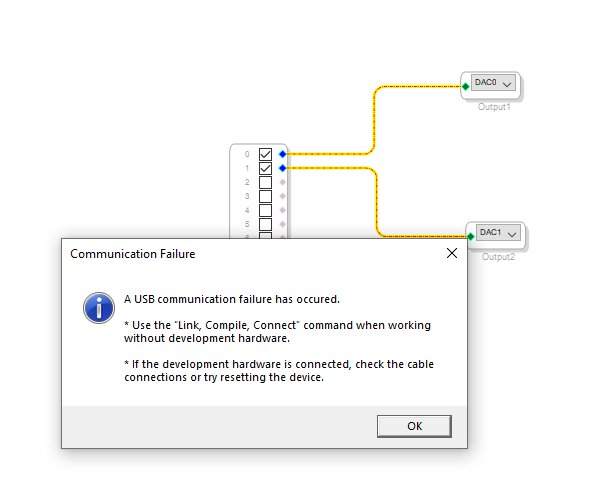

With your drivers I succeeded to install them on the Windows 10 HP desktop machine, but the behaviour is the same as on the Lenovo laptop.
The USB communication error appears when I press the button "Link Compile Download".
The USBi remains in Green all the time.
In the Windows Device Manager the device is present all the time - no reloading of the driver.

- low cost ADAU1452 China board...
