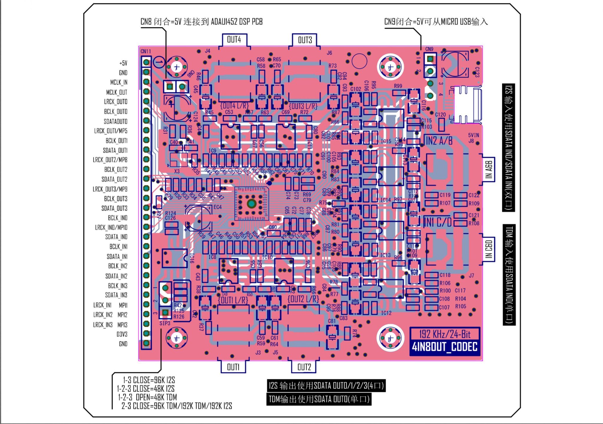

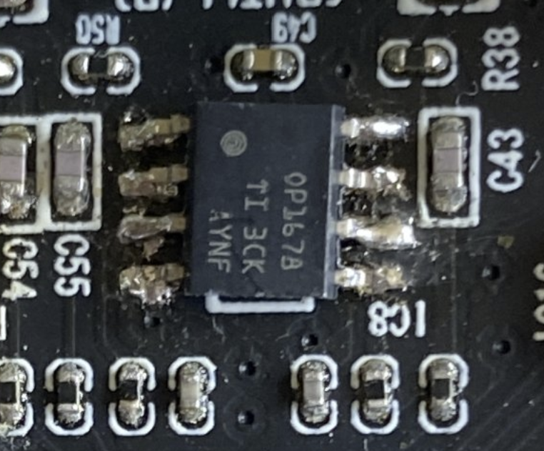

@frobek The split supply for opamps is very interesting. Congrats with very nice measurements!5V rails are connected so you can supply only one board as far as 3V3 rails are also connected together. In my project I split supply lines and built external power supply 2x5V and 3V3, than I obtain quite good distortion level. See below. Measurement made by REW using Motu M2 interface, balanced output and internal (DSP) 1kHz generator. The USBi is essential but you can go the cheap way:
https://www.diyaudio.com/community/...rammer-using-cypress-cy7c68013a-board.269111/

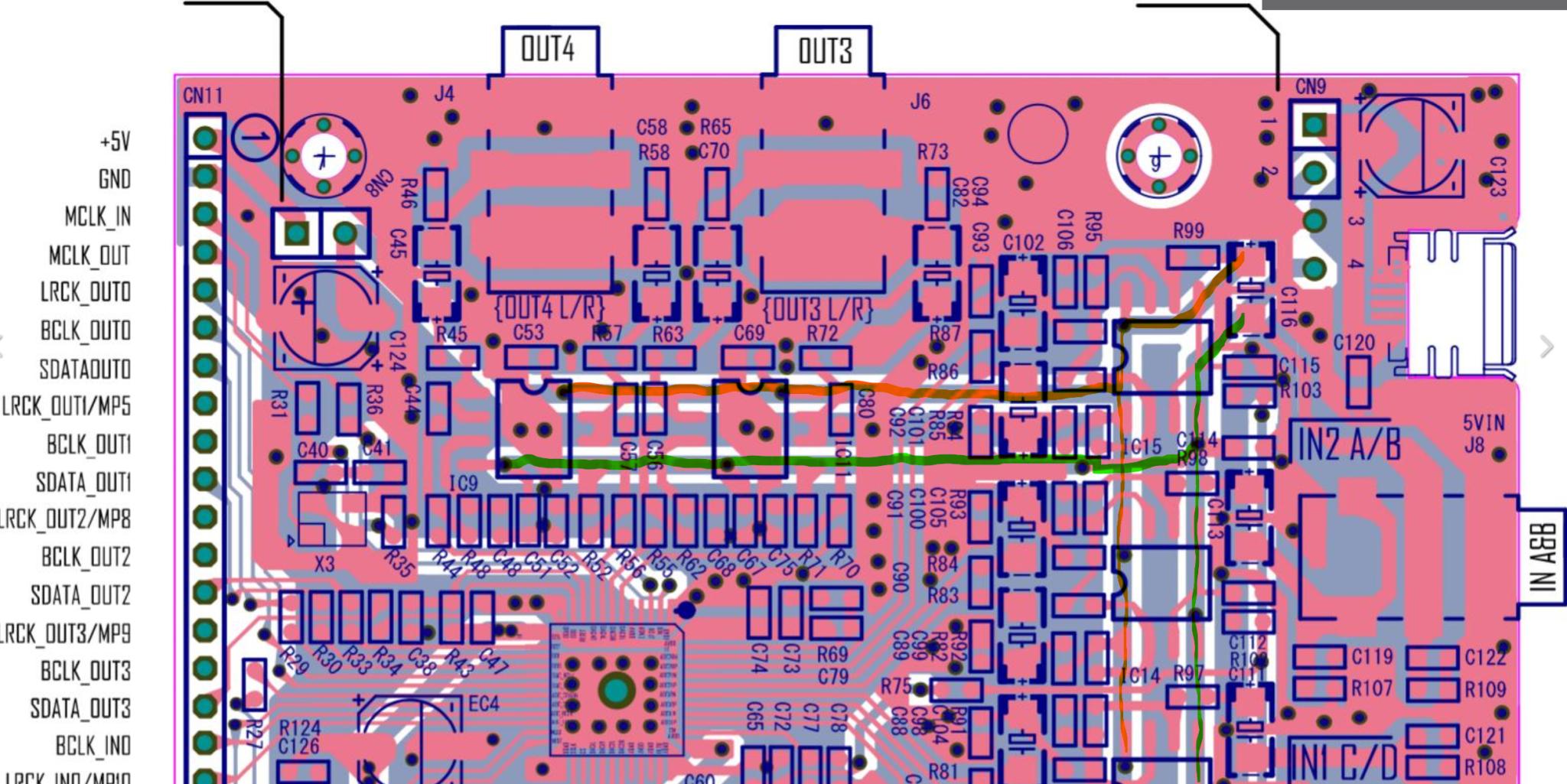

Do you have the oppertunity to explain where you cut the lines so a negative supply could be used?
That is where it is cut so not -V is shorted to ground.
I am interested in using a +-12 Volt analog supply so if you know where to cut the positive lanes it is also very nice to know. (Without shorting +12V to +5V)
Now I undertand your setup.
Misunderstood the 2x5Volt centense. Wishfull thinking it was +/- 5 volts.

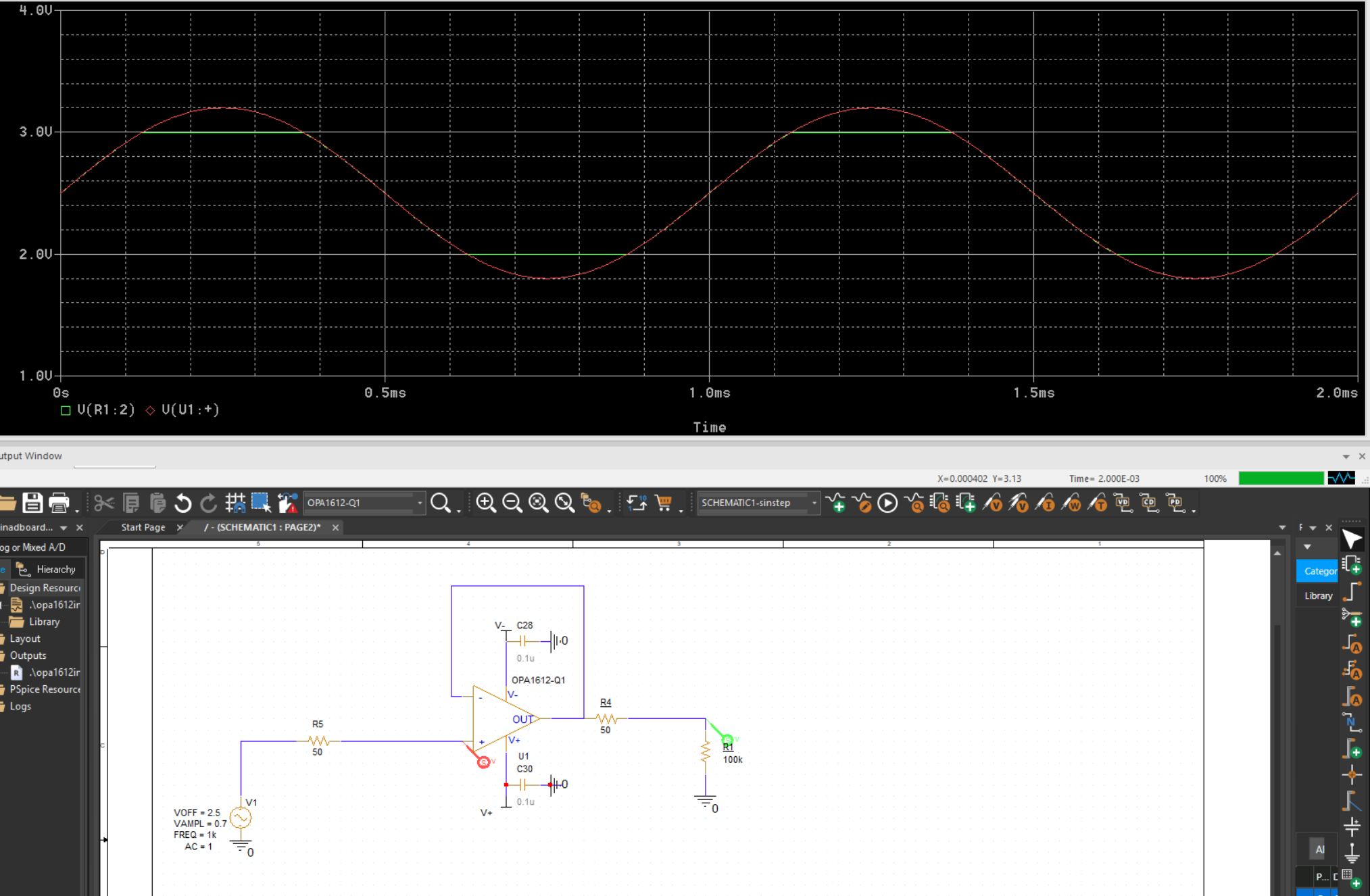

But then it can't be the OPA1612 version of the AD codec board? The OPA1612 don't work at 5 volt single supply? Or is it just the bad/unstable/noisy supply voltage of the unmodded boards?
I have fried my AD codec card with OPA1612, so can not verify, but this is very interesting.
I wonder if your modification of separating DSP card voltage source and codec card voltage source is enough. Will the result be OK by using USB power source on both and just cut the 5v link between the cards?
The strange thing is that the cs codec handles common power. Wonder why the opamps do not without really high distortion

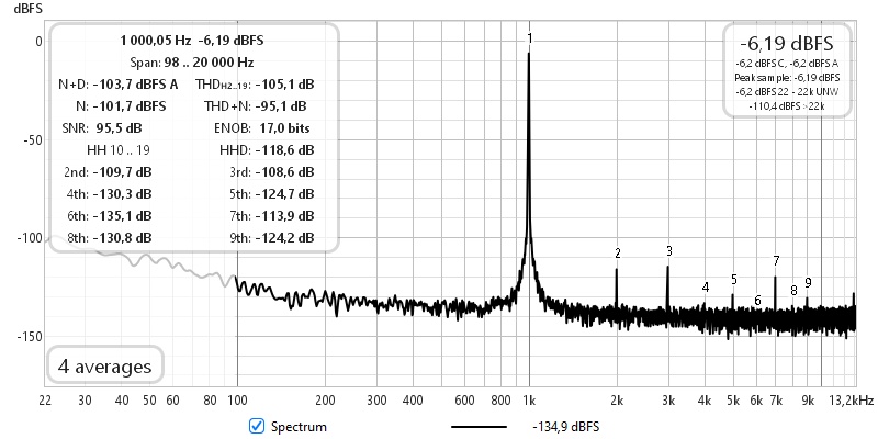

Just for reference, my measurement of a unmodded AD combo https://www.diyaudio.com/community/threads/low-cost-adau1452-china-board.309680/post-7717061
Measurements made before I fried the AD card
Even not modified codec board looks much better then yours, sligtly worse than modified. IMHO your mesasurements looks like damaged or signal is distorted (to high).
I am not the only one that have the «bad board» https://www.diyaudio.com/community/threads/low-cost-adau1452-china-board.309680/post-7808251
we manage to get good signal out of modified boards AD or CS, but not the unmodified ones

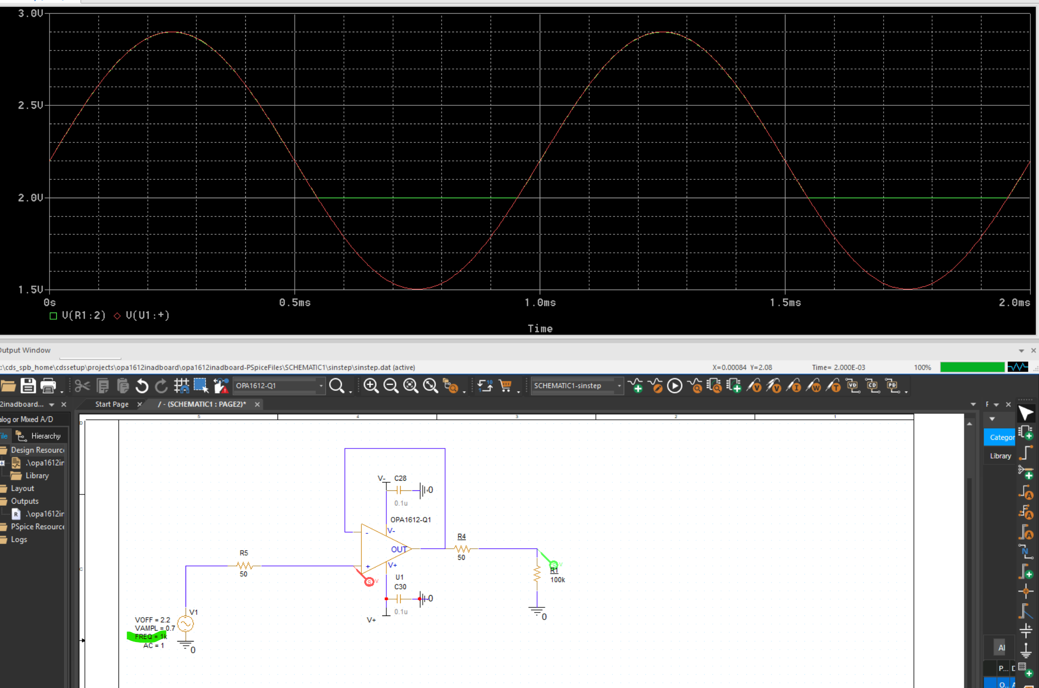

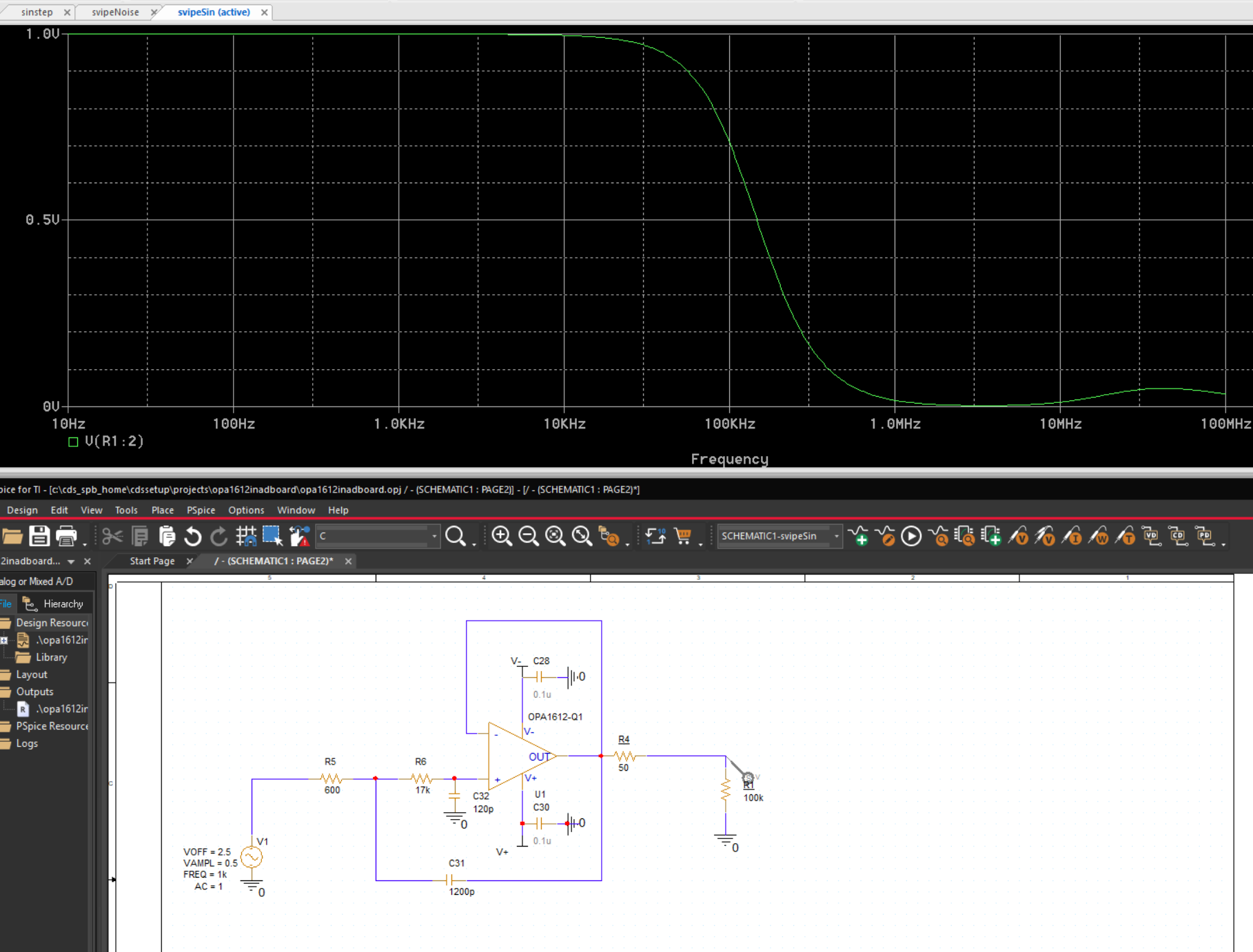

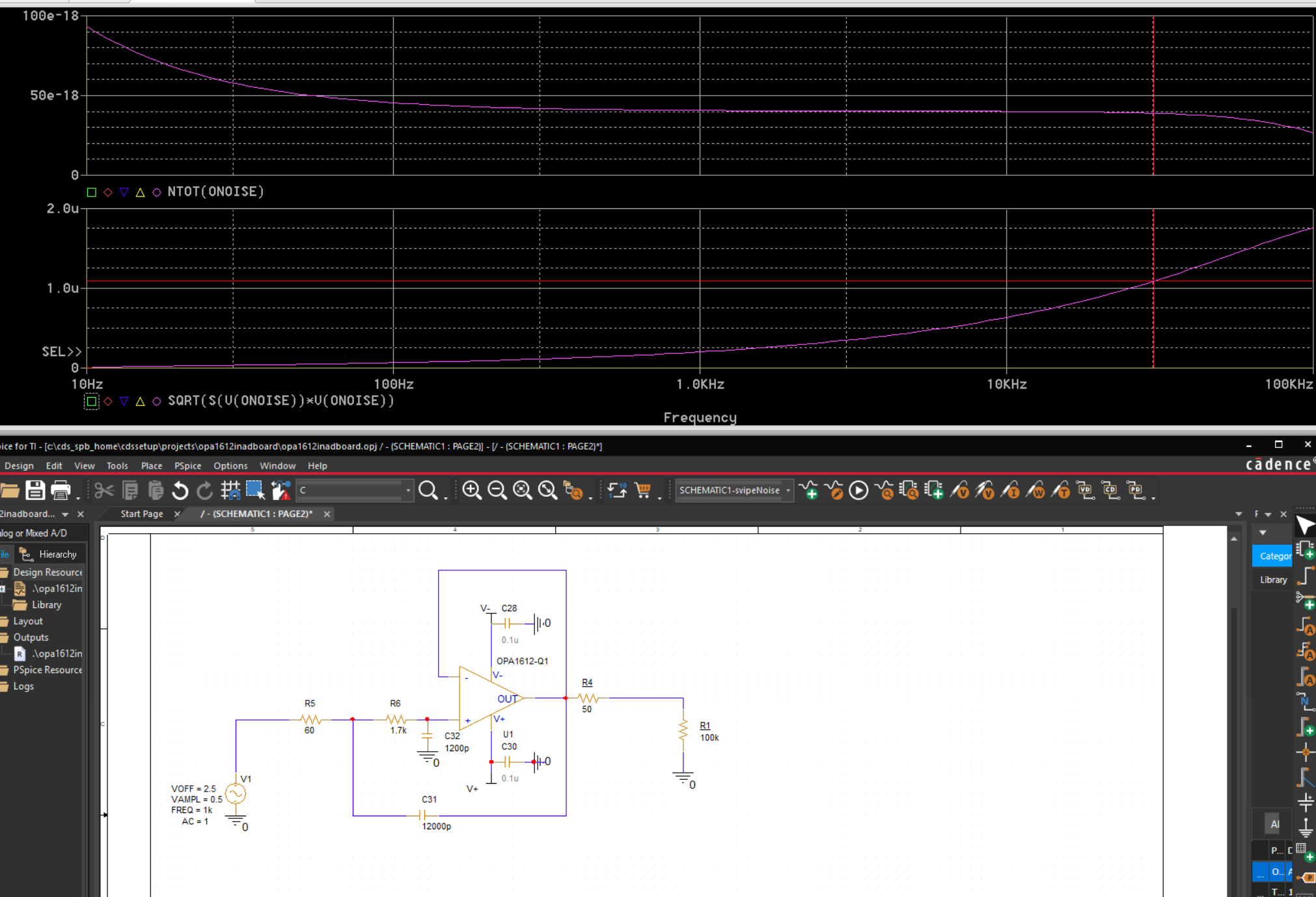

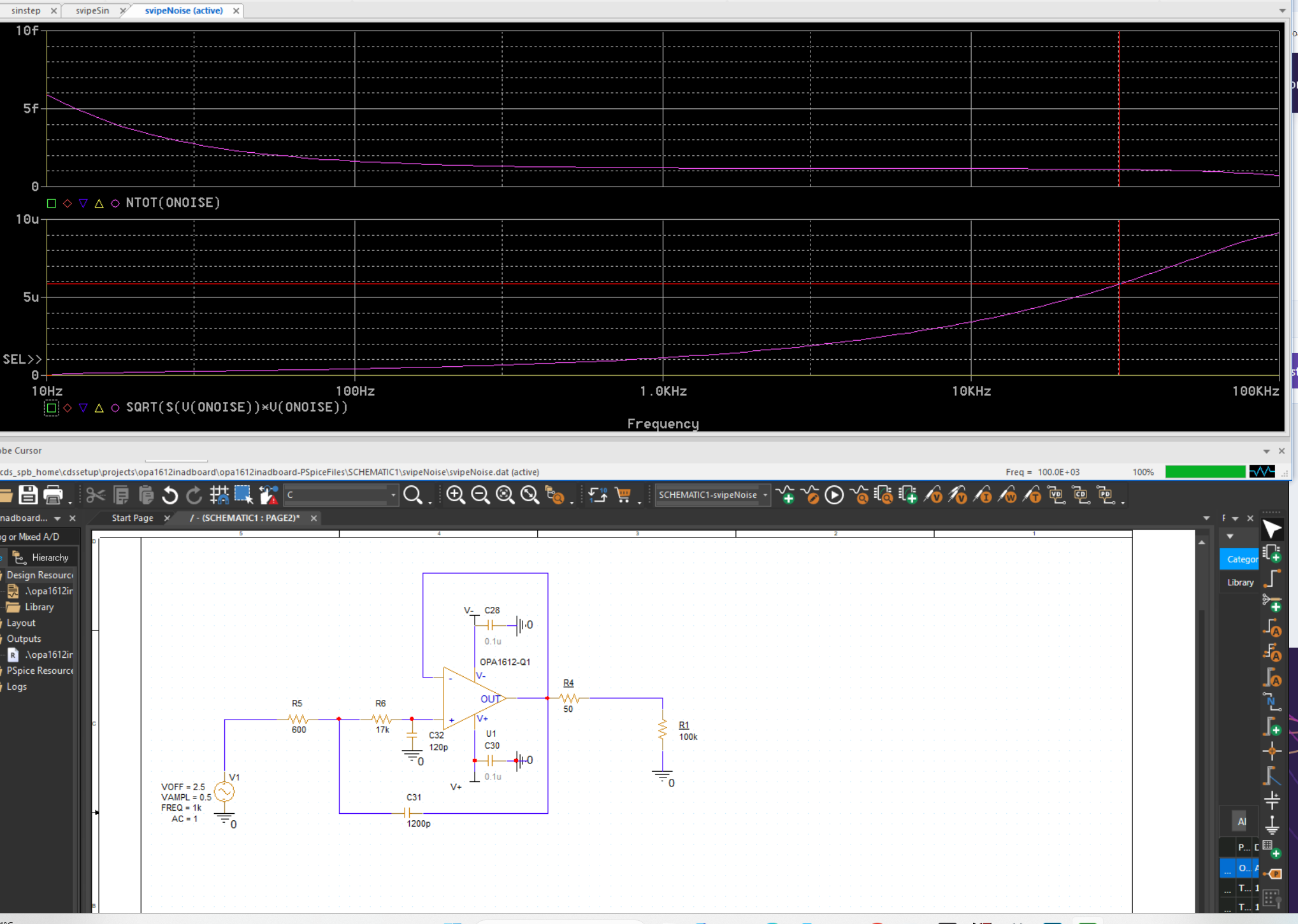

Another thing that is a little clumsy on this board is the OPA1612 with high input impedance. If the enclosed scheme still holds the circuit is like this.
Sallen key LP filter
So really nice filter, but noise way to high for a 1612. Should have 1/10 of the values so the low voltage noise of the device could shine.
Like this.
Guess they just had a surpluss of OPA1612s and used it instead of the original more rail friendly and high impedance ones
Like this.
