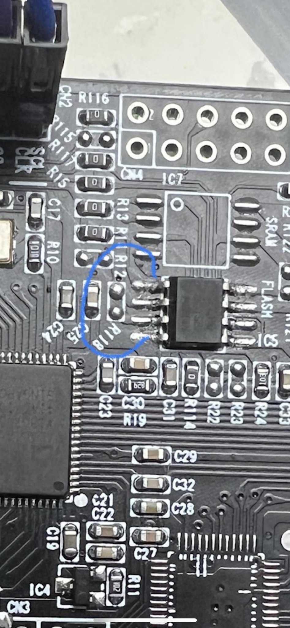

1) I'm not sure if the EEPROM supplied onboard was SPI or I2C because I can not find datasheets for it. However I do know my board was set to use an I2C EEPROM because of the ressitors in use around the EEPROM.
So, I replaced the EEPROM IC with a known I2C device (512bytes).
2) The ADAU1452 datasheet P.52 specifies that it looks for self-boot EEPROM on address 0x50 (7-bit hex). In Sigma Studio on the USBi controls (8-bit) this is 0xA0.
This means on most I2C EEPROMs (incl. the one I used), all 3 of the address pins must be pulled low (grounded). However the PCB in factory configuration had EEPROM Pin 1 connected to ADAU1452 pin 26 'SS_M/MP0' and when running this pin is HIGH 3.3V. This means the EEPROM address is not 0x50/0xA0.
3) The ADAU1452 datasheet P.52 specifies that Pin 26 'SS_M/MP0' must be pulled LOW to define EEPROM as I2C. (Pin 26 HIGH = SPI).
Since ADAU1452 pin 26 is connected to EEPROM Pin 1 I simply pulled EEPROM Pin 1 LOW to ground.
Now it works!
I can program the EEPROM by right clicking the ADAU1452 in the SigmaStudio 'hardware' tab and choosing SelfBoot Memeory > Write latest compilation through DSP. It doesn't seem to matter if the self boot pin is enabled or not.

Hi Tenson, I am also having the same problem you had with getting the program to stick in the e2prom. I am so glad I found your post. I hope it solves the problem. Should I connect what I believe is pin 1(A0) to pin 4(ground) of the flash? I can solder a wire to them if that is what you did. Your help is greatly appreciated on this adau1452 board!

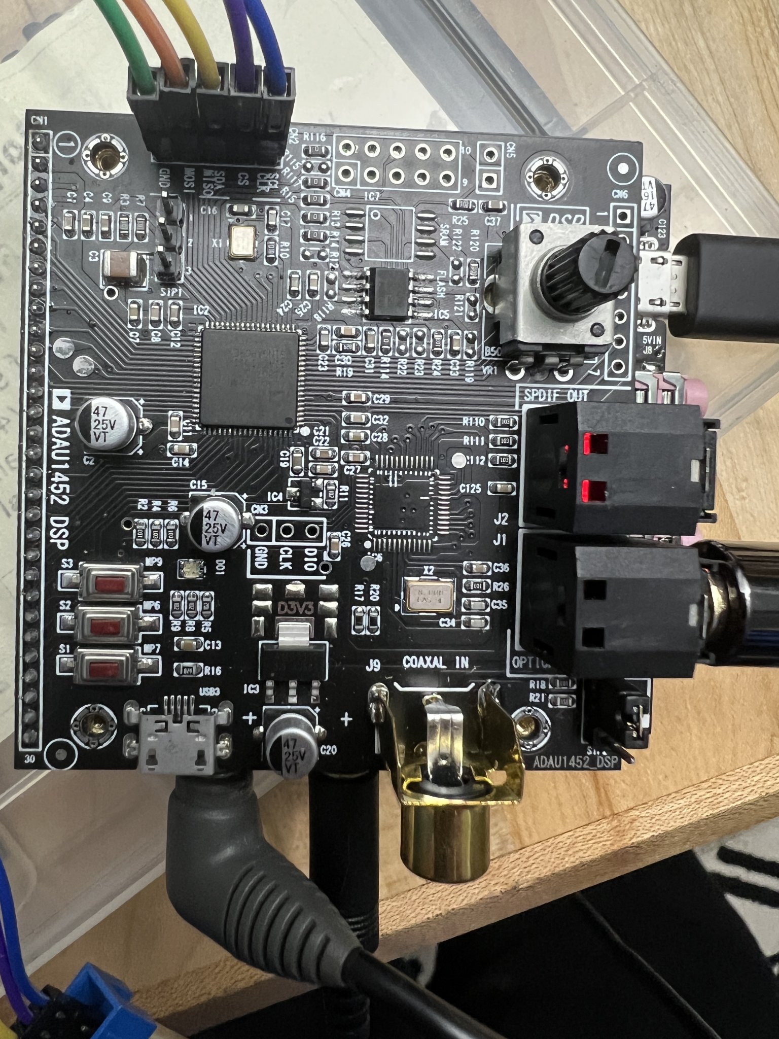

Made some progress on the ADAU1452+AD1938 board. It wasn't easy. If you got one and are very frustrated, you are not alone.
I got a couple of Dayton 1701 boards plus their output daughter boards, and they are a LOT easier to deal with. However, I wasn't very happy with them as I needed them to do a 2IN-4OUT configuration, and after a lot of painful trial and error, I found out the best way (for me) to get a 4 out of these boards is to use 2 of them so I got each do a 1IN- 2OUT. Wasteful, and a mess of cables.
So I got one of these. ADAU1452+AD1938 board and I went from a high level of frustration to an entirely new higher level in no time.
First, I made the mistake of buying one without the USBi interface. Three more weeks of waiting for that to come in from China.
Once the USBi arrived, the fun began.
I'm not a programmer or an engineer, but I think the STM32 is what gets in the way of making this as easy to program as the Dayton/Wonwom one.
The sparse documentation does not help.
But I got this board to work in a 2 IN - 8 OUT configuration consistently. Nothing fancy, but man, I was just about to trash the darn thing moments before I finally heard a sound coming out of it.
So here is what you need to know.

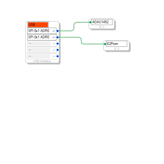

First, the correct procedure to program it from Sigma Studio is as follows:
(this is with the SPI interface. IC did not work for me)
1 Connect the USBi using the SPI connection
2 Power on the unit with the SIP1 jumper set to 1-2
3 From your SIgma Project, press F7 to link/download to test your config
4 If everything checks out, from the Hardware Configuration page, do a "Self Boot Memory > Erase Memory through DSP
(you only need the step above at the beginning to erase the built-in config))
5 If everything checks out from the Hardware Configuration page, now do a "Self Boot Memory > Write Latest Compilation through DSP
6 Power off the unit
7 Power on the unit with the SIP1 jumper set to 2-3

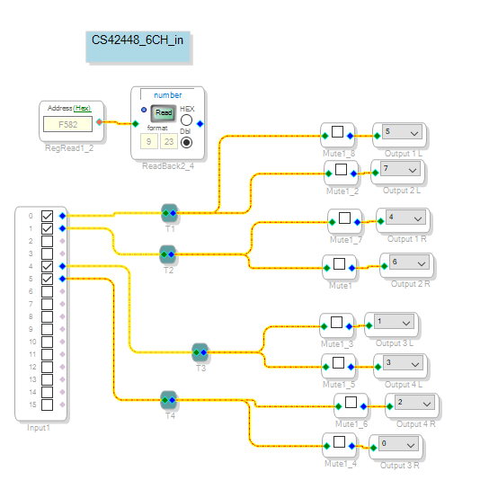

Following the steps above (without the optional step 4), I have been able to consistently configure the board so I could do <sarcasm on> the incredibly sophisticated test to check which input and output correspond to the Sigma input-output <sarcasm off>
Yeah, because the brutal truth of why many people are struggling to get sound off the board is that the inputs and outputs do not correspond to what would be expected, like input one in Sigma Studio corresponding to input one on the board.
On my board, the connection works as follows:
The Board inputs 0 and 1 correspond to 5 and 6 in Sigma Studio,
The Board inputs 5 and 5 correspond to 0 and 1 in Sigma Studio,
What about 3 and 4? I don't know. I don't care. It is messed up. I need 2 in, and I got them, so for me, this is a win.
And what about the outputs? My heart sank when I realized I had to test each to determine which one goes to which.
This is what I got:
Sigma Out # - Board Out #
0 - Jack 3 R
1 - Jack 3 L
2 - Jack 4 R
3 - Jack 4 L
4 - Jack 1 R
5 - Jack 1 L
6 - Jack 2 R
7 - Jack 2 L
It makes total sense, doesn't it?
Here is what my 4 IN - * OUT config works out. Do not ask me what these RegRead and ReadBack do: I have no idea.
I found on the internet a Sigma Studio template that worked for me, and I ain't gonna fix what's not broken, so...
If you know what they do, I'd like to know too. Hehe.
I attached the template projects: use them with extreme caution.
