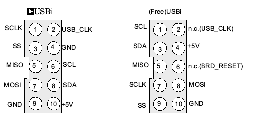

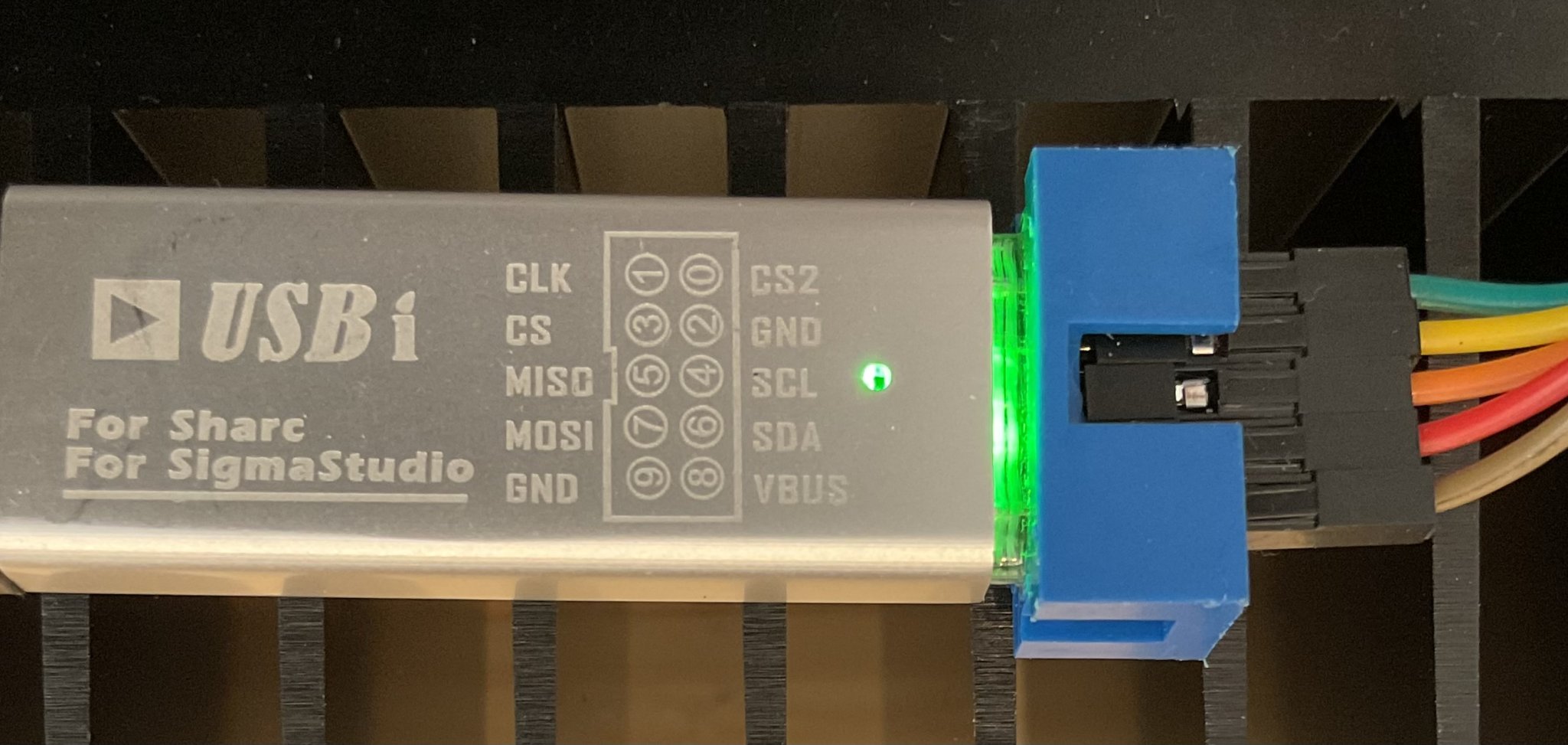

The USBi connection with the ADA1452-AD1938 (aka CS42448) are pretty straightforward.
The documentation I found online matches the labels on both the board and the USBi, however, while both connections seemed to work fine without errors, only the SPI connection ended with a successful in-out config for me.
I didn’t investigate further, cuz ain’t gonna fix what’s not broken, so YMMV.
- Definition of the link mode between USBi and target board (ADAU1452dsp board):
SPI communication mode: 1/3/5/7/9 (CLK/CS/MISO/MOSI/GND) of the USBi terminal of the simulator corresponds to 5/4/3/2/1 of the CN2 of the target board (ADAU1452 dsp board), which is just in order.
I2C communication mode: 2/4/6 (GND/SCL/SDA) of the USBi terminal of the simulator corresponds to 1/5/3 of the CN2 of the target board (ADAU1452 dsp board).

This means a genuine ADI USBi user should change its pinout connections anyway.

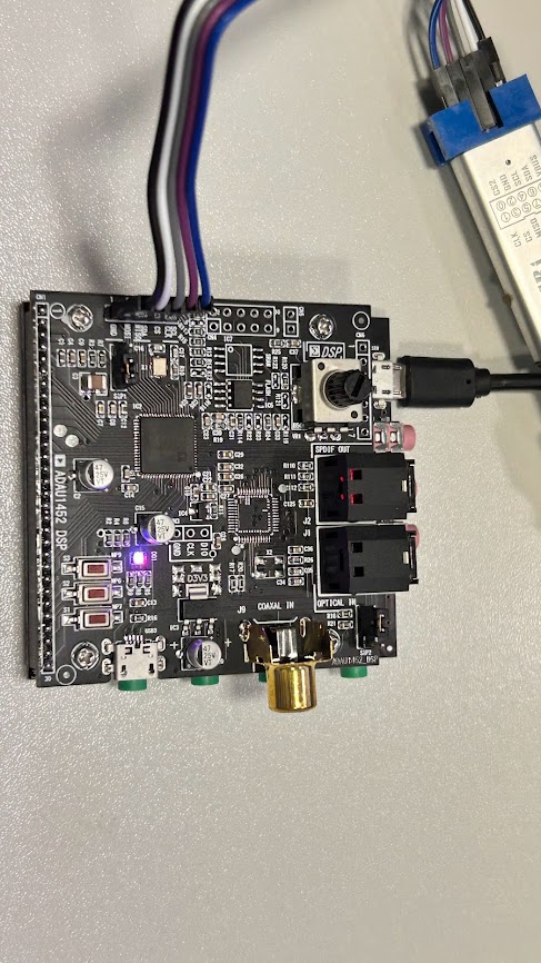

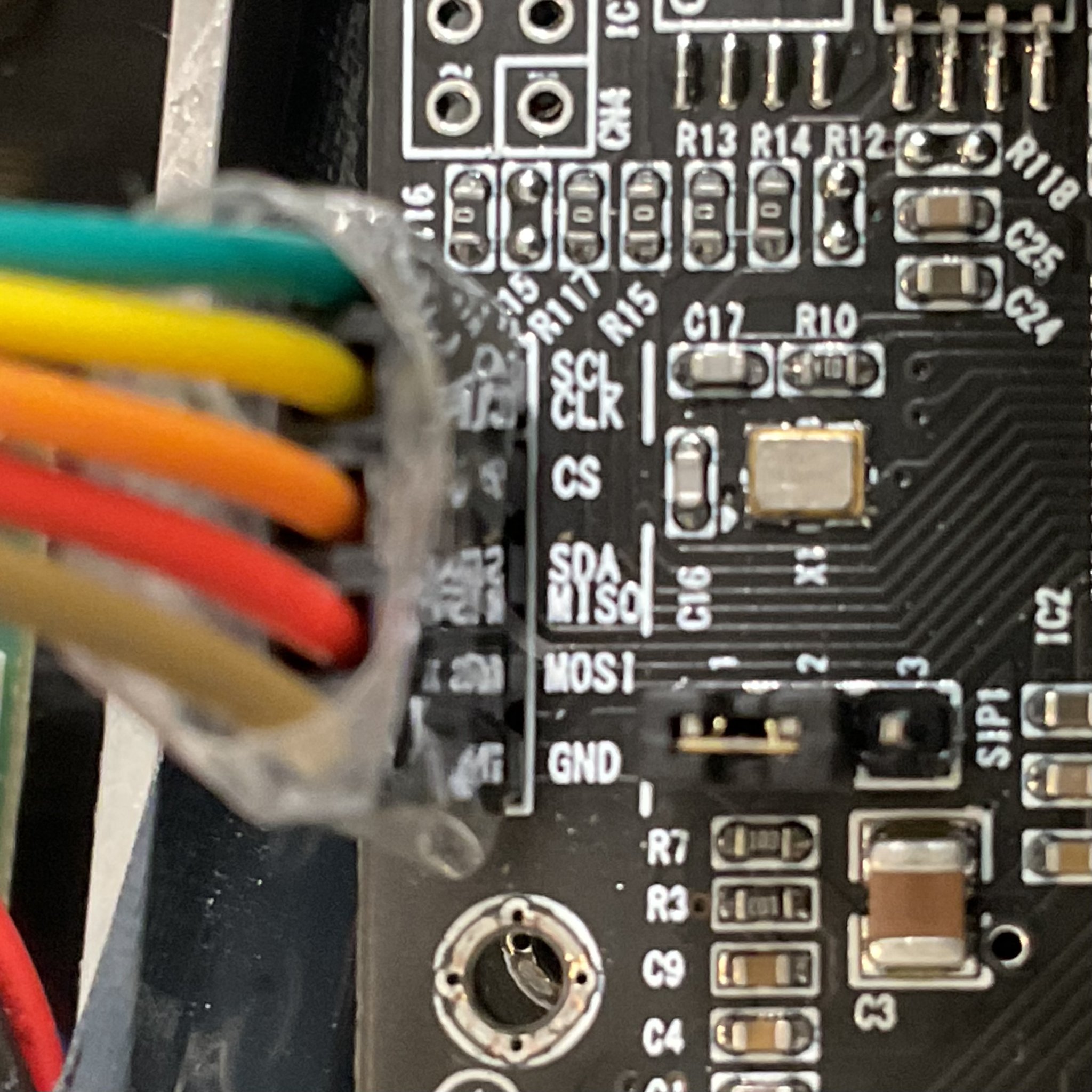

Hm I can't seem to edit the post. I found I had CLK connected to SCLK instead, fixed that but that did not seem to make a difference.
SPI1 to 1-2, power on unit - unit has green/blue steady light. Link/compile/download in Sigmastudio. Not sure what "everything checks out from HW config page" means? The USBi stays green if that matters.
Erase mem, write mem via DSP seems do to something in Sigmastudio but the board does not appear to be affected. (SPI mode 0 or 3 when writing does not seem to make a difference)
Power off the unit, set SIP1 jumper to 2-3, power on unit. Now the unit powers on like when it was new, that is it has a red/purple flashing LED. Pushing MPI7 button seems to switch between programs or modes:
1) (default power on) - blinking red/purple
2) blinking blue/purple
3) blinking green/purple
4) steady purple light < this one passes audio through (but still no Sigmastudio control)

Ok, you succeeded in erasing the board to its default settings: when it is in red/purple blinking mode, that is where it is at.
When the led it's steady blue/green, it means it is with the SP1 in the 1-2 position and ready to be programmed.
Now you need to download your program on it: it seems you are missing step #5 in my procedure.

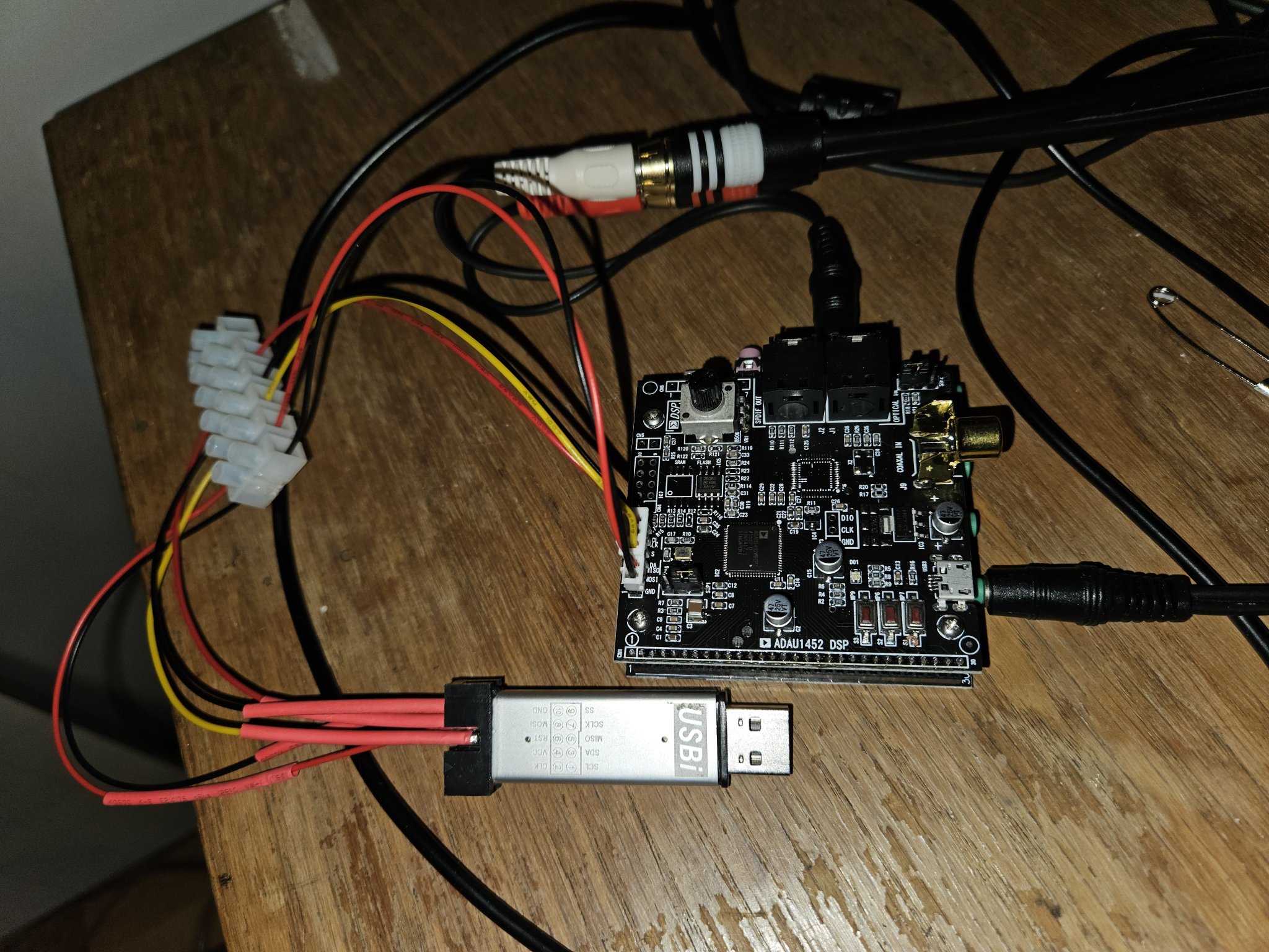

I tried your project file 1452_cs42448192i2s_Test_v3.dspproj and also 1452_cs42448192i2s.dspproj
Then I made follwing steps :
1. SPI1 in 1-2 position
2. F7 to compile, then step 5 (download via DSP)
3. Turn off board, change SPI1 to 2-3 position

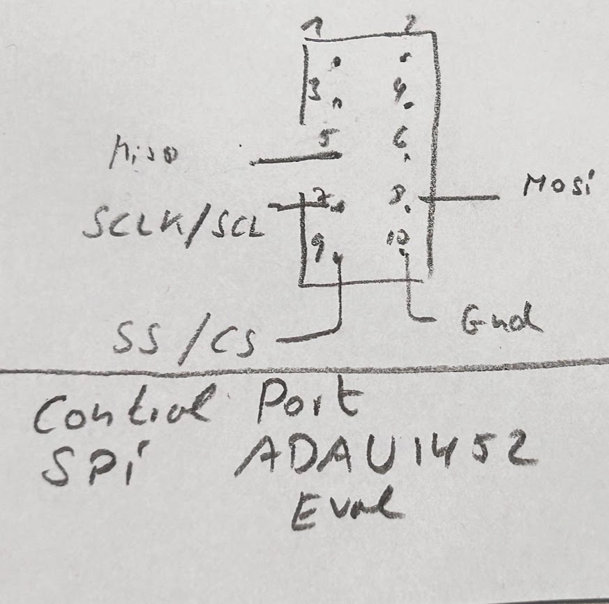

I connected the delivered USBi Stick to a standard ADAU1452Eval ( see drawing ) and I had successful control with SigmaStudio
