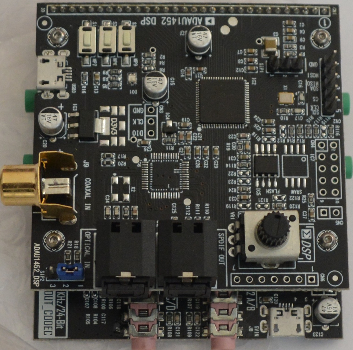

Well there is a poor, single AMS117-33 powering everything: ADAU1452, AD1938, STM32F103 and all other analog chips. The ADAU1452 alone can use more than 500mA, the AD1938 is ~200mA when fully powered, it's unclear how much the STM32 is using, let's say 50mA. Just just these 3 chips, we can use 750mA, out of an AMS117 that is rated for 800mA. Touch the AMS117 when running, and you'll see how hot it gets. Other chips get pretty hot, too, and there isn't a lot of air circulation or heat sinks on the board/copper planes
Pretty much everything on the Lusya board is operating outside of specs. It's very cheap and easily available, but not exactly a well designed board.
As a test, you can try disconnecting the AD1938 board and use only the ADAU1452. If yo don't have problems in that case, your root cause is the AMS117 being maxed out. If you still have problems, it's very likely not a power/heat issue
Hmm, AMS chip isn't particularly warm to the touch but I have discovered that I can still read signal levels and such from the 1452 so it looks like an issue with the codec board.
It certainly looks like a heat issue given the failure pattern.

Edit: Yep... Blew some air in between the PCBs and we're stable again. Looks like the CODEC board s overheating

- Removed jumper from Codec board for 48khz mode, 192khz causes it to overheat and shutdown.

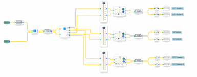

96kHz crossover
After having realized that the max core frequency for this board+codec is 96kHz, I started creating a skeleton project to be used in the future. And I thought that other people might benefit from it, since this is basically the highest quality we can get out of the board.
First of all, you need to set the SIP3 jumper on the AD1938 codec board to 96kHz, i.e. connect together pins 1 and 3. I'm using a thin solid wire, wrapped like the old wire wrap around the pins. Probably the safest option is to solder 1 and 3 together from the bottom, with a thin insulated wire.
That sets the board to use TDM for both ADCs and DACs. The project uses inputs 0-3, with 0-1 being L+R for input 1 on the codec board, 3 and 4 are L+R for input 2. The AD1938 is sending all 4 ADC channels in TDM format to serial port in 0.
For output, the 4 DACs in the AD1938 are fed from serial port out0, TDM format 8 channels. 0-1 are L+R for the jack marked out1, 2-3 for out2, 4-5 for out3 and finally 6-7 for out4.
In addition, I enabled the SPDIF input, thru an ASRC, and mapped to inputs 0-1 on the digital input block. Then 2 separate I2S inputs, which I mapped to serial in2 and serial in3. I don't use serial in1, because there are already enough inputs. But would be easy to add. All I2S inputs also go thru the ASRC, and are mapped to 2-3 for I2S 2 and 4-5 for I2S 3.
To connect an USB to I2S interface to, for example, I2S 3, connect the bclk output from the USB interface to BCLK_IN3, lrclk (or fsclk for the Amanero board) to LRCK_IN3 and finally the data line to SDATA_IN3. Also set the USB interface to 96kHz as well, even if the ASRC should be able to handle any other rate. A side effect of the board design, is that the LEDs will light with the I2S signals. I plan to address this in a future post (requires soldering on the board, though)

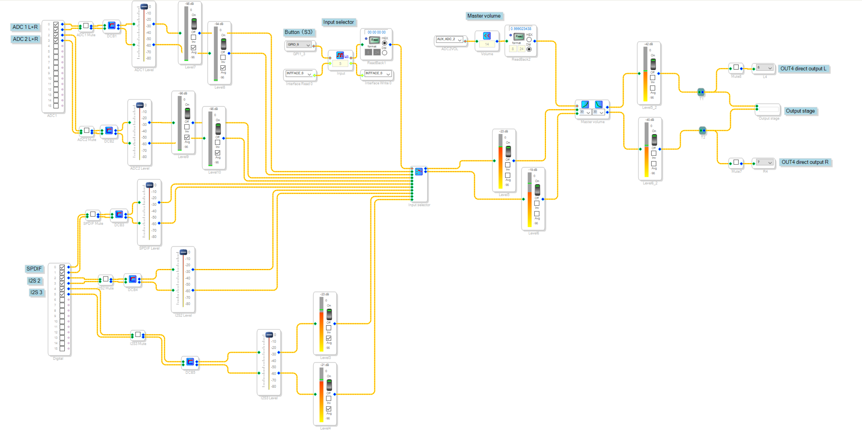

I put a mute control on each input, so that any unused input can be muted. I also put a DC blocker on every input because I noticed that without it, the level meters would otherwise see a signal on unused inputs. I don't think that a DC filter will cause problems, and it's an extra safety to protect the speakers connected to the board. And each input has its own input level control, to ensure all signals have the same level
Then there is an input selector that uses the button S3 to select the input. And the potentiometer on the board is used to control a master volume Since this is a learning project, I added a couple of read backs to see what values are selected by S3 and the potentiometer. I also added a ton of level indicators to be able to visually follow the signal, for the times I don't want to have any amplifier connected to the outputs.
For the outputs, I decided to have out4 as the "raw" output, no crossover. Each output can also be individually muted. I put the actual crossover on a separate tab, to keep the project visually clean. First there is a Parametric Equalizer to correct the signal, then a 3 way crossover. The outputs of the crossover feed into a separate level control for each of the 3 signals, then a delay to time align the speakers, and finally the individual outputs, each with a mute control
Since, once again, it's a learning tool for me, I added a stimulus and 4 separate probes to see how the signals change with the changing of parameters.
Lastly I tried to optimize the ADAU1452 for power consumption, more than anything to keep it cooler. In the Power Clocking tab of the ADAU1452 register controls, I disabled power for the unused serial ports (in and out). I also disabled SPDIF out, since I don't plan to use it. I'm not really sure how much it helps. but there's no harm in doing it and potentially an upside

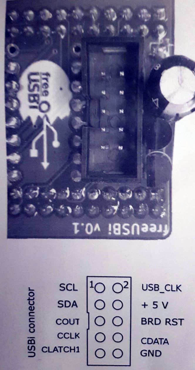

1. Interface with SigmaStudio? I have a FreeUSBi+EZ-USB V.0.2, but I'm not sure if it works with this board

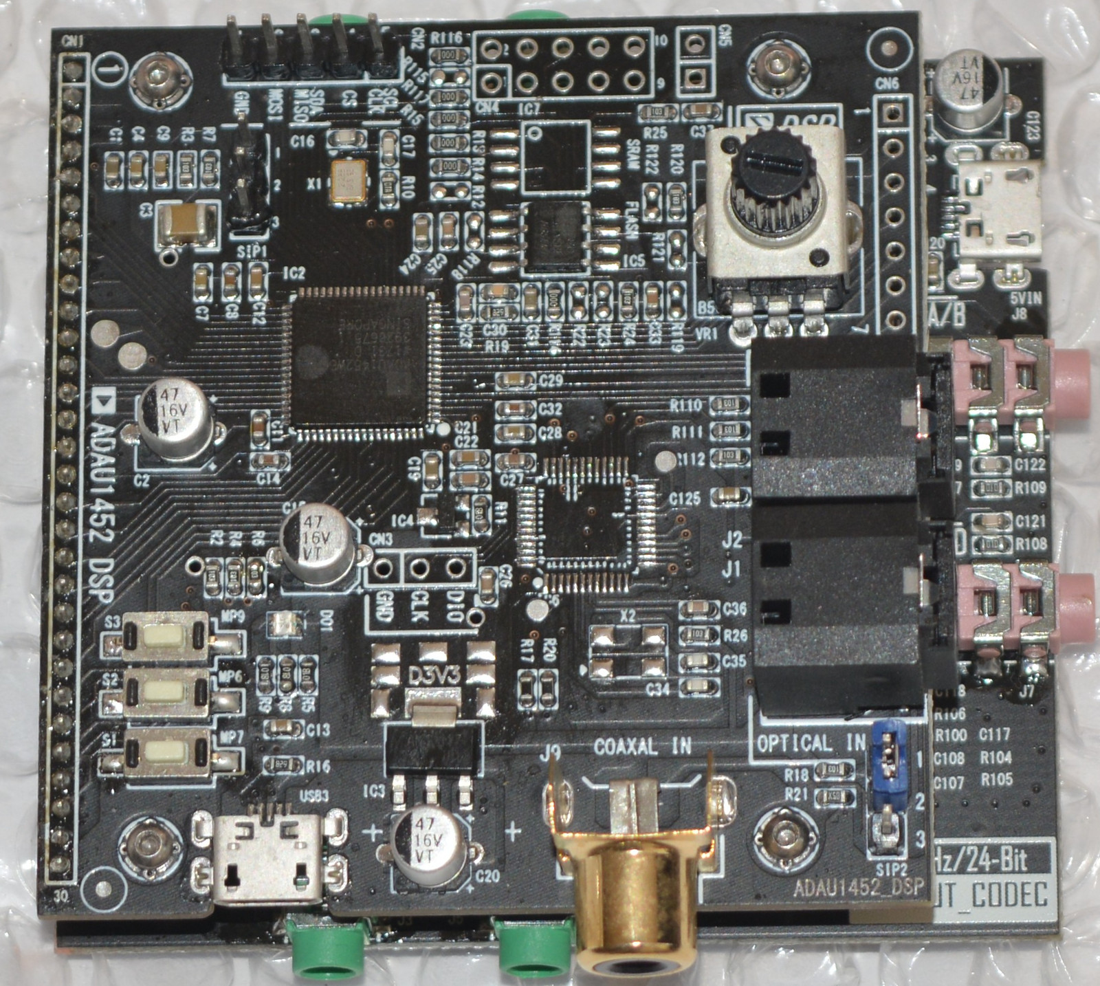

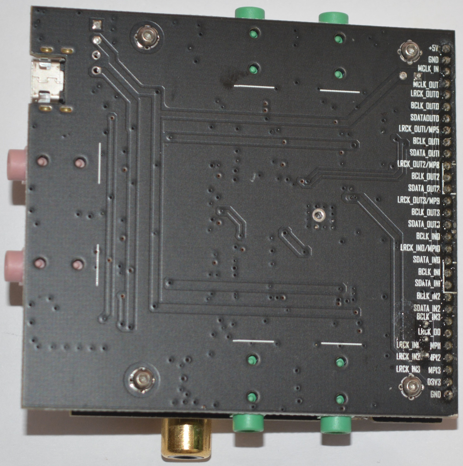

Thus far, I've only taken the DSP/Codec out of the packaging to take the pics attached.
I just now noticed that the STM32F103 seem to have been removed. I don't know if that is the case with all these boards?

I've read of multiple ways to connect to the various boards discussed in this thread, I am wondering which is the correct way to connect the freeUSBi to the ADAU1452 board (the version without the STM32F103 microcontroller)? I have pictures of my board attached in the post above.
In essence; what pins from the freeUSBi to connect to what pins on the DSP board?
Different boards have different resistor configurations (you can see it from the schematic), so it really depends on your board.
The best way to find if you need SPI or I2C (the only 2 ways to connect), is to follow the ADAU board USBi connector with a multimeter in low ohm mode (or, if it has the function, the continuity beeper). Find which USBi pins are connected to the I2C or SPI pins on the ADAU chip, and you'll know if I2C or SPI work
Alternatively, just try first one (SPI or I2C) then the other. There's no risk of damage as long as you use a working USBi adapter
SDA SCL GRND
With only that 3 pings I program my ADAU1452 with my USBi
As I've read in this thread, i2c for the ADAU1452 and spi for eeprom (via DSP)?
I only use I2C without a problem.
