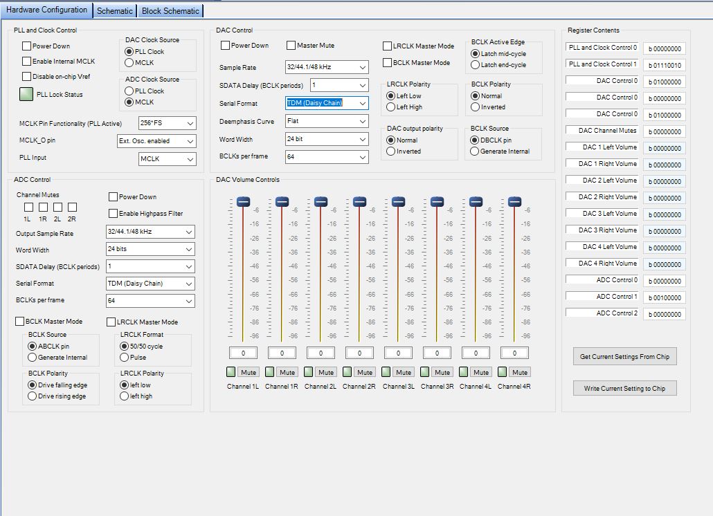

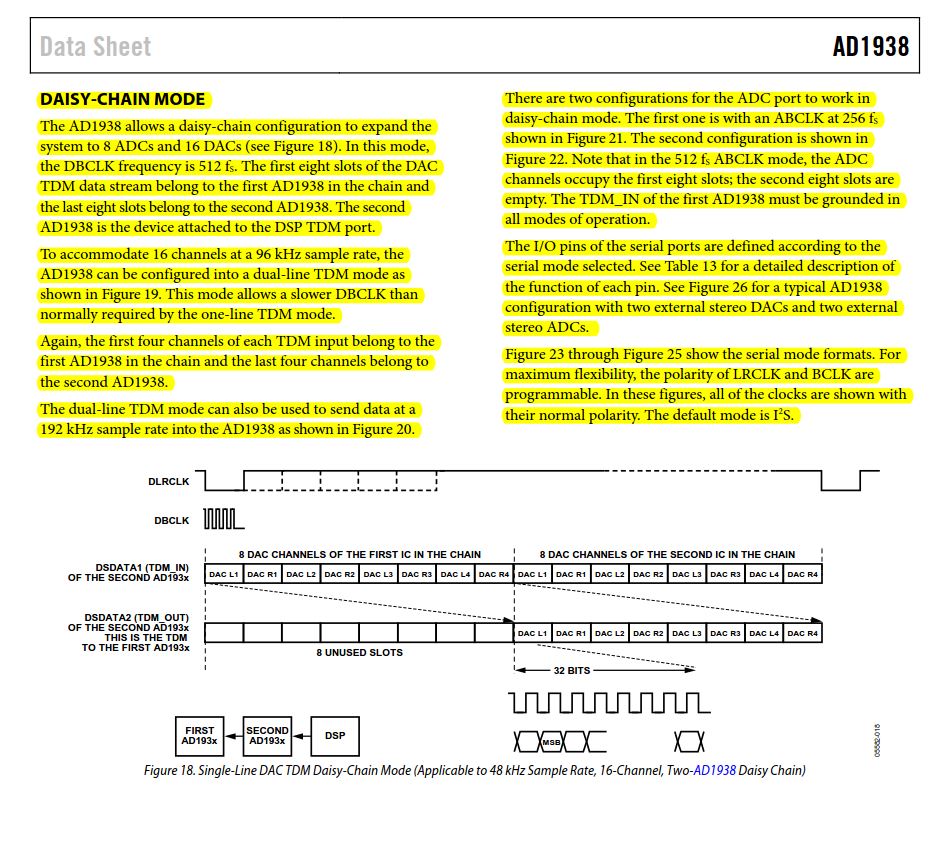

Does anyone tried to daisy chain the AD1938 CODEC that comes with the ADAU1452 to get 8 channel input and 16 channel output?
It requieres TDM connection between DSP and CODEC
The register controls of the AD1938 contemplate an specific option for the daisy chain connection, but I could not find any option in the DSP's register control to enable TDM comunication in the Serial Output Ports, only can select the TDM mode, which in this case should be 8 channels and only use two serial outputs.

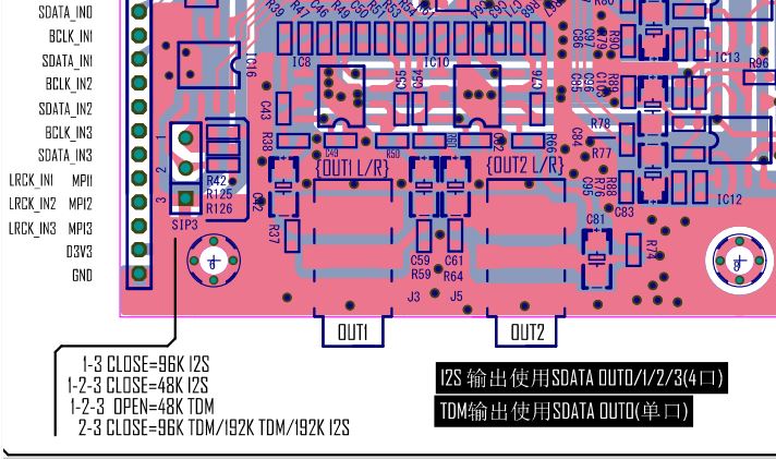

UPDATE:
Here is a diagram of the CODEC that shows the required pinout for TDM.
Google Translate:
I2S output uses "SDATA out" 0/1/2/3 (4 ports)
TDM output uses "SDATA out" 0 (single port)

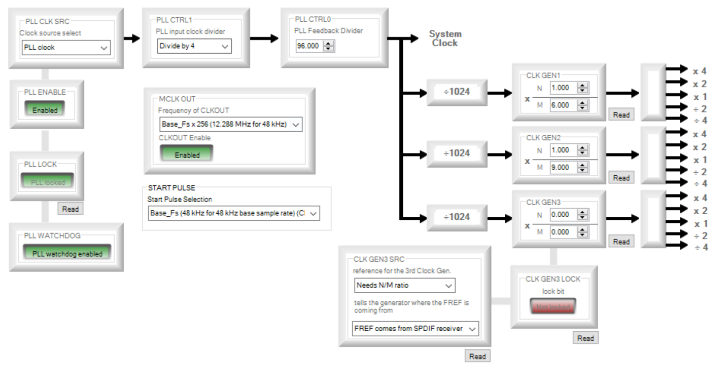

I made a adapter board where I place a Toslink GP1FA550RZ for Input and a Toslink PLT133/T8 for output. The output should only be a copy from the input to send the signal to the next speaker (Toslink input). Input and output are connected to the spidf Pins from the DSP
The DSP should be use in a 3 way loudspeaker as a crossover.
The problem is that I did not get the Toslink signal correct in the DSP.
First I connected direct the output from the TosLink GP1FA550RZ receiver to the DSP input, then I provided there an ac coupling capacitor on the input pin of the DSP. I reduce the input voltage from 3V to 1.5V.
The output over the PLT133/T8 is also not working.
The test I made to check that the DSP is working is to switch on an of the on-board LED from the board with Sigma studio.
Attached the sigamstudio program.
Do anybody have an idea what I did wrong?
Thank's
I'm no expert but hopefully the following helps...
Your clock setup looks wrong, assuming you're not providing an external clock. See my screenshot attached.
I found it helps to test your outputs with an oscillator block before getting the inputs involved, one thing at a time.
Also check ASRC tab to see if you're getting a lock, and the SPDIF tab.
Is the word length correct? Mine is 24 bit

Hello
@xplo5iv first of all I want to say a Big Thank You for your help!!!
the DSP is receiving and sending Data over Toslink.
As you expect to problem was the clock setup.
I never looked in the clock settings because I followed the instructions in the "EVAL-ADAU1452REVBZ User Guide" side 11.
