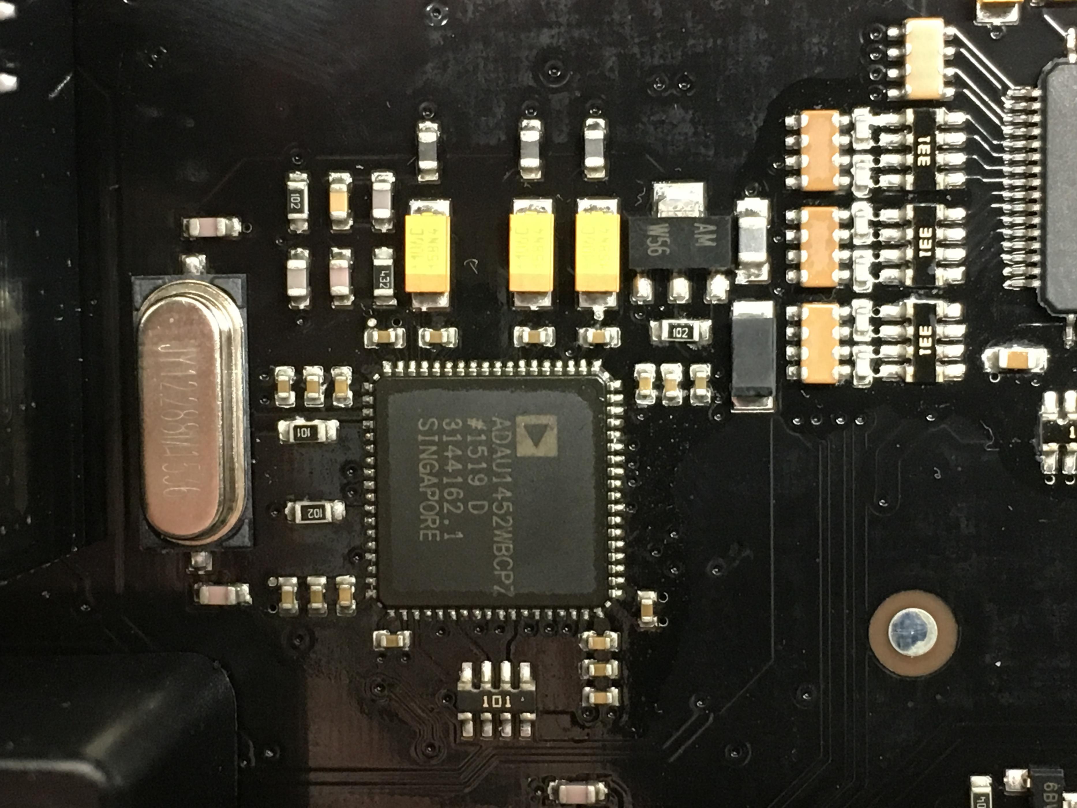

I have a 1452 implemented into a $$$ car amplifier/dsp. It has multiple spdif in and out, time alignment, etc... I wonder if it is possible to pull the program off of it? It has a custom laptop program, but i know that it programs the dsp on the fly from an atmega controller if you make changes. I think you can save configurations too.
Mayday: maybe some inspiration for you?
Unfortunately it is mounted in my car and I can’t get pics of it. But it is Helix P Six DSP mk2 HELIX P SIX DSP MK2 | Audiotec Fischer

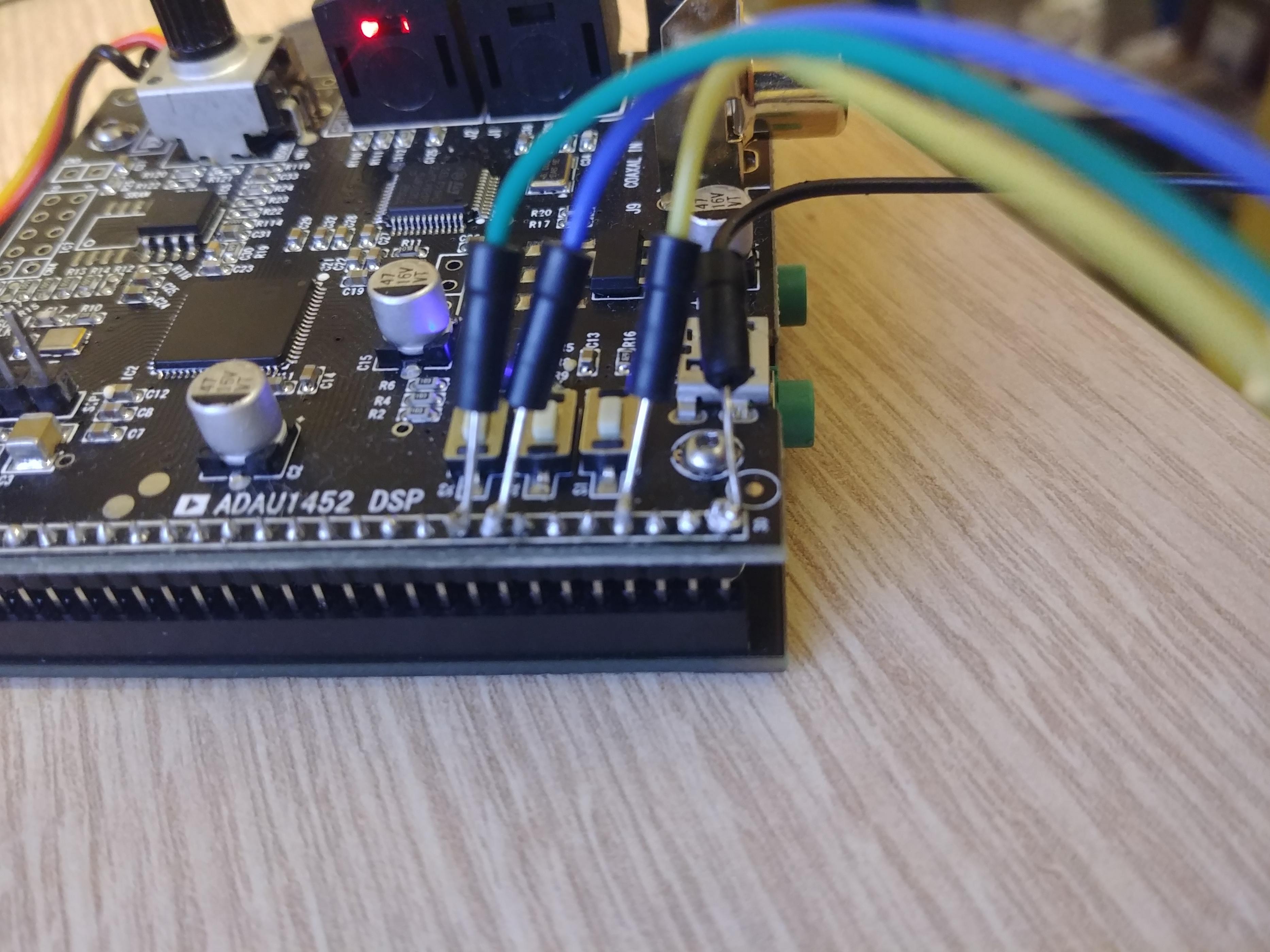

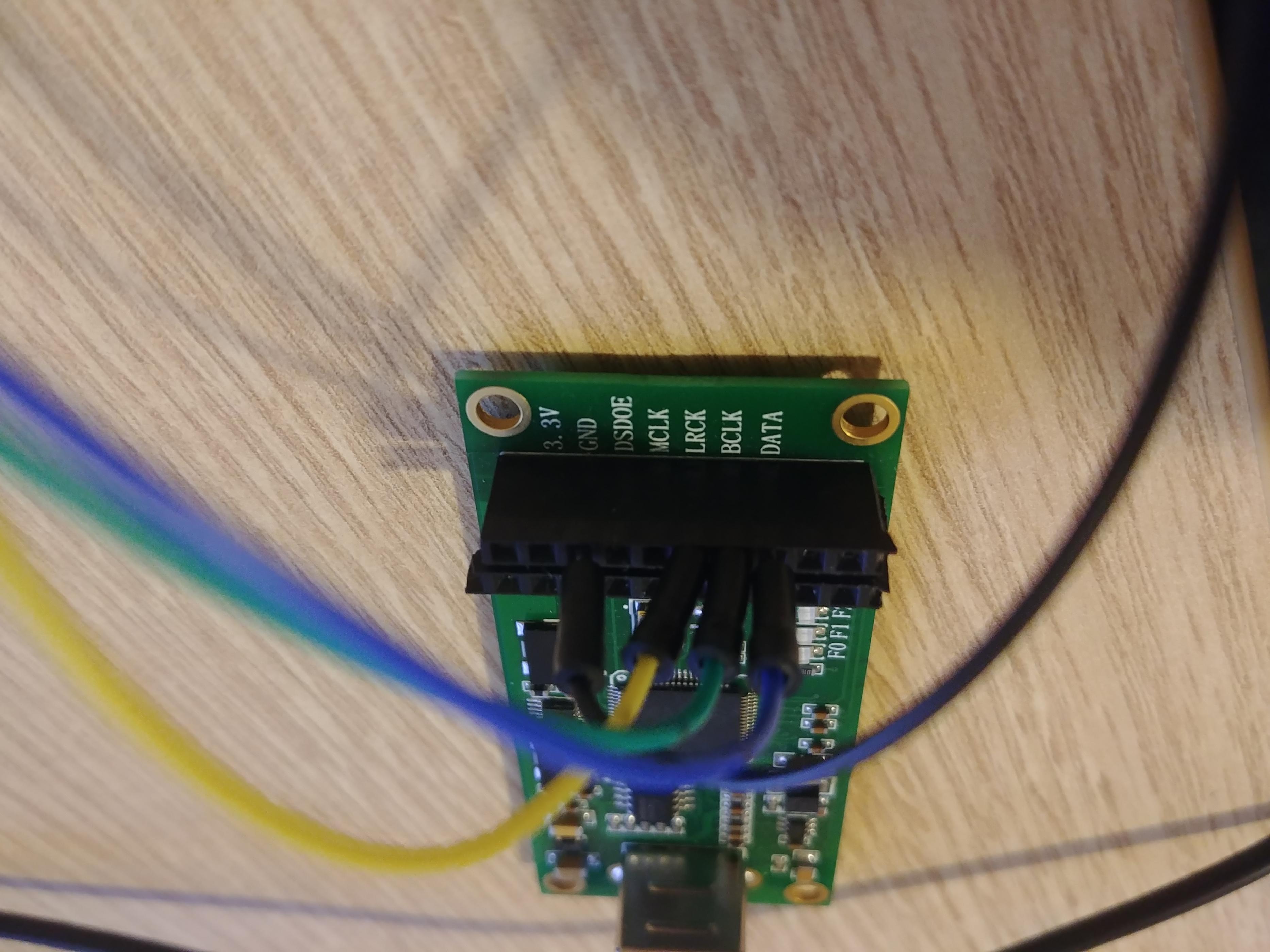

The onboard USB connector appears to be just power.
On the 30 pin connector
Pin 30 - GND
Pin 27 - LRCLK
Pin 23 - DATA
Pin 22 - BLCK
Excuse the obvious bodginess of this in the photos!
Needless to say, this is just testing

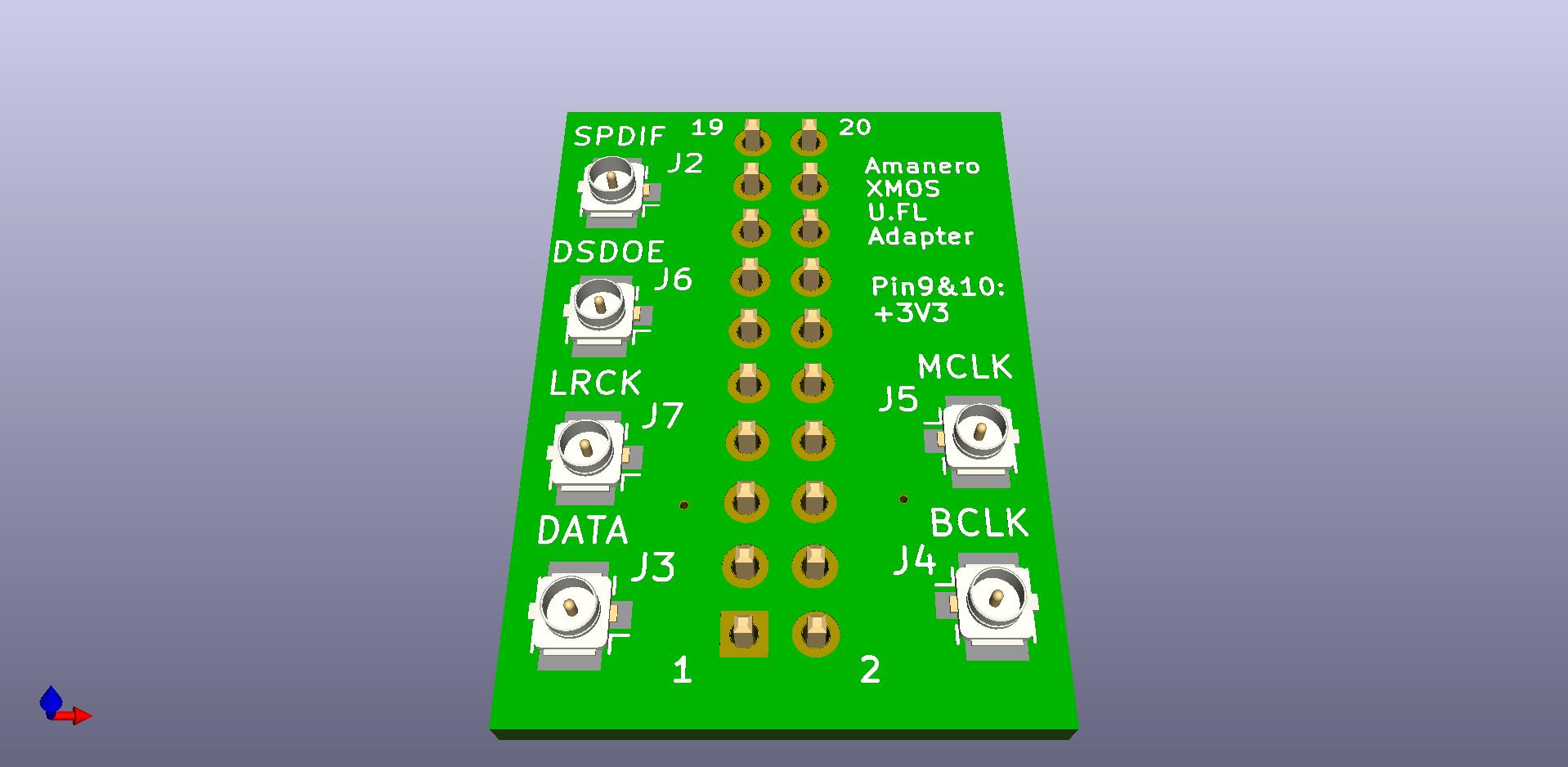

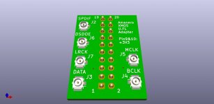

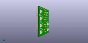

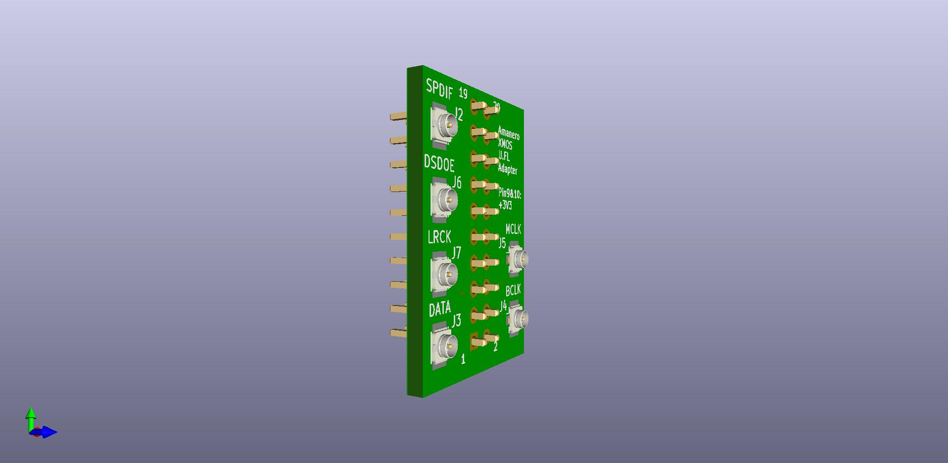

Any ideas on how to wire up two sets of I2S out?
Or atleast two SPDIF (coax) out?
I am trying to get the info off datasheets etc, but my chronic pain makes it hard to concentrate and remember what I've read.
EDIT:
I made a small, crude, layout of a pinheader to U.FL adapter.

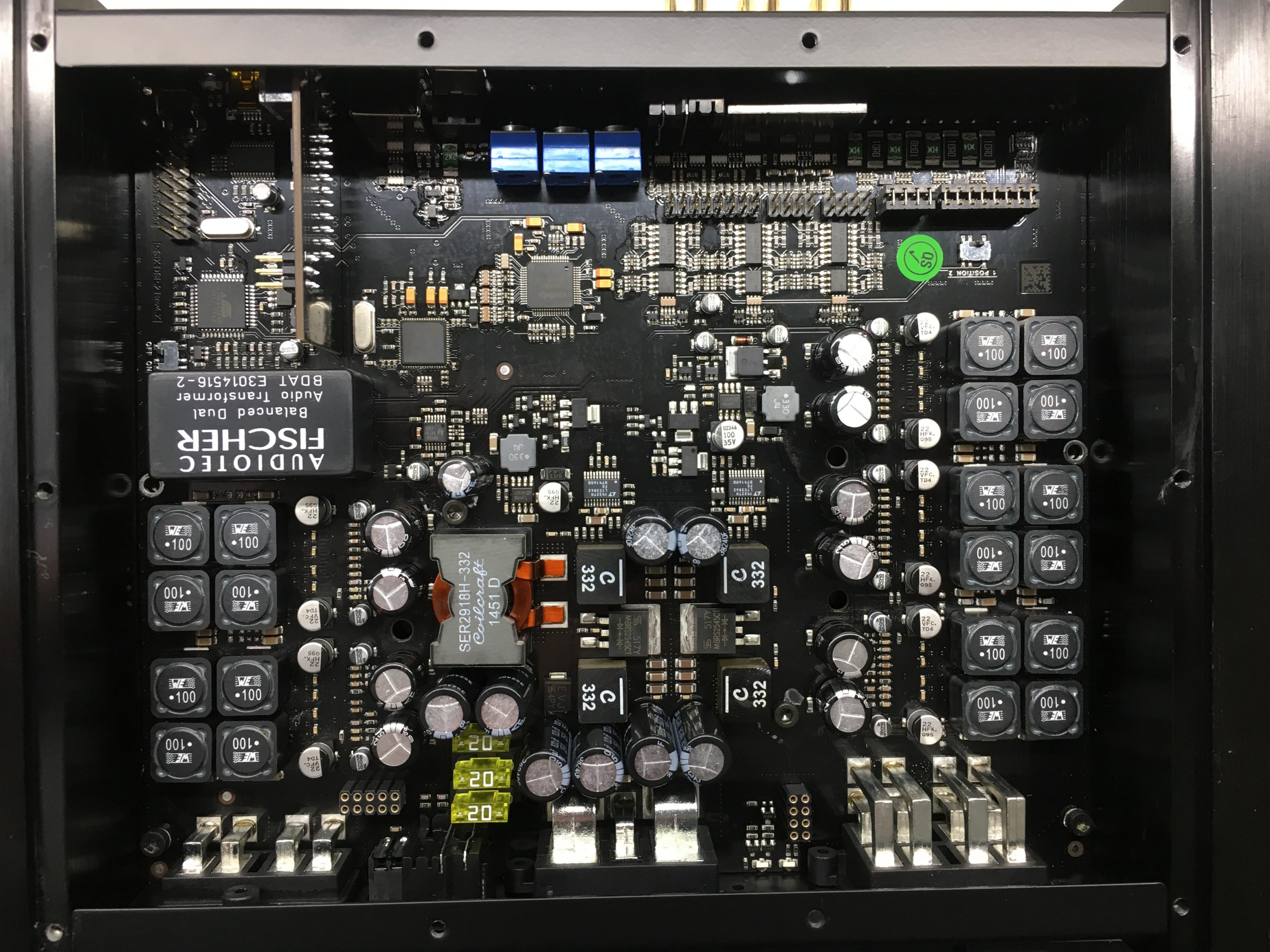

From the parts I can see, that thing was not cheap.
Nicely done from a quick glance at it.
