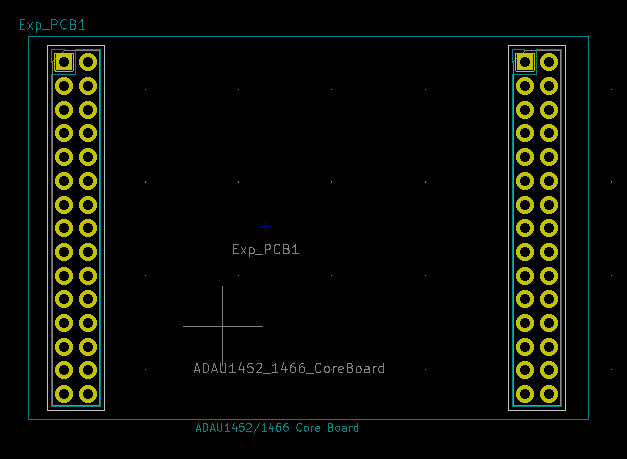

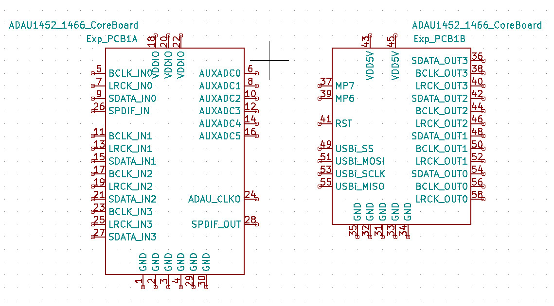

Before I go through the time consuming process of making a schematic symbol and a footprint, I thought I'd ask if anyone has made those for this board:
ADAU1452 Core Board
It has the same dimensions and pinouts as the AD1466 Core Board
I just finished making it.
That has to be the most boring part of PCB design, making symbols and footprints. I made it in KiCad's nightly version, 5.99.

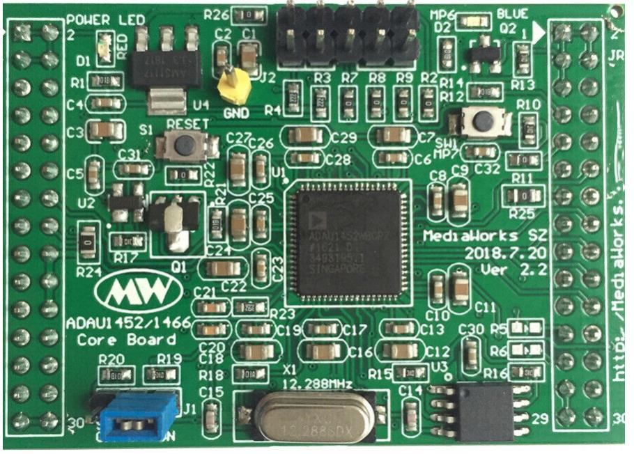

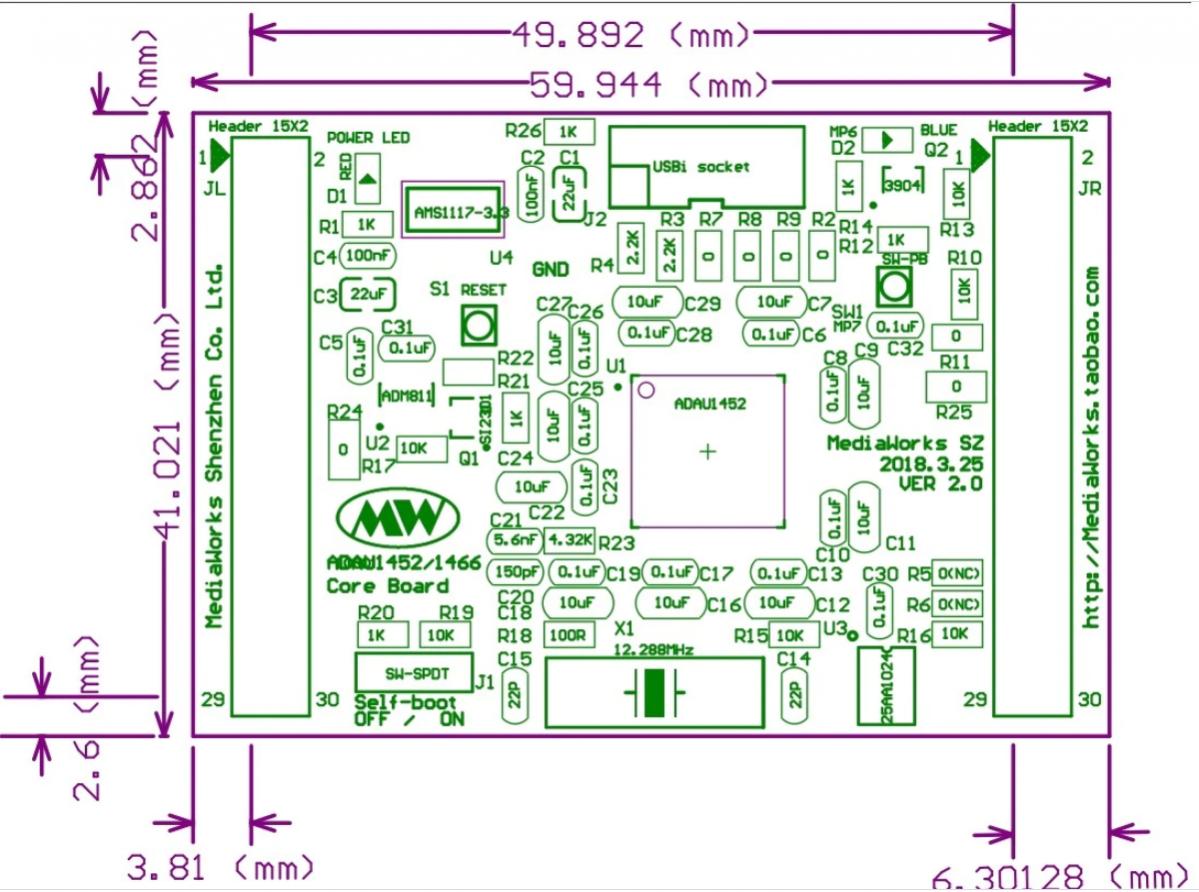

Hi Mayday
This is the schematic and elements I have on hand for the "ADAU1452 mediaworks core board" ... hope this is what you are looking for !

Thanks!
I didn't have the schematics, but I found the dimensions and pinout info for the 2x 30pin headers (this is what I used to make the schematic symbol and PCB footprint).

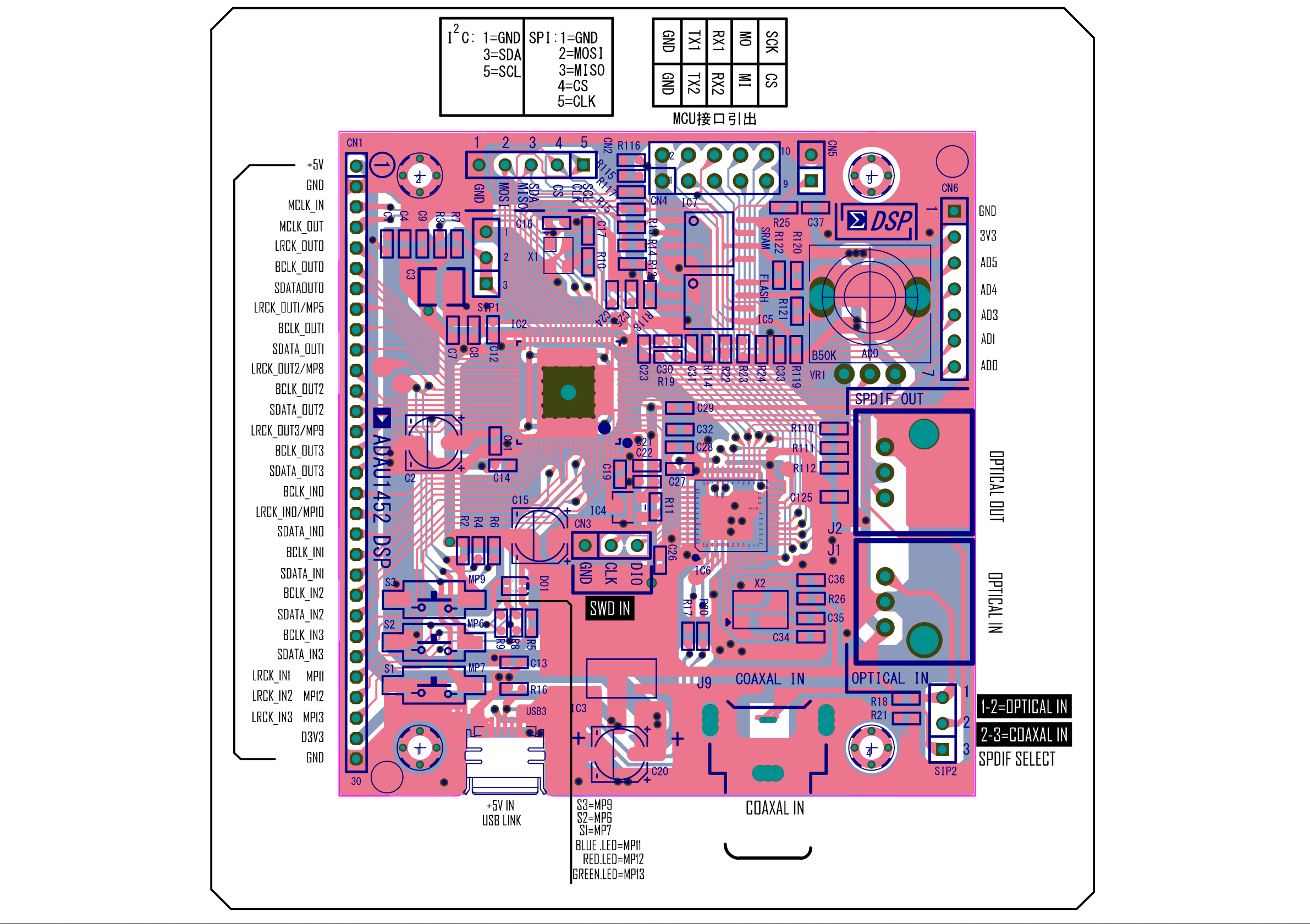

Hello Mayday-San,
Maybe you can see some ideas in my board design...
(Sorry! written in Japanese)
DIY DSP PRE-AMP PROJECT PAGE
(Machine Translation)
Google Translate
CyberPit
Having looked a bit closer at the schematic and board, I have to compliment you on a very nice design.
Mine will be a little different, I wish to have SPDIF in and out via U.FL connector.
I'll also use those connectors for I²S in and out.
Not being very familiar with the ADAU1452/ADAU1466, are the buffers (logic) necessary for I²S out?
If not, I'd like to know the reason you chose to use them.
I like the options for input in your design.
Not sure I can implement your source select part of the schematic (given that you are ok with that in the first place).
My inputs would be USB(via XMOS208 with Sitime oscillators), if I don't just use the SPDIF out from that board. I will also have I²S input. I don't think I will have any analog inputs, I haven't made up my mind about that but I don't think I'll use analog in.

About the I2S output buffer
Mayday-San,
I'm glad to hear from you. Would be the help is my pleasure.
The reason why I had add the Tri-State Buffers on each I2S output Headers, there are two reasons. Mainly depend on a signal integrity at the DAC's input pins.
Reason1:
Considering fan-out (Load) effect on the MCLK line. Driving four I2S connection ribbon cables at 24.576MHz directly seems to be a heavy load for ADAU1452/1466.
Reason2:
Wanted to do the same output impedance/dumping factor the rest of I2S signal lines. But this part might not necessary, because the fan-out is 1 and the signal frequency is not so high.(I'm Not sure for all cases)
I implement additional option output-enable control, if the output buffer is not necessary for the user's application. It will reduce the power consumption and the emitting Noises.

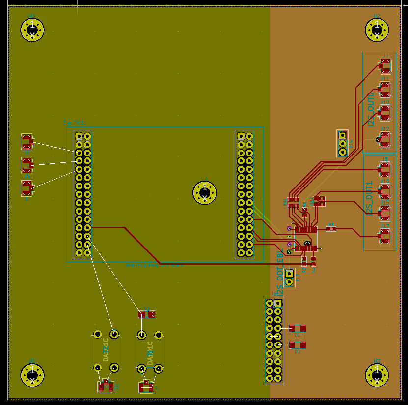

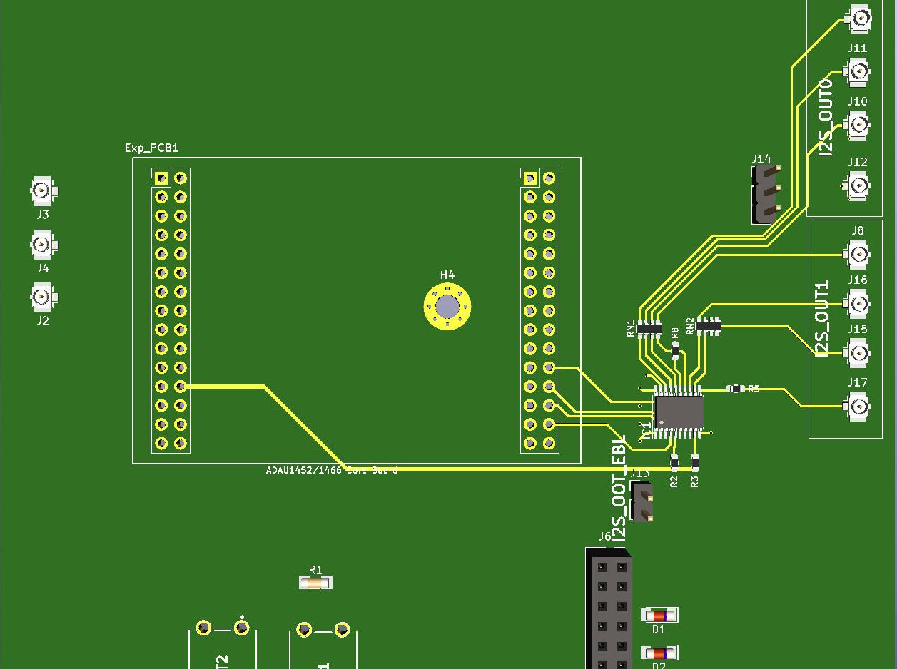

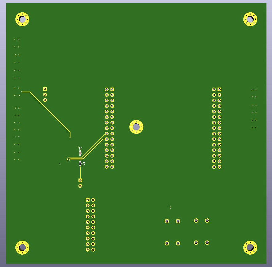

I've started a preliminary layout. From past experience it'll change a number of times before I'm happy with it.
All I've done is take the I2S, via SN74HCT541(Thank you CyberPit-san), to U.FL connectors.
I've placed Murata DA101C digital transformers for SPDIF in/out and a pinsocket for Amanero/XMOS208(w sitime oscillators, I have one of those at home).
This just a rough starting point and will most likely change alot before I send anything of to a boardhouse.
Board size is currently 120x120mm
I know there are spelling errors etc on the board. Remember, this is like 5-10 versions from what I'd consider an Alpha-release.
