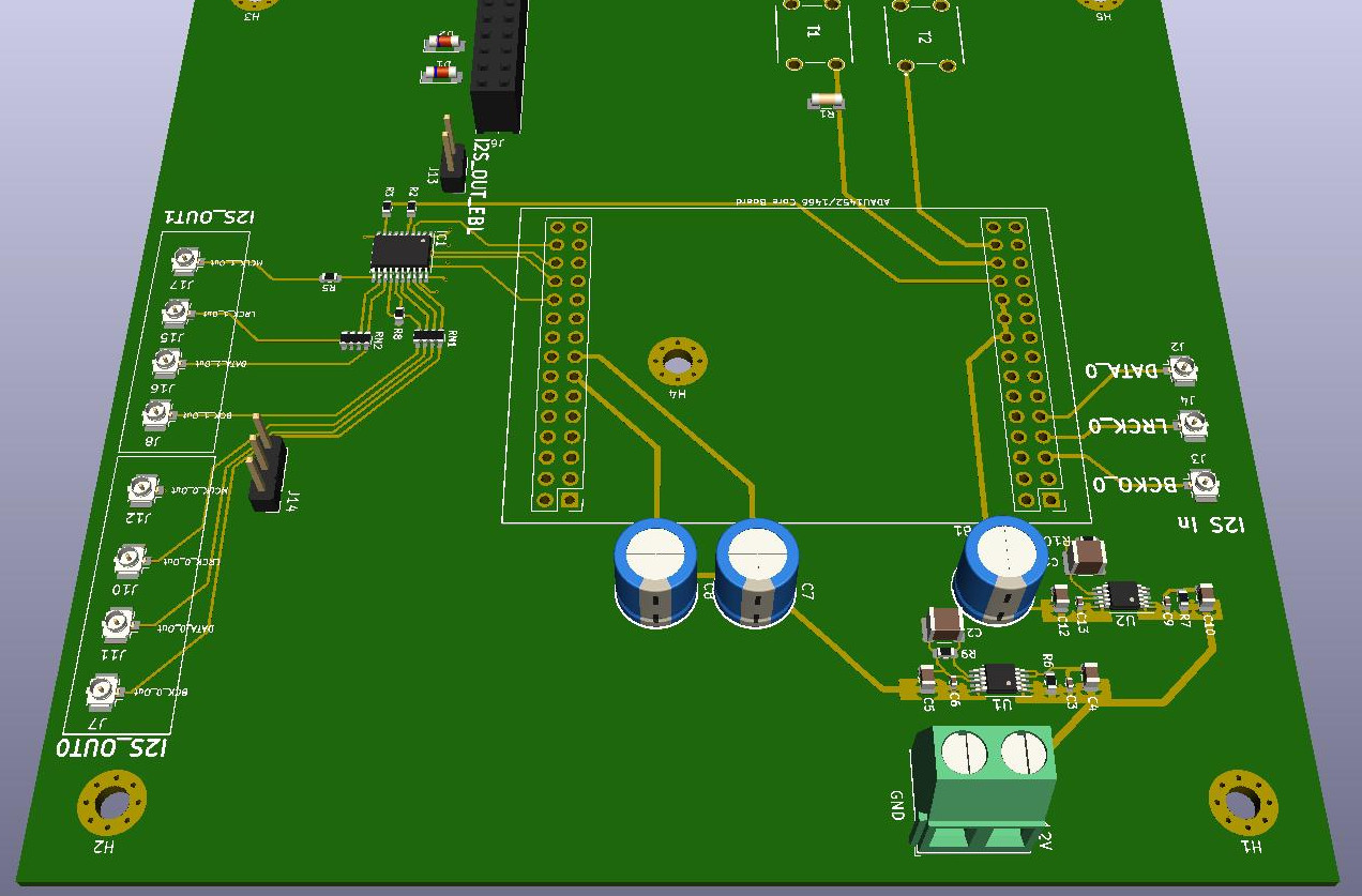

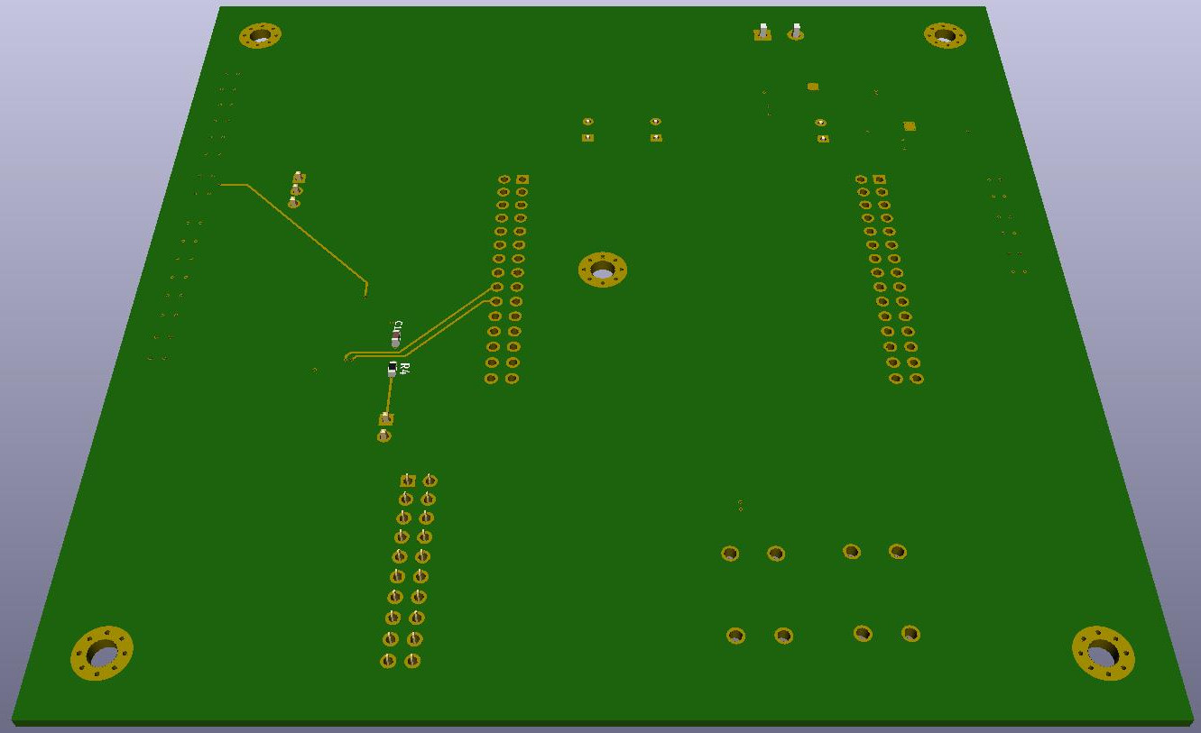

At this point, I'm merely playing with the idea of a "mainboard" for the ADAU1452/1466 "Core Boards" available on ebay and aliexpress.
I'd really appreciate if someone with experience with these boards(in Sigma Studio as well) would let me know which pins to use for what.
As I have a number of 3pin regs (LT3042. LT3042+BJT. TPS7A4700, TPS7A3301 etc), I'm considering dropping the LDO's from the board and put 3pin sockets there instead.
My main goal is a low noise, no A/D-conversion, DSP that I can use to power a sub-amp...maybe even make my speakers active X-over as well.

Looking for the right I/O-pins to route the SPDIF and I2S in and out.
I feel like not knowing the ins and outs of Sigma Studio is a barrier to creating a decent PCB.
I'll get a UMIK-1 at some point, I have a mic designed according to Linqwitz site. I think it would be much easier having a USB-Mic that has calibration-files.
The ADAU1452/ADAU1466 are overkill for what I need, but they do offer digital in and out from what I've gathered from the datasheets.

From what I've gathered, I need to route the SPDIF input to ASRC input as I play backed up RBCD(16bit), and the ADAU1452/ADAU1466 require 18bit in.
I would like SPDIF input/output and at least one (stereo) I²S input/output.
Not understanding how routing is done in Sigma Studio is really a speed bump in making a motherboard for these Core Boards.
It's very frustrating to say the least.
I want what DSP has to offer, but not any extra A/D-conversion, and a solution that lets me use the D/A-converters of my choice.

What would really help is a Sigma Studio file with SPDIF input, I²S input and the routing to and from the ASRC.
Also SPDIF output and I²S outputs (two at least).
Preferably with a comment about what pin is used from the "Core Boards".
