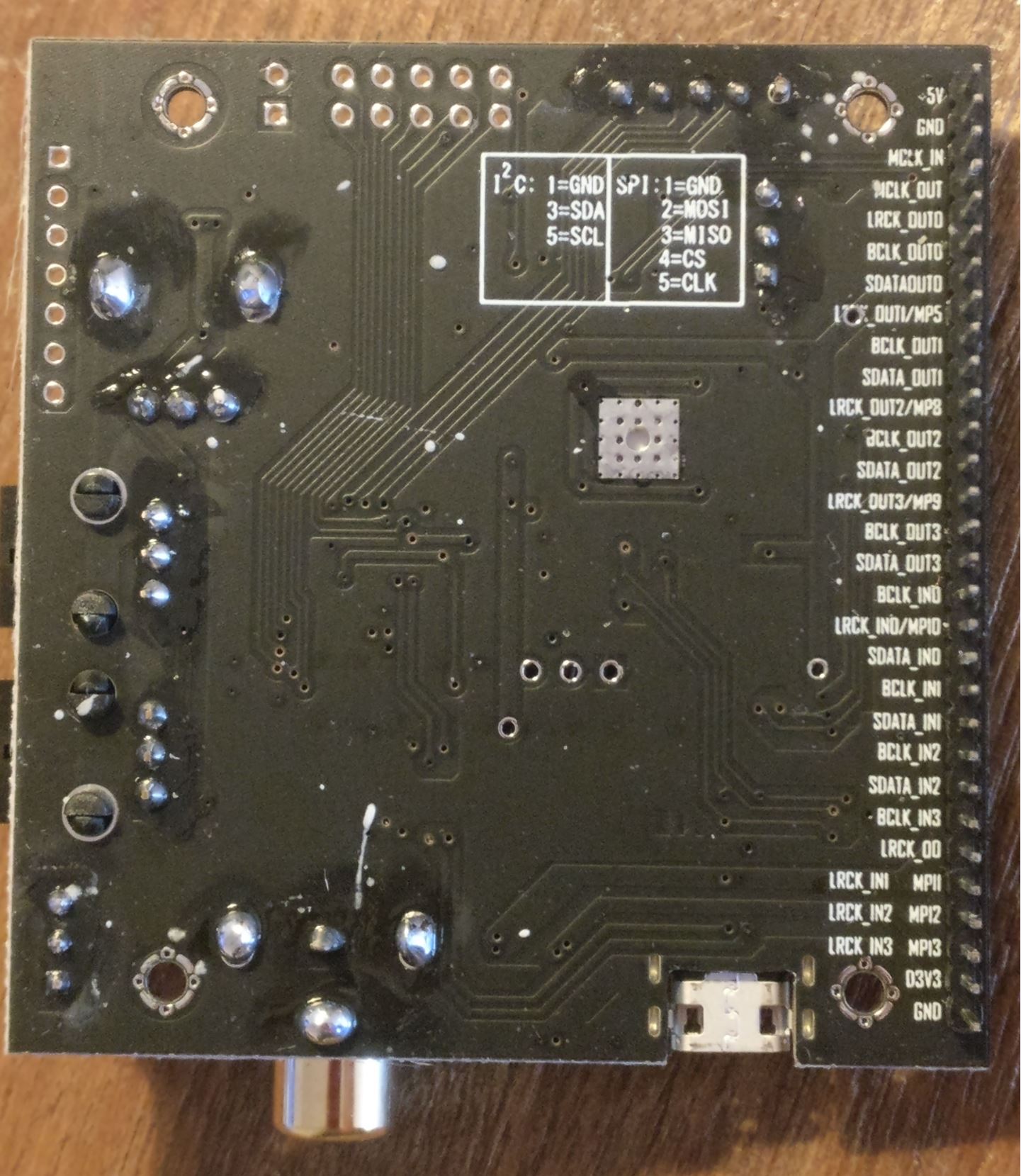

I've just ordered one of these ADAU1452 boards from AliExpress (not arrived yet).
I'm a but confused about the connection method for using with Sigma Studio. Reading this thread I gather it needs to use SPI interface (unless ressitors are changed to enable I2C).
Can I talk to this with any USB to SPI interface? I have one from CSR that I used to program bluetooth modules. I would have expected Sigma Studio to talk to a com-port and the drivers in windoze do the rest?
I'm also confused about USBi. Never heard of it before. From what I can gather it is simply AD's USB to SPI interface chip, were some of you thinking the PCB had one onboard (or running in software on the missing ST micro?) so you could connect the header directly to USB? Should I understand Sigma Studio will only talk to AD's own USB-SPI chip?

Hi Tenson,
I'm a but confused about the connection method for using with Sigma Studio. Reading this thread I gather it needs to use SPI interface (unless resistors are changed to enable I2C).
Actually, I²C is the default communication mode of the ADAU1452. You won't need to do anything besides connecting SDA and SCL. IIRC, the I²C address is 0x76.
Also, the I²C and SPI pins are shared, and the ADAU is switching to SPI mode after the SPI_CS pin has been toggled three times (by making three fake SPI writes for example).

I2C may be the default for the adau1452 but if you have bought the core board it is wired for SPI, it will need the the 0 ohm resistors changing as per the info in the schematic to work with I2C.
I'm using the Sure Electronics / Wondom DSP programmer with my core board in I2C mode.

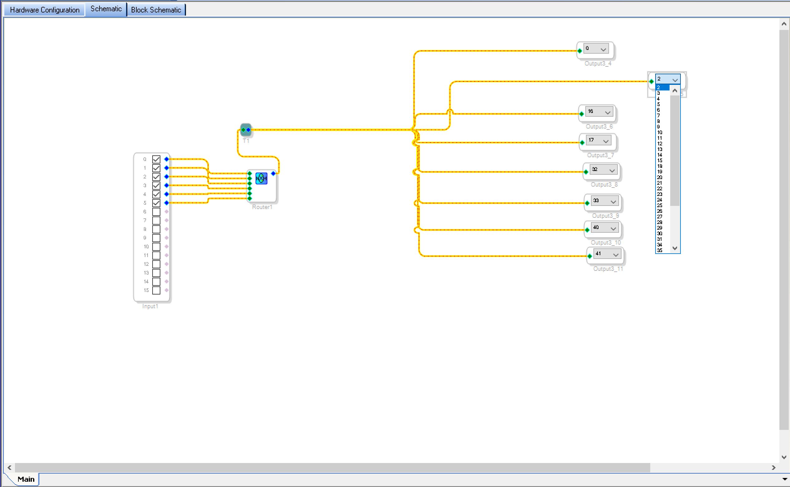

I am using the ADAU1452 from Aliexpress with my FreeUSBi, and managed to compile and download (I am not getting any error) and it seems to work because every time I press F7 I hear a "bip" from my speakers... the thing is I am not getting any sound!!
I configured everything as Tenson thankfully showed, but still no sound.
I am using analog inputs/outputs without any sound.
Any help would be greatly appreciated
Cheers

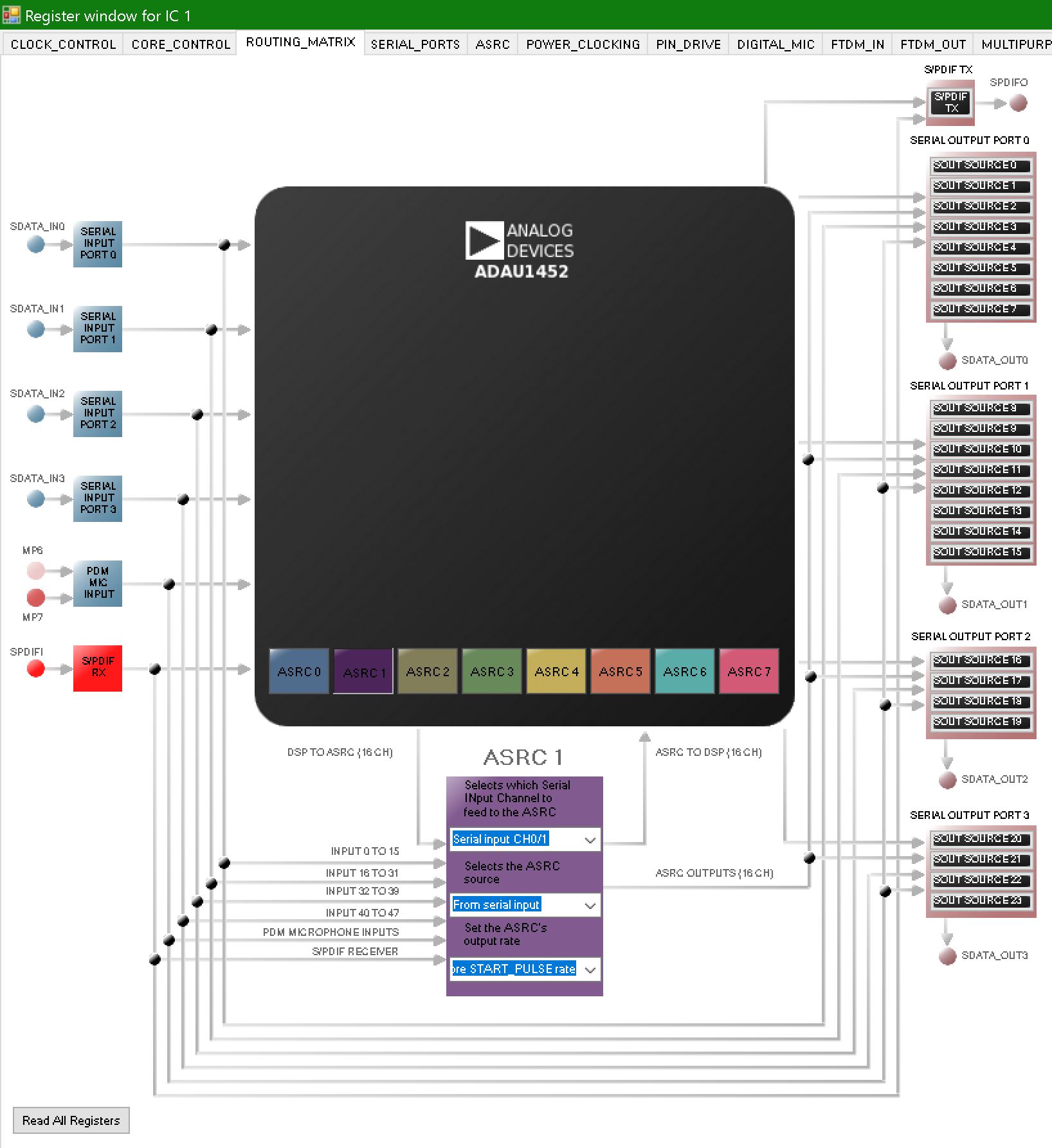

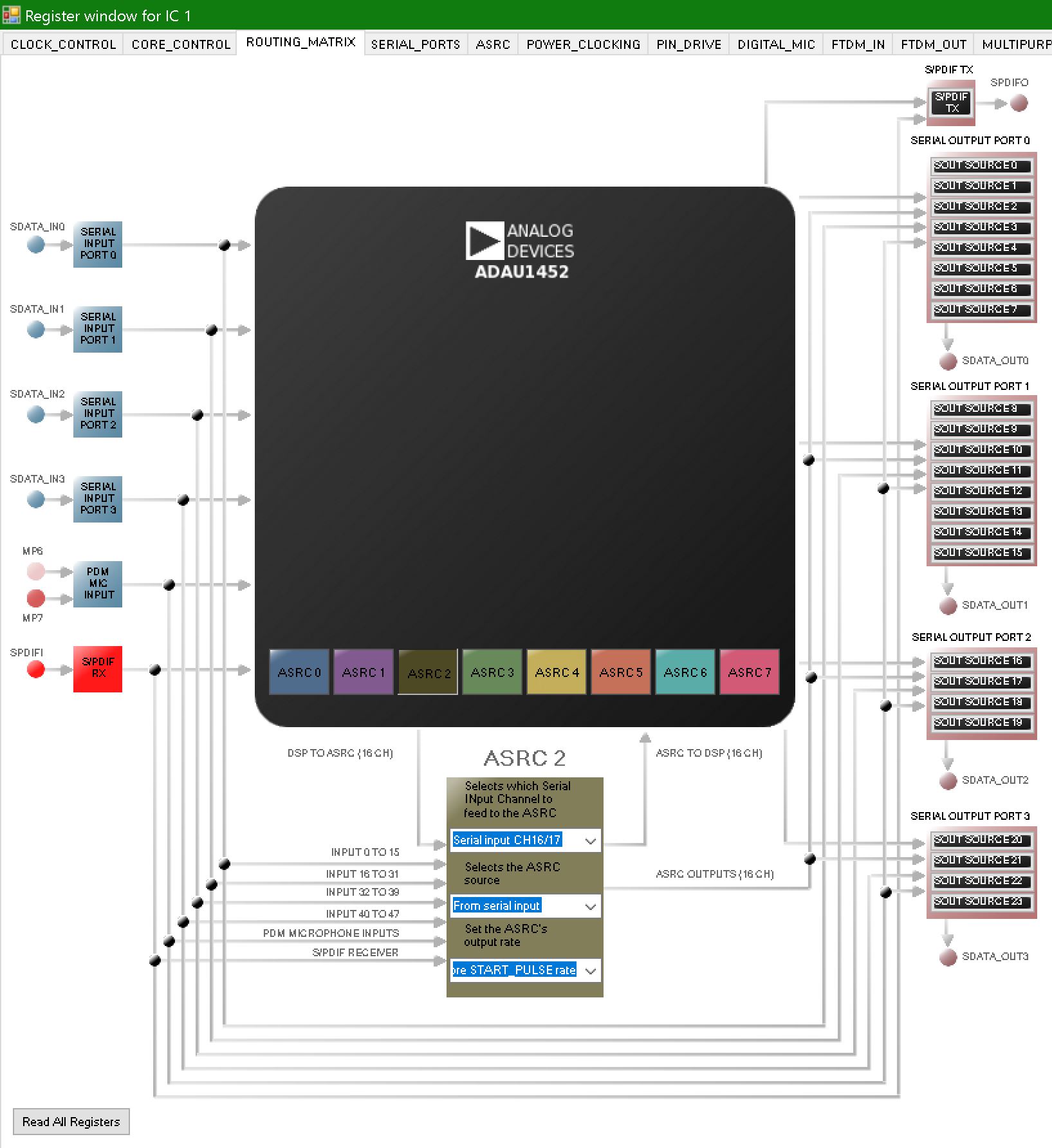

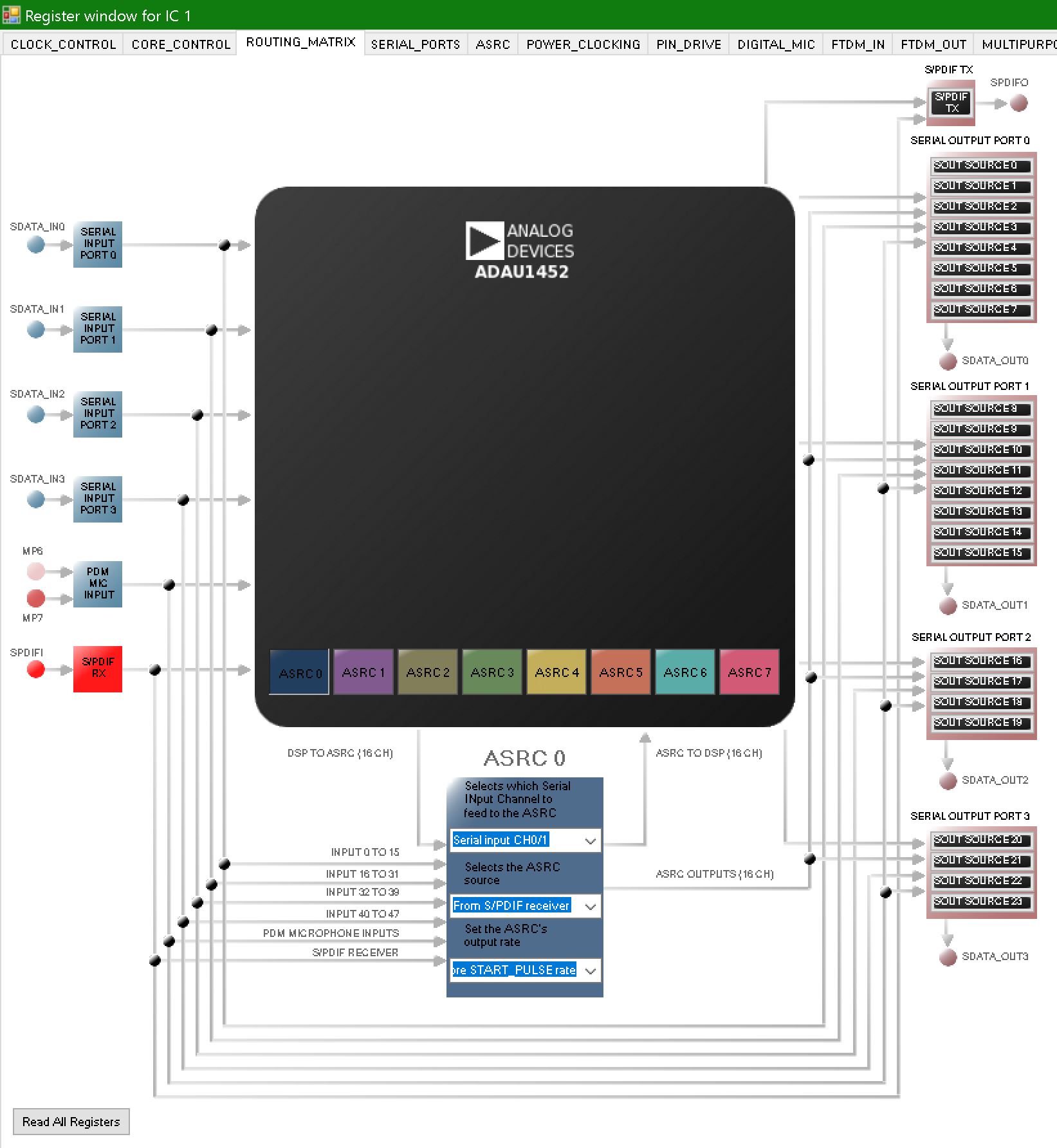

Did you set the routing matix?
ASRC 0 should be 'Serial Input CH0/1' and 'From SPDIF receiver'
ASRC 1 should be 'Serial Input CH0/1' and 'From Serial Input'
ASRC 2 should be 'Serial Input CH16/17' and 'From Serial Input'
Yes, I've set the routing matrix just as you showed, and on the right side, every "Serial Out Port 0/1/2/3" is set to "From corresponding DSP core output channels".
One strange thing is that in my "Schemtaic", there is no "Output 1", from 0 it jumps to 2 up to 47.
Here is a capture of my schematic.
One thing to consider is that I still don't write the eeprom, so every time I unplug the DSP, it goes to it's normal state.

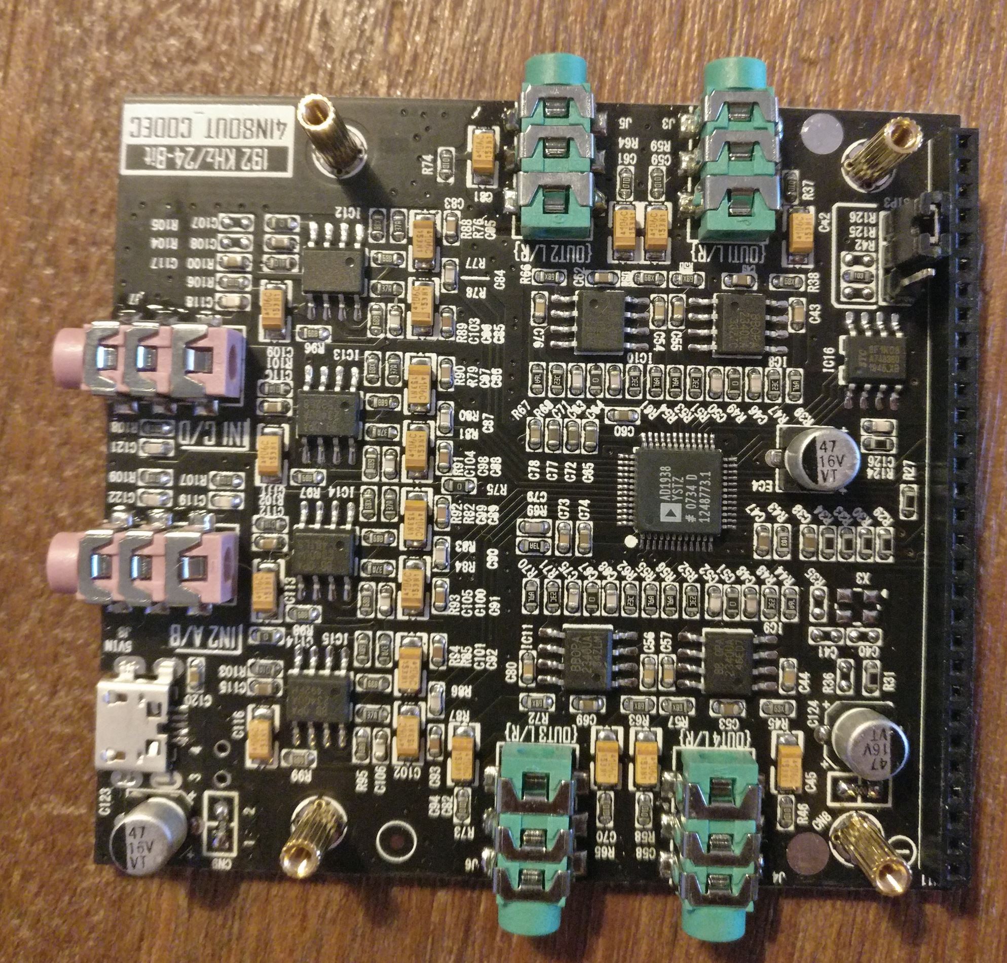

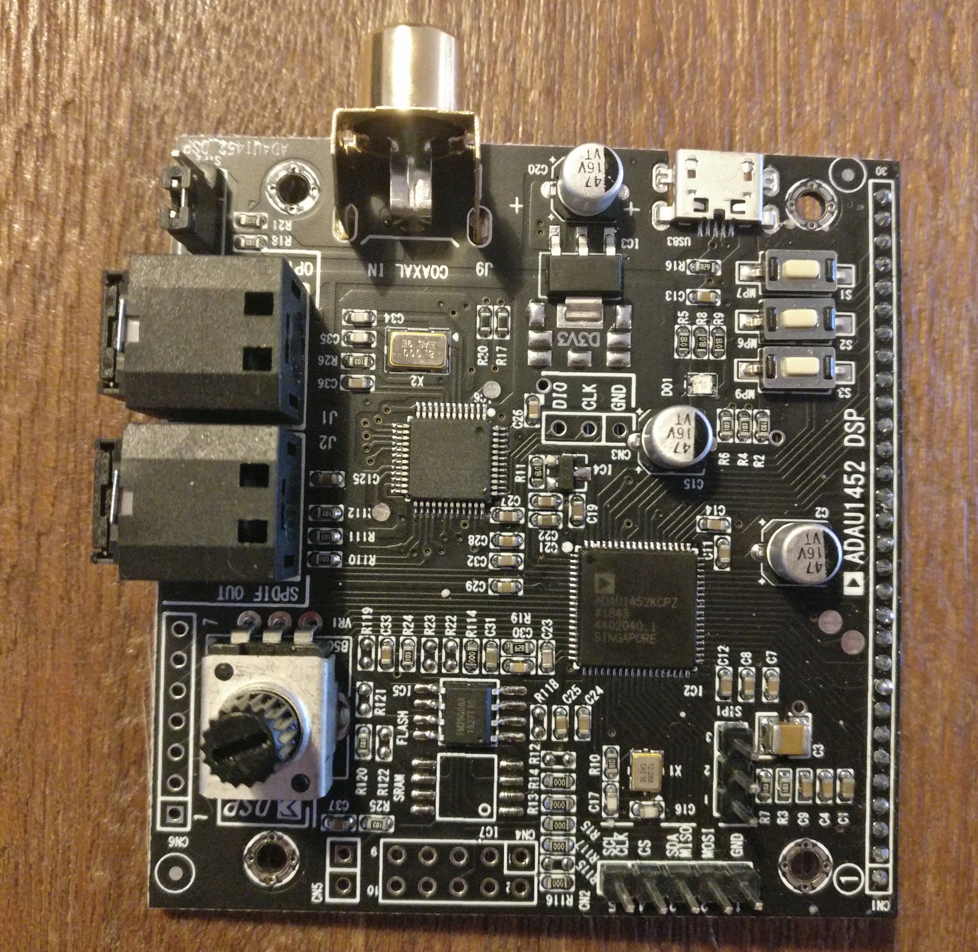

I managed to get my DSP sounding. I grabbed the default schematic that I've got from the seller and started striping parts.
It seems that not all Aliexpress's ADAU 1452 are the same. Mine has an STM32 single-chip micro controller on the board. Others don't seem to have it.
My analog inputs are 4, 5, 6 and 7 and my DAC outputs are 0,1, 2, 3, 4, 5, 6 and 7 and the "routing matrix" seems to be different, as it's working with a different configuration that the one showed before.
Still, I did not wrote the E2Prom yet...
I attached a few pictures of my DSP board and the codec board. I am not an expert, but It would be great if we could have a complete "How to" guide for thes ADAU1452 boards, as they are very cheap (around USD$55 shipped) and quite powerful, actually quite a lot more than the standard miniDSP 2x4 which is around USD$80 w/o shipping.
