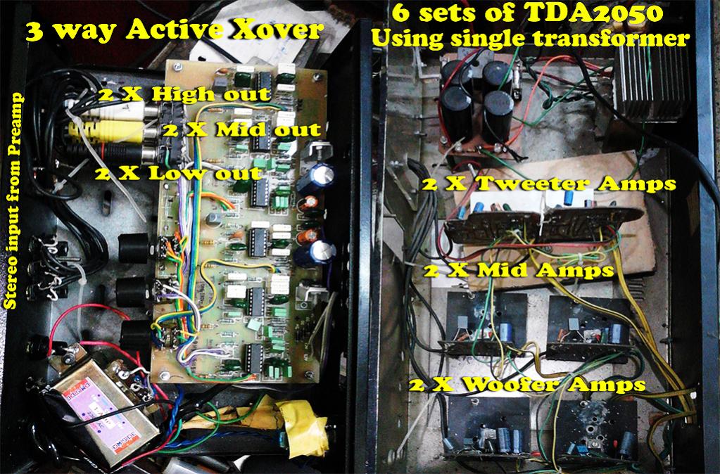

Thank you so much Gootee for your kind reply.
Here I'm posting my current setup of TDA2050 along with 3 way active cross over ( kindly see the attachment ) that has been running really great with my entire satisfaction since last some 6 months without a single problem. The system has a great, crystal clear, dynamic sound stage and absolutely no unwanted perceivable noise, hum etc.
My aim is to replace the TDA2050 ones with Apex's great LM3886 boards with as few transformers as possible.
Using two transformers and putting 3 amps together in the speaker enclosure box are indeed great suggestions for my specific case. But I am worried about the length of long 6 signal cables and an additional power cord. But I will try that and report the result back to you here.
For your second suggestion, could you kindly post a diagram or sketch of your suggested arrangement to make it more clear for me? I am bit lost with the number of transformers there.
And kindly suggest the rating of the transformers too. As I stated earlier, I don't need the full thundering sound just the great quality at low volume with all the details.

Do not worry about longer signal interconnects.
Short speaker cables give more advantages than you lose with long interconnects.
But,
ensure the Source can drive the interconnects. This means the Source must be able to drive some capacitance in parallel to the input impedances of the active filters. i.e low output impedance and adequate current capability.

Thank you Sir for taking time to post your valuable words. 🙂
I am using Rod Elliott's Project 88 Preamp in the intermediate stage between the equalizer and Xover at this moment.
I will follow your and gootee's kind suggestion 🙂

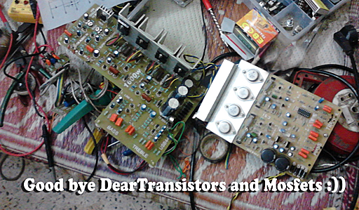

Here I am tempted to express my purely personal experience with High-wattage Discrete Mosfet Amp from a hobbyist's standpoint. And there is a good chance that many won't agree with me.
I bought/assembled/made and tested several Discrete Kits available locally in India. Initially I has happy with their performance. But after the honeymoon with them was over, I discovered a slight hum developed in some kits due to improper designs, lack of good components hampering the performance, bad quality transformers, low quality variable resistors leading to missing dynamic sound stage etc. Their output was high and they were reliable but still I was not very happy with them sound wise after some 6 months or so. And more we can't easily buy good branded speakers without spending a fortune. You know the Indian condition very well.
Our respected experienced member Andrew T has mentioned and warned us many times about improper grounding. And I found this problem even in some commercially available kit too. Also if I can remember rightly, our respected Mr. Miles who knows the real thing about audio, once wrote that even 35 watt is good for home listening. Please correct me if I'm wrong. He has many discrete circuits too. May be you can try one of them.
In a nutshell , we need quality as well as stability. I finished a recent project with TDA2050. I can safely say that I am extremely happy with the crystal clear, detailed sound stage. And this IC is very cheap and reliable too as I have seen.
My suggestion is if you can't obtain LM3886 immediately just wait. Meanwhile you can give TDA2050 a try with bi-amping or tri-amping. That won't hurt your pocket much. That's a pretty capable and powerful chip with excellent price performance ratio.
You can make a PCB very easily with a permanent marker pen following the datasheet.
Btw, I trashed all my Hi-wattage Mosfet kits after listening to the awesomeness of LM3886 amp using Apex's truly great design. 🙂 My plan is to do tri-amping with them. 🙂 Right at this moment while writing this reply to you, I am testing one LM3886 amp I made some days ago, with only a ONE AMPERE 18-0-18 VAC Transformer in series with a 60watt Lamp. Even then the sound quality is simply mind blowing.

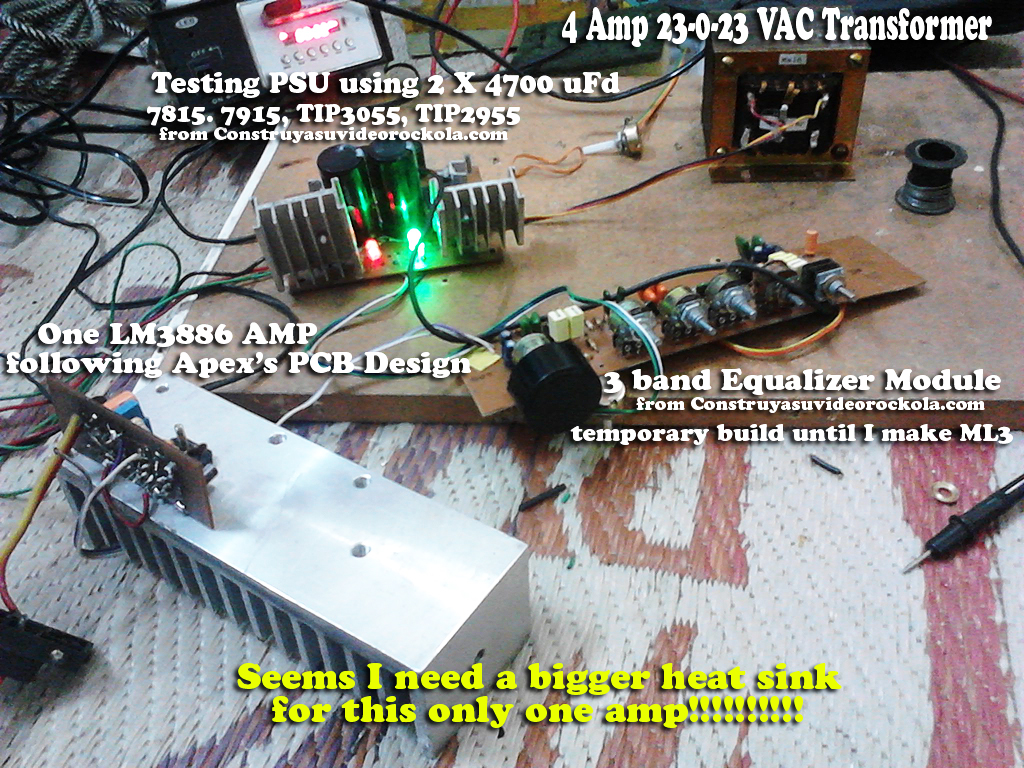

Dear apex,
Your LM3886 design working truly great with 15-0-15 VAC since I changed the zener to 5.6v as per your suggestion
Now I've just bought a 4 amp 23-0-23 VAC transformer to power it up.
Can I leave the 5.6V zener there in the board as it is
or
should I change it back again to the recommended 16v Zener?
Update of my LM3886 amp using Apex's great design
I have been running the amp with 5.6v zener continuously with 23-0-23 VAc @4 ampere. No problem yet. Sound is great as usual.
I guess I need a bigger Heat sink now! I don't want to use a fan.
If you need a bigger than that, then something is wrong.
Perhaps the culprit is 5.6 v zener instead of the recommended 16v with the increased voltage? or I'm not sure.
I just noticed one thing. I switched on the celling fan of the room and now its completely cool, not even warm.
The temperature here is like 33 C at this moment.
