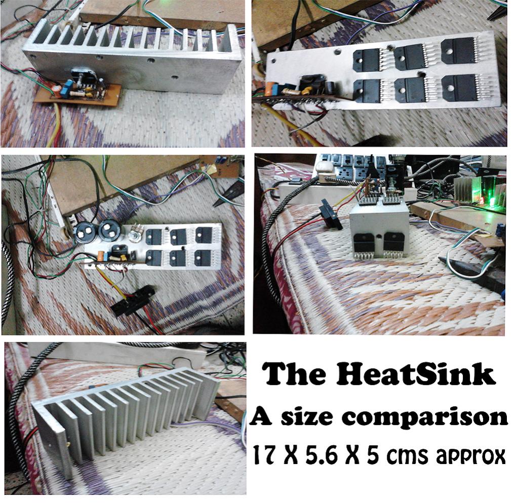

Did you check how big heatsinks ppl put on their 3886 chip?
As I know these chips have 1C/W thermal rezistance meaning it is useless to put a bigger heatsink, because the chip can not dissipate more heat. If you put 500 times bigger thing on it, it will still be the same hot. But if you like to waste money.
The one you have on the pic is already less than 1C/W as I know.

From a certain point it is useless to use a bigger heatsink. Maybe if he puts in a 3 times bigger he will get 10% less heat.
Same reason ppl use heatpipe in CPU cooling because a chunk of metal is a crap heatsink. Heat spreads slowly. But also the chip is unable to give all the heat away instantly. But please explain then.
add a 1C/W sink (Rth s-a) to a 1C/W device (Rth j-c). Make allowance for the interface, say 0.5C/W for Rth c-s.
The total Rth j-a is 2.5C/W
Now do the same using a 30C/W sink. The total resistance is 31.5C/W
Pass 1watt from junction to air for the two arrangements.
What are the predicted junction temperatures (Tj)?
Now tell me it makes no difference !!!!
I was talking about his present heatsink. Not using your hand for cooling.
As I sad he already has a about 1C/W heatsink and doesn't need a bigger one. Didn't say he should use a 30C/W sink...
Sorry if I was not clear. I though he is using the heatsink on pic #178.
What heat sink are you using csom?
It also matters how it is set. If face down like on the pic, then you get lot worse cooling. Need ground clearance also.
Som
The pic on post 178 looks like your sink is fine for a chip amp like a LM3886. I am betting you could get away with 2 chips per heatsink and I dont think you could fit more anyway. I have put very small sinks on LM3886 and overheating wont destroy them, they just stop working well til they cool down. So its pretty easy to figure out when your sink is to small.
Like Wagner said you need the fins to be at a 90 degree angle to the floor, vertical. As you noticed even a very very slight breeze will make the sink much more efficient. Many people use tiny fans at very slow speeds to increase the efficiency of the heatsinks.

First, thank you so much Mr Wagner and Mr. Miles, Andrew T and all, our respected experienced members who always extend their hands to help out noobs like myself.
For me, electronics theory, math, physics etc. are my really long-forgotten things of the past ( some 20+ years ago, I guess ) and my Real life profession is just polar apart from these. Everything has gone with the wind except my soldering and PCB making skill. Sad but true.
From this stand point, I might not understand all or give apt feedback to the technical questions. So kindly bear with me. 🙂
I just want to build a "great and yet simple to build" system that is tested/endorsed by all of you, the audio gurus, to satiate my age old craze of owning a great amplifier. That is why I am so dependant on all of your wisdom. And to be honest I'm re-learning from all your wise words and "following" your advice.
Here I attached some photos of the heatsink that's being used with one LM3886. Other photos are just for size comparison.
In India, where I live, it's next to impossible to get a heatsink with tech-specs. I really have no other way but to guess with trial and error what is working in my case. 🙁 I just purchased this big piece from a shop with a rough guess.

I had a plan to use 2 chips per piece.
And may be I'll have to use Mr. Mile's fan control ?
That heatsink is for sure fine for two chips. If you only have one sink I would attempt three chips. You might get away with it.
