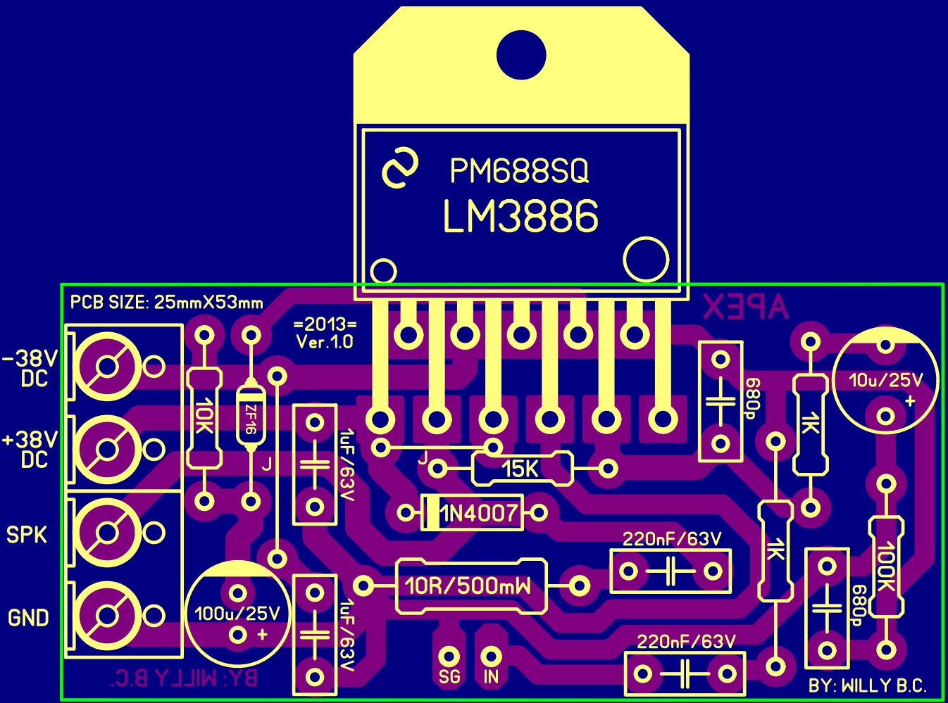

Lmfao, 1/2W... and capacitor, hows the cap?
Cap is in sound health. 🙂
Ouch! Should I increase the Wattage of the Resistor to 1 Watt?
PCB Layout shows 10 Ohm 0.5 watt.
But I saw 4.7 Ohm 1 watt is used in the Parts List.
Which value should I use ?

Burnt, or hot, or warm Zobel resistors tell you the amplifier is oscillating.
Stop and find the oscillation, otherwise you will blow up the amplifier.

Can the oscillation be in the tone control section ?

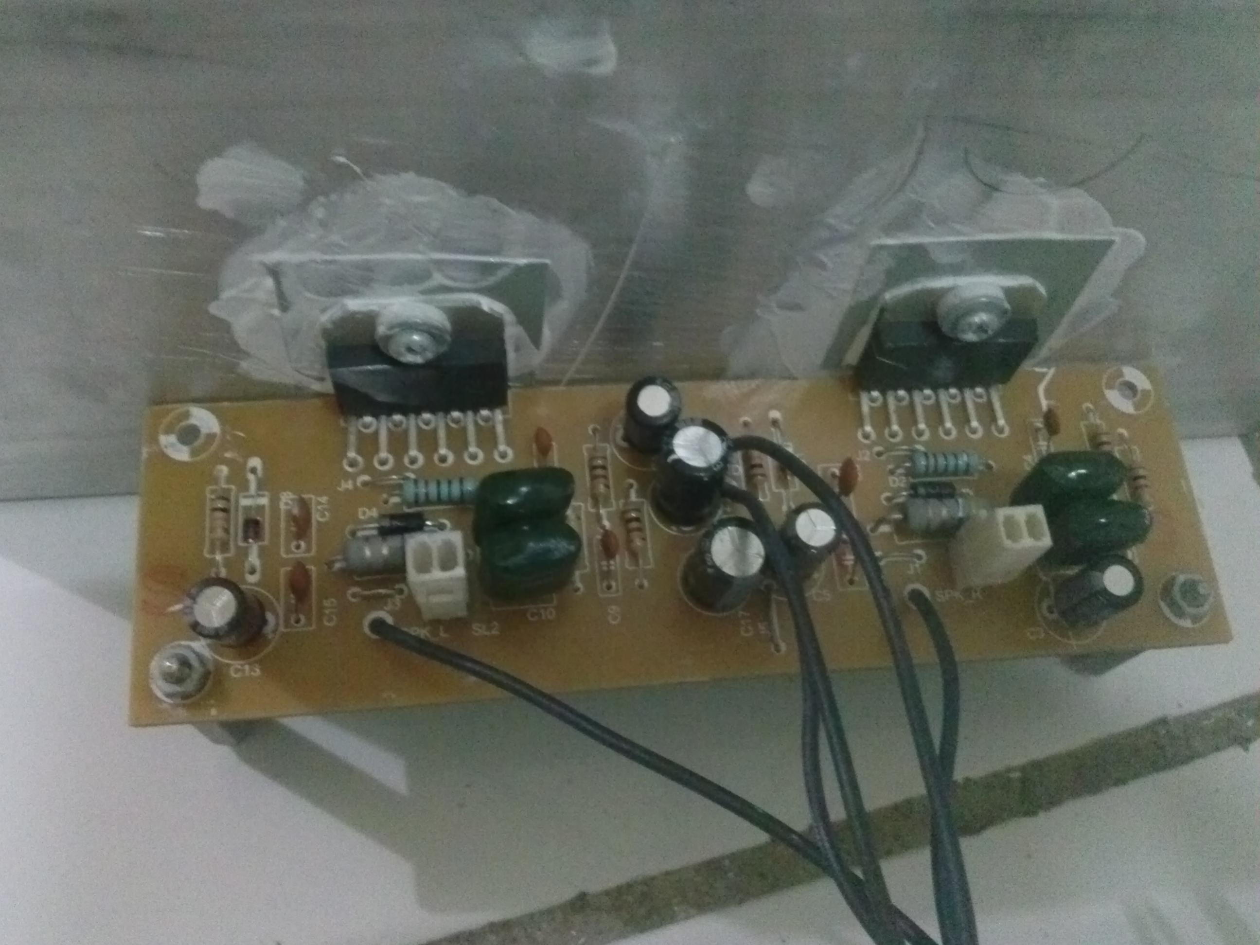

Just found a bad solder joint damaged the BC558 in the PSU of the preamp. And the voltage was like +15.67 and -32.25. I replaced the faulty one with BC560c and now the voltage is back to normal.
Zobel Resistor is cool now.
Burning started after I added the Project 88 preamp of Rod Elliot after the ML3 tone control section. The output from the preamp is being fed to LM3886 now.
Or perhaps with ML3 I don't need the Project 88 preamp? Any thought?

I checked posts you mentioned and then double checked the amps. I missed nothing.
Everything is there as per the circuit.
My gainclone base on apex schematic. Thank you Apex.
