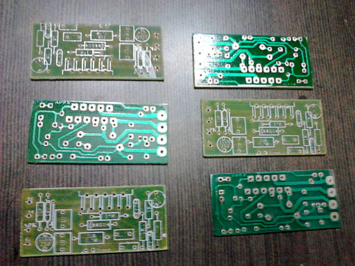

LM3886 pcb making complete. Time to build now. 🙂
Thank you Mr Mile. 🙂

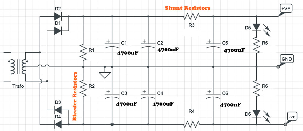

I've just finished a PSU designed by sir Mile for the ML3 preamp/equalizer section. It's working great.
I was wondering if a similar PSU can be made for 6 X LM3886 chips or is that just redundant/overkill here?
If the answer is yes, which PSU Circuit of Sir Mile should I make?
I'm not sure but I am sure that you dont need much of a complex supply for LM3886. I use an unregulated psu. Just a transformer followed by a rectifier followed by 40000uf then about a small amount of resistance followed by another 20000uf. Its basically the psu at the end of the F5 manual. Works and sounds great.
Thank you sir.
Could you kindly post a diagram along with the value and wattage of the Resistor of your supply?
Wow! You are fast! Great anticipation of the next question!!
The moment I finished posting the earlier question, I found you had already given the answer! Much Appreciated!!!
3W .47R
Look at last page of the linked pdf
Thank you sir. 🙂
