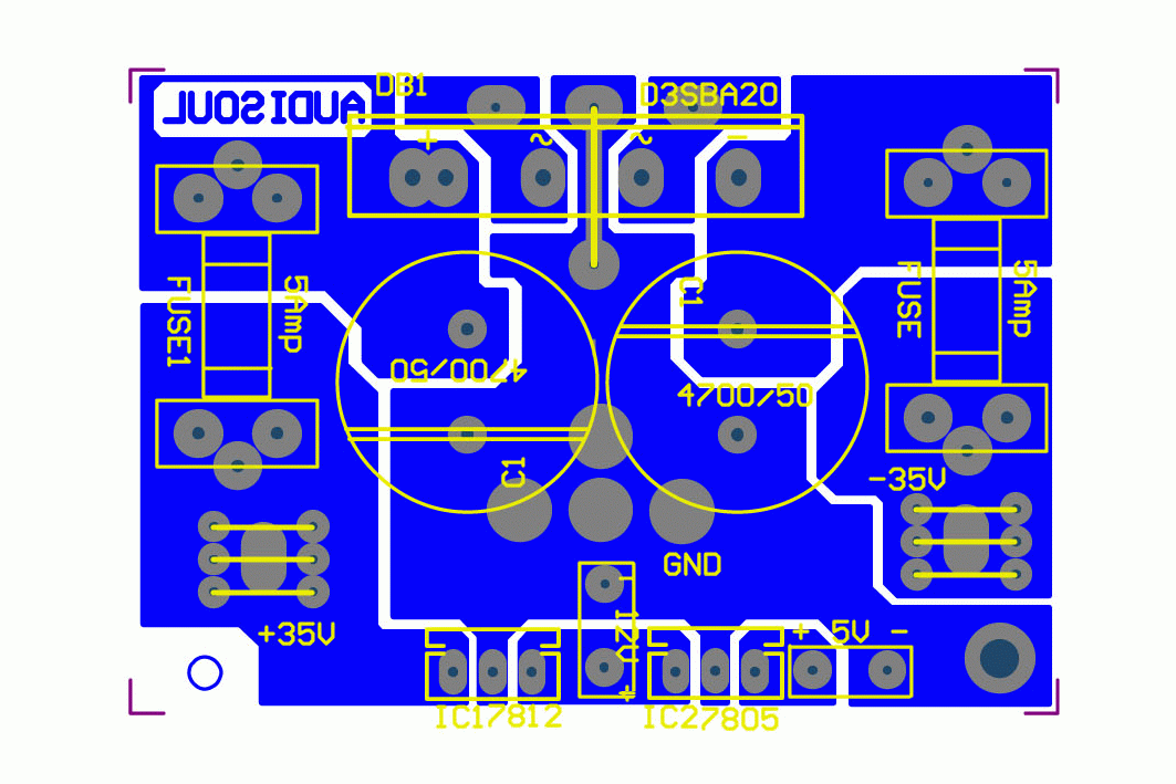

added 56R resistors on regs and also managed to loose one jumper. is it perfect now?
reg

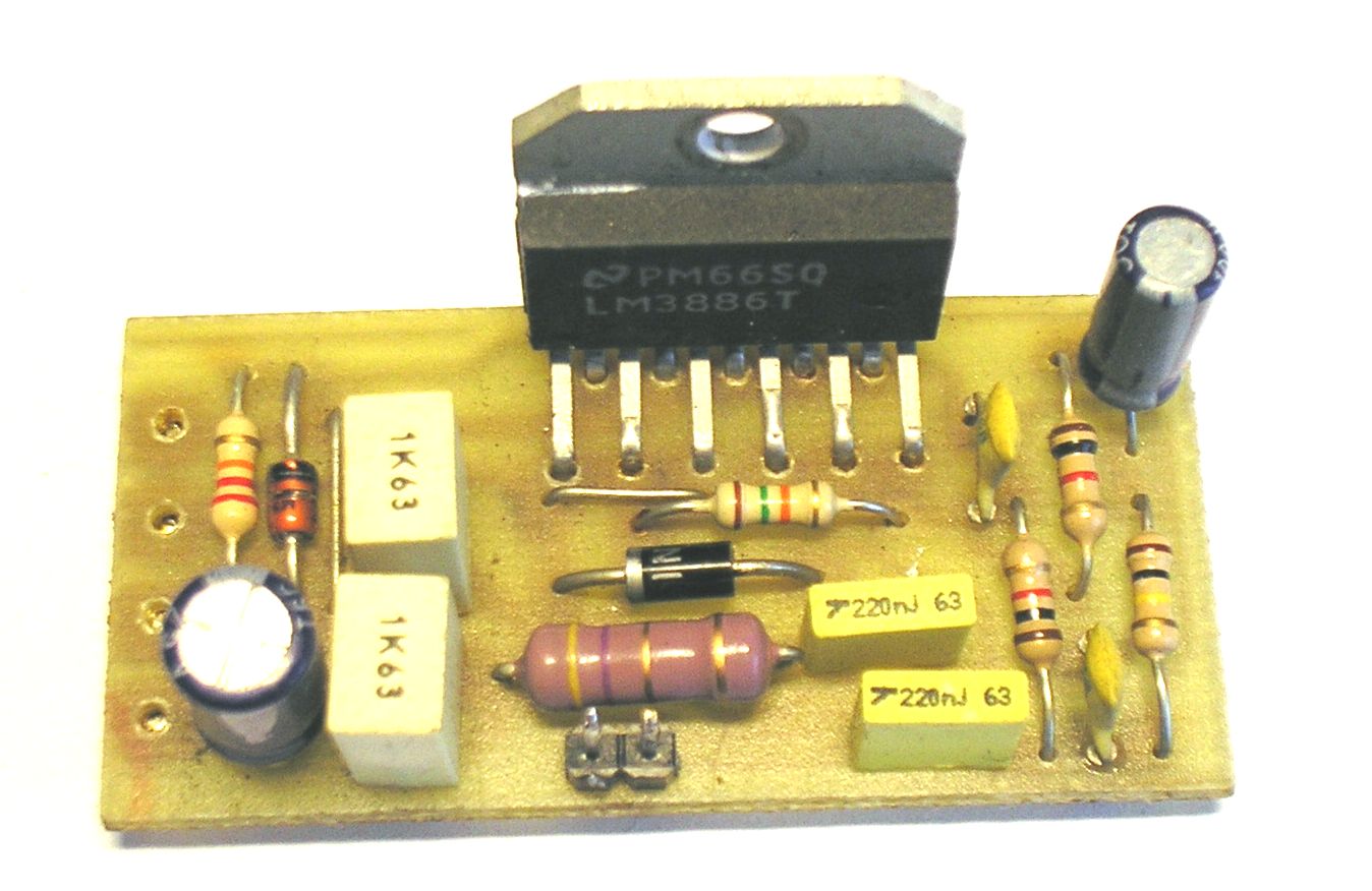

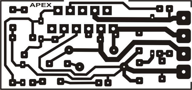

Prasi
Prasi's single PCB tested with TL072 and works great 🙂
No switch on and off noise, sound is coming out nicely and rich.
After listening to music for about an hour and half, my IC is just still cool, you touch even for +2min.
DC coming at 0.9mV while i listen to music.

I think regulators will shut down randomly. It depends on mfgr.
Some will oscillate and some will latch.
Input voltage too high.
Best regards.
Indeed, things looked suspicious so I googled a couple things. the OPA2134 has an absolute max power input of +/-18V, so if the regulators put out 18.01V (flip a coin and if it's heads they will), the op-amp has its specs exceeded. Likewise, the 7818/7819 regulator inputs are supplied by 35V, just exactly on the edge of their maximum voltage inputs.
I recall a thread a few years ago where several of us were trying to convince someone not to run things at their maximum voltage ratings, and it's not like they were in a major US or European city, they were in an area where parts are harder to get ...
Who "designs" these things?

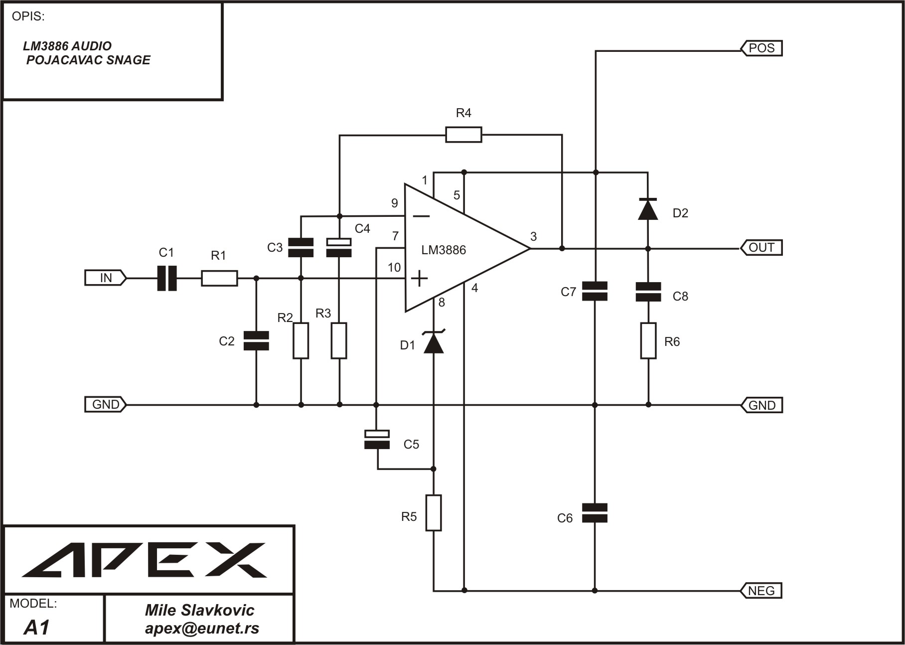

This is really nice schematics!
I am new to the diy audio and electronics in general.
What does UF4007 diode does? Connected to the output and +35V? Also, will 56R resistors help during the turn on when voltage from power supply can exceed more than 35V?
Thank you!
