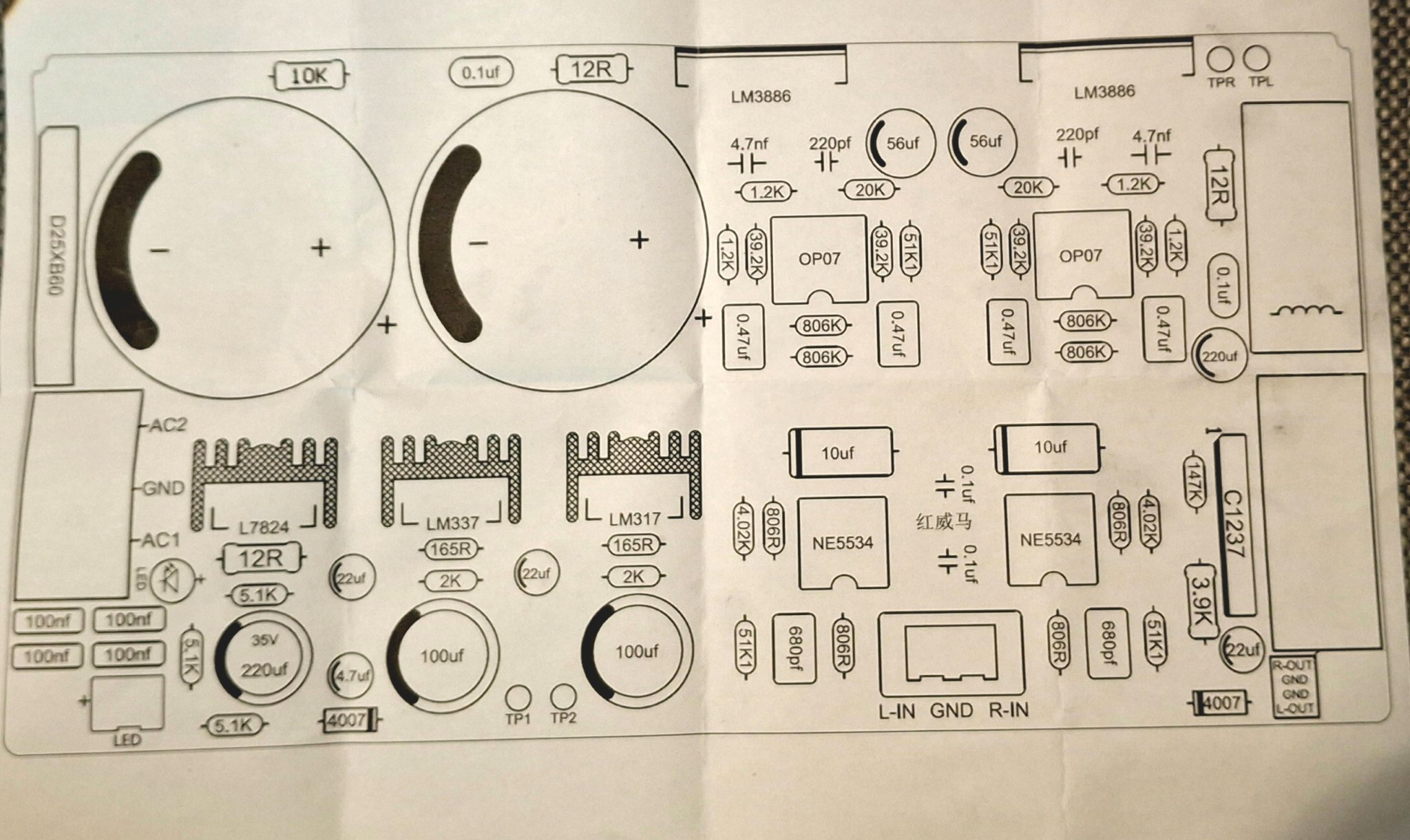

Hi :

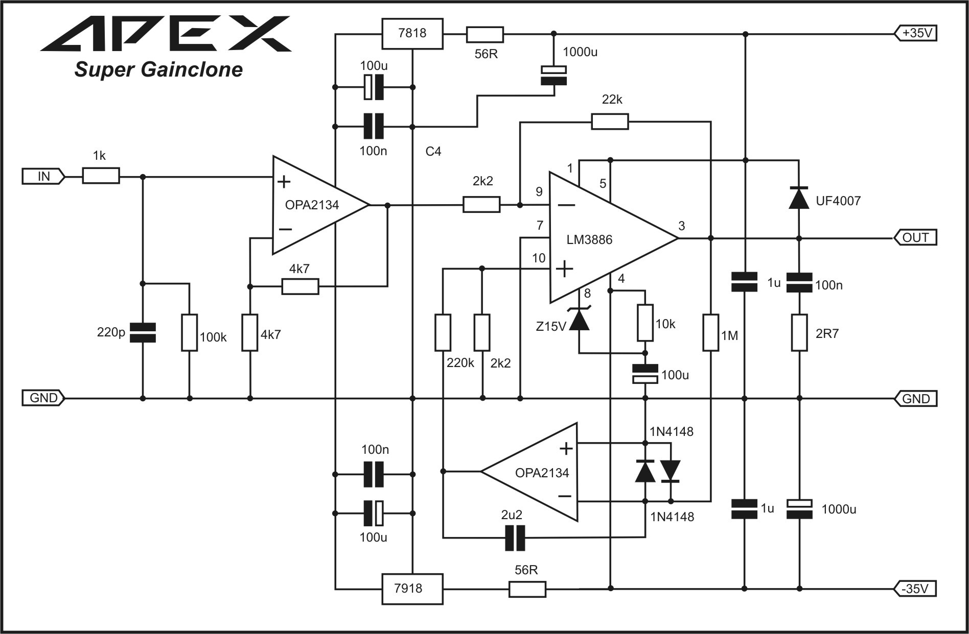

Can somebody help me with what the UF4007 does? Is it really necessary and will a 1N4004 be a good substitute?
Also how critical to performance is the 100uf that is connected to pin 4 through a 10K resistor?

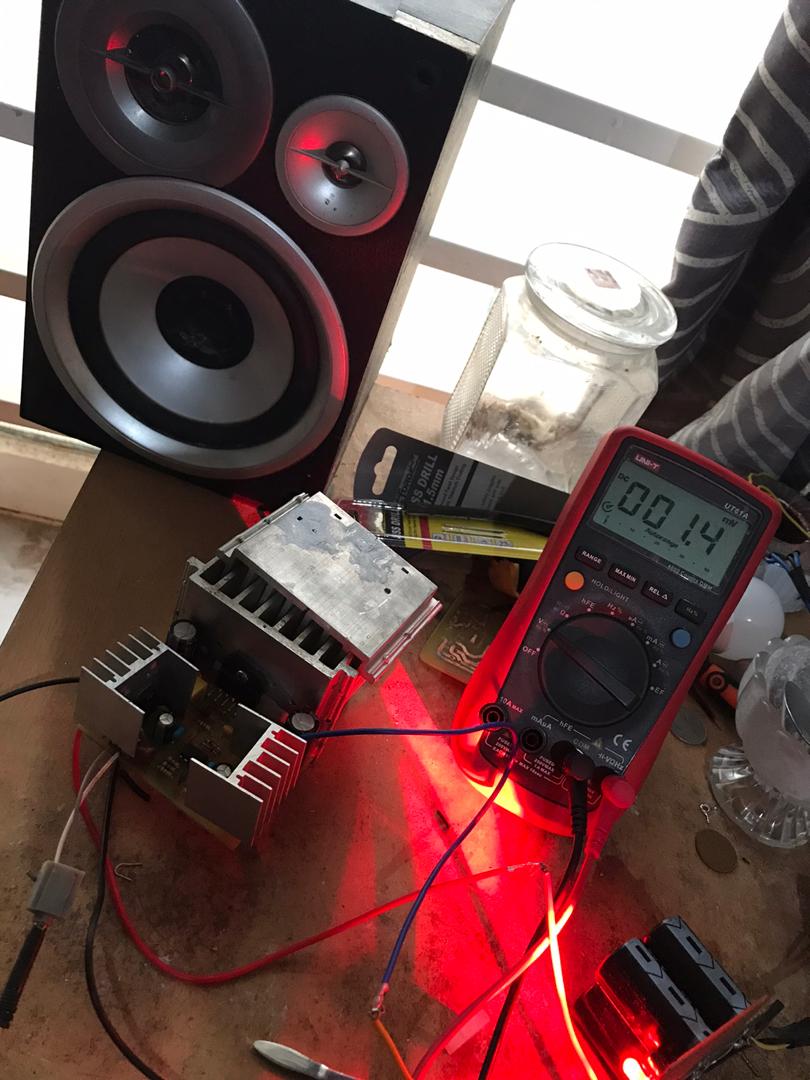

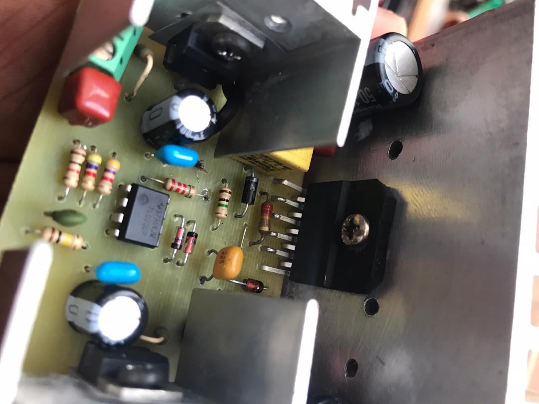

Prasi's single PCB tested with TL072 and works great 🙂
No switch on and off noise, sound is coming out nicely and rich.
After listening to music for about an hour and half, my IC is just still cool, you touch even for +2min.
DC coming at 0.9mV while i listen to music.
Am suing 22-0-22 Toroidal Transformer, test PSU 4700uF/63v x4

I think regulators will shut down randomly. It depends on mfgr.
Some will oscillate and some will latch.
Input voltage too high.
Best regards.
Indeed, things looked suspicious so I googled a couple things. the OPA2134 has an absolute max power input of +/-18V, so if the regulators put out 18.01V (flip a coin and if it's heads they will), the op-amp has its specs exceeded. Likewise, the 7818/7819 regulator inputs are supplied by 35V, just exactly on the edge of their maximum voltage inputs.
I recall a thread a few years ago where several of us were trying to convince someone not to run things at their maximum voltage ratings, and it's not like they were in a major US or European city, they were in an area where parts are harder to get ...
Who "designs" these things?

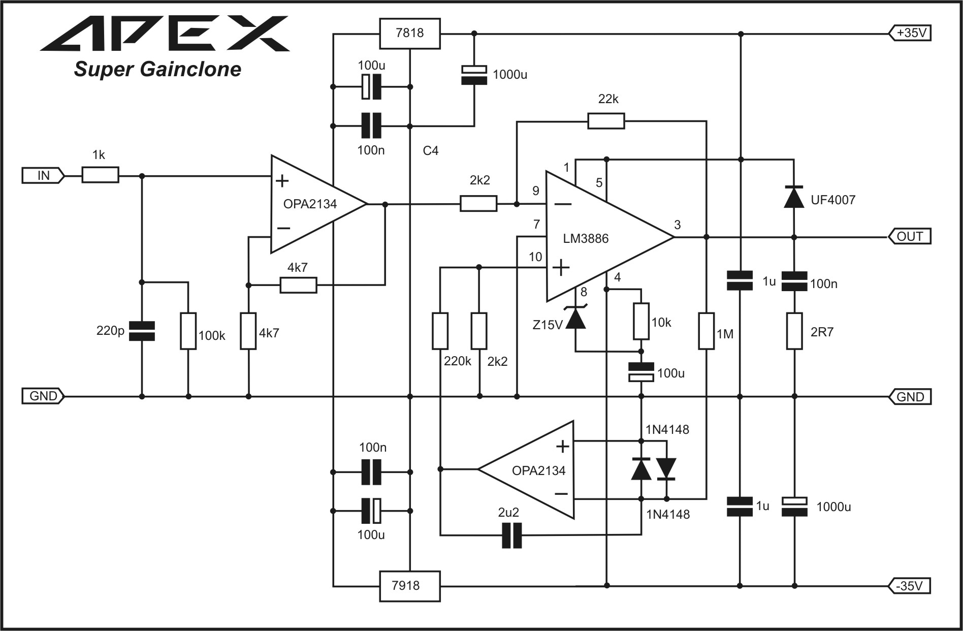

A "super gainclone" adds an input buffer so that the lm3886 can be run inverting and at lower gain.
The gain difference is minuscule: 10 V/V vs 11 V/V (0.8 dB difference). The main difference is that the inverting configuration of the LM3886 gives a touch lower distortion as the common-mode distortion is eliminated.
The original Super GainClone used fairly high resistor values (10 kΩ) in the inverting stage ahead of the LM3886, which increased the noise quite a bit. You can address that by lowering those resistors to 1 kΩ, but you then need a buffer stage driving the 1 kΩ impedance.
Personally, I would rather use the opamps to perform error correction by making a composite amp as I did in the Modulus-86. That's a different level of design challenge, though.
Tom
This is really nice schematics!
I am new to the diy audio and electronics in general.
What does UF4007 diode does? Connected to the output and +35V? Also, will 56R resistors help during the turn on when voltage from power supply can exceed more than 35V?
Thank you!

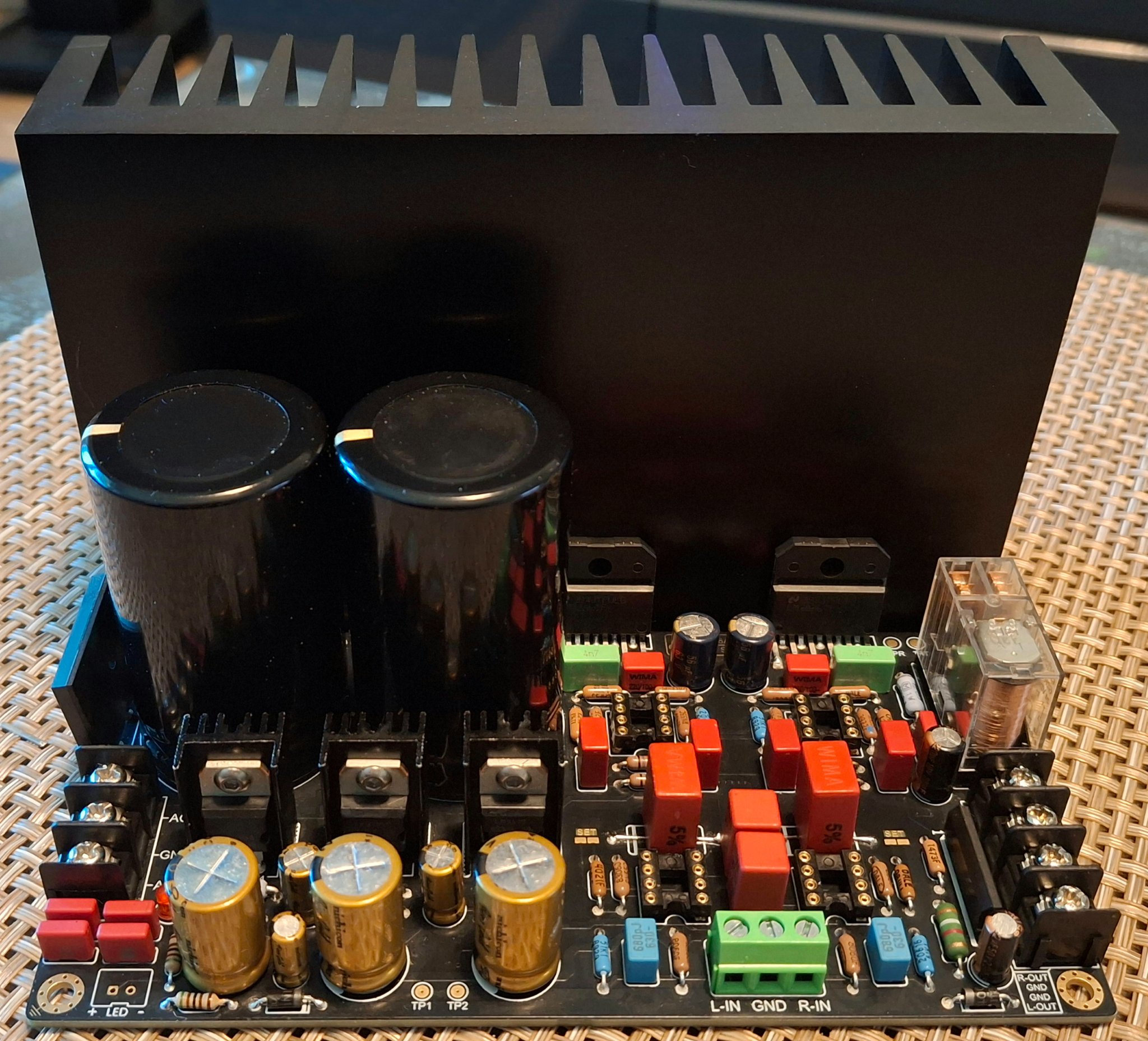

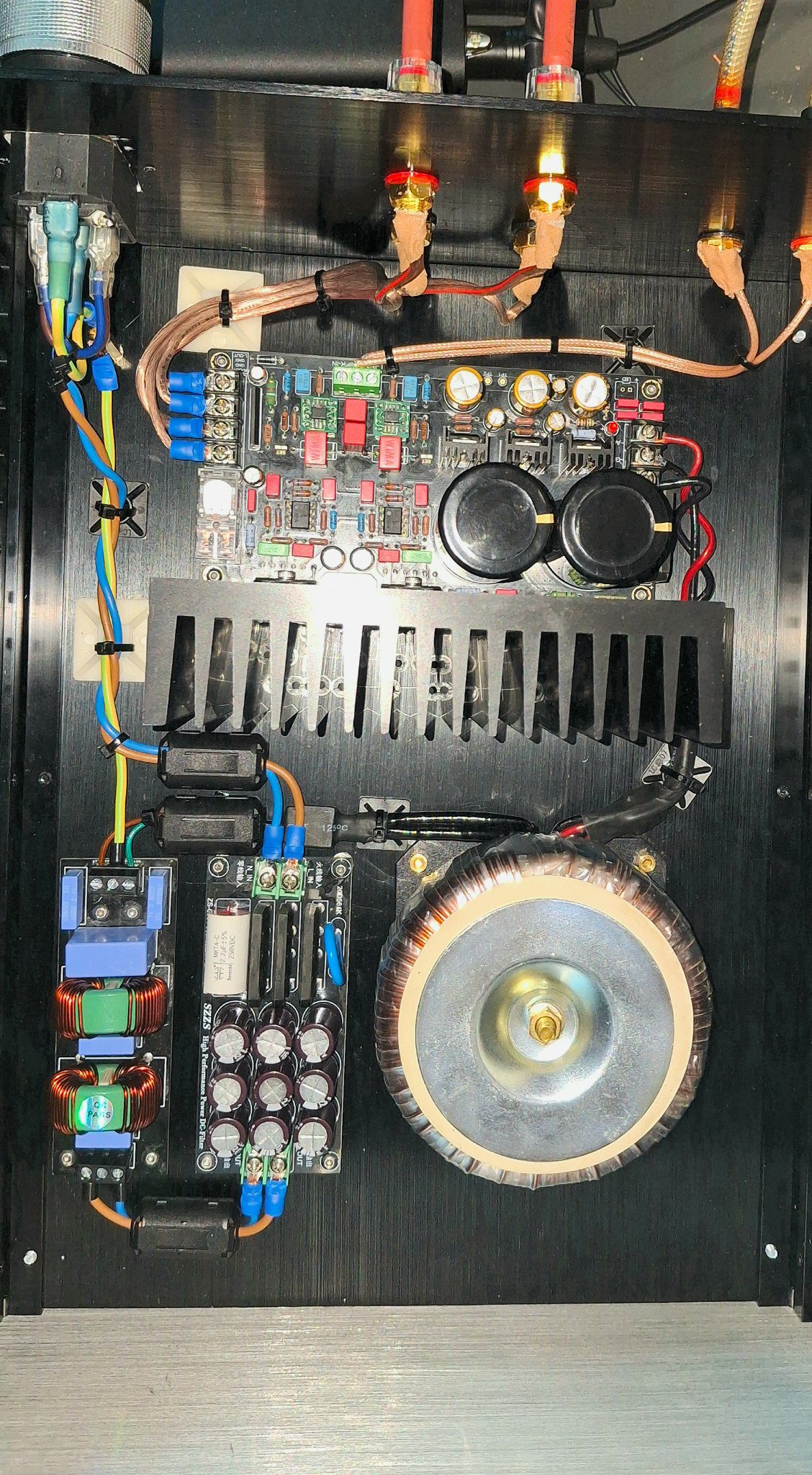

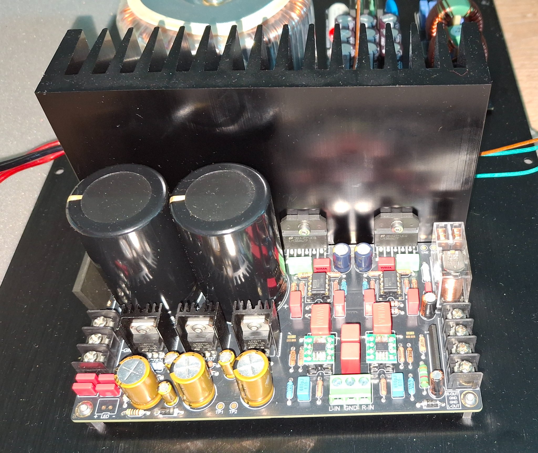

Hi Tom,

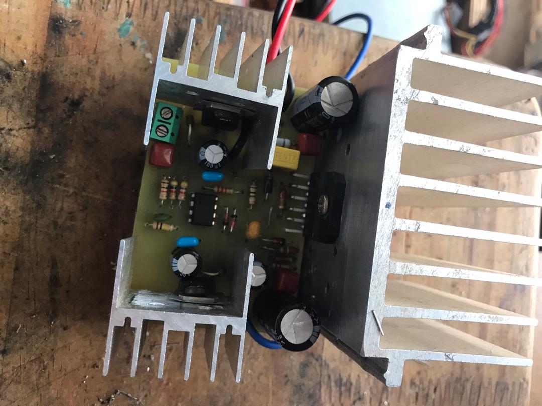

I built an LM3886 amplifier, and it sounds fantastic. I swapped the NE5534 for an OPA1655 and the OP07 for an OPA277. I also replaced the 10uF electrolytic capacitor on the op-amp with a 10uF Wima MKS. Can you explain what I built? It sounds better than my Nait 5si.
