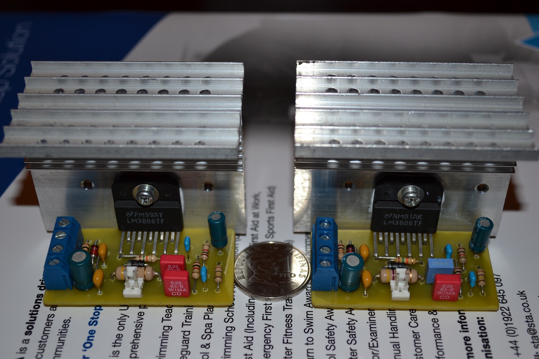

Just to share one of my favorite APEX collections LM3886 Chip Amplifer...
What software did you use to recreate this ? It looks very nice.
Hehe, I understand the feeling. 😀I can't stop my self to build again and again.....😀
I enjoy a lot with this very very nice amplifier of APEX

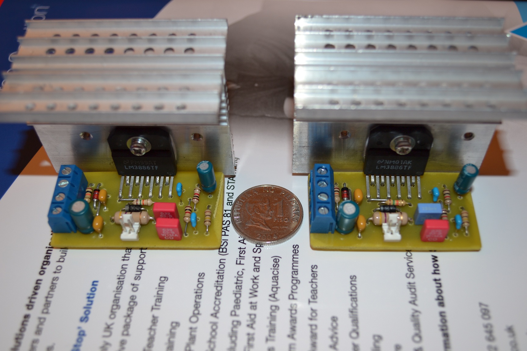

Today another 2 new born babies singing beautifully...😉😀
Nice work and is this heatsinks from ATX PSU?
Regards
Regards
Thanks... and Yes that's for ATX PSU but for testing only, will move that later into bigger heatsink.

Yep!... started 2.1 channel With apex LM3886 for speakers and AX-14 For subwoofer
here are the pics
Uploaded with ImageShack.us
here are the pics
ATX heatsinks are good?
Reading from your posts, i find you used processors heatsinks, so i asume i can use those too? Of course with a 4 in. fan blowing fullspeed all the time?
Processor heat sink for testing with speed controller fan is ok, but I don’t recommend for long term use, but if you accept the noise of high speed blower fan it should be ok.
