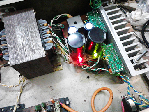

Lots of twisting well done.
Short cable runs, good.

All done!
Finally got around to building it and it's done! Mr Mile, i have already made a PCB for your preamp with TL074, could you tell me what transformer do I need, 12-0-12 or 15-0-15 and should 2x250mA be sufficient, or do I need more or less? Thanks!
Very cool! nice and pro-
LazaKamikasa whwt transformer did you use?
i saw there are two transformers...
Thanks! The torus is 200VA 2x24V for the actual amp, and the small one is just 1A 9V I had laying around for the fans.
Nice work but wrong resistor 4k7/2W must be replaced with 4R7/2W. Use 2x15V 250mA transformer for preamp.
