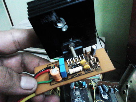

Hi all,
I made the LM3886 in a PCB as per Apex's design with so much optimism but alas! It's not working for me. 🙁 I am lost where I made the mistake.
I powered it up with a 15-0-15 VAC 2 amp transformer . Voltages are okay. But no sound, no hum. Total silent.
Is the IC faulty?
Need your kind suggestion/guidance to make it work.

Have you got a 10K resistor from -ve to the mute pin? Without this, the chip will be muted
Also, have you fed the board with 15-0-15 AC, or have you rectified it to give you +-21V DC?

Thank you so much Port... for your prompt reply.
I double checked the 10k Resistor and pin 8 and the zener diode. All okay as it seems.
Sure, the supply supply is rectified dual with 4700 uF X 4
Very strange. Is there anything more that I should check before changing the Chip?

The circuit is pretty simple, there isn't that much to go wrong. Have you got any voltage at all on the output? I don't use a Zener diode on the mute pin, I simply use a 10k resistor from -ve to it as in the LM3886 datasheet. You could try removing the Zener diode from the circuit and link it with a wire.
.........Have you got any voltage at all on the output? I don't use a Zener diode on the mute pin, I simply use a 10k resistor from -ve to it as in the LM3886 datasheet. You could try removing the Zener diode from the circuit and link it with a wire.
Ohh! I will remove the zener too and report you back with voltages at various pins, in some hours.
Thank you really so much!
