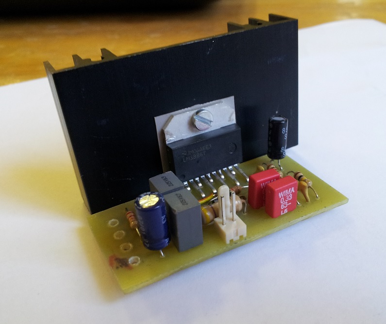

Just slapped it together to see how it sounds,
And must say lovely small pcb and amp.
Ill put a decent heatsink on it later 🙂
Nice work
Regards

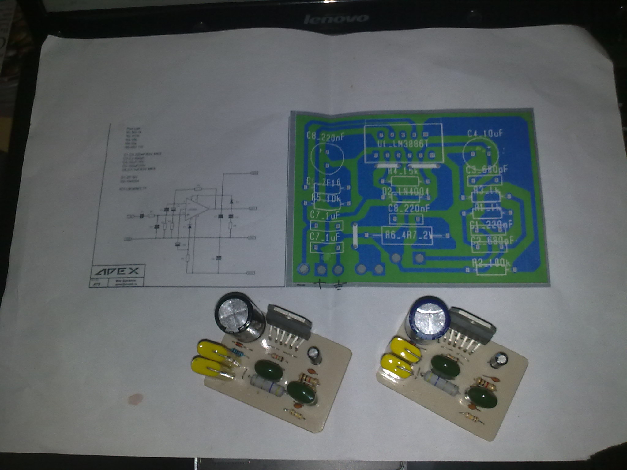

Hi apex,
this is my LM3886T project, and nice combine with my new small speaker 6" 😀
BR,
Nice work,
Regards
Nice work,
Regards

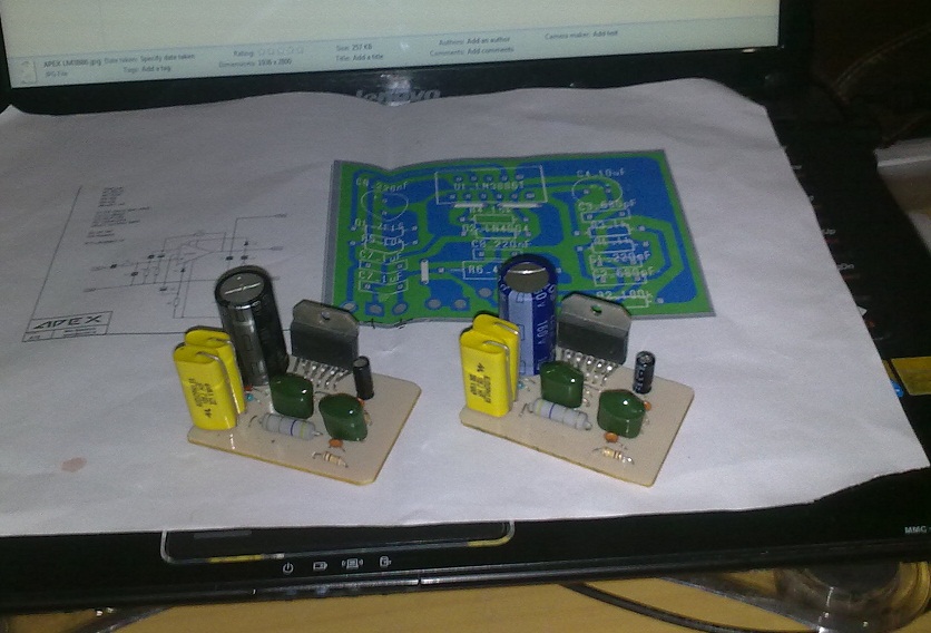

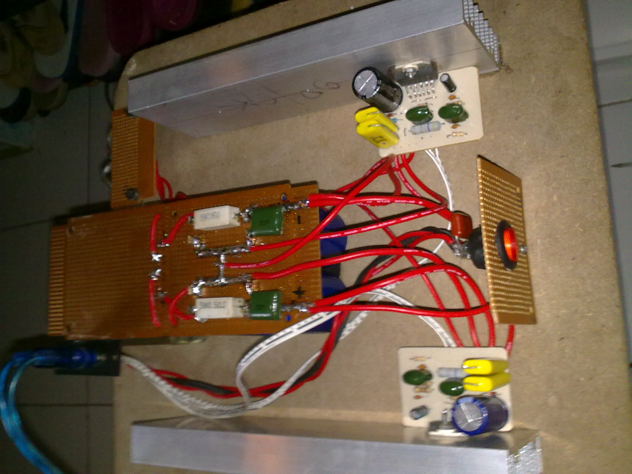

Hi Apex,
i want to ask about component for this Amp,
how much difference sound, if using good quality components or using component like i used at the picture? only poor ceramic capacitor, and other.
i need advice for that, before plan to buy good quality component,
have much different or not, because for now the sound is good enough.
thanks Apex,
BR,

Most of your components look fine.
You might want to try to fit 1uF or more (or less) of film cap directly between each of the chip's power rail pins and the main power ground trace, connected VERY close to each power pin. If you could also get 220 uF (or as much as possible) connected directly at each power pin, and to the main power ground, that would be very good, too.
With the film caps, unless you have a scope you will want to initially look for signs of oscillation, in case you get unlucky (e.g. excessive chip heating). But without SOME small cap connected directly at each power pin, to gnd, you increase the risk of high-frequency oscillation. If film won't work, use ceramic, but not the "good" ones like C0G or NPO; you would want a little more loss, to damp any oscillation tendency.

thanks for your best answer,i will try using more than 1uF metal film caps,
for 220uF and 10uF at schematic, can i use more bigger volt value more than 160V?how about impact to the sound?
at my kit, using 220uF/160V and for 10uF still using 10uF/25V (will change with 160V 😀).

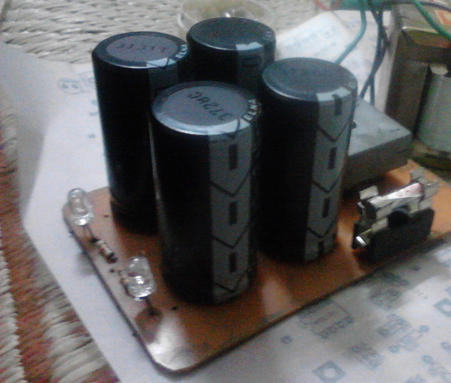

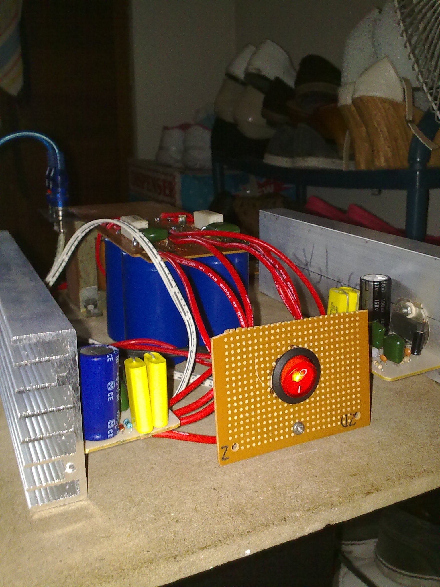

Hi Apex,
This is update for my LM3886 amp, no box there 😀
PSU using 10000uF x 4, 😀
and with Trafo 3 Ampere (so only 36 watt per-channel) 🙁
BR,
Nice work, 36W is enough for home listening.

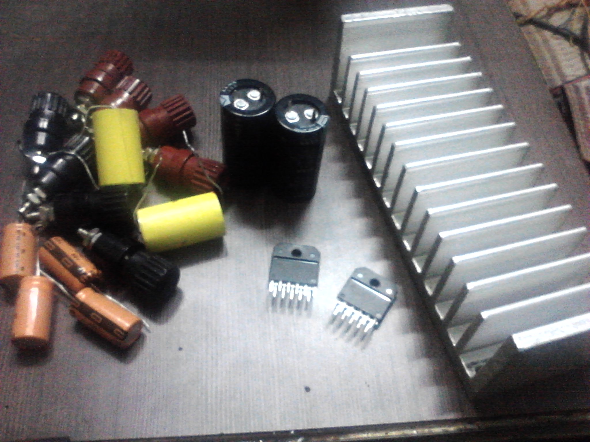

Starting my first LM3886 bi-amping
I bought some components yesterday.
Is the size of the heatsink ( 6 cm X 17cm) okay to mount two LM3886 ICs for proper heat dissipation?
Best regards,
Som

60 by 170 should be enough for a pair of 3886. But check the National datasheet for their guidance.
Then I recommend you double what they say.
Thank you Andrew.60 by 170 should be enough for a pair of 3886. But check the National datasheet for their guidance.
Also I have a 30-0-30 @ 5amp Transformer. Can I use that with 4 X 4700 uFd 63 v in the PSU ?
