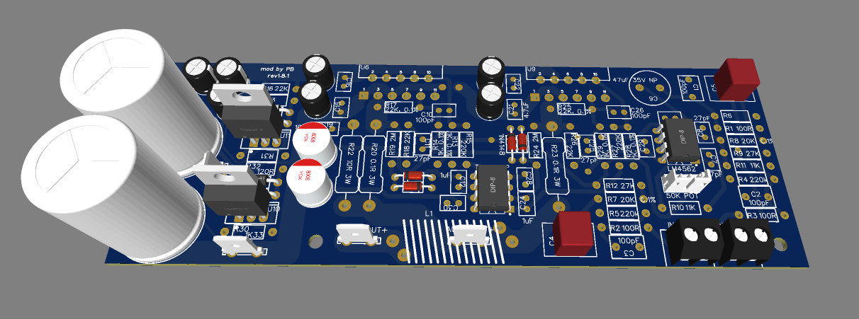

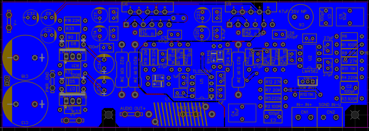

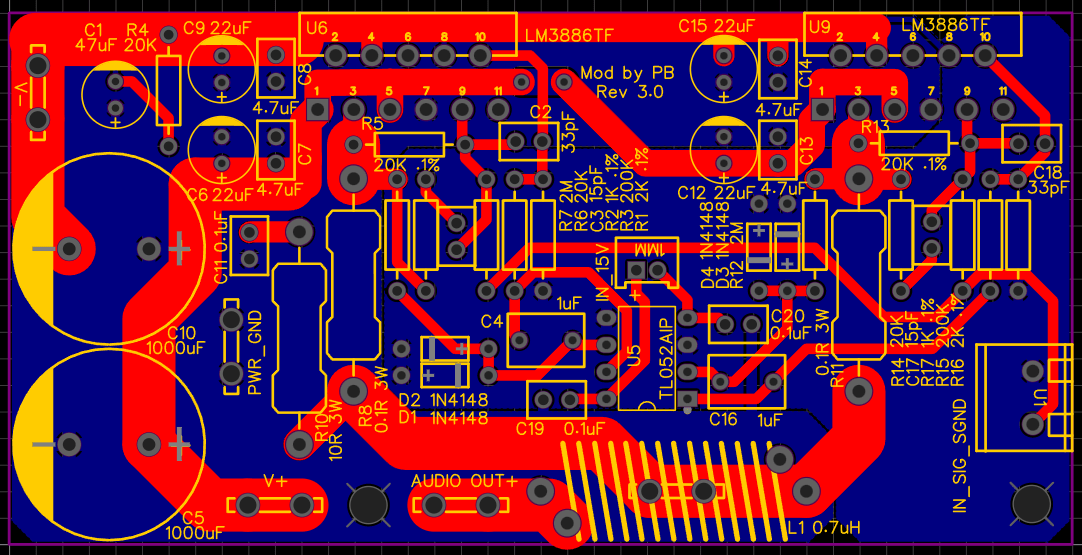

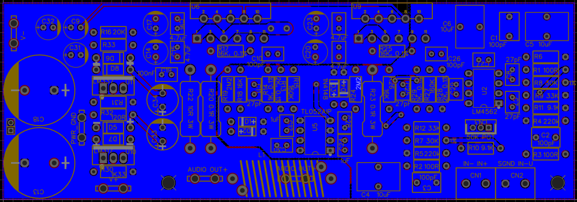

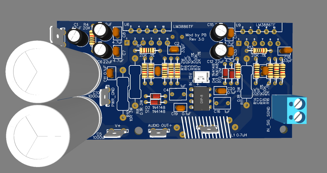

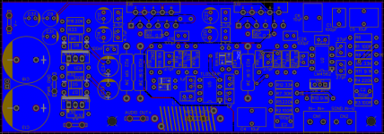

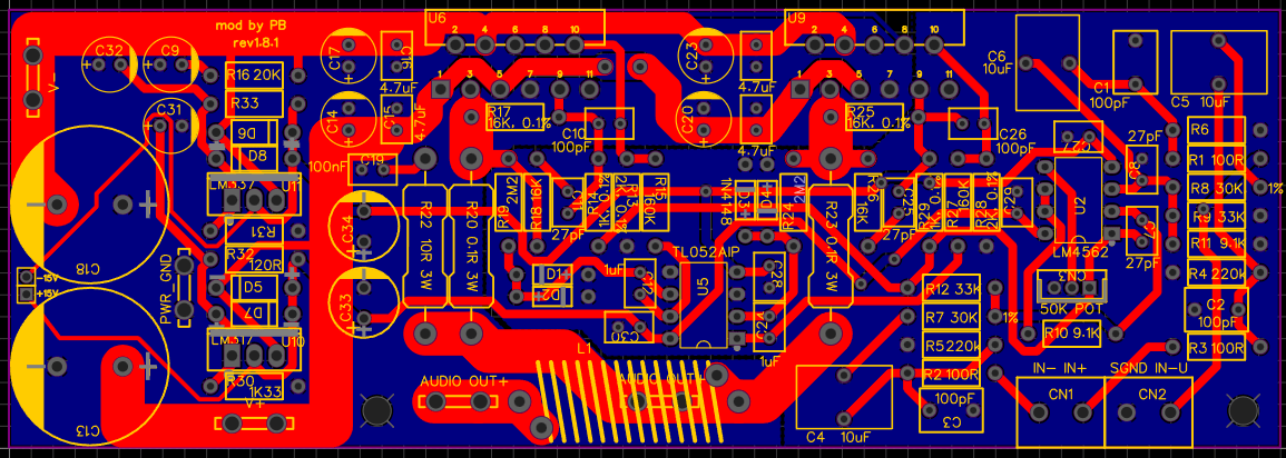

Latest update on this one with better ground plains and proper decoupling for each chip.
For input buffer and servo opams decoupling capacitors were connected to the signal ground - is that bad? will it introduce power supply ripple into a low signal ground at all?

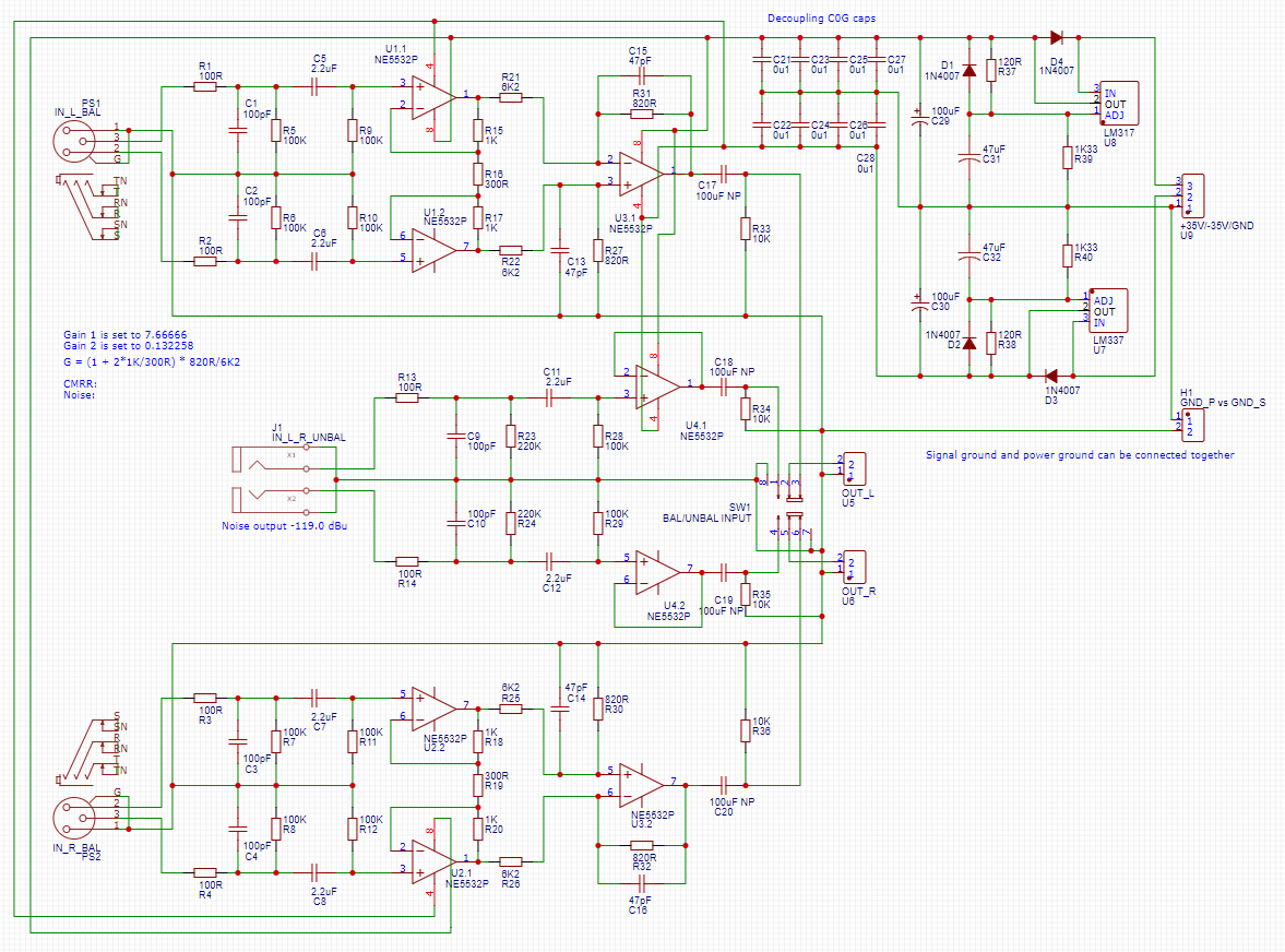

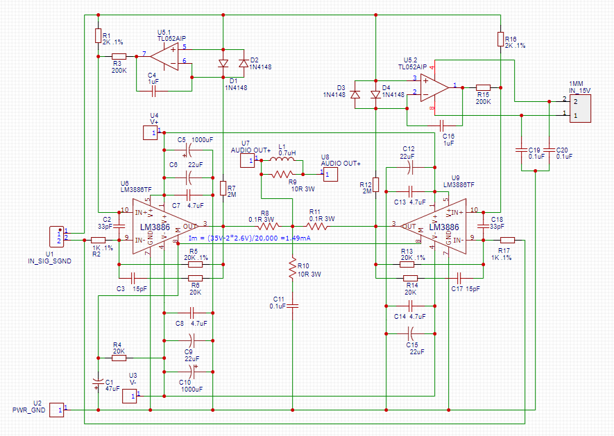

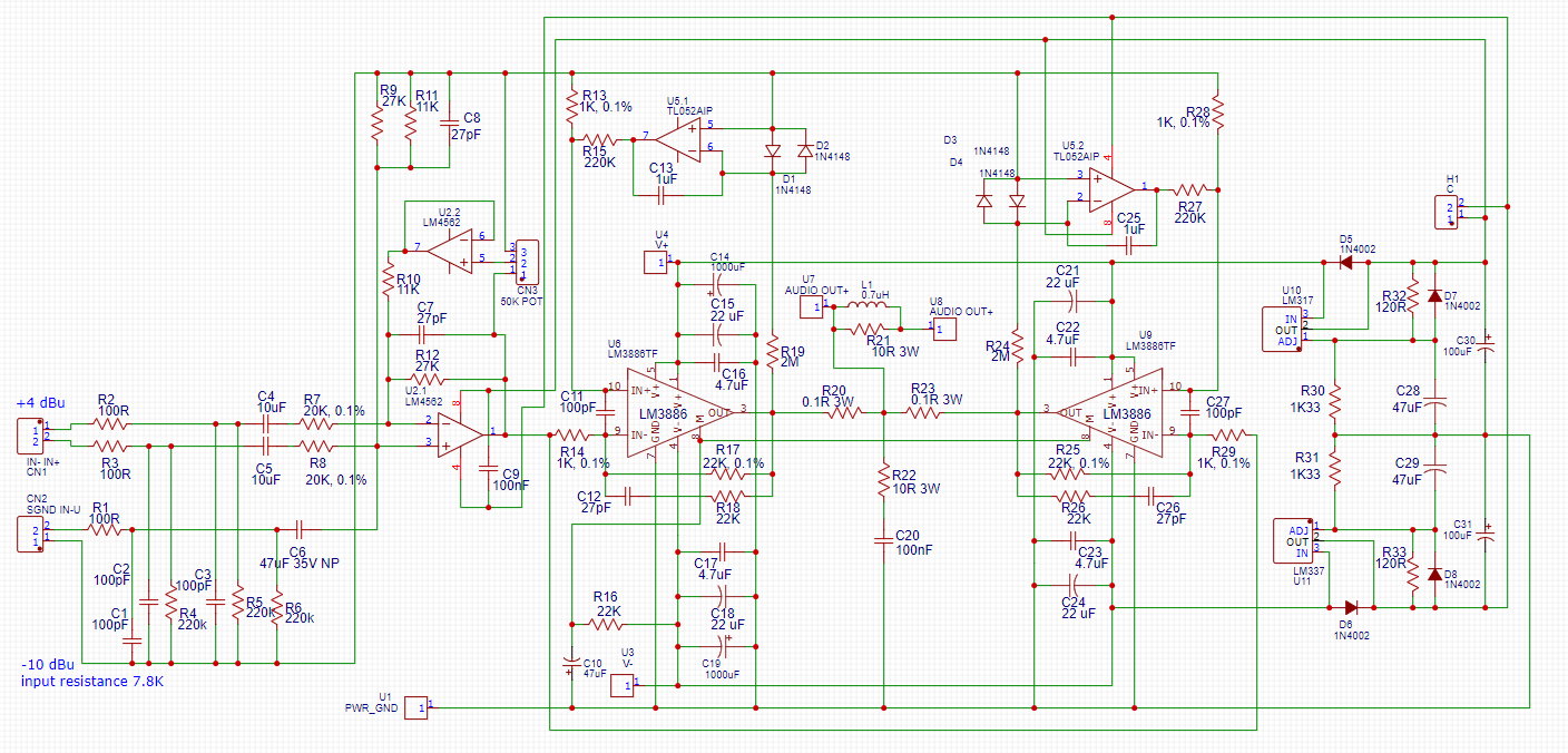

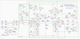

I am thinking about splitting the schematics into two separate modules: preamp and power amp.
Attached schematics are for both.
Setting gain to 10V/V is the minimum gain required according to the datasheet. Will it negatively impact stability or any other characteristics of the LM3886 to do so?

That would be dBu not dB. Or so I'm assuming anyway. dB without a reference is meaningless unless we're talking unit-less ratios such as gain.
+4 dBu = 1.23 V RMS
-10 dBu = 245 mV RMS
Handy-dandy calculator: http://www.sengpielaudio.com/calculator-db-volt.htm
Common gains are:
+23 dB (= 14.1 V/V) for balanced
+29 dB (= 28.2 V/V) for unbalanced
+26 dB (= 20 V/V) used to be very common but I get the sense that 23 and 29 dB have taken over. I usually design for 20 dB (= 10 V/V) for better gain structure.
Thanks,
Pavlo
You can run the LM3886 with 20 dB gain (10 V/V). You just have to be a bit careful with the not-so-optional stability components (Cc, Cf, and Rf2 in the data sheet) if you do that.
The TI simulation model doesn't capture the behaviour near the supply rails, so you'll have to experiment a bit once you build the circuit. Just run a sine wave into the amp and apply a 4 Ω load. Slowly dial up the amplitude until the amp approaches clipping. It should clip cleanly without buzz on the waveform.
Tom

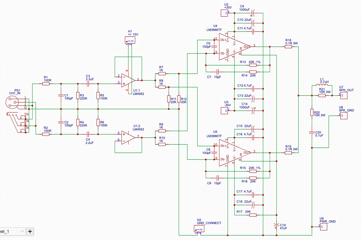

As I progress learning more the schematics is being changed to reflect that new information.
For the input levels I think I finally got it. Two levels +4 dBu and -10 dBV. Also, +4 can be balanced or unbalanced. From what I understand, balanced level means double voltage, so in total it is 2*4 = 8 dBu.
As far as connectors, you have XLR or TRS jack that are used for balanced interconnections. You also have RCA phono connector that can either carry +4dBu level or typically -10dBV level signal.
According to that, the latest changes to the schematics are as follows:
- for unbalanced RCA inputs the input buffer gain was set to ~x4 to bring -10 dBV signal to the proper level
- for balanced XLR or TRS inputs attenuating resistors' values were adjusted to gain of x0.7 (21k/30k). (to set gain to x0.5 increase 30k resistors to 39k or 43k)
- gain for both LM3886 was set to 16V/V
All of those are for the 50K gain potentiometer adjusted to the max. Adjusting it to the min allows for wide variety of inputs to be connected to the amp.
Servo resistors were updated as well.

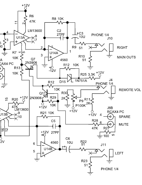

I just found out that so called balanced output of the Rolls RM67 is a "fake" one! It is done using resistors only! Not proper inverting opamp!
Attached is a screenshot.
I am thinking now to simplify the design now since I do not need balanced inputs in my amplifier. All I need is just input buffer.

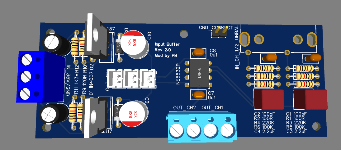

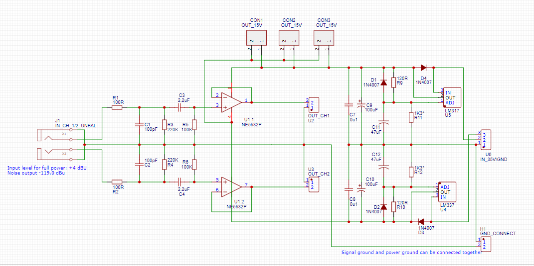

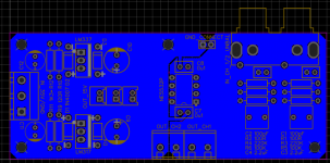

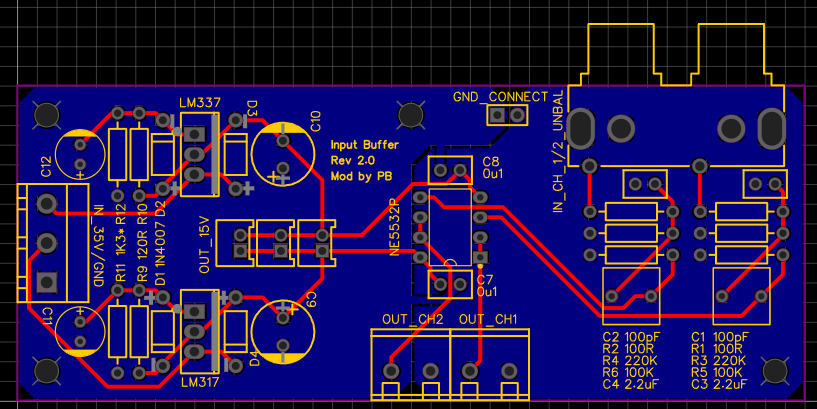

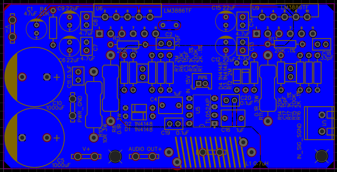

Input Buffer Module is a separate board now. It includes input audio filtering, voltage follower opamp, and power regulation.
This is designed to be used together with the main amp board.
The gain is set to none since this is a voltage follower.

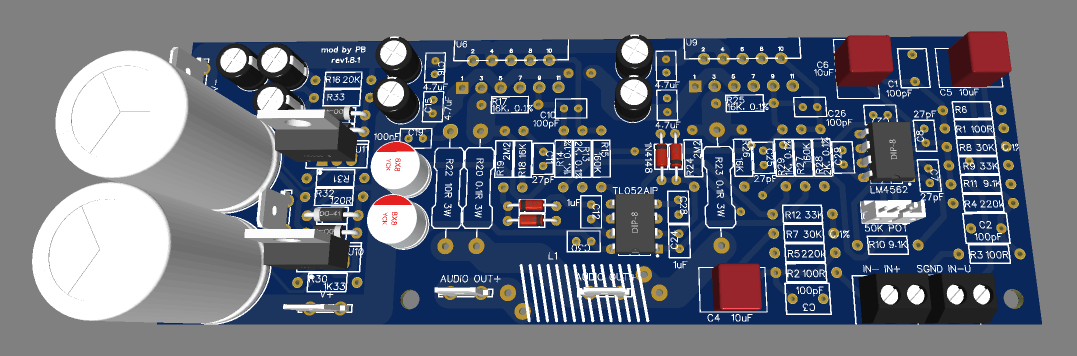

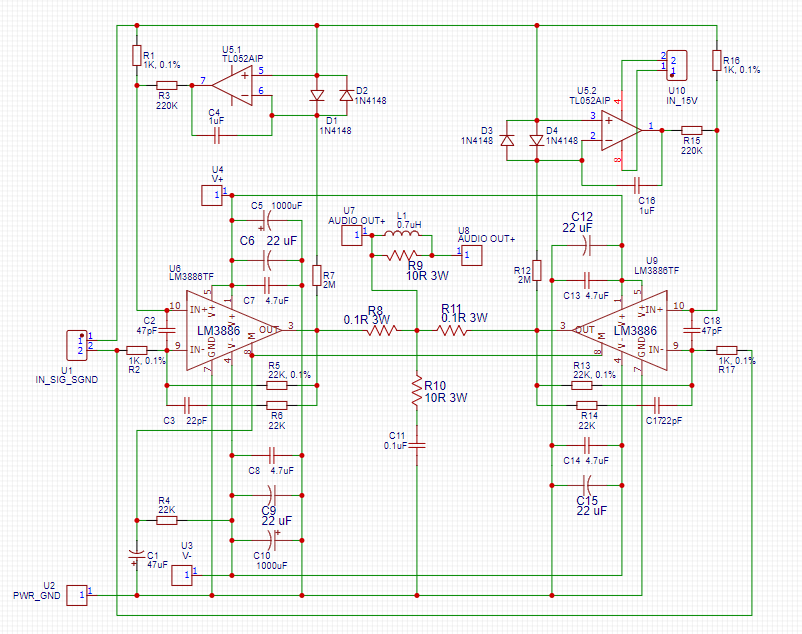

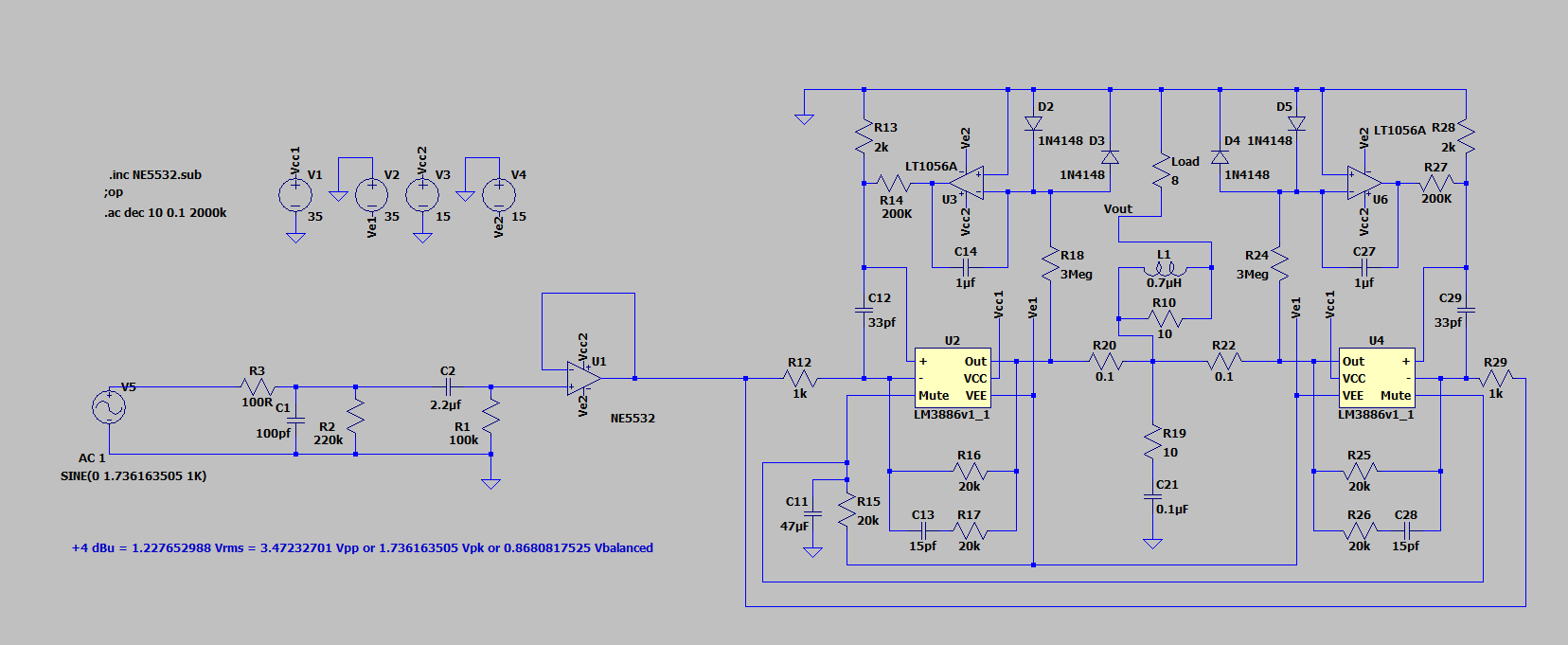

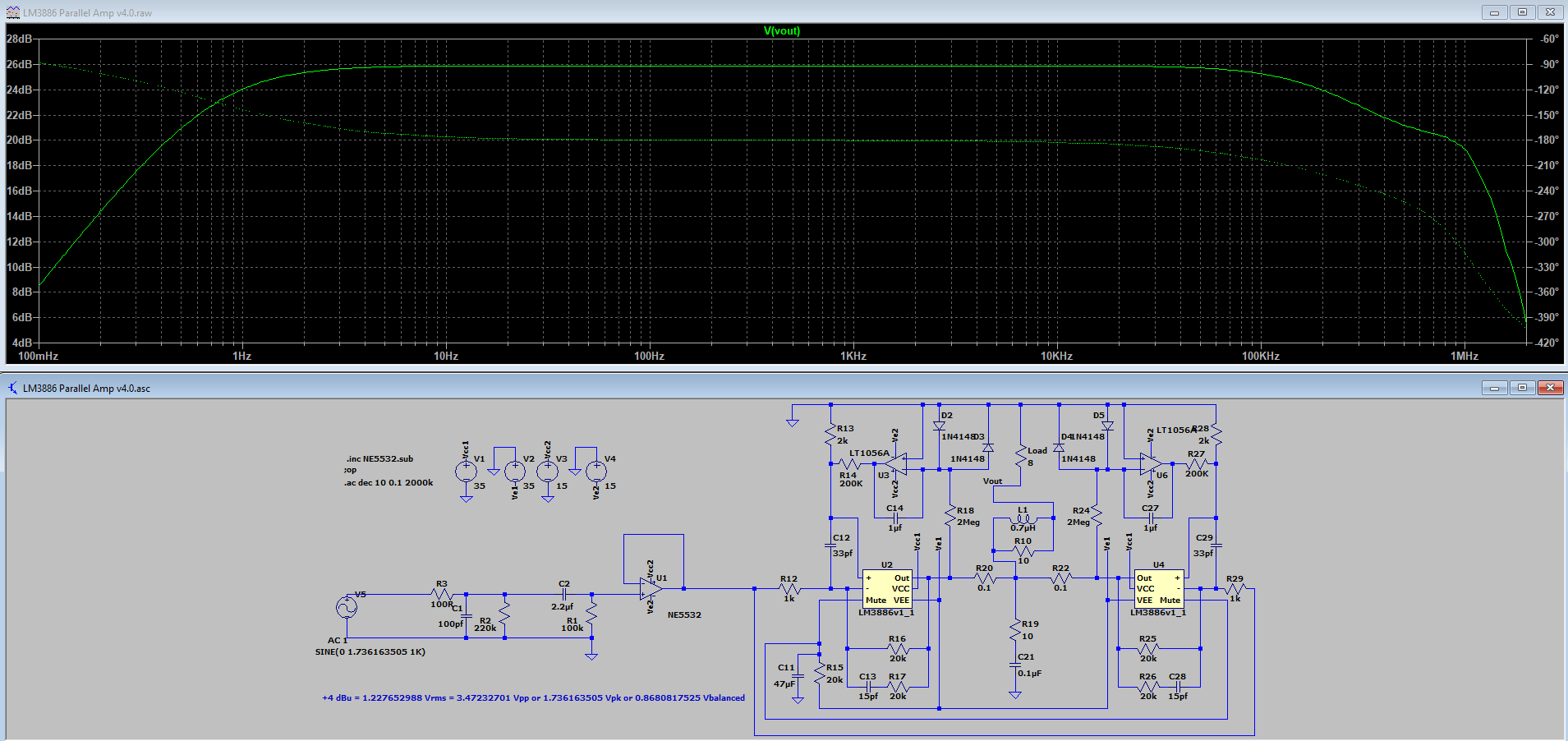

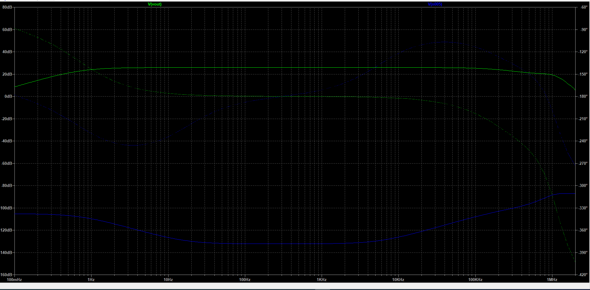

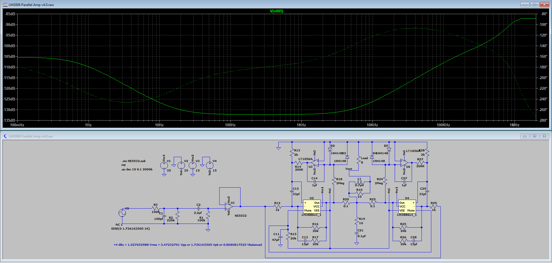

Power Amp Module is a separate PCB board now. It includes two LM3886 chip amplifiers connected in parallel. Audio signal from the previous board is fed to the inverting inputs of both chips. The board also includes DC servo circuit.
The gain is set to 20 V/V. With +-35V supply amplifier will develop the full power output if fed +4 dBU level input signal.

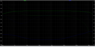

All resistors and capacitors were adjusted using LTSpice simulation to give optimal frequency response.
That's pretty common. Some call it "impedance balanced". It's still a proper balanced out as there is no need to actively drive both signal lines unless you need the extra voltage swing. Here's a nice article by Bruno Putzeys that addresses this.I just found out that so called balanced output of the Rolls RM67 is a "fake" one!
I am assuming that I can just use one of the output signals to drive my amplifier - all I need is a Tip and Sleeve portion of the TRS jack out - connected to the innner and gnd of the RCA input of my power amp. I am expecting +4dBU output level signal. Is that correct?

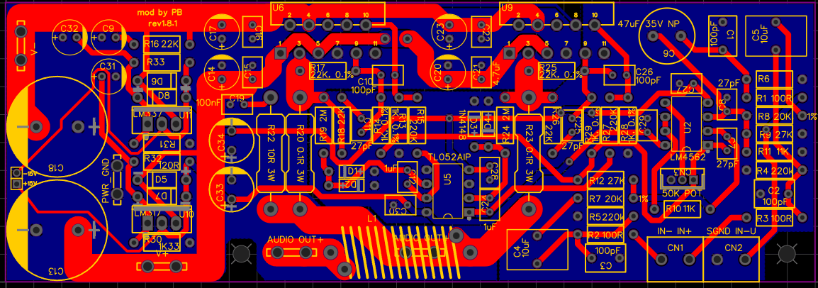

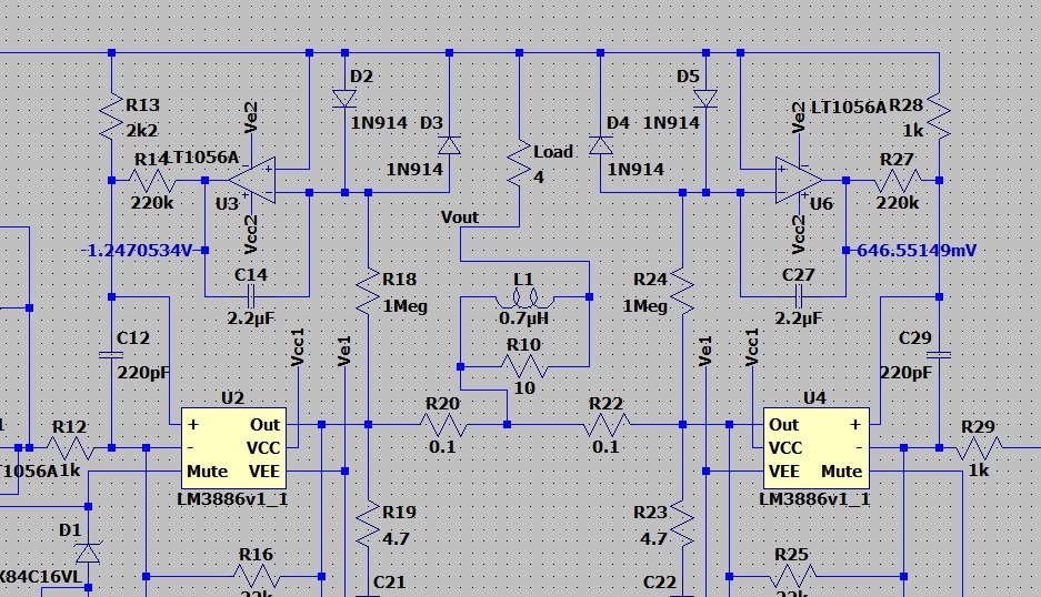

It probably makes no difference in practice simply because you have a DC servo to correct any offsets. When the amp is built for real then ideally you want a value of resistor that gives 0.00 volts DC at the output of the servo opamps. In the simulation the DC voltage is around 1.2 volts with a 2k2 and half that with a 1k. Remember you have up to -/+ whatever the opamp supply is as a correction voltage and so its a non issue.
Here is 2k2 and 1k
Playing with servos a little more here. It looks like those resistors limit the amount of correction servos can apply. For example, I had a circuit where DC offset voltage at the input of the LM3886 presented was +170mV. With 2K resistor servo could only provide -110mV and with 1K only -56mV. Adjusting resistor to 4K7 fixed that to be -170mV.
Also, wierd way LTSpice was acting when I used 1k, 2k, 4.7k resistors - was running super slow and loading the PC a lot. Only 6.2k resistor value fixed the circuit and LTSpice was able to run fast again.
Some values can be slow to converge, it's an LT thing and sometimes altering a value by even a few ohms makes a big difference.
If the basic circuit has an intrinsically high DC offset then you have to decide whether you are actually using the servo to correct the offset of whether the 'servo' has actually become more of a bias source for the amp.

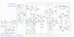

Found this video from audio science review on balanced vs unbalanced connections and I'm thinking now how would I go about changing the schematics to the balanced back again...
Here is a different approach that considers balanced inputs. It is just to illustrate the concept ("+", GND, and "-" are not connected between each chip)
I wonder if there is any way to implement servos in this schematics to remove DC offset at the output of the LM3886s?
