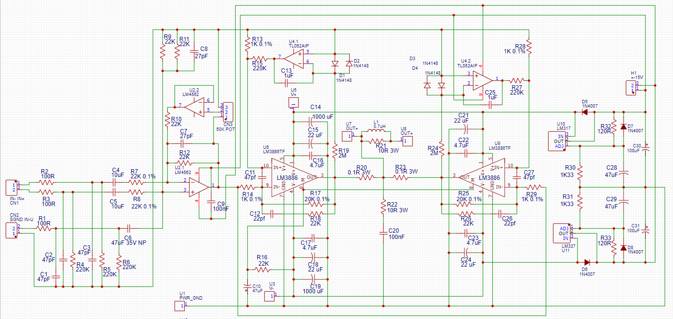

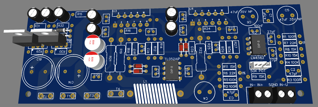

Mostly because I have four of LM3886 lying around since my student years. Adding pair of bjt on output would be interesting idea. I might dig into that...

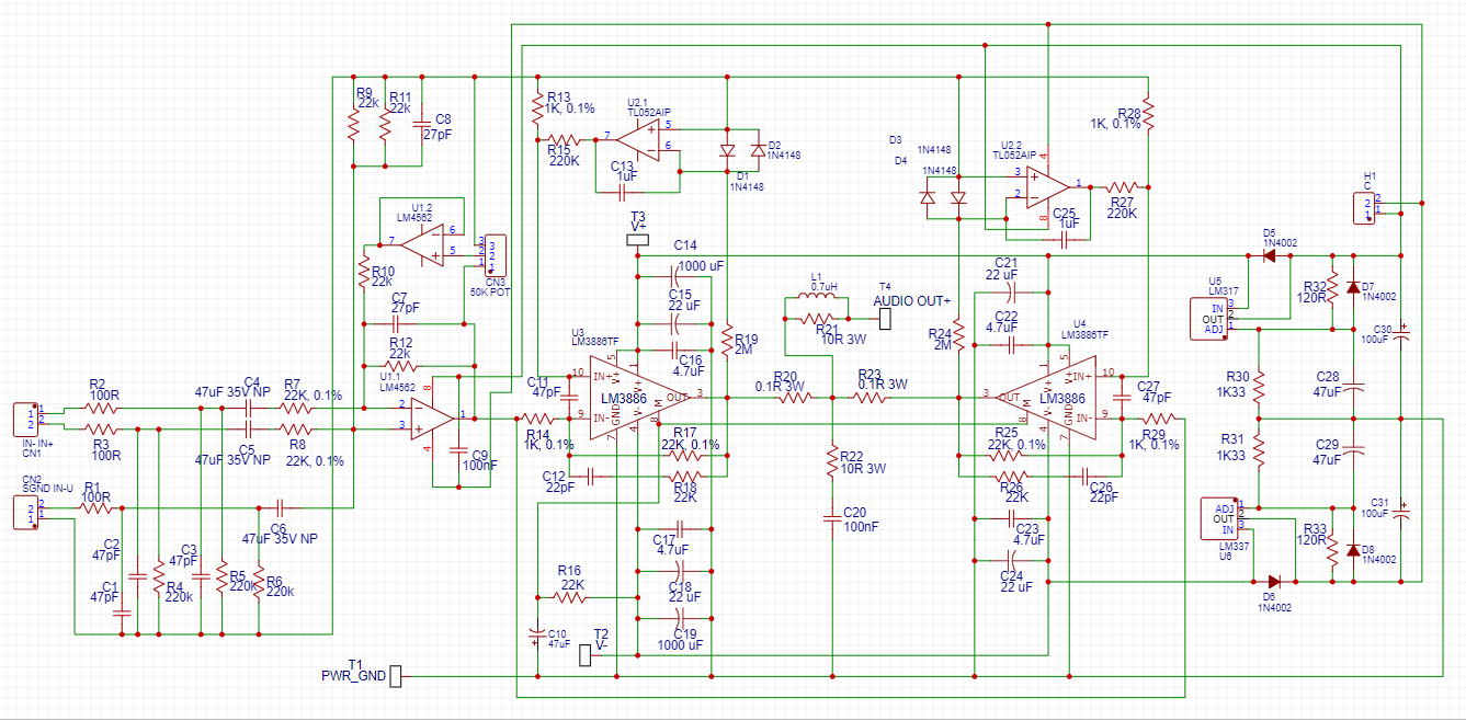

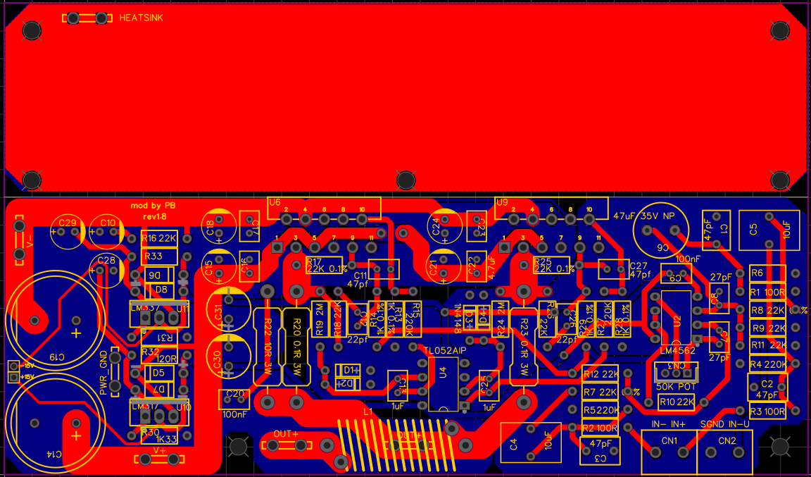

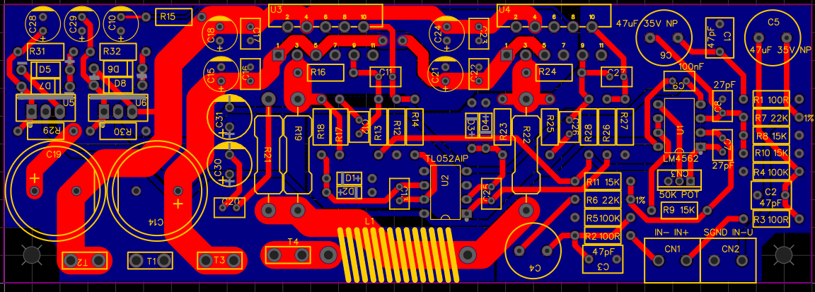

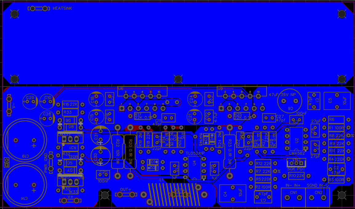

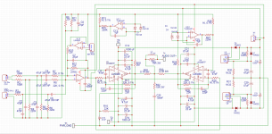

So far the progress is that I ran the amp in the simulator and fine tuned all of the capacitors and resistors' values to not affect 20Hz - 20kHz frequency response. I want to include gain adjustment at the input buffer, just because this solution is on the cover of the Small Signal Design book by D. Self 🙂 Not very practical, but I want to implement that "Self" line input lol.
As far as protection circuit - I decided I will put it on a separate PCB to dial down on the complexity.

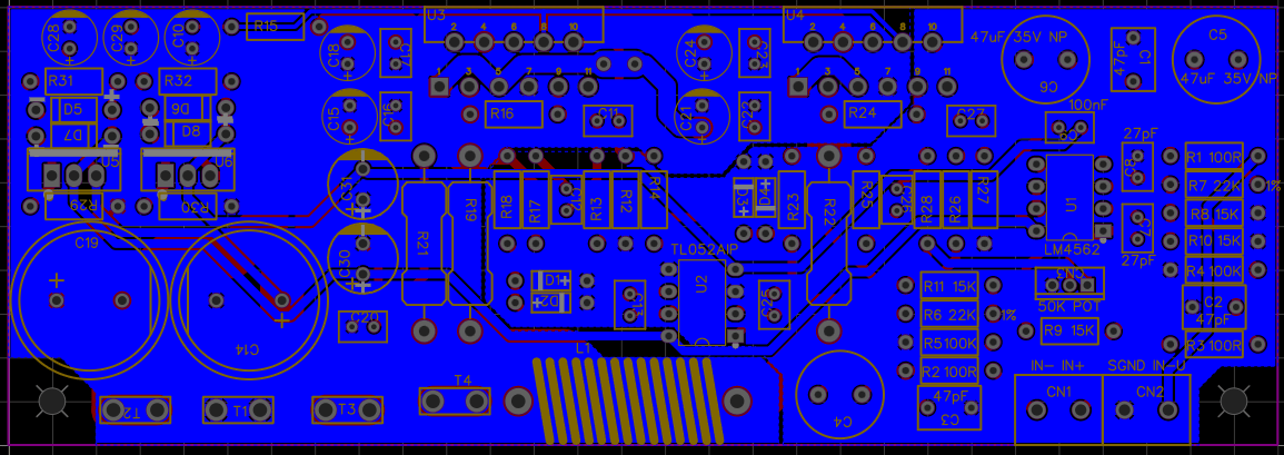

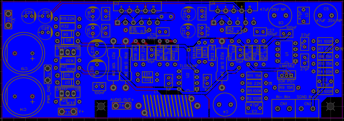

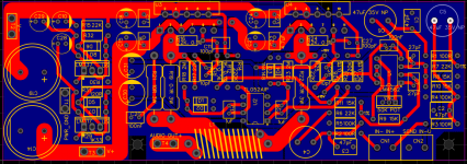

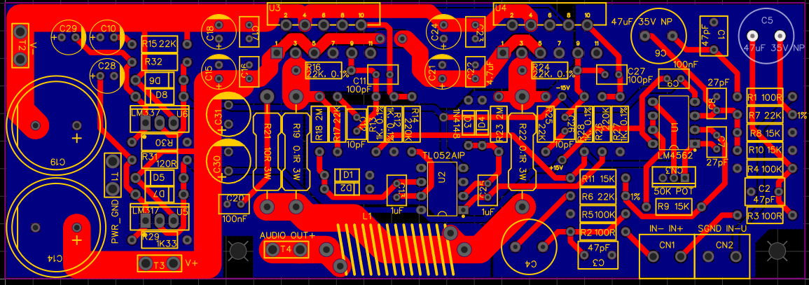

Latest schematics and PCB design attached. PCB size was changed to 50mm by 145mm.

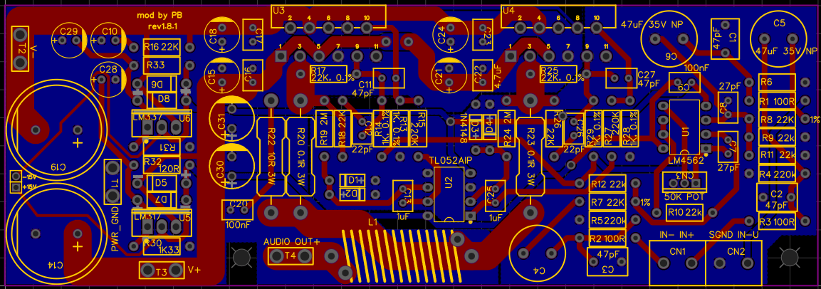

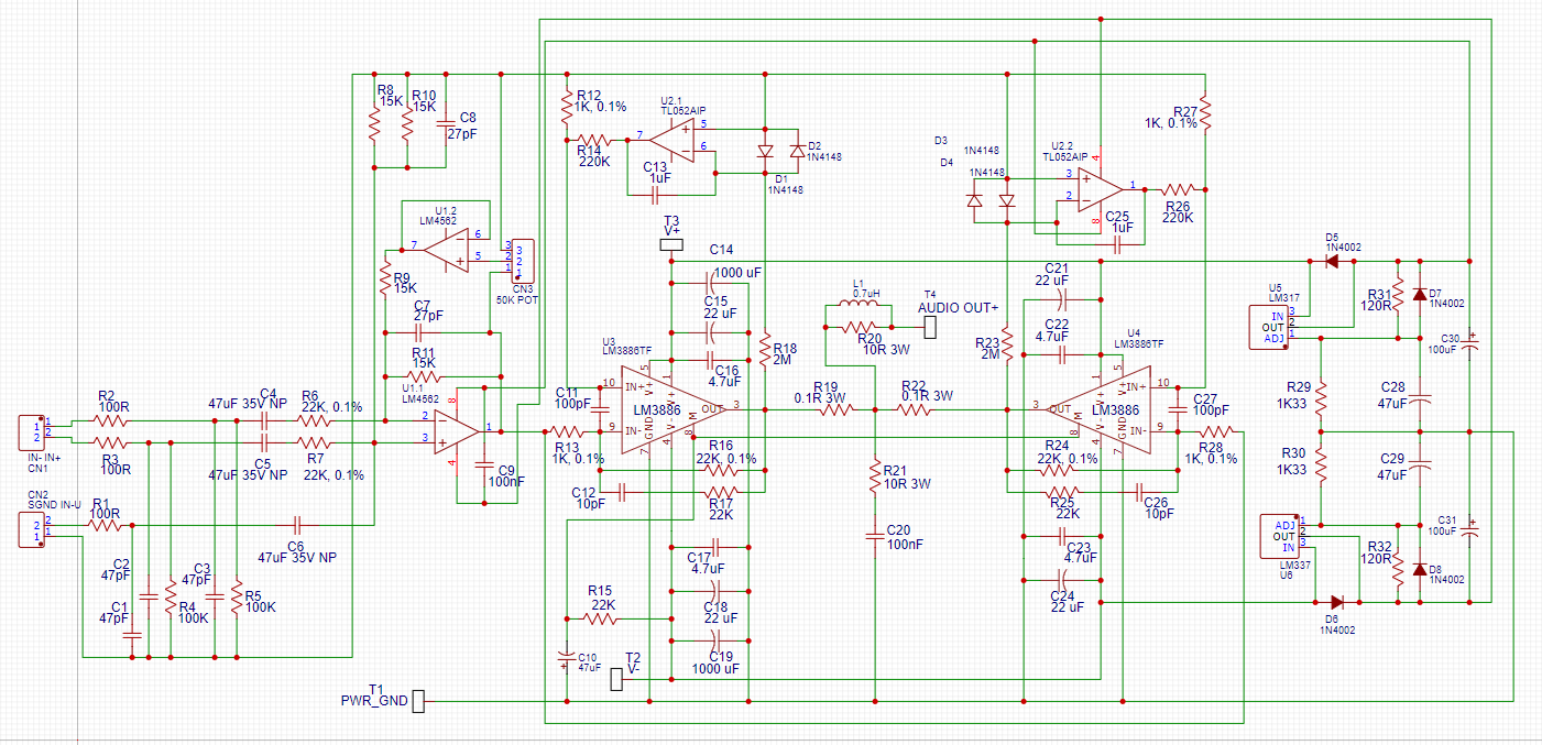

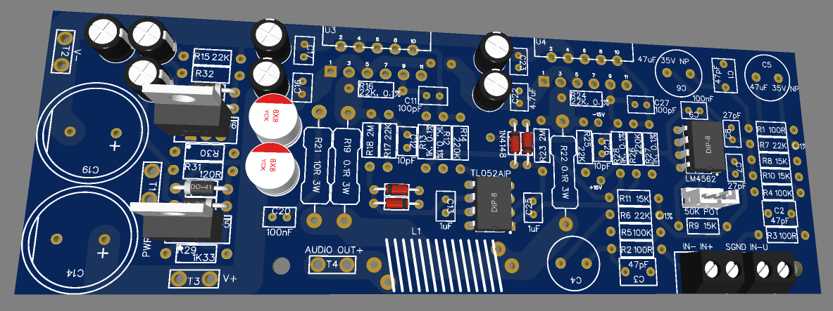

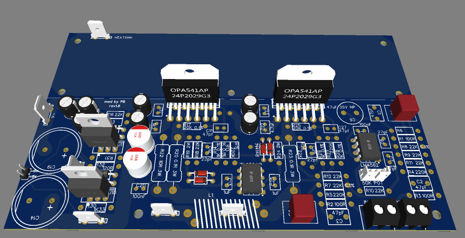

Latest revision includes:
Added PCB space to mount heatsink on top of it - I already have one that is designed like that.
Added an option to install 10uF caps at the balanced input.
Adding film cap to the unbalanced input is challenging because of the low input impedance of the unbalanced input. 15uF seems to be ok, but 20uF or 22uF is the best for unbalanced input since they don't affect the frequency response that much. Adding 10uF to unbalanced input starts to affect 100Hz and lower. Verified all of that with LTspice simulation.
Gain was reduced to 20, by replacing feedback resistor from 22K to 20K

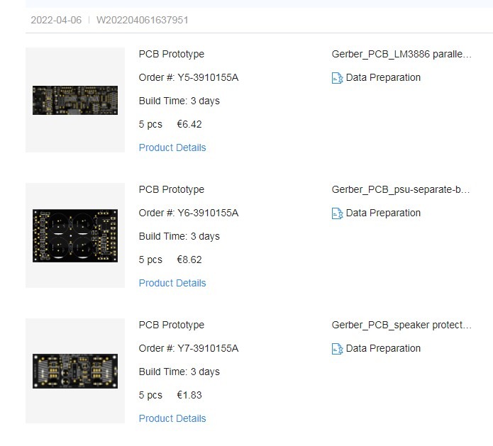

If you don't mind I had the boards made for myself in exclusive black!
Power supply board needs to be upgraded with proper rectifier bridge. I used rectifier diodes that were 3A, but you need total of 35A.
You can just use two PCBs with separate components for each channel. In that way you will have two big capacitors for each channel individually.
Yes, I'm planning full dual mono...
I would replace the originally used 1N5408 with MUR460, I think the current reserve will be sufficient,...
I just can't estimate what the charging current of the capacitors will be when switched on. (40.000 uF/per channel)
Won't I also need a softstart? 2x225w toroid + 80.000 uF 🙄
