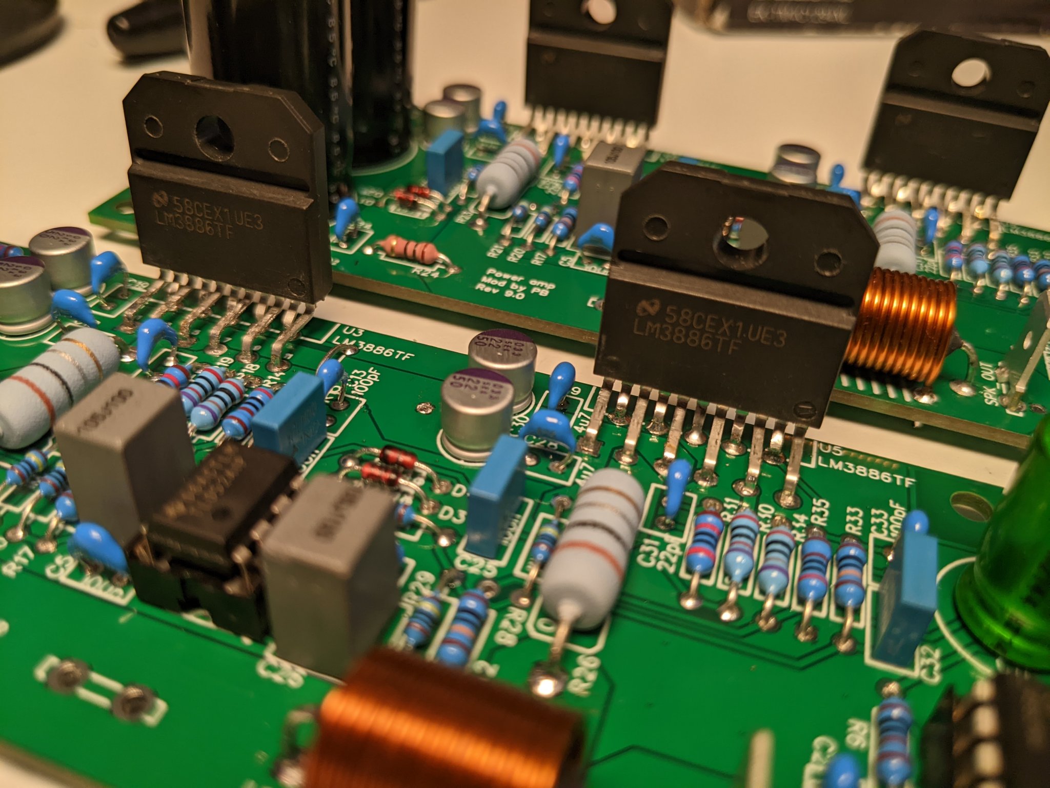

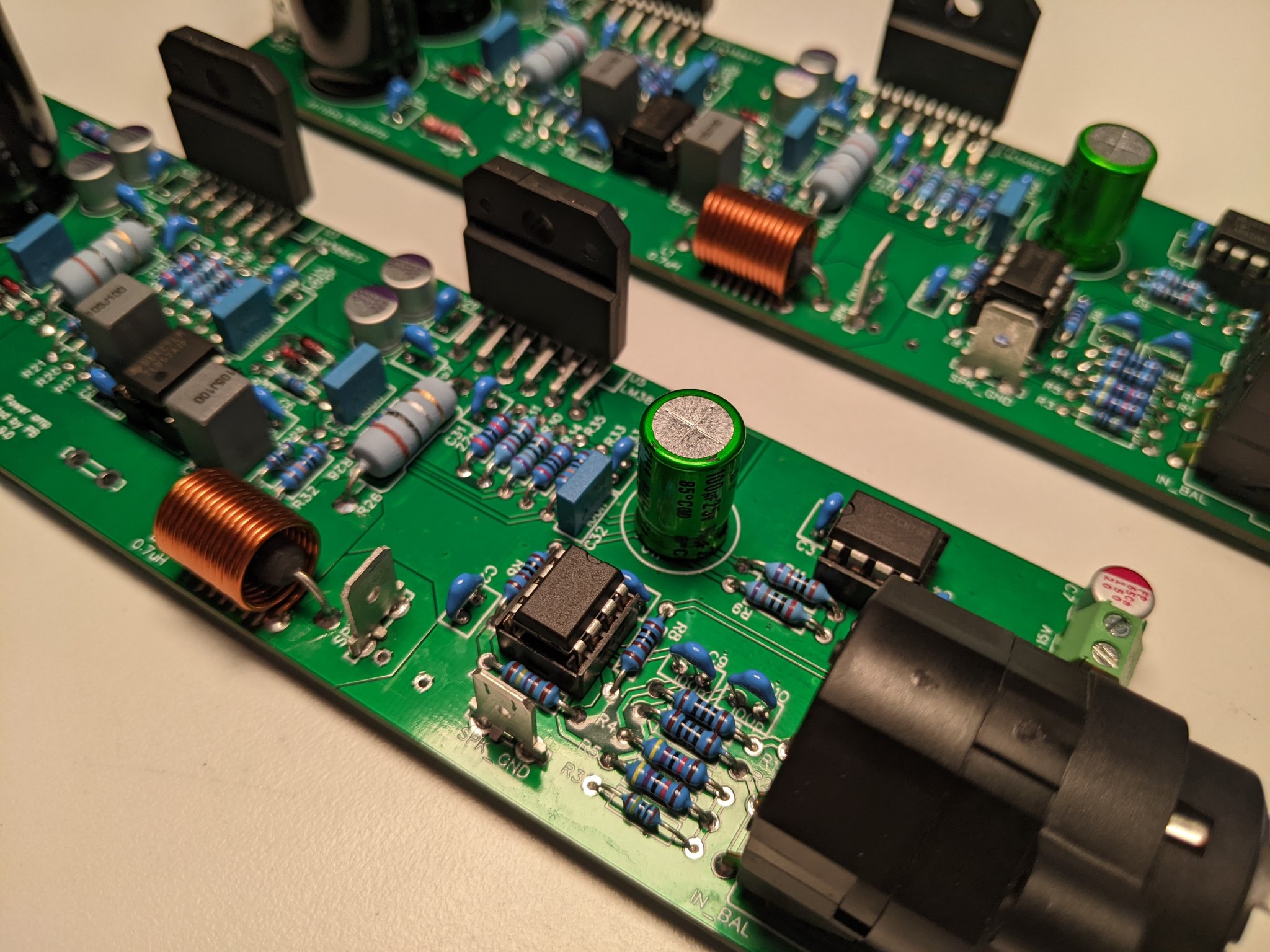

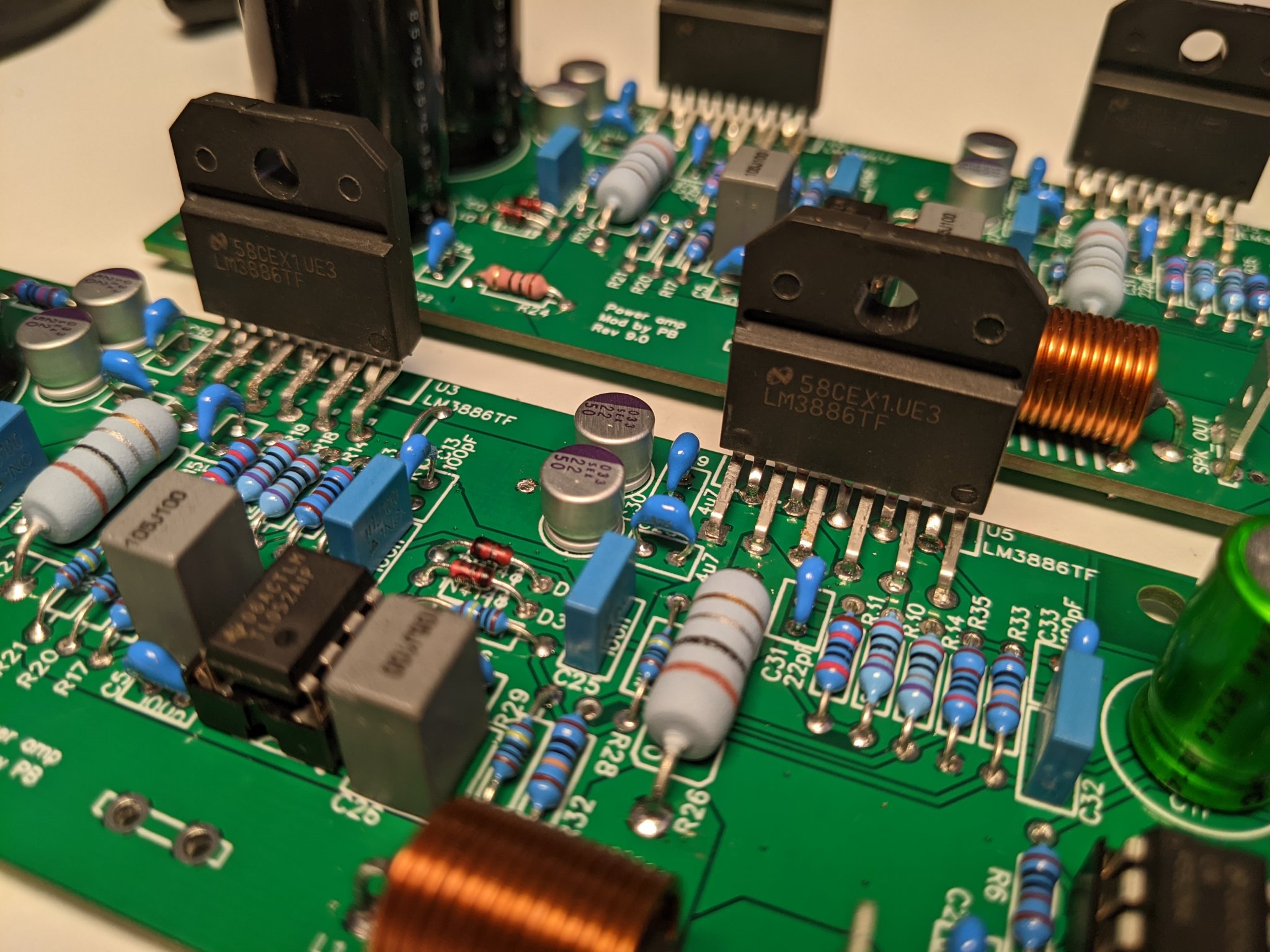

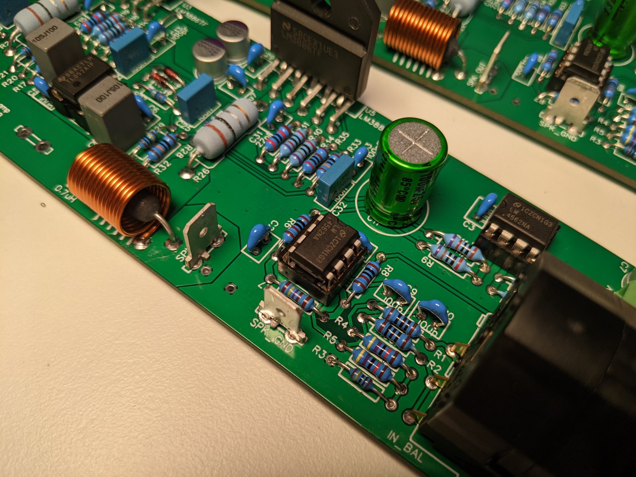

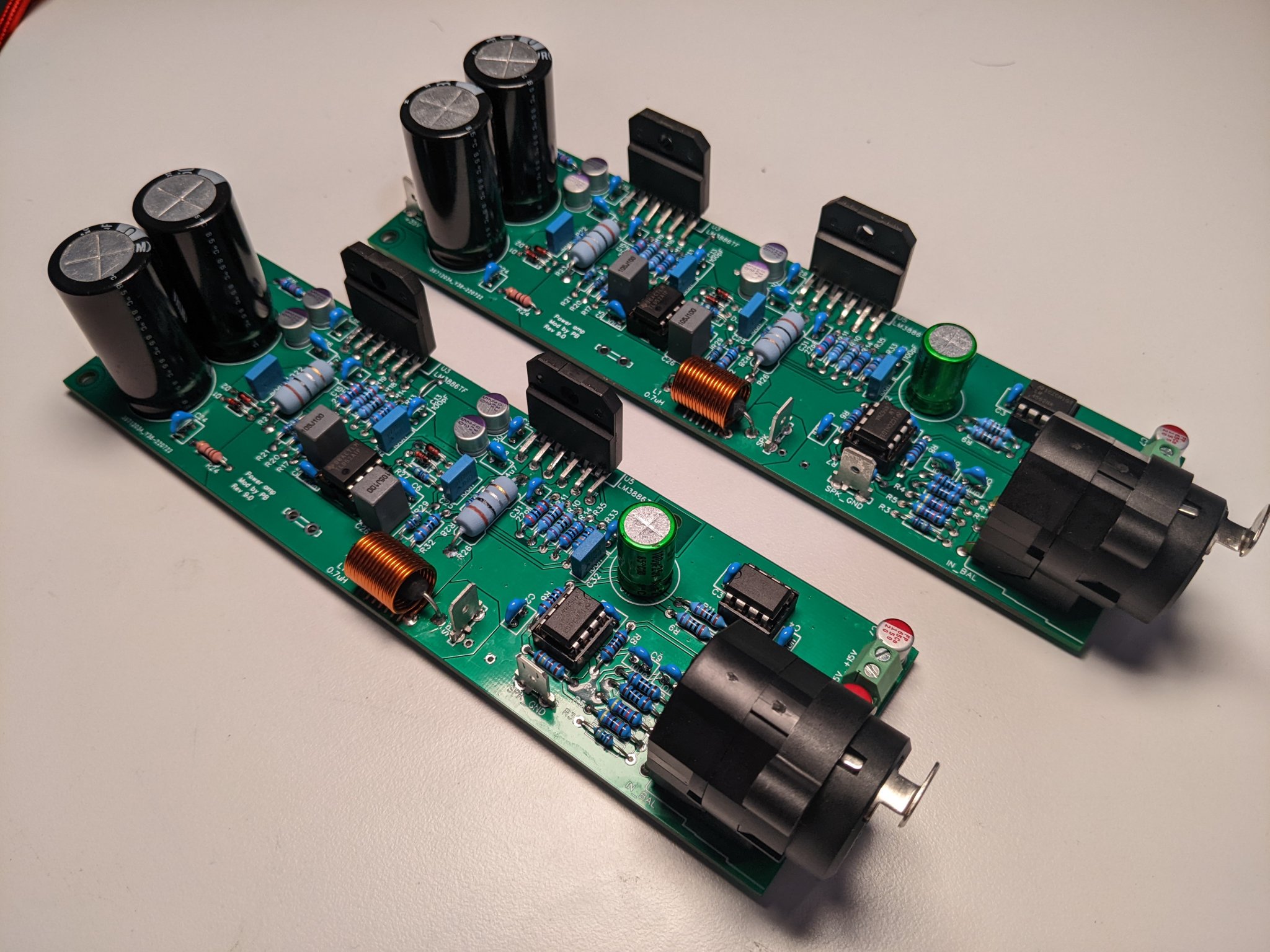

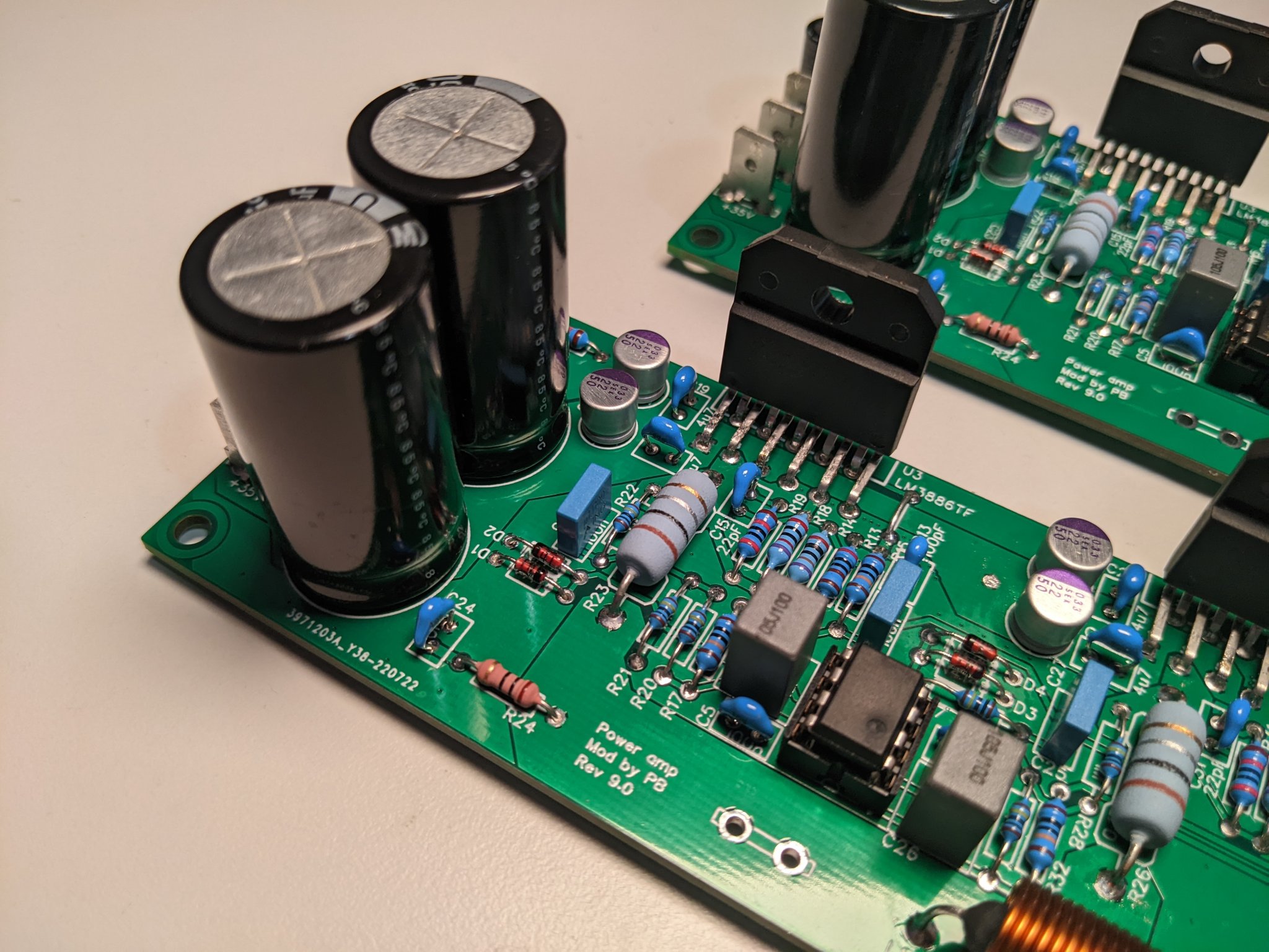

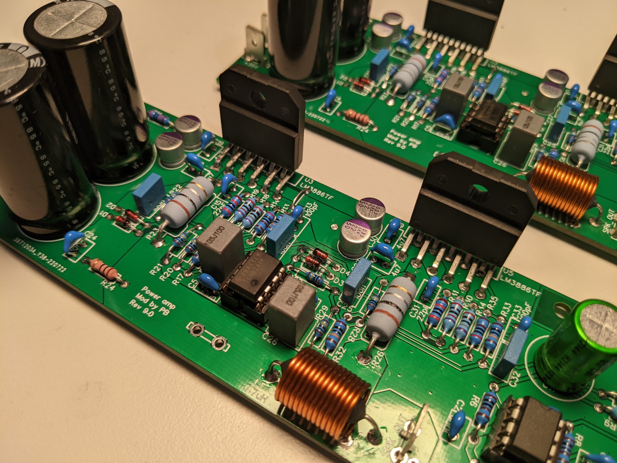

Parts and boards are in so this project has is in progress!

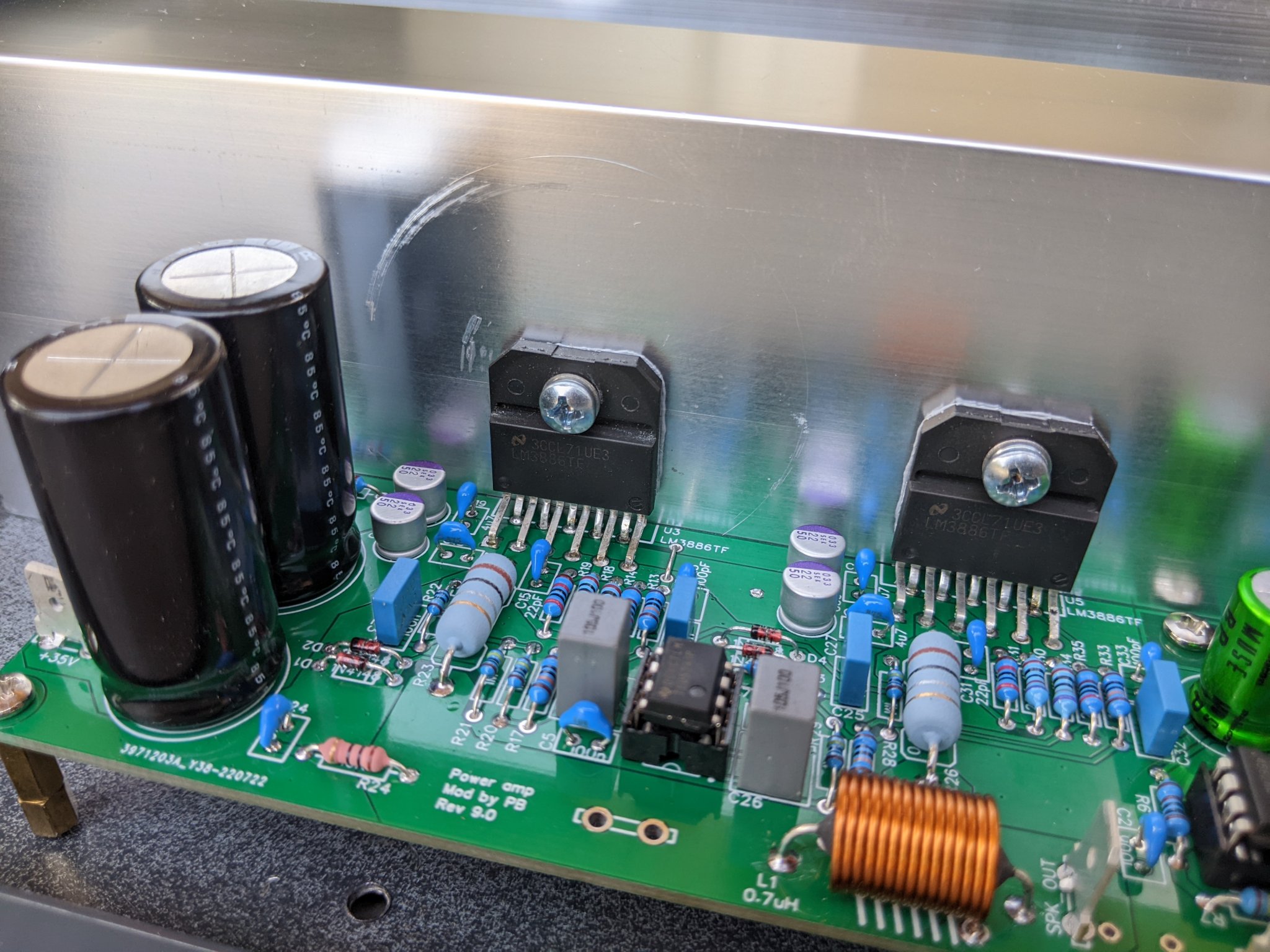

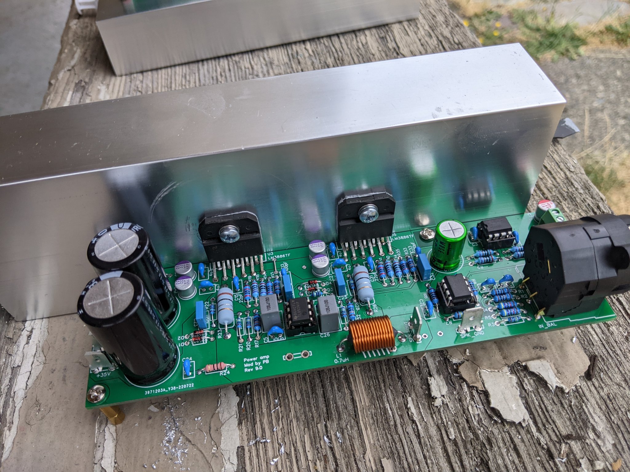

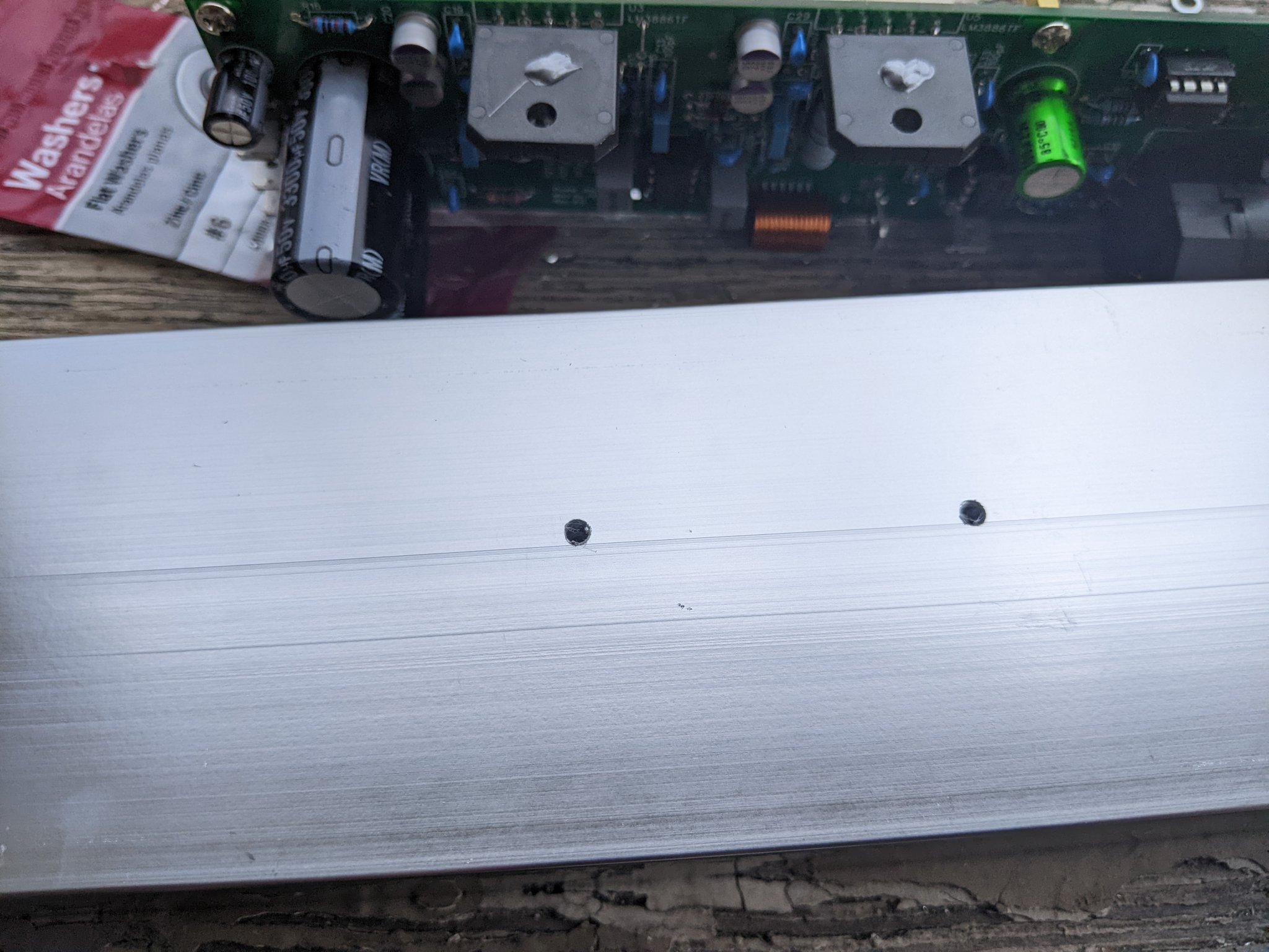

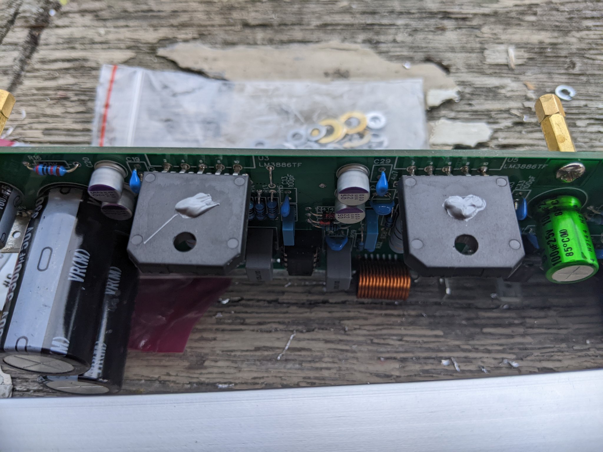

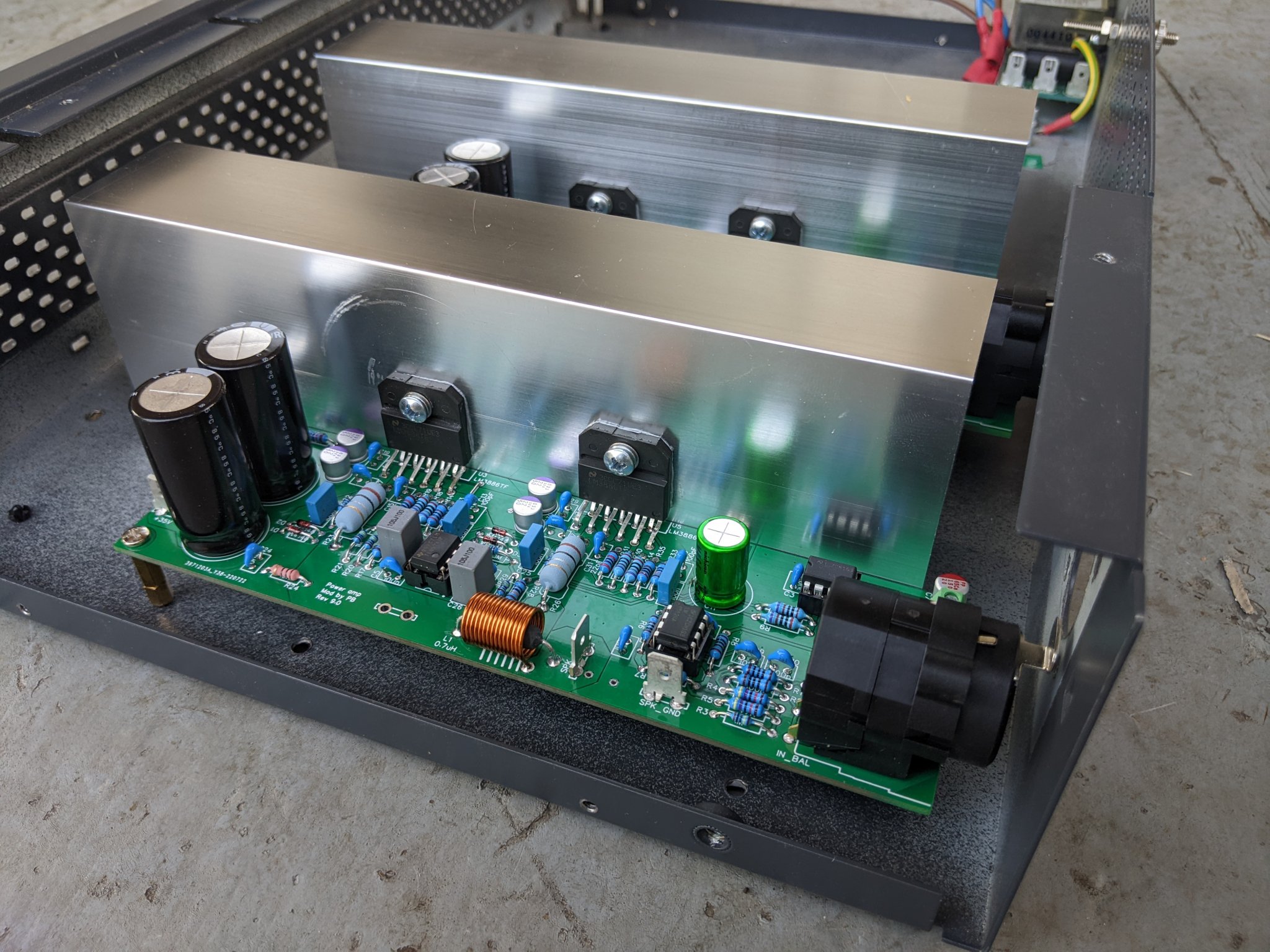

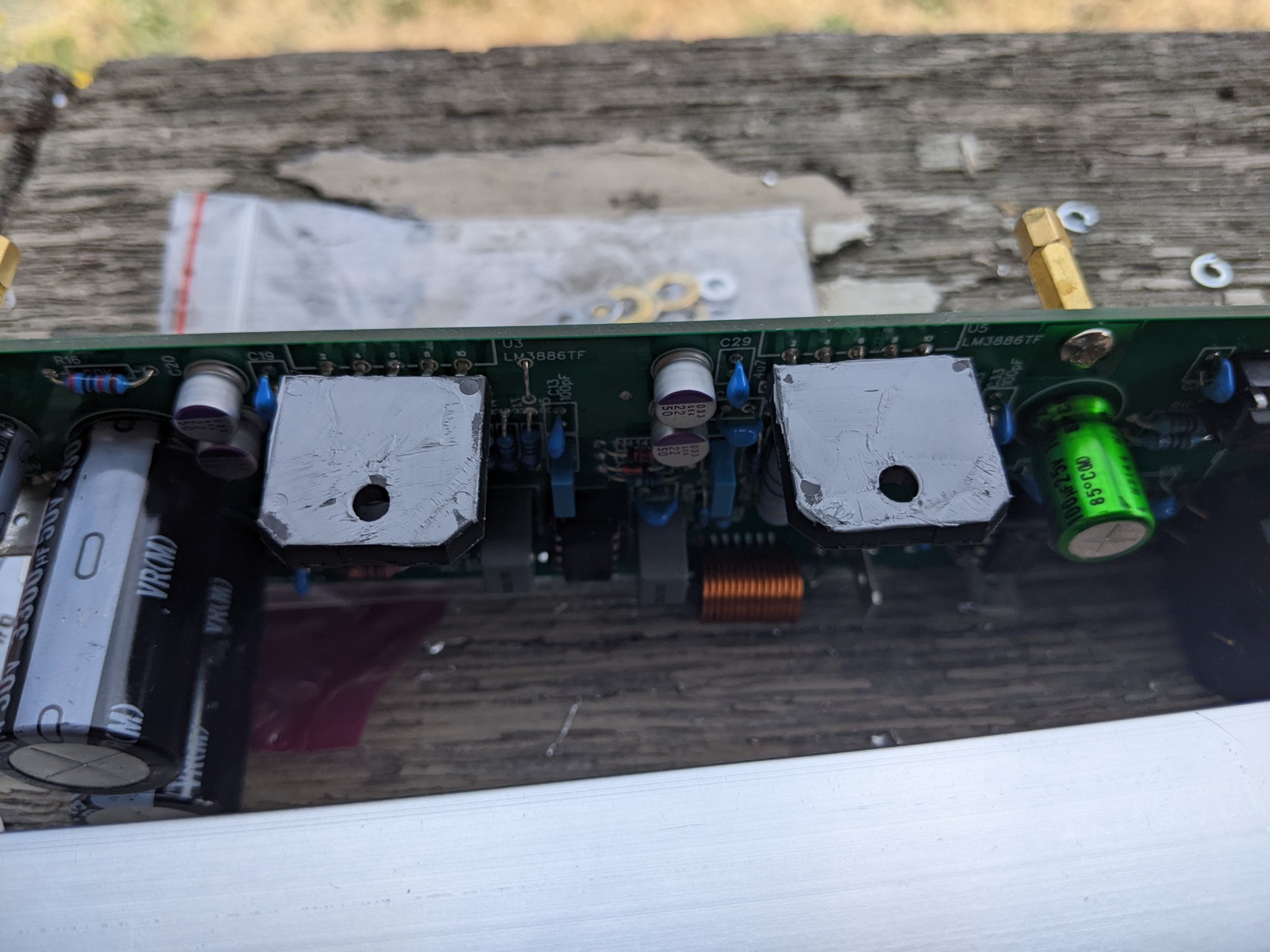

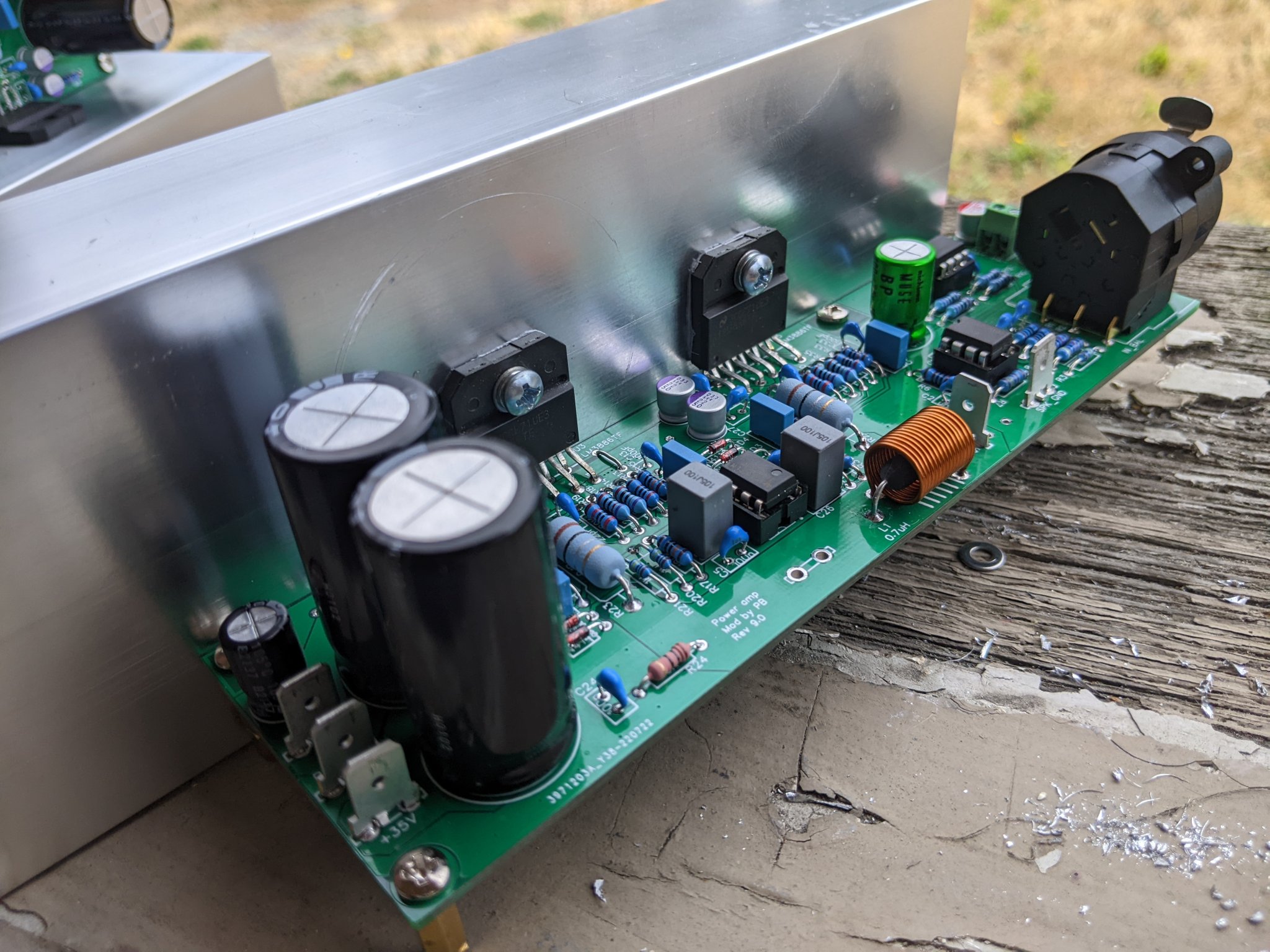

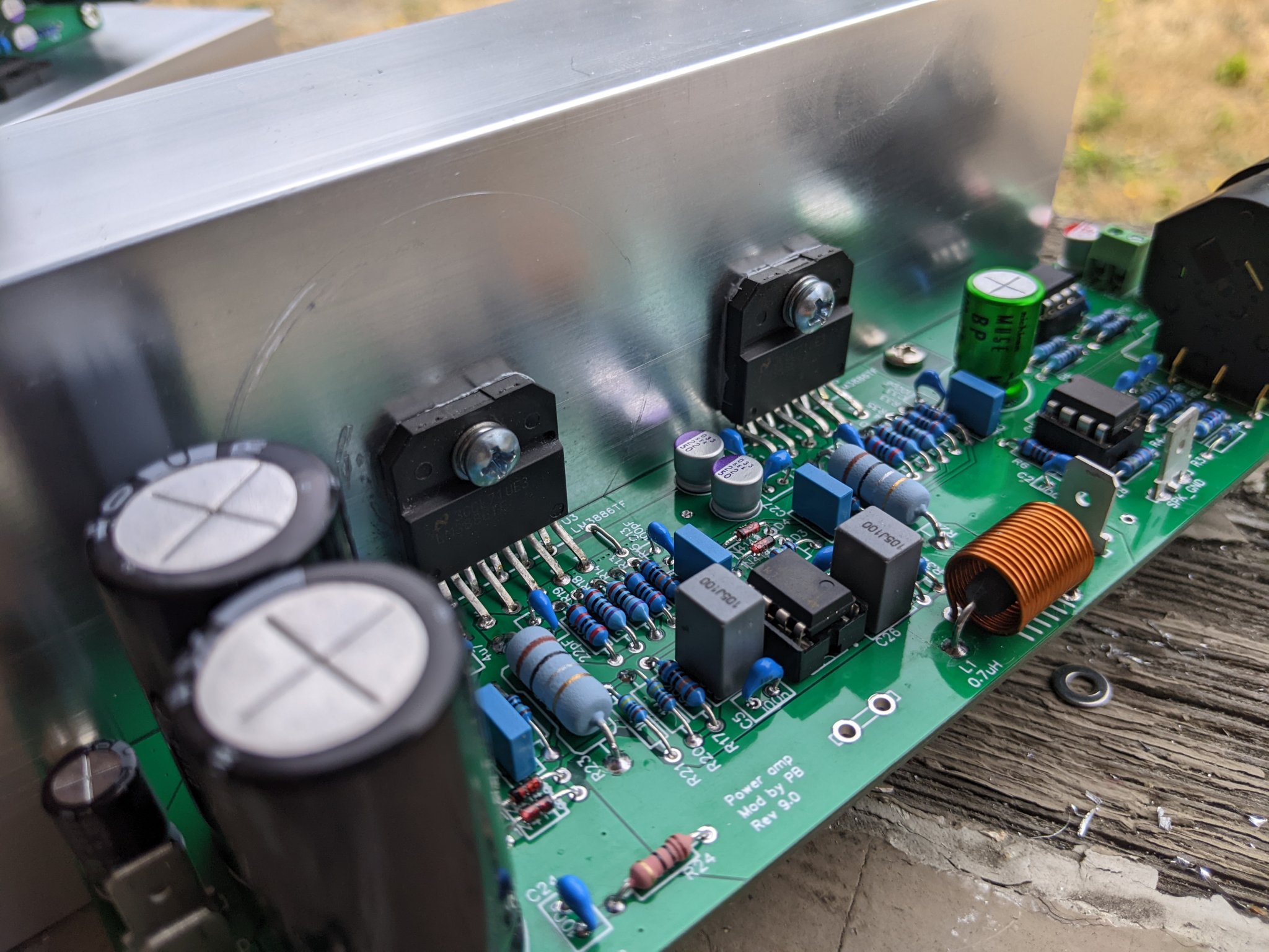

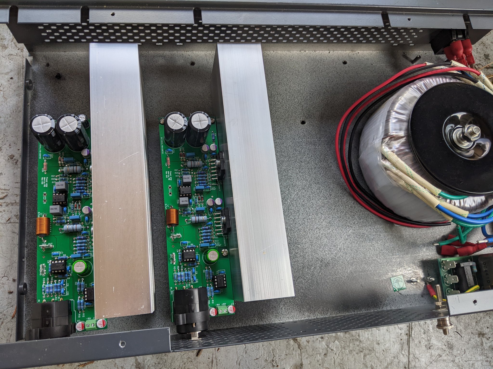

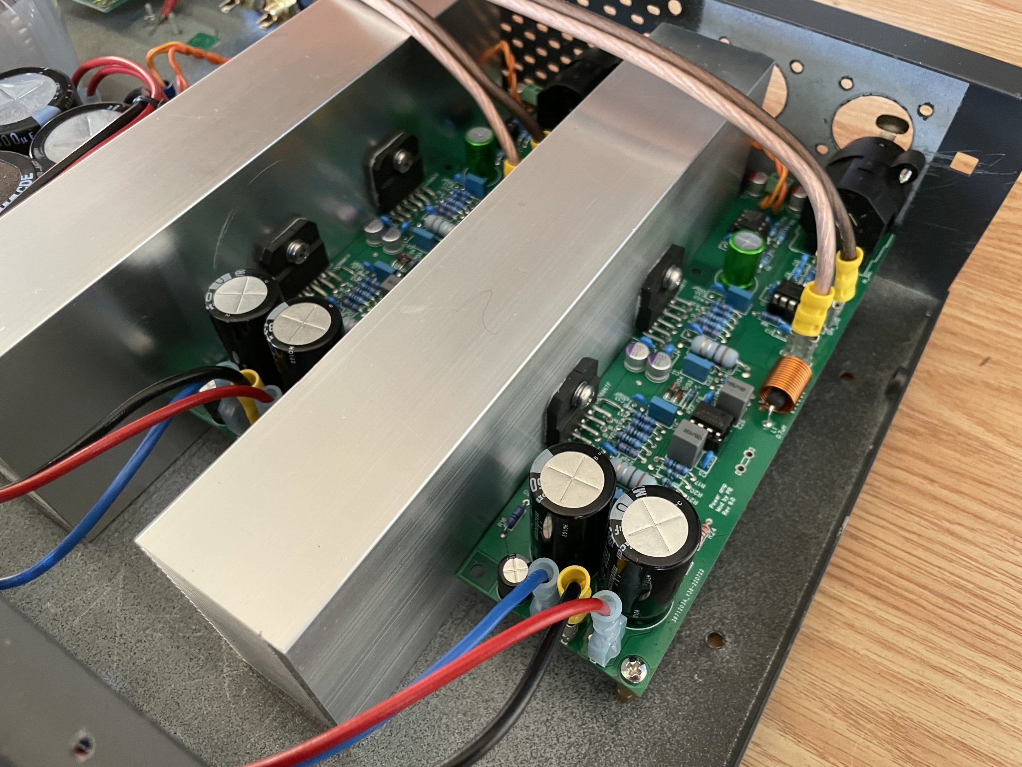

Heatsinks are attached!
Looks like a lot of work and components for a problem that could have been fixed with a simple bridged amp.Pardon me for asking, but whats the purpose of paralleling two chips?
Did you find one not to be adequate? You need double current? Tough speaker load?
Why not three in parallel? Its been published and tested. Or six.
Or chip with extra bjt on output to boost the current.
Or just adequate discrete design.
Complicated isnt always better.
I could go with a discrete design and that would get me more power - 100W to 300W. Probably would be simpler (or more tunable, customizable).Looks like a lot of work and components for a problem that could have been fixed with a simple bridged amp.

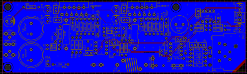

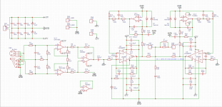

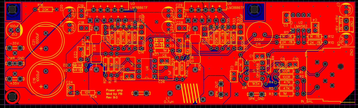

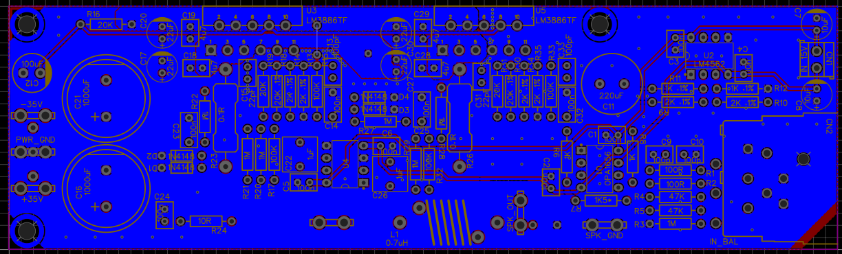

Thoughts behind the above solution:
Bridging two LM3886 limits output current. Cannot work with 4ohm loads.
Paralleling two LM3886 doubles the current. Better load capability. Using them both in inverted mode decreases common mode distortion (slightly).

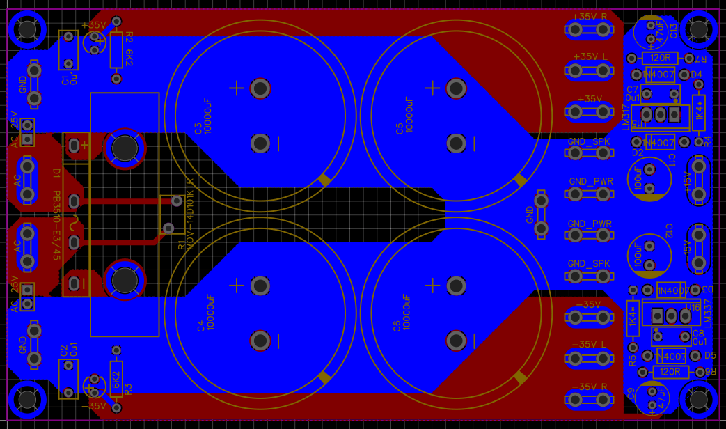

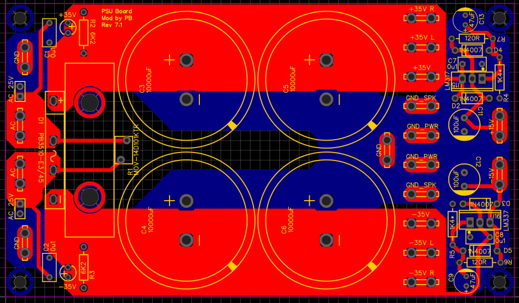

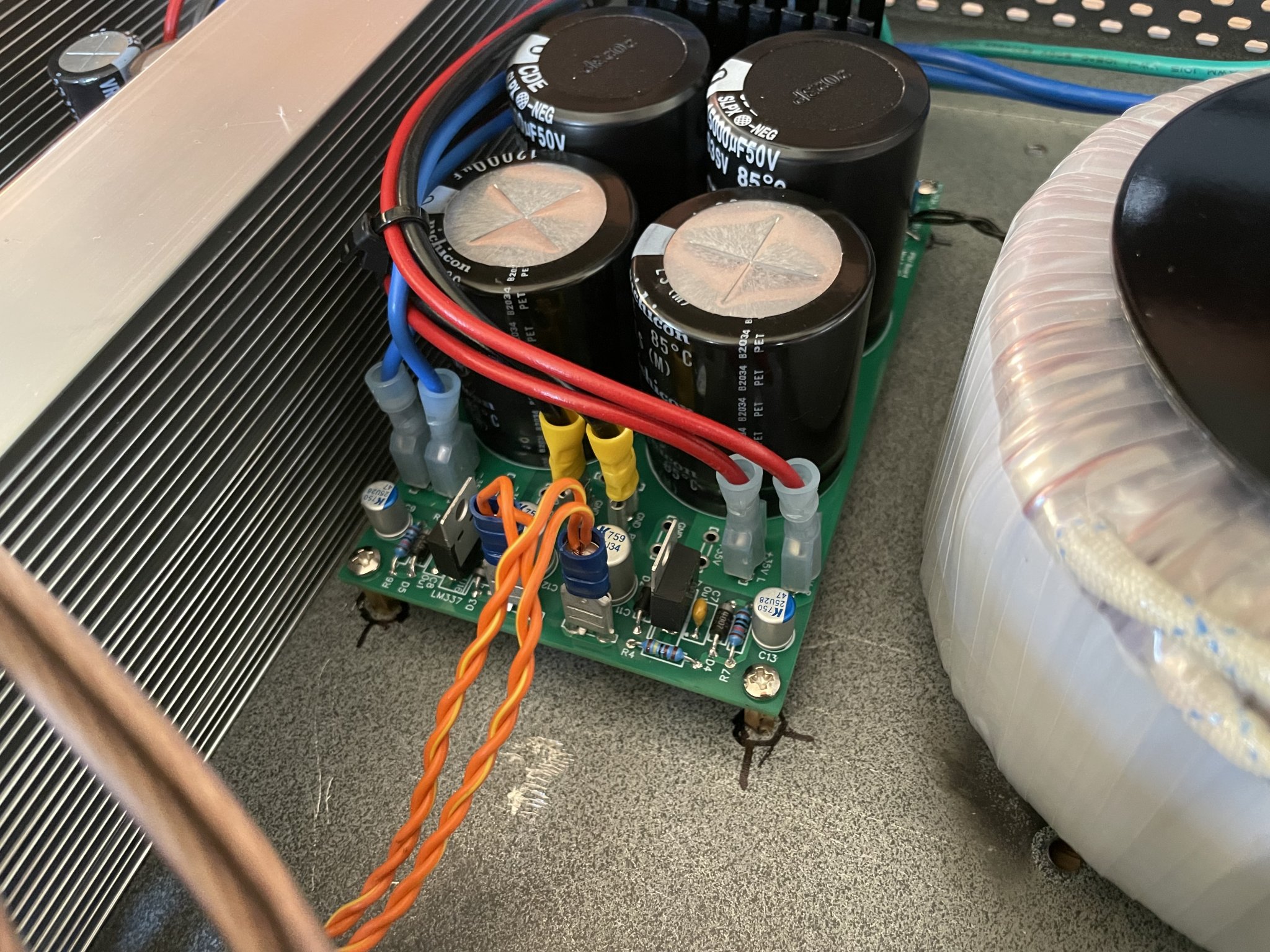

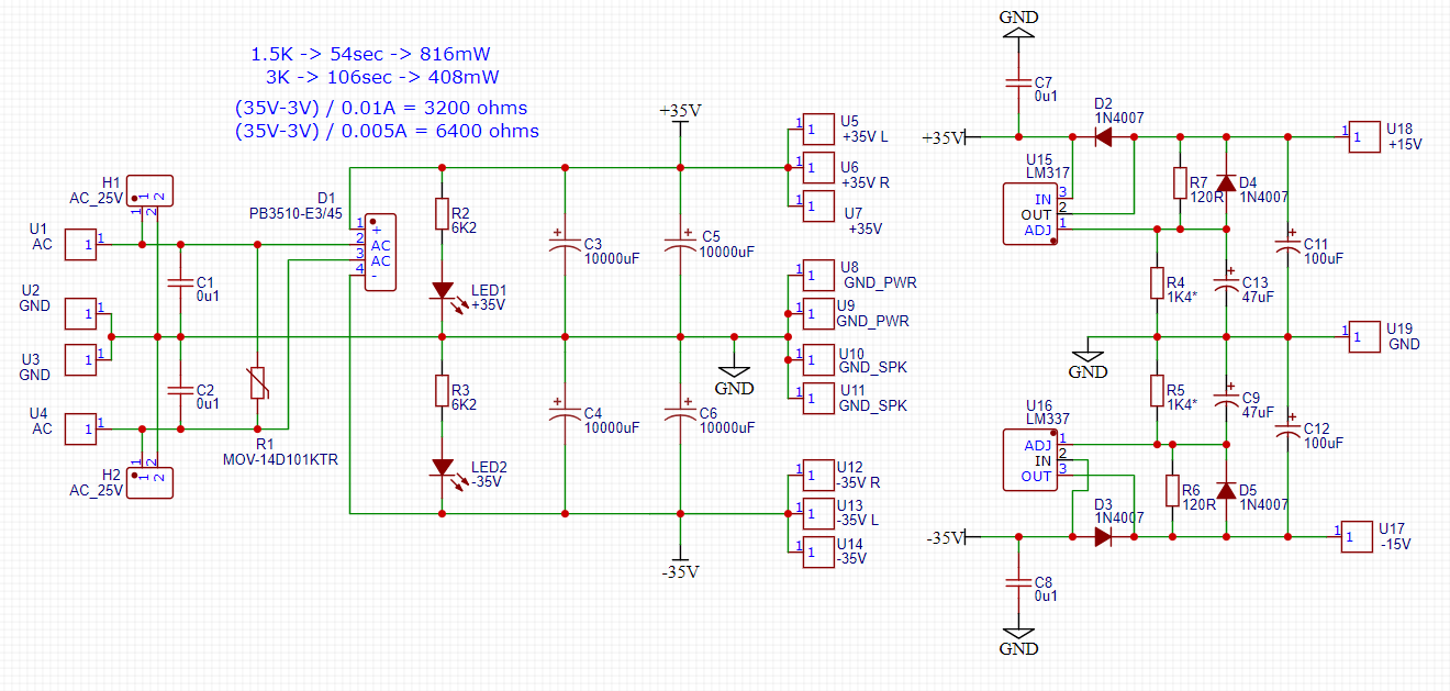

Had to fix power supply layout - was using incorrect pinout for LM337 voltage regulator. I wonder why designers decided to go with two different pin layouts for LM317 and LM337...
The most positive power element "must" go to the center leg and the mounting tab. That's how old chips cook-out, like an NPN power transistor's collector is the package. (For the last 30 years this can be violated, but many of our fave chips are really really old designs.)why designers decided to go with two different pin layouts
Yes, many builders have run aground on these pinouts.
Actually, ICs have the lowest (or most negative) potential on the die substrate and, hence, on the metal tab.The most positive power element "must" go to the center leg and the mounting tab.
I think that has more to do with how a bipolar transistor is fabricated. Usually the base region is implanted into the collector substrate. Then the emitter is implanted into the base 'tub'. This is done to get as thin a base region as possible, thereby getting the highest current gain (beta). At least that's been the case in the processes I've worked in. Discrete devices are often a bit more involved.That's how old chips cook-out, like an NPN power transistor's collector is the package.
The only time I've ever seen a lateral BJT was in a CMOS process where a crappy BJT was offered so one could make bandgaps and such. Beta was maybe 10 on a good day. With some luck above one... 🙂
Tom
Yep. Always check the data sheet.Yes, many builders have run aground on these pinouts.

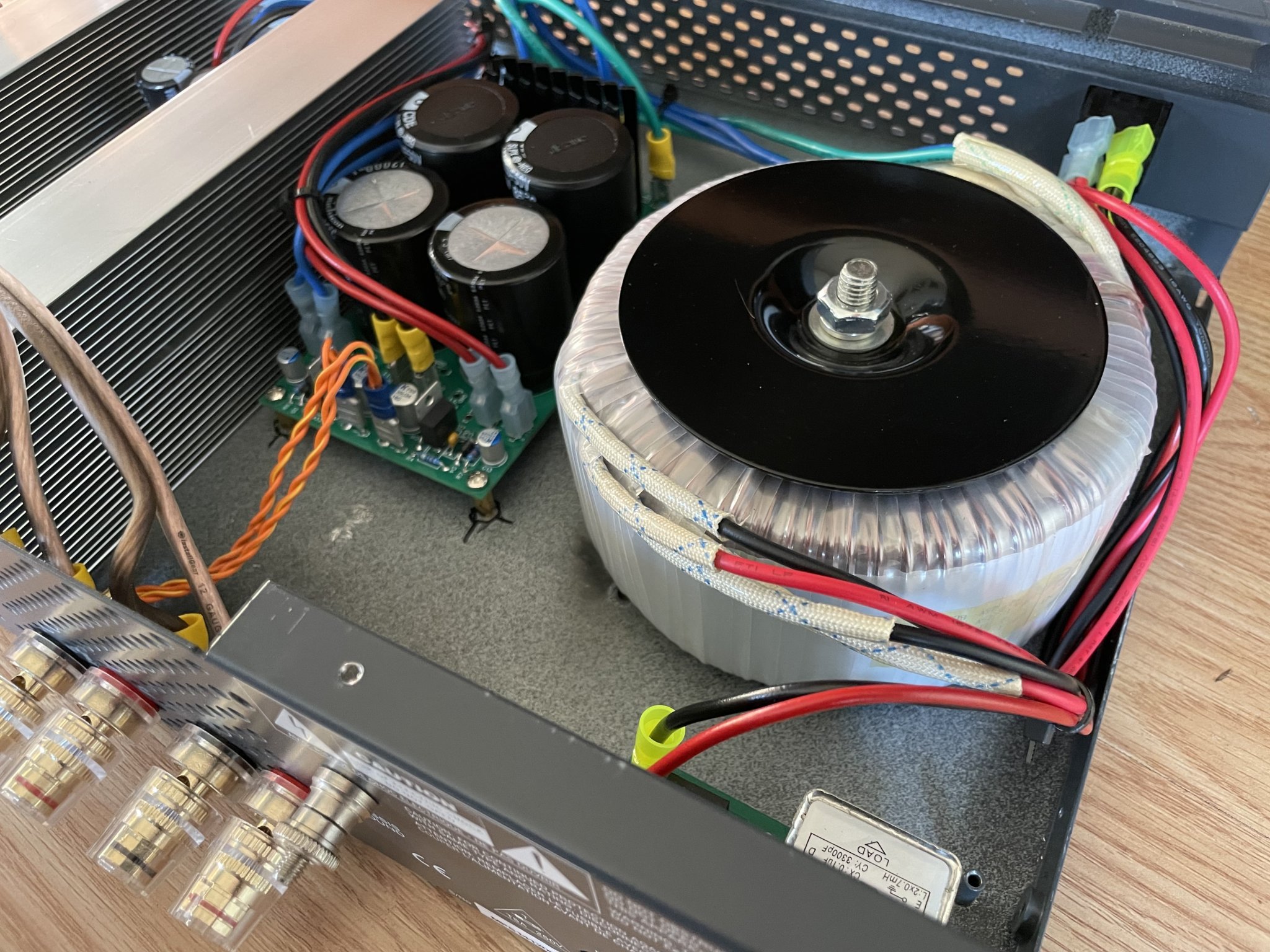

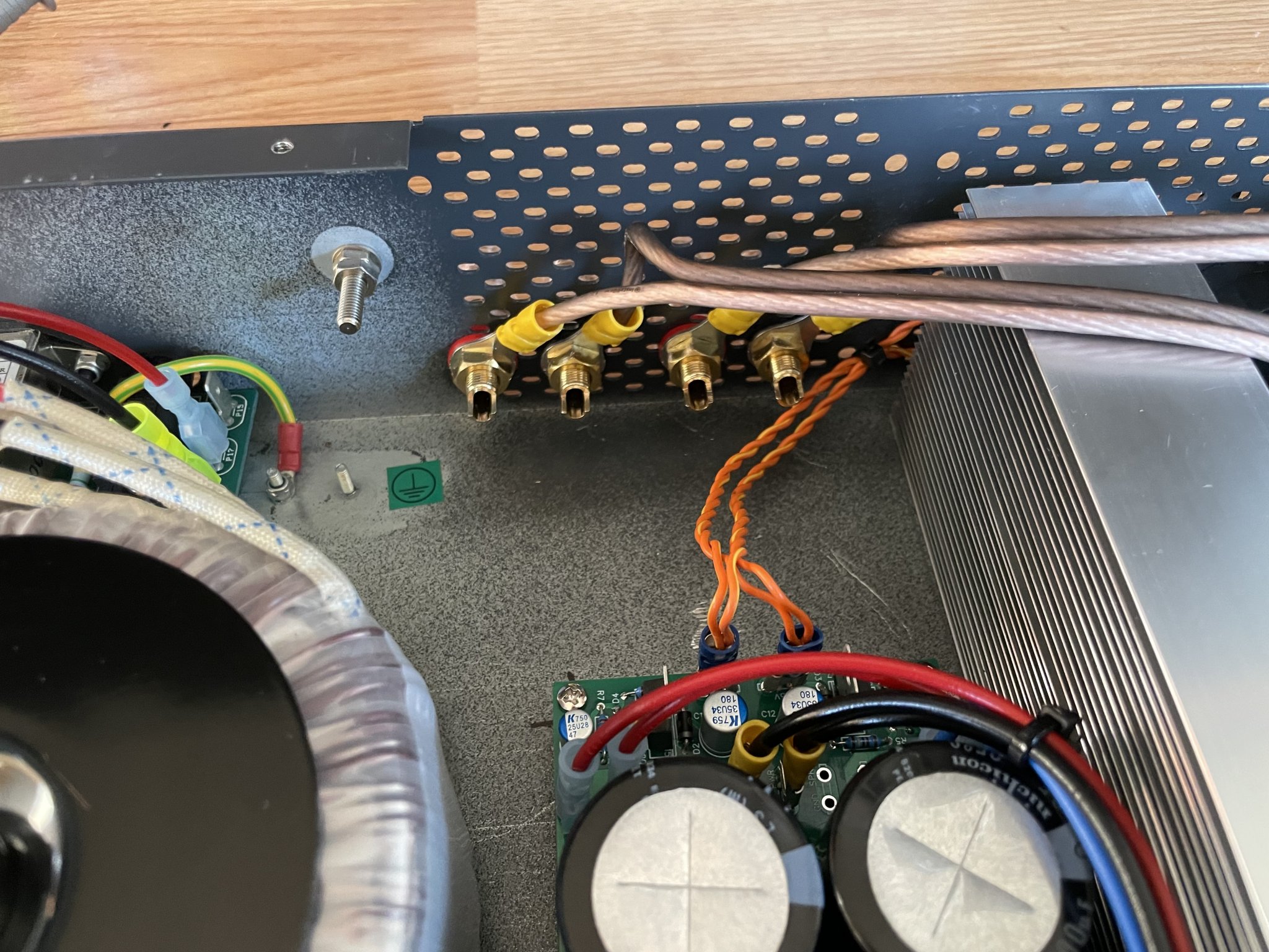

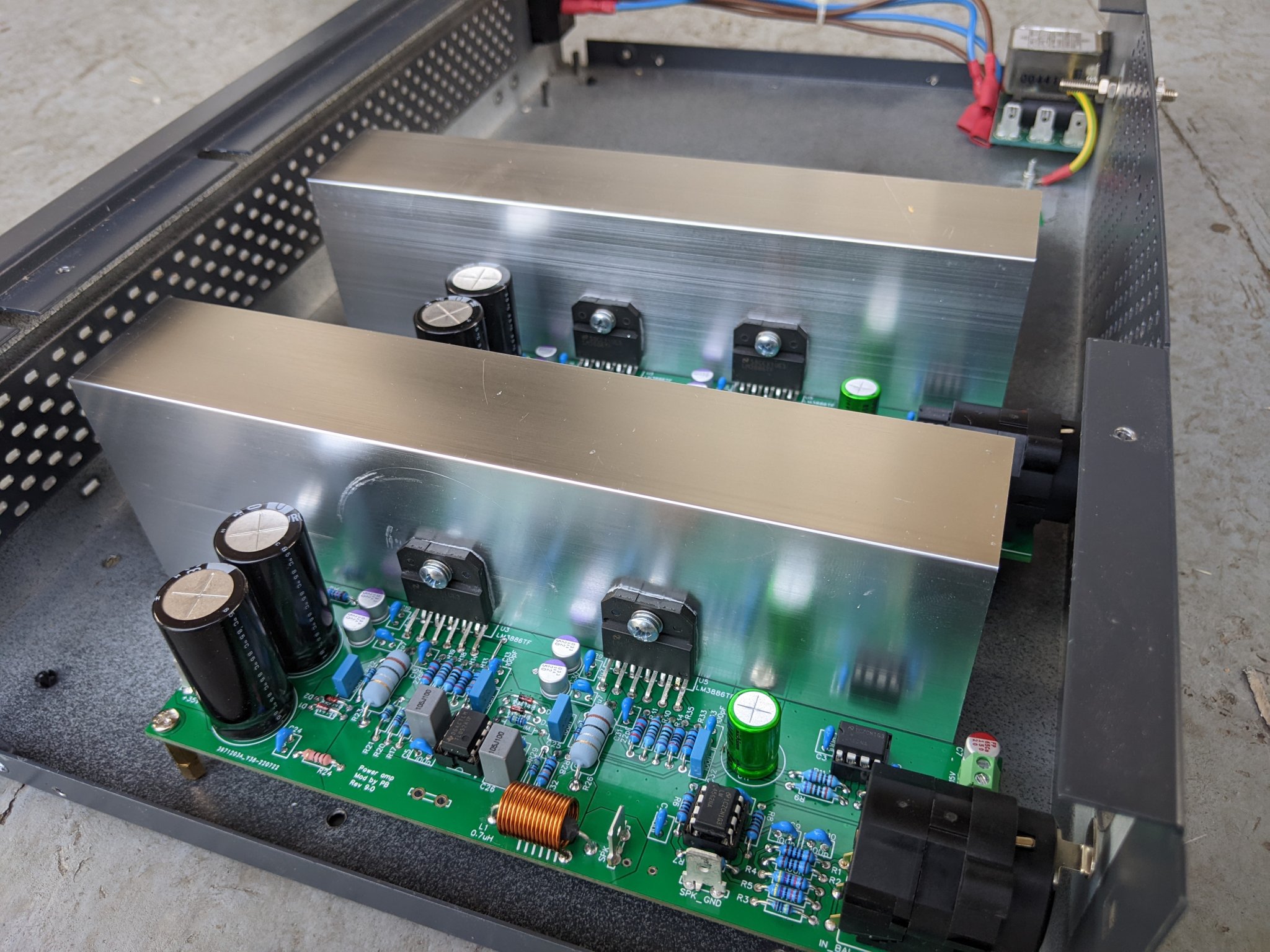

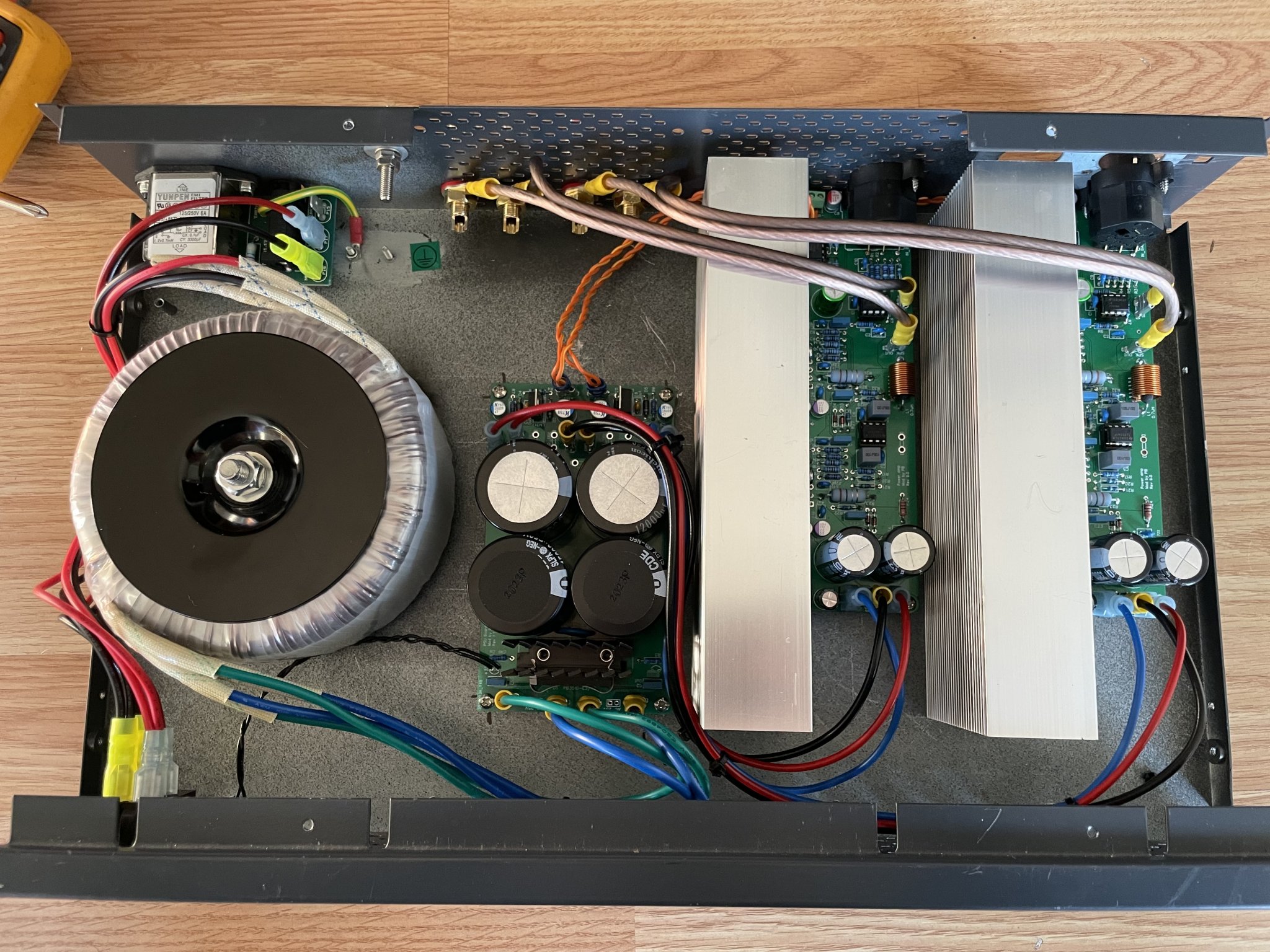

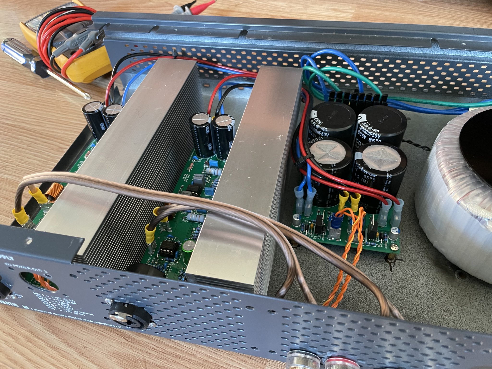

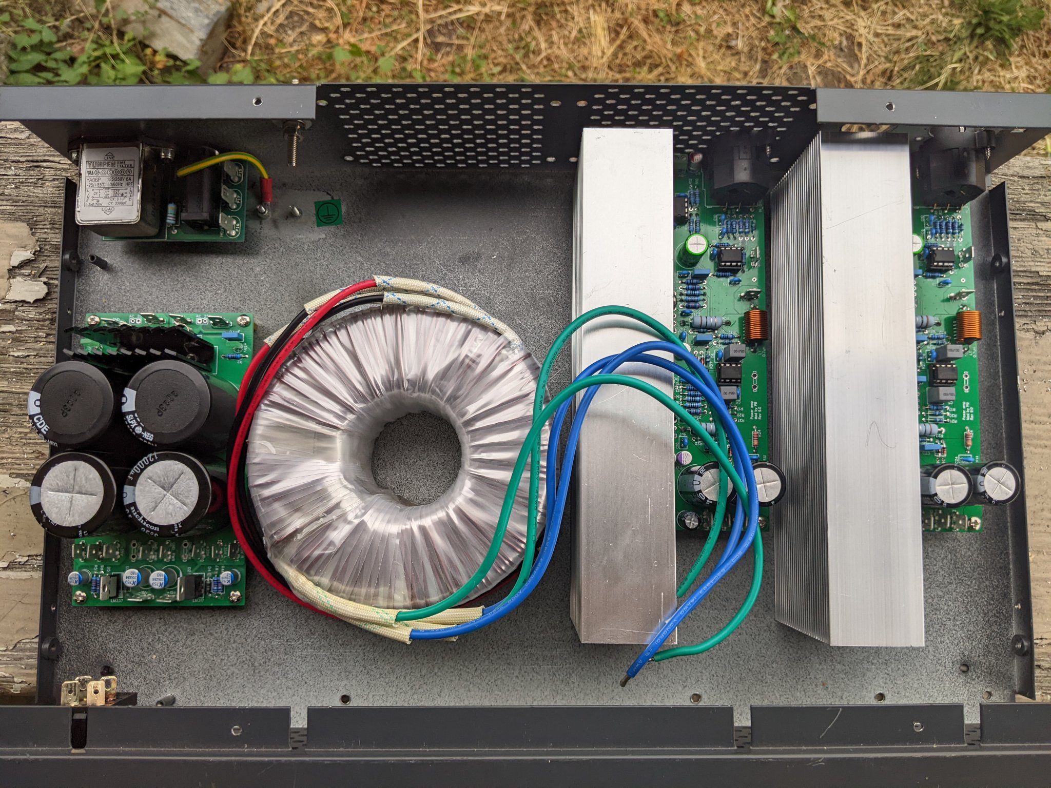

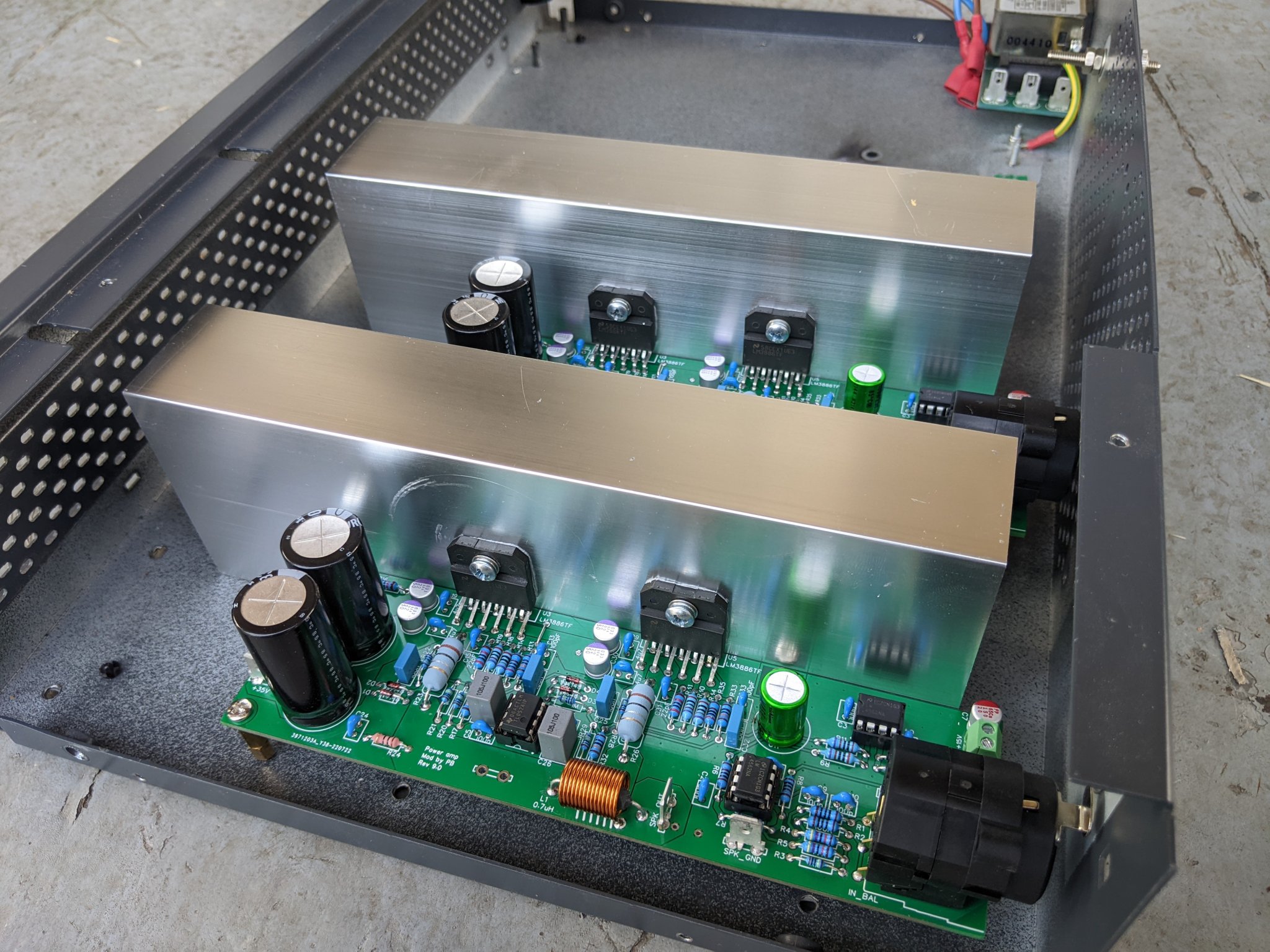

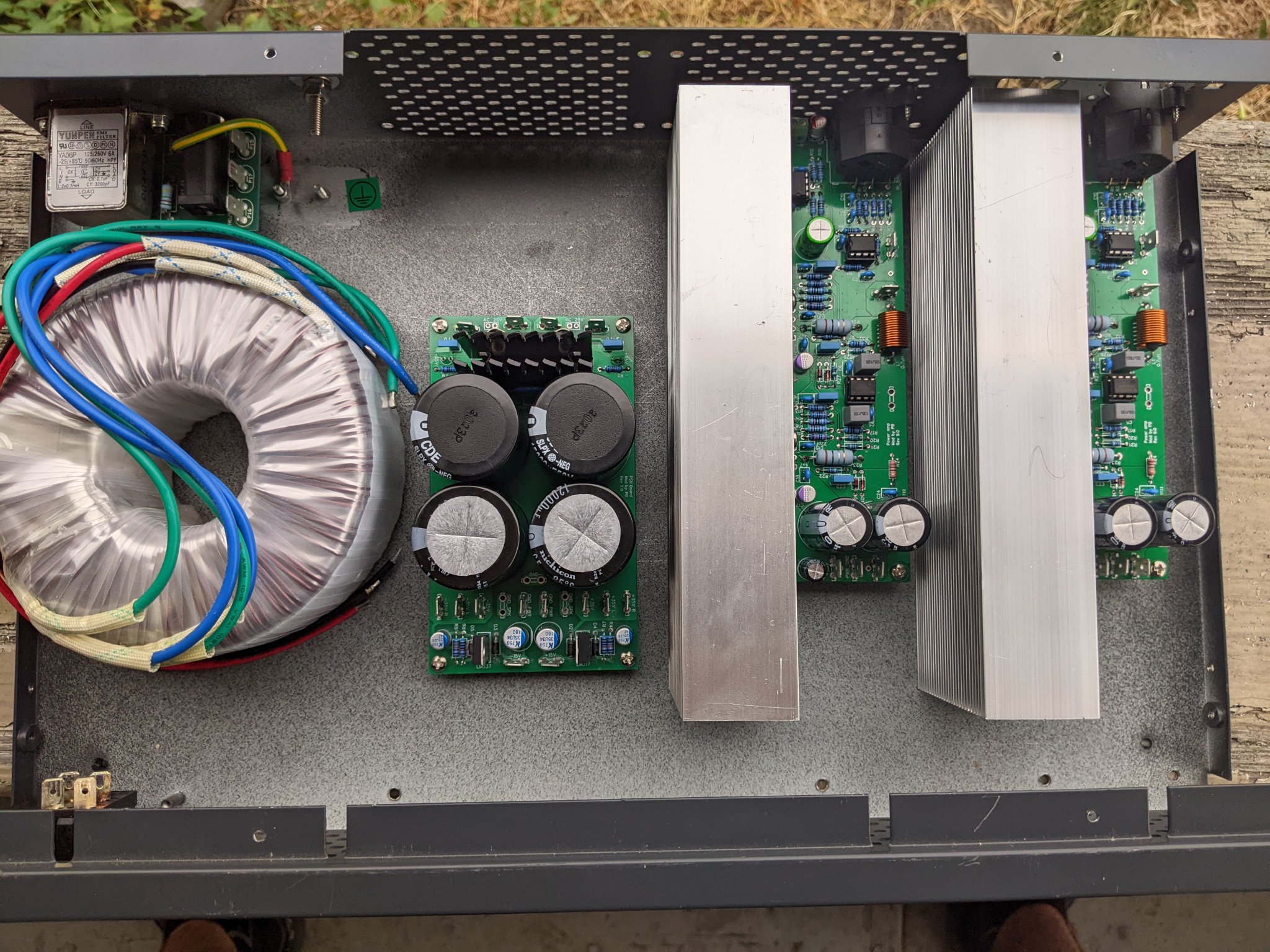

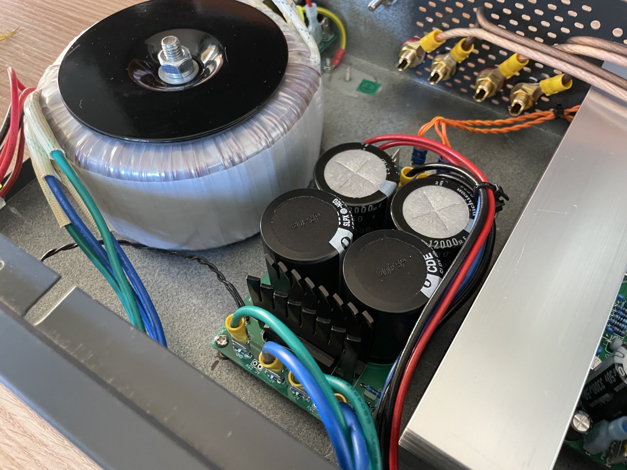

Amp is finally finished! Measured for correct power supply voltages and dc at the speaker terminals. All seems to be fine. Plugged to my speakers and it sounds great!
Next step will be measuring thd.

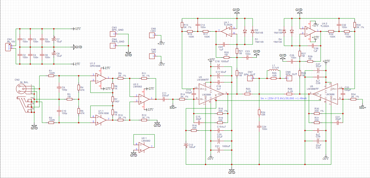

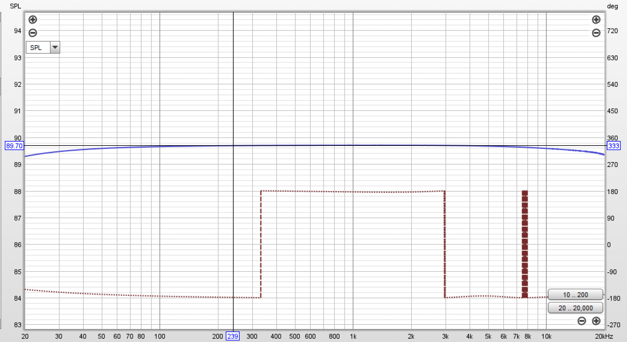

I finally had a chance to measure frequency response for the amplifier build. Few interesting points from the result - simulation for the frequency response in TinaTI was spot on. Roll off towards both ends of the spectrum (20Hz, 20,000Hz) is about 1dB.
What is puzzling is the phase response. Since both LM3886 chips are inverted, the phase should be negative 180 degrees. But it is not. There are two strange occurrences where the phase shifts from -180 to 180 deg in the frequency range from 300 Hz to 3000 Hz and second region from 7kHz to 8kHz.
Can anyone help me to fix this? Any ideas where should I look and what to check?
Much thanks!
Below is the schematics implemented:
Much thanks!
What is the physical meaning of this?the phase shifts from -180 to 180 deg
Stand on a compass at N. Walk 180 degrees to the right. Do again but walk 180 degrees to the left. Where do you end up?

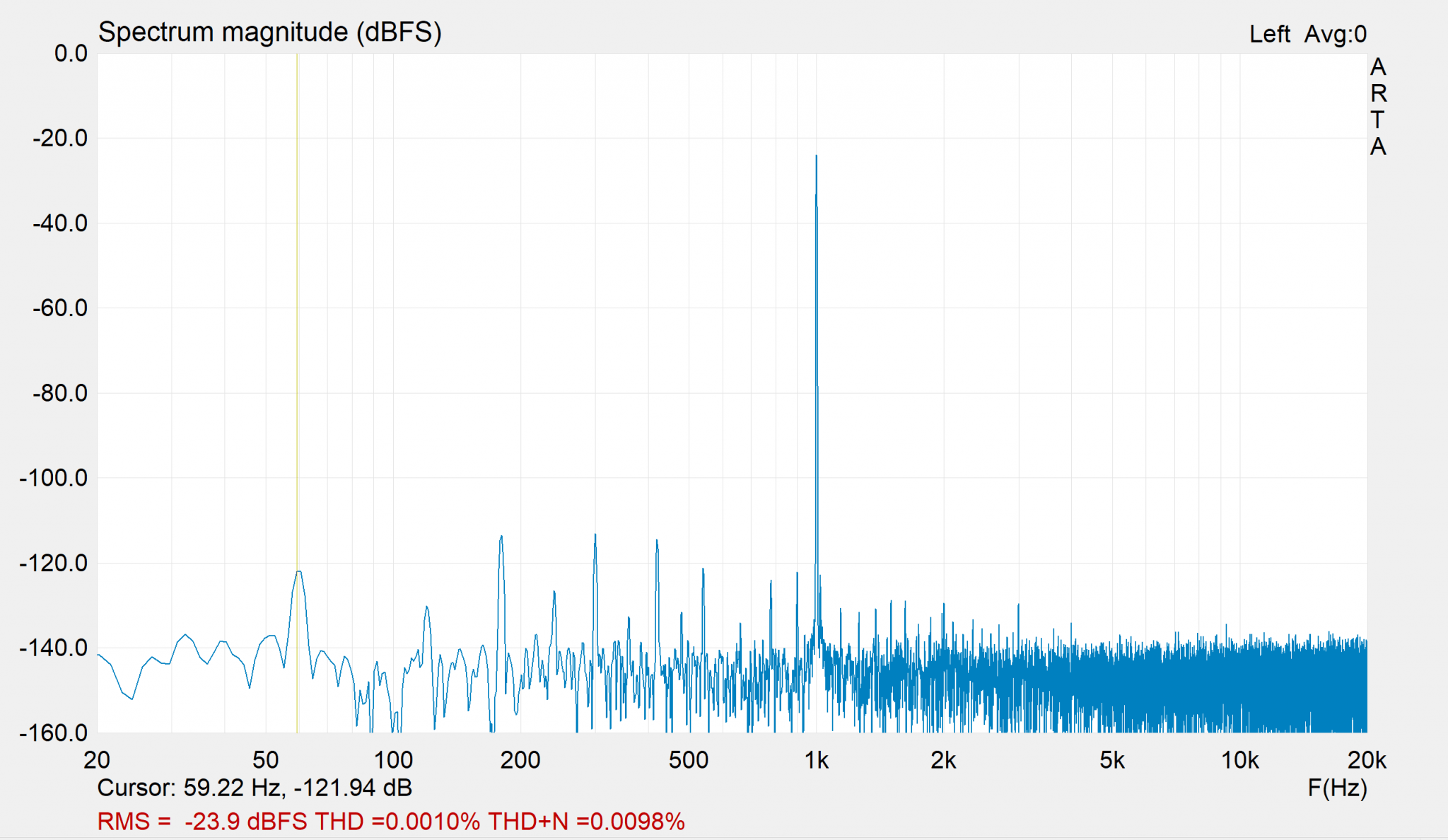

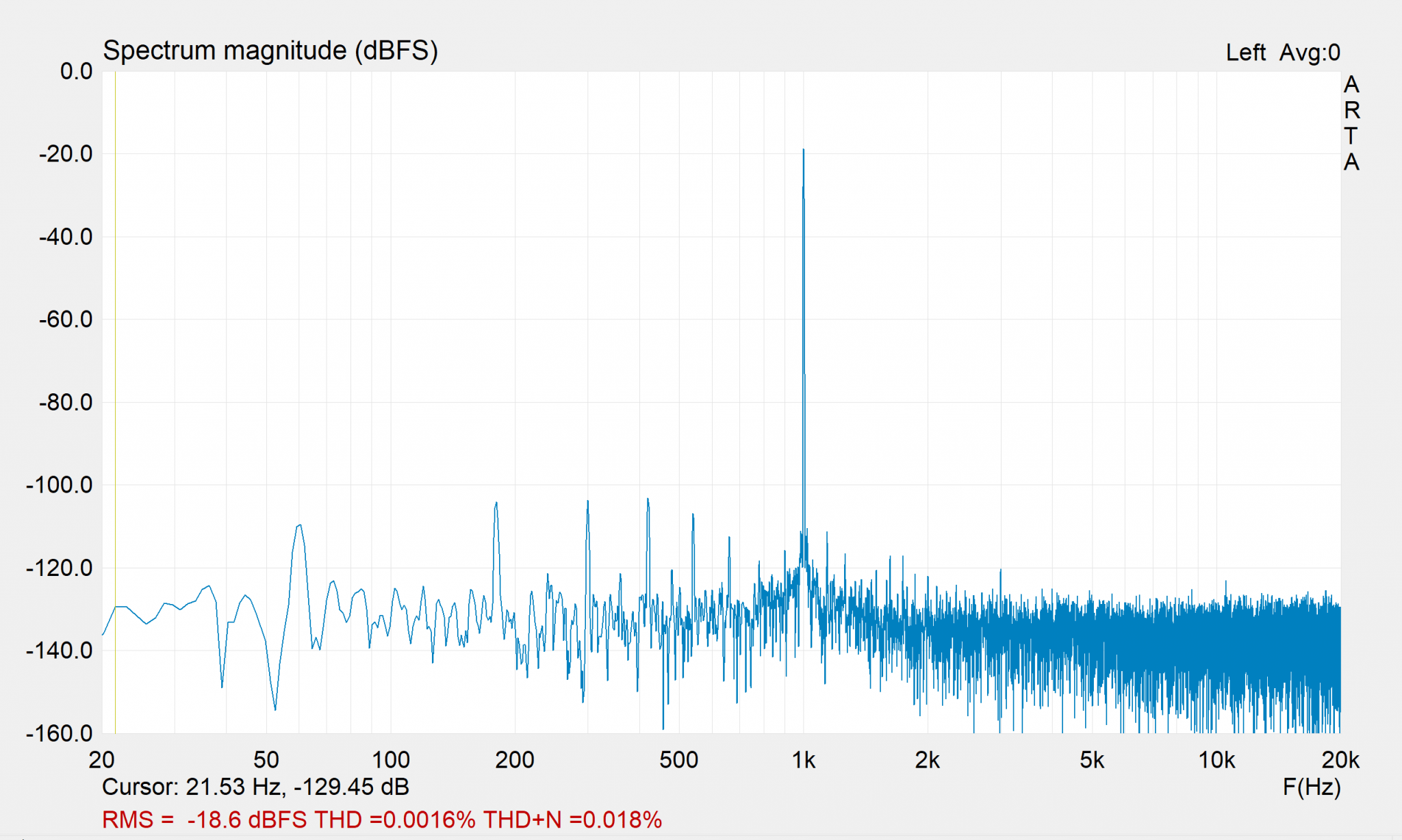

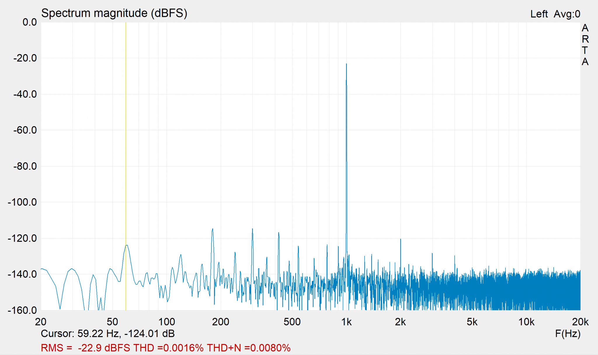

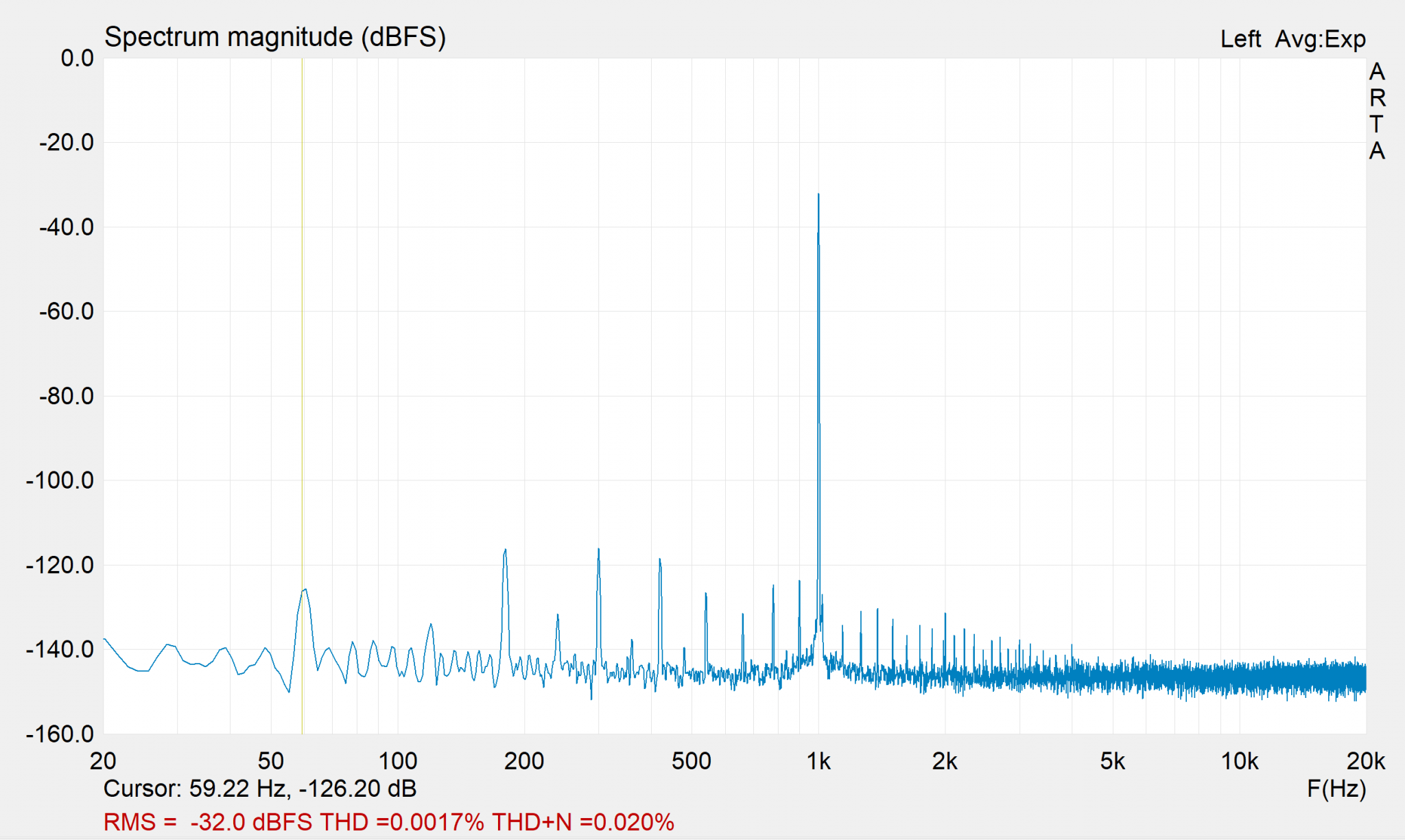

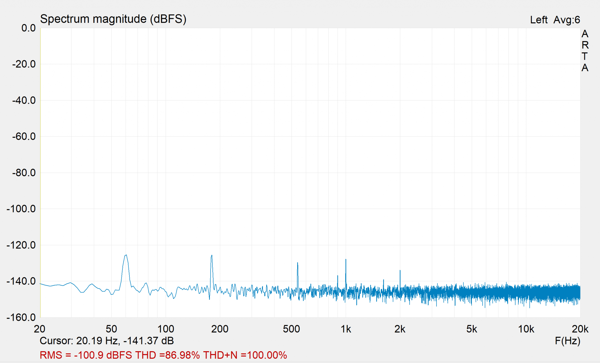

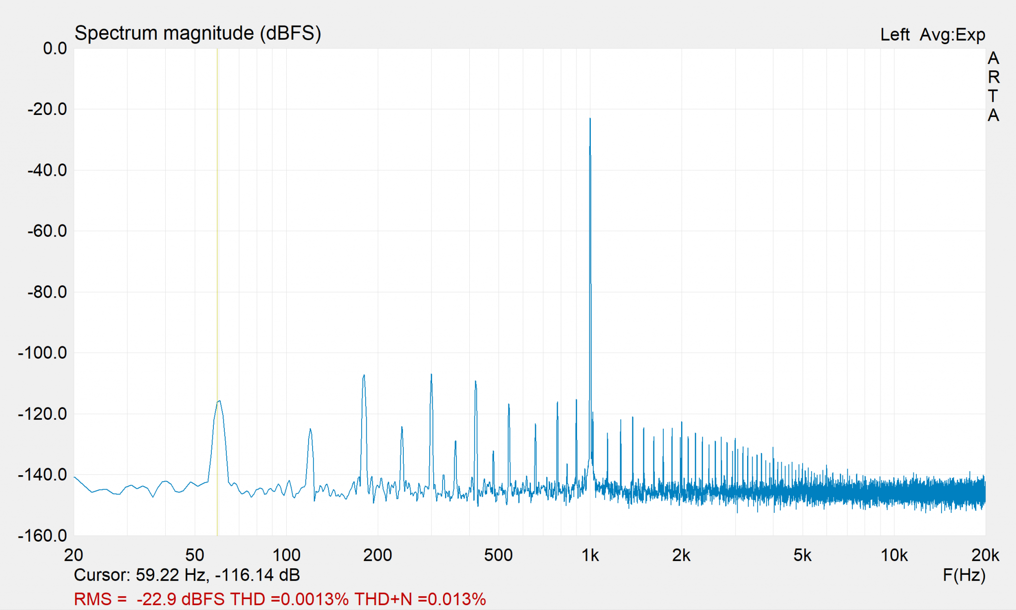

I measured THD and THD+N today using ARTA.
I am not sure what to make of those graphs. I used a few different settings for the volume out and mic in on my sound interface. I also used averaging on some graphs.
My guess is that I need to use regulated power supply to get rid of all the spikes in the graph. Even though they are below 110dB mostly.
