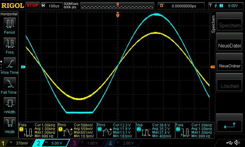

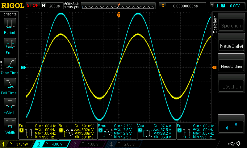

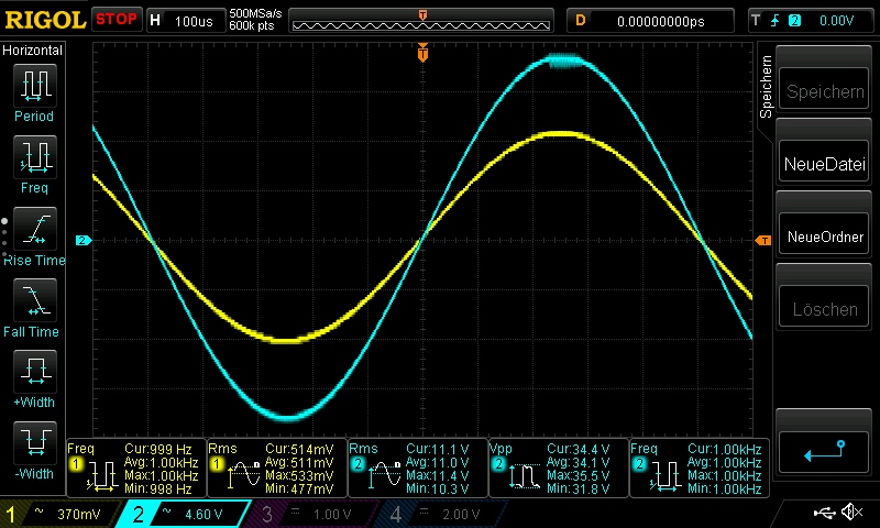

i did the following tests with 1khz sine wave. 2x 1875 ebay kit parallel, load resistive 4,459R.
pic 1 +25_-25V supply_620mVrms_start oscillating
pic 2 +25_-22V supply_620mVrms_start oscillating
pic 3 +25_-22V supply_640mVrms_start oscillating
pic 4 +22_-25V supply_560mVrms_start oscillating
pic 5+25_-20V supply_640mVrms_start oscillating
at pic 5 the positive input goes up to 640mVrms compared to pic 1 620mVrms

...sorry...... i forgot to inform you that this pics are not from the same channel- this pics are from the right channel. it is a bit better before oscillating 620mVrms.
channel L give us 590mVrms. e.g. lch, post 279,post 258

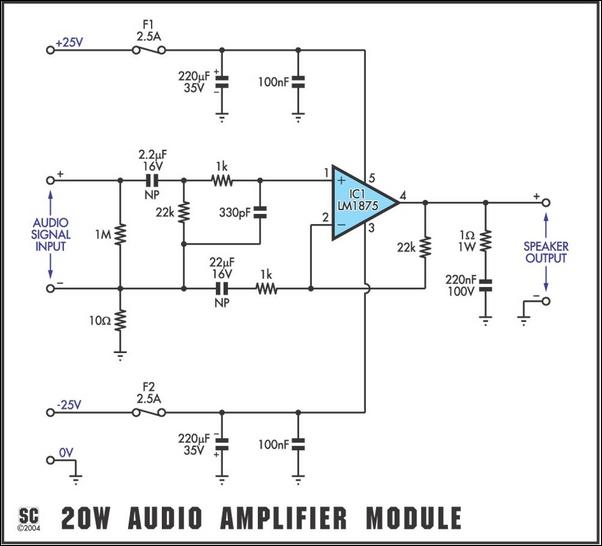

Do you think it would be possible to change your boards to inverting mode and rerun the tests?
Short the input, desolder the feedback capacitor and inject the generator signal to the lower feedback resistor?
It's the 22uF, 16V NP capacitor. You have the inverting input right there, ground and everything.

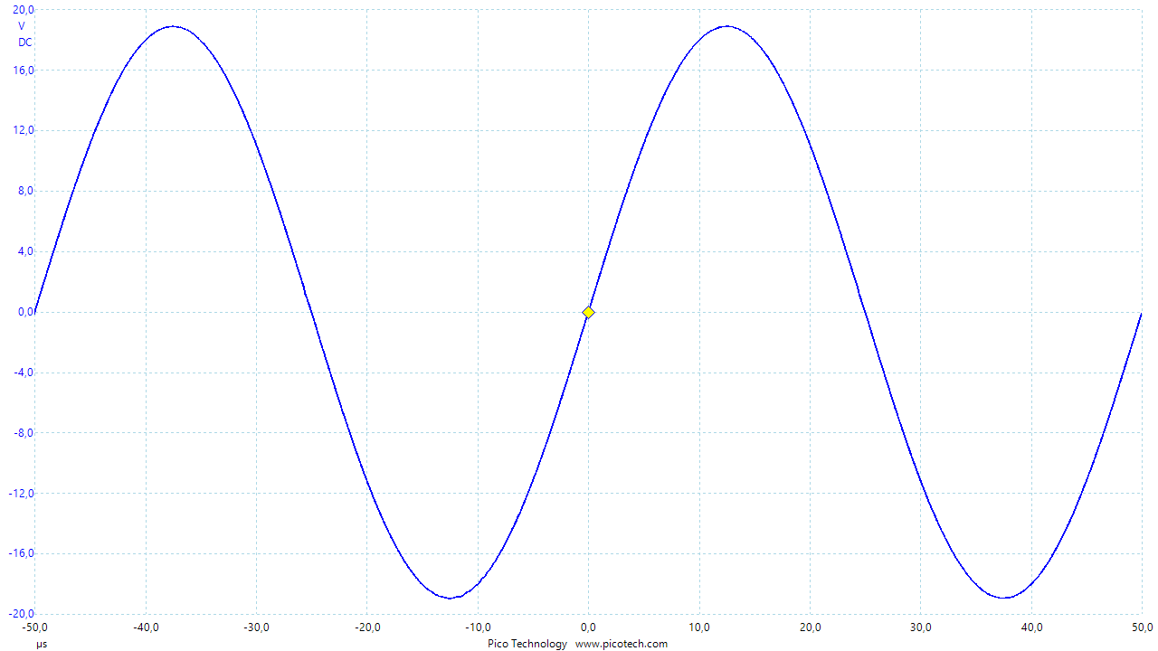

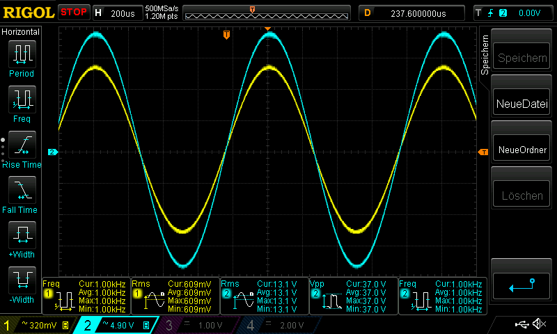

EURECA!
Increasing the gain in the 1875 solves the oscillation. This is with -3,33x.
I need to come up with optimum values for the gain and compensation now...
20kHz, just before clipping attached.

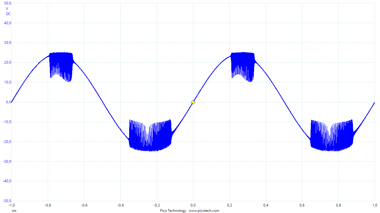

I am back at the -1.5x (only) gain at the 1875.
I have found out an interesting phenomenon.
Increasing the gain at the high frequencies begins to cancel the - lets call it: "half rail oscillation".
There seems to be several ways to cancel out this oscillation.
Increasing the over all gain at the 1875, ruins the THD, well not completely, but some here and some there and soon you have nothing... But cancels some (- all) of the oscillation.
But increasing the gain at HF only, also improves the THD at lower frequencies!
I can increase the HF gain both at the 5534 and at the 1875 and both helps to the half rail oscillation problem.
Interesting...
Top rail oscillation, near (at) clipping, will always be there, so lets forget that. It is built into the chip for good.

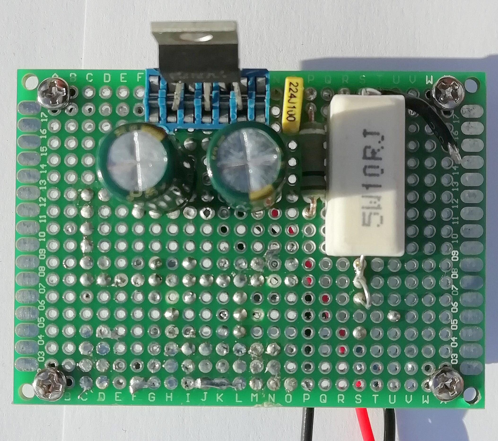

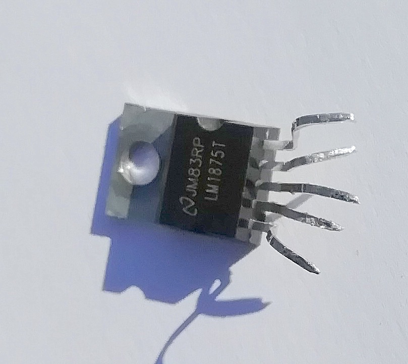

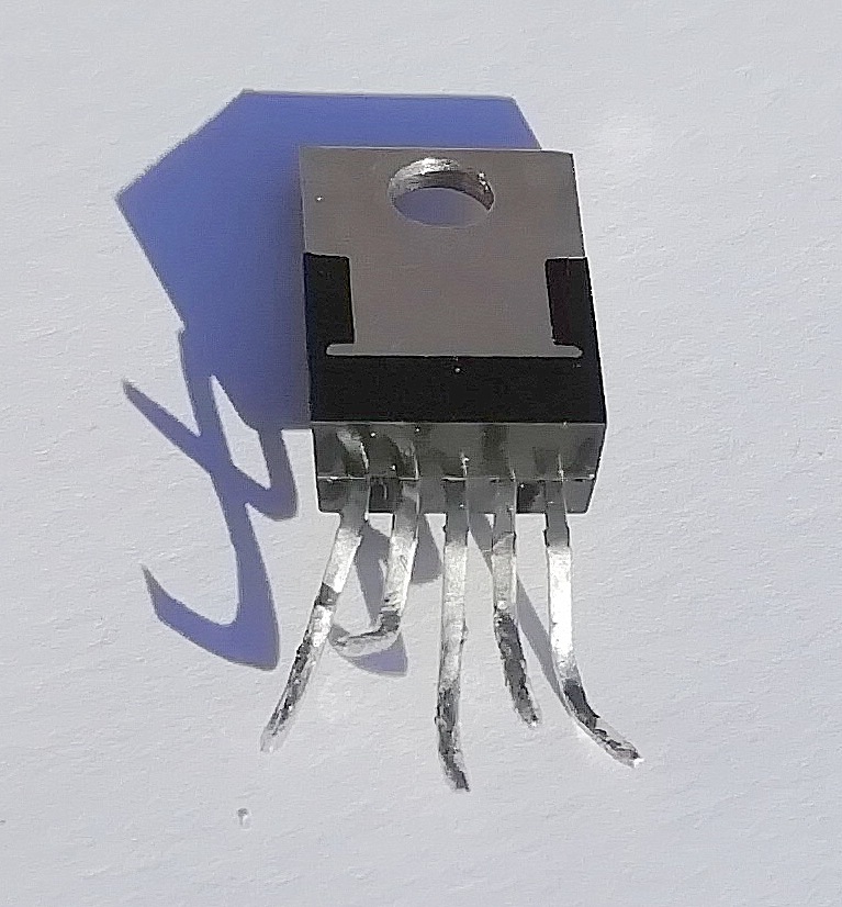

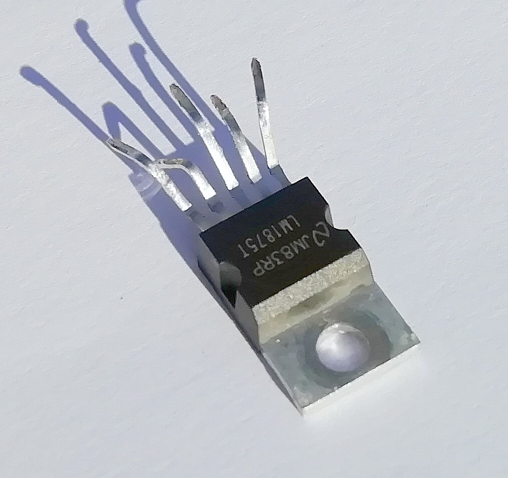

I finally decided to move-on with my “triple” and my LM1875 test-amp had become redundant.
So, I did the short-circuit test as suggested.
Checked first that the amplifier still worked well with the oscilloscope and a sine-wave signal – OK.
With power off, I reduced the input signal to very little and short-circuited the load. Turning on the power did not harm the LM1875.
After having turned the power off again, I removed the short-circuit. Then, I put power on and adjusted the input level to 10Vpp at the output. Power off again and the short-circuit back across the load.
When I turned power on, I heard a small “paff” from the LM1875 so I switched power off and removed the short circuit. When I switched power on again, I heard two more loud “paff”-”paff”. The output voltage would remain at around -12V constantly. The LM1875 chip was destroyed. I removed the chip from the PCB and measured 250 Ohm between output and the negative power terminal without supply voltage. Also my LM1875, that performed like a genuine LM1875 dynamically, had a useless current limiter. Performance-wise it was “fake”.
The photos show the defect LM1875 IC after test. No signs of physical defects – I wonder how the “paff”s are produced? The external componenets were in functional order.

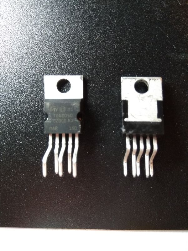

As Turbowatch2 rightfully says, there are differences between geniune and fake.
Genuine LM1875s cost a little more than half of genuine LM3886s. One LM3886 has a power capacity a little above four LM1875s. As the fakes are performing dynamically close to genuine LM1875, I will continue with fakes during the experimental phase. If a PCB is later on made, I may consider genuine LM1875s for that.
FauxFrench .., of course i recognise your "LM1875" chip 🙁,
I am using the same ones. However when building and testing my amp recently, i came to the conclusion, it rather behaved as a TDA2050.
The chip clearly did not appreciate voltages above 24 V and just under 25 V a kind of protection circuit was probably triggered, resulting in oscillatory artifacts on the output. Reducing the voltage to under 24 V restored the stability.
Of course the +/-30 V of the LM1875 specification was clearly not met.
And i did not perform your "ultimate" test.
I was somewhat intrigued by this behaviour and out of curiosity i ordered some chinese TDA2050's. Of course fake TDA2050's because the genuine ones were taken out of production years ago.
When i received the copies my assumption was confirmed, the look and performance was identical.
However the chips as such are doing a decent job, more or less in line with the TDA2050 datasheet.
And as such the TDA2050 also "was" a decent chip.
Again out of curiosity i ordered 4pcs of UTC's "genuine" TDA2050. Apparently UTC is manufacturing the chip under license and at least a professional looking datasheet of the UTC chip is available. (Chip ordered and supplied by Reichelt).
From what Google found, this chip is in current production and the closest to the original one. It is also claimed to be short circuit proof.
In the coming days i will perform some tests and measurements of the various chips (LM1875 and TDA2050) in my possession and post the results.
Well.. this is just my story and please be aware that your "exploded LM1875" is also sold by the Chinese as "TDA2050".

I have now made a small LM1875/TDA2050 tester such that I can do basic tests on all my chips before soldering them in a circuit. I will show my test results when ready.
UTC2050 will most likely work as well as "old" TDA2050. They are not fools out there and perhaps they even worked as second source to STMicroelectronics in those days.
