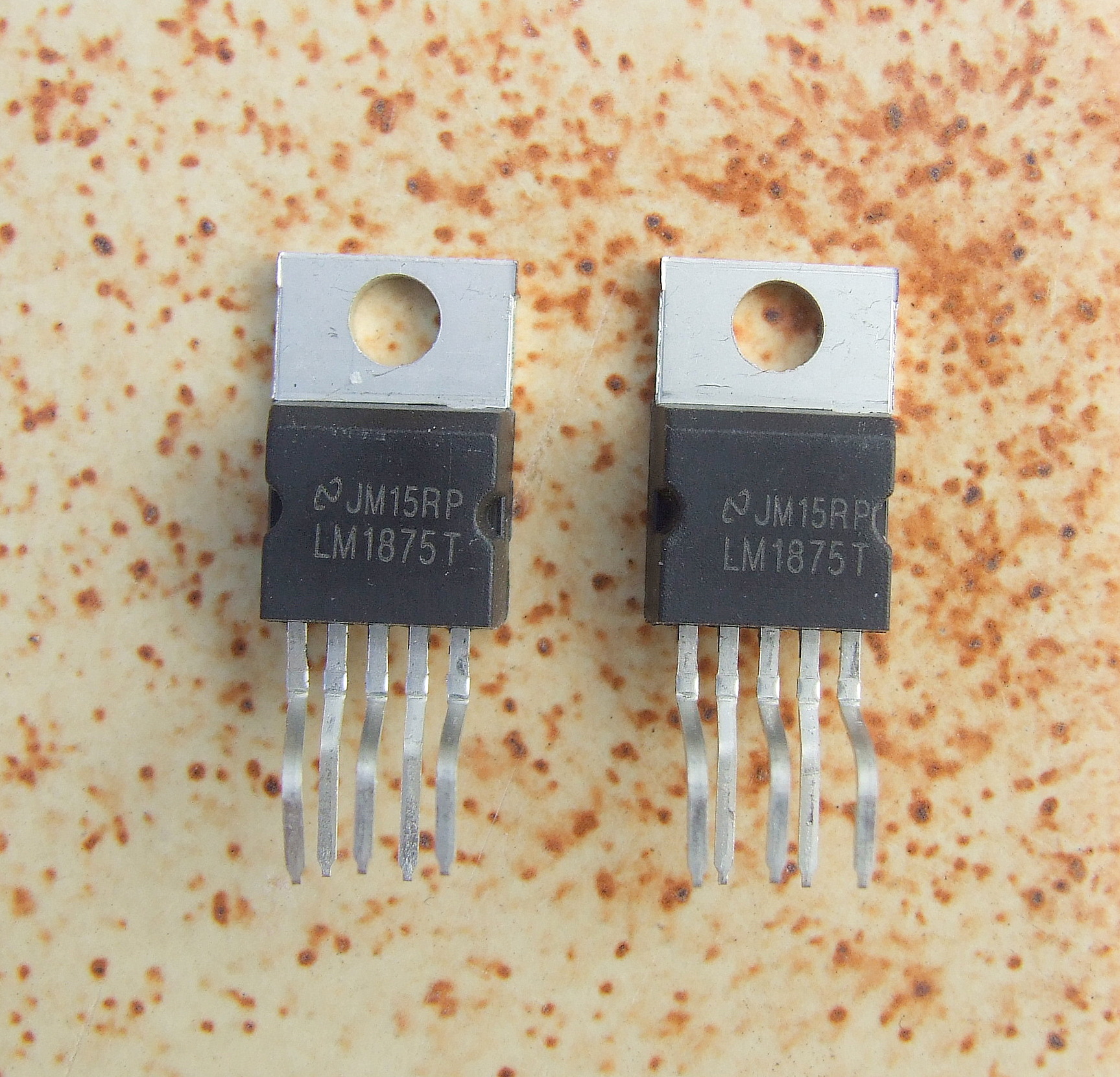

A first issue to discuss is how many LM1875 to put in parallel such that a BTL configuration is possible with the relevant load impedance.
My personal view is that loads between 4 and 8 Ohm are relevant. 2 Ohm loads, I find relate to vehicle use. With 2 Ohm loads, the currents become high while the voltages can remain low such as used for electrical systems in vehicles.
The LM1875 exists from (at least) two sources: The original LM1875 designed and manufactured by National Semiconductor (today TI) and a more recent “CD1875” of Asian origin. The manufacturer of the “CD1875” I cannot identify because I cannot read what I believe to be Chinese. From what I can read in the “CD1875” datasheet , it appears that the specifications are the same for both chips.
From the NS/TI datasheet the following relevant characteristics are found:
Figure 5: Output power vs supply voltage (typical). With a +/-25V supply, the clipping limit with an 8 Ohm load is 25W. 25W in 8 Ohm corresponds to a voltage of 14.1 Vrms or 20 Vpeak. Thus with 25V supply, the chip output will clip at 20V such that the voltage drop caused by the driving circuit is effectively 5V.
With a +/-28V supply, the clipping limit with an 8 Ohm load is 30W. 30W in 8 Ohm corresponds to a voltage of 15.5 Vrms or 22 Vpeak. Thus with 28V supply, the chip output will clip at 22V such that the voltage drop caused by the driving circuit is effectively 6V.
“Description” (page 1) and “Absolute Maximum Ratings” (page 2): The absolute maximum supply voltage is +/-30V (60V total). At the same time, the description indicates that the chip may be used all the way to +/-30V supply. However in order not to exceed the absolute maximum supply voltage, it is risky not to leave a supply voltage margin of 2V such that in reality +/-28V supply is the maximum used. From the section above we know that with +/-28V supply we will (typically) have a clipping voltage of 22V. For SE amplifier configuration, 22V means 2.75Apeak (1.95Arms) in 8 Ohm and 5.5Apeak (3.90Arms) in 4 Ohm. For BTL amplifier configuration (where both voltage and current is doubled), clipping at 22V means 5.5Apeak (3.90Arms) in 8 Ohm and 11Apeak (7.80Arms) in 4 Ohm.
2.75Apeak in 8 Ohm means 30W in 8 Ohm (SE-configuration).
5.5Apeak in 4 Ohm means 60W in 4 Ohm (SE-configuration).
5.5Apeak in 8 Ohm means 120W in 8 Ohm (BTL configuration).
11Apeak in 4 Ohm means 240W in 4 Ohm (BTL configuration).
“Electrical Characteristics, Current Limit” (page 3). The internal current limiter of the LM1875 will typically kick-in at 4A (instant peak) but for sure above 3A (instant peak). Only the limit of 3A can be relied upon in design. The “typical” 4A will provide a convenient margin.
If a good parallel design is made, we can rely on a very good load sharing of the paralleled LM1875.
2.75Apeak can be handled by a single LM1875 to deliver 30W in 8 Ohm. (SE-coupling)
5.5Apeak needs two LM1875 in parallel to deliver 60W in 4 Ohm. (SE-coupling)
5.5Apeak needs two LM1875 in parallel to deliver 120W in 8 Ohm. (BTL coupling)
11Apeak would need four LM1875 in parallel to deliver 240W in 4 Ohm. (BTL coupling)
For a 6 Ohm load, the peak current would be 7.3Apeak in order to deliver 160W in 6 Ohm (BTL coupling). That would require three LM1875 in parallel.
My personal view is that it is exaggerated to design for 240W in 4 Ohm using the guaranteed current limit. With the typical current limit of 4Apeak, the 240W output power in 4 Ohm can be reached with three LM1875 in parallel. Else, the supply voltage can be reduced a little to stay within the guaranteed current limit.
My personal opinion is that three LM1875 in parallel is a good compromise. In BTL coupling, they will allow 120W in 8 Ohm with good current margin or even 160W in 6 Ohm. More than 200W in 4 Ohm may be reached but the supply voltage may instead be reduced such that 160W in 4 Ohm can be reached within guaranteed current limits.
Please let me hear your opinion.

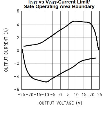

additionally to that i am not really sure i understand our first discussion about the current limiter in the other thread:
https://www.diyaudio.com/forums/chip-amps/341675-ebay-mono-lm1875-kit-19.html#post5941439
the graph looks like that we are above 20V rail in the current limiter- with 1 chip for sure...? or not?
the page 3 current limiter "formula":
Vout = Vsupply - 10V...4A (typical)--> 3A(tested limit)
Does this mean at this current the Voltage will sag down to Vsupply - 10V??
Does this mean at this current the Voltage will sag down to Vsupply – 10V??
It seems that in my posting #187 I have grossly dodged your question about how to interpret the two graphs. I hate strange looking graphs in datasheets but now I had to concentrate and think.
To me, the two graphs look like two graphs describing the dynamic value of the positive and negative chip current limiters respectively. The chip is supposed to operate in-between the to curves.
I will try to explain: Had the current limiter values been for instance 3A fixed, the curves would have been two horizontal lines at +3A and -3A. The LM1875 has a (typical) dynamic characteristic such that at an output voltage of 0V, 3A can be drawn before the current limiter is activated, at 5V output voltage 4A, at 10V-15V output voltage more than 4A, at 20V output voltage 4A. Above 20V output voltage the current limit drops very rapidly. Similarly for the negative current limiter.
With a constant value load at the output, the current in the load increases steadily and linearly from zero. As long as the load current curve stays below the dynamic current limit curve, there is no problem. Above an output voltage of 20V, the load current curve is close to the dynamic current limit curve and problems start. It appears prudent to avoid operating in the area with output voltages above 20V where the current limit drops very rapidly. The supply voltage should be limited to +/-25V such as concluded from Figure 5 of the datasheet.
If we limit the supply voltage to +/-25V such that we can expect output signal clipping at 20V, the output power calculations become:
SE-coupling: 25W in 8 Ohm.
SE-coupling: 50W in 4 Ohm.
BTL-coupling: 100W in 8 Ohm.
BTL-coupling: 133W in 6 Ohm.
BTL-coupling: 200W in 4 Ohm.
Still respectable values.

The LM1875 I will be using are bought for around 2 Eur per 10 pcs. Probably "fake" or CD1875 versions but I have already tested two items and they seem to work. At least when I do not take them to the limit.
