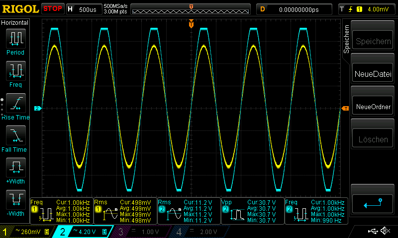

to be clear which supply voltage we should have for 4 R load i did a test again.
to get 3Amps aout we need at 4,459R a Voltage rms about 13,37V at the resistor.
i use 25V supply but with the with 450mVrms i get this current limiter. switch on_off_ on off --> i show this in the LM1875 kit thread.
i go dwon with the supply 20V - this is the max off Voltage of the chip to do not go into the limiter. and here are the results:
pic 1 +/- 20V supply 500mVrms in (G=27dB) 11,2 Vrms at the load of 4,459R -- clipping

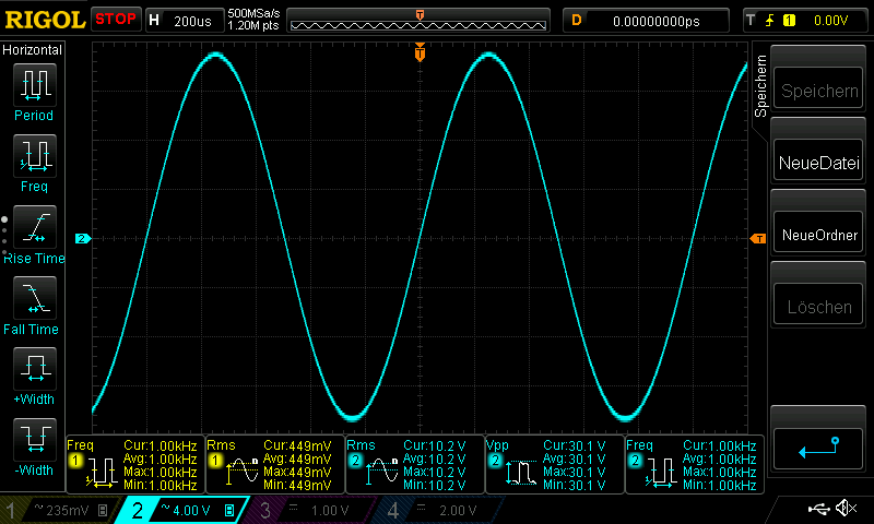

pic 2 +/- 20V supply 480mVrms in (G=27dB) 10,6 Vrms at the load of 4,459R -- clipping
pic 3 +/- 20V supply 460mVrms in (G=27dB) 10,2 Vrms at the load of 4,459R -- no clipping - this give us a current of 2,287Amps continuous

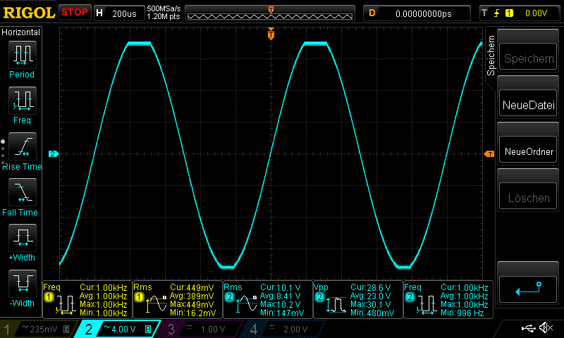

pic 4 +/- 15V supply 460mVrms in (G=27dB) 9,3 Vrms at the load of 4,459R -- clipping - supply voltage too low

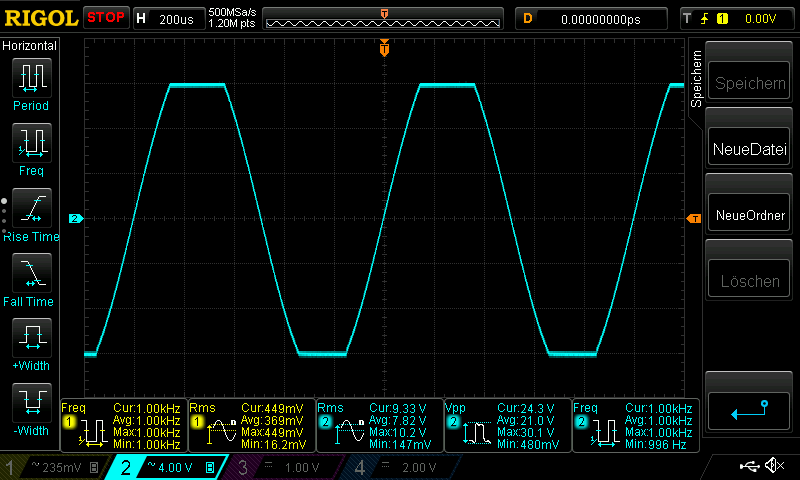

pic 5 +/- 18V supply 460mVrms in (G=27dB) 10,1 Vrms at the load of 4,459R -- clipping - supply voltage too low - closed to 20V supply but not enough this give us a current of 2,265Amps continuous

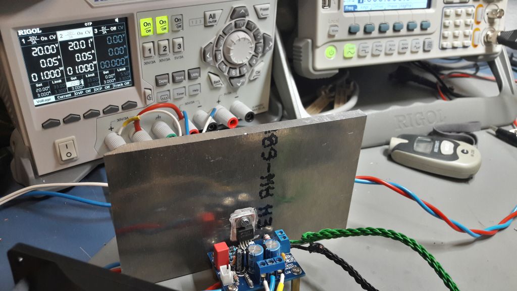

pic 6 is the test enviroment - idle - no signal
so we should calculate per chip at 4R with 2,2 continuous?

Good work as usual, Chris. The current limit kicks in at 2.3Arms corresponding to 3.25Apeak. I assumed use to 3Apeak in the initial estimations so that wasn't completely wrong.

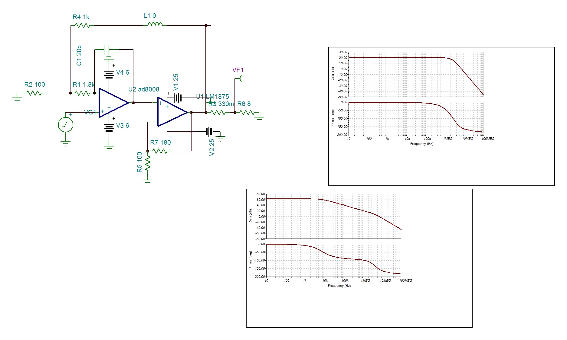

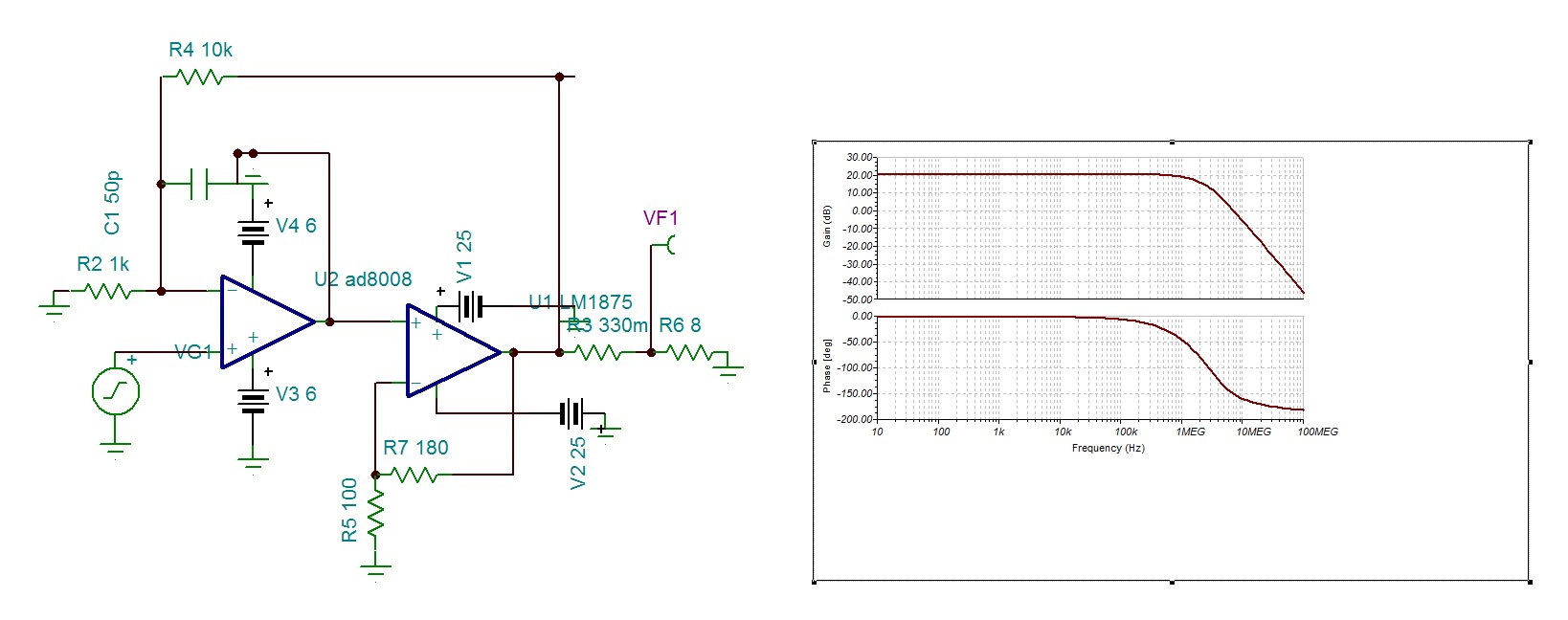

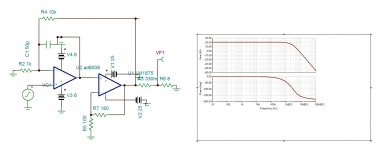

here is a first approach for composite .
I agree on the design. We may have to adapt some component values. With the present values, the gain of the LM1875 should be below the minimum gain for stability (10 times / 20dB).

Look at the frequency response curve/ phase , there is no any resonance. The LM3886 also is 20db minimum but with 1K input impedance, I use it at gain 10db stand alone with 100 ohms impedance without any problem . On simulator it shows the same behavior with 1875. The AD8008 is a CFA with open loop frequency response of 100khz , the open loop gain is adjusted by the negative input resistance 1K bringing the open loop gain of about 70db. With closed loop gain of 20db, and 10db gain of LM1875, it provides 40db enhancement . Of course the distortion now is dependent mainly to the op amp. Simulator calculates 0.00025% @10khz.I agree on the design. We may have to adapt some component values. With the present values, the gain of the LM1875 should be below the minimum gain for stability (10 times / 20dB).

With this version you can adjust the open loop frequency response vs NFB , by adjusting R1 &C1. It allows you to tune by ears for best sound . Chermann , as you have a working circuit on bench , can you please replace the feedback resistors to 180 ohms 1W /100 ohms and listen the sound using multiple brass jazz orchestras.
