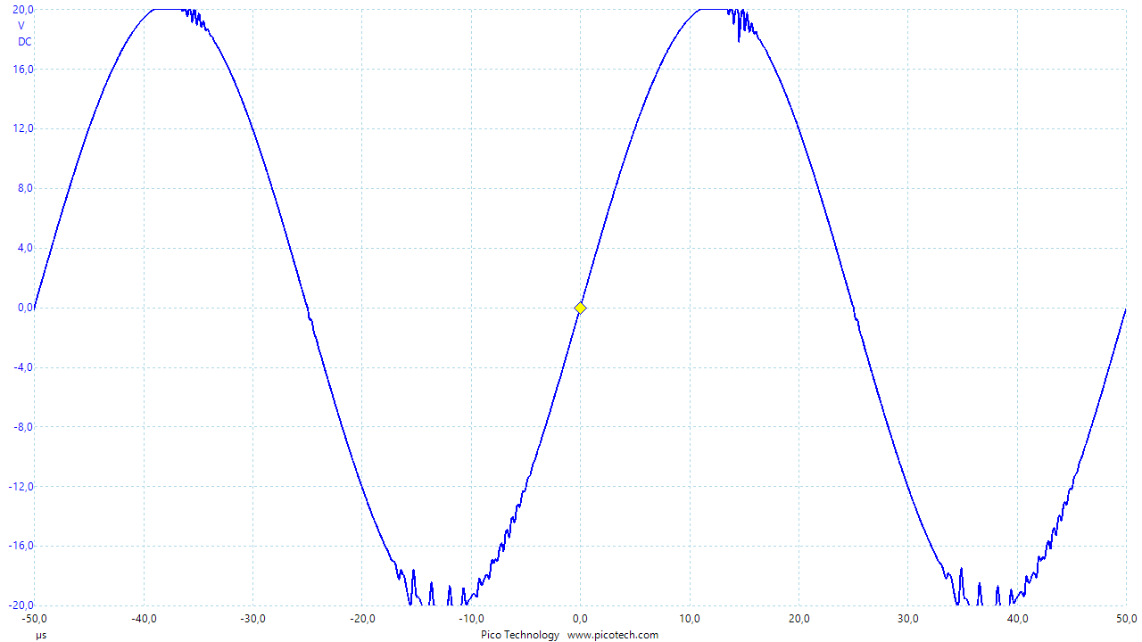

I am leaning towards the idea, that this is a 1875 related feature?

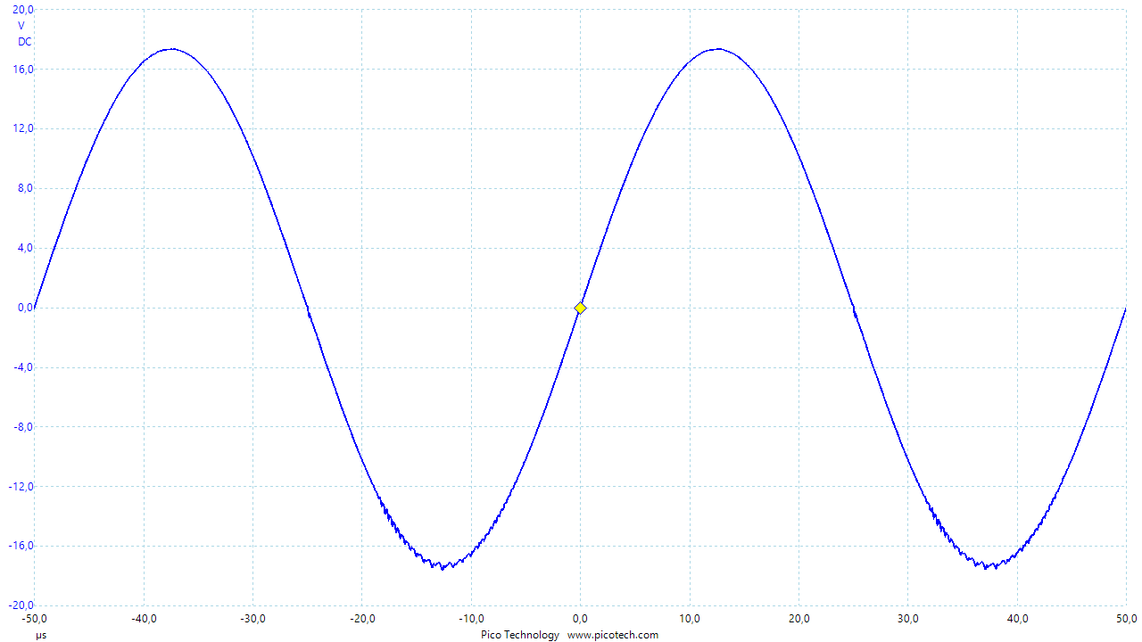

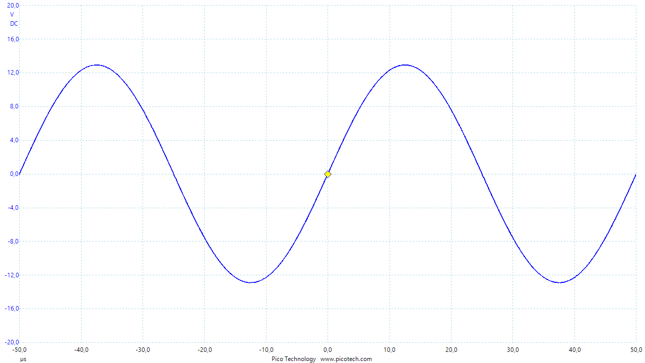

Here is results if rail voltages are lowered to +/-24V.
With +/-25V we would get quite clean 25W output.
Anyways, 20kHz 8R...
Positive rail clipping. Otherwise positive rail is clean.
Negative rail starts to oscillate shortly after -12V.
But much less oscillations when rail voltages down.
I can also see some crossover distortion.
Compensation 10pF.

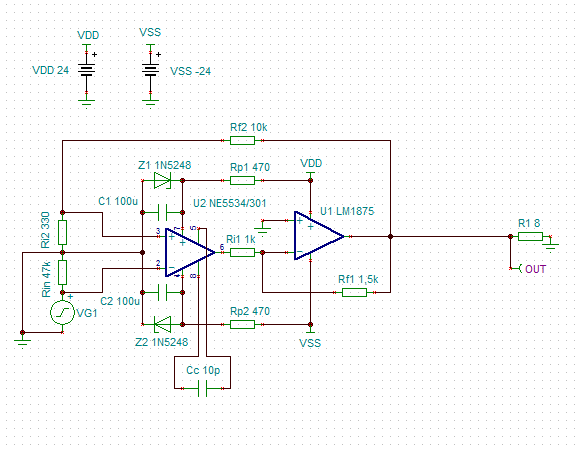

Compensation at the 1875 feedback improves things a lot.
100pF parallel with the Rf1.
Rf1=2k2, Ri1=1k5.
I have the non-inverting input of the chip directly grounded. That results in offset at the chips output. Which 5534 will fix. I was wonderin, if I put 1k in series, with the non-inv, to gnd?
I have the oscillation problem at the negative channel. Everyone else seems to have it at the positive ch?
And the only difference is the inverted configuration in my circuit???
Just wondering...?
Try it.

I don't think the 1.8K at in+ is a good idea; From the datasheet Ios = 0 typical means it is internally compensated.
http://www.ti.com/lit/pdf/snas524
The datasheet states an Input Offset Current of Typical 0uA, with +-0.5uA being the limit. But it also states an Input Bias Current of +-0.2uA within a tested limit of +-2uA.
From a google result:
The input offset current (IOS) is equal to the difference between the input bias current at the non-inverting terminal (IB+) minus the input bias current at the inverting (IB-) terminal of the amplifier. Offset current is typically an order of magnitude less than bias current.
From this I would deduce that a resistance at the non-inverting input, that equals the resistance at the inverting input, would be a necessity to cancel out the bias currents of both inputs and thus arrive at the stated offset current of 0uA. Can't hurt to try it out in any case.
Will try the 1k resistor.
Nope. Thats not it.
Might as well have it on the gnd, with less noise.
