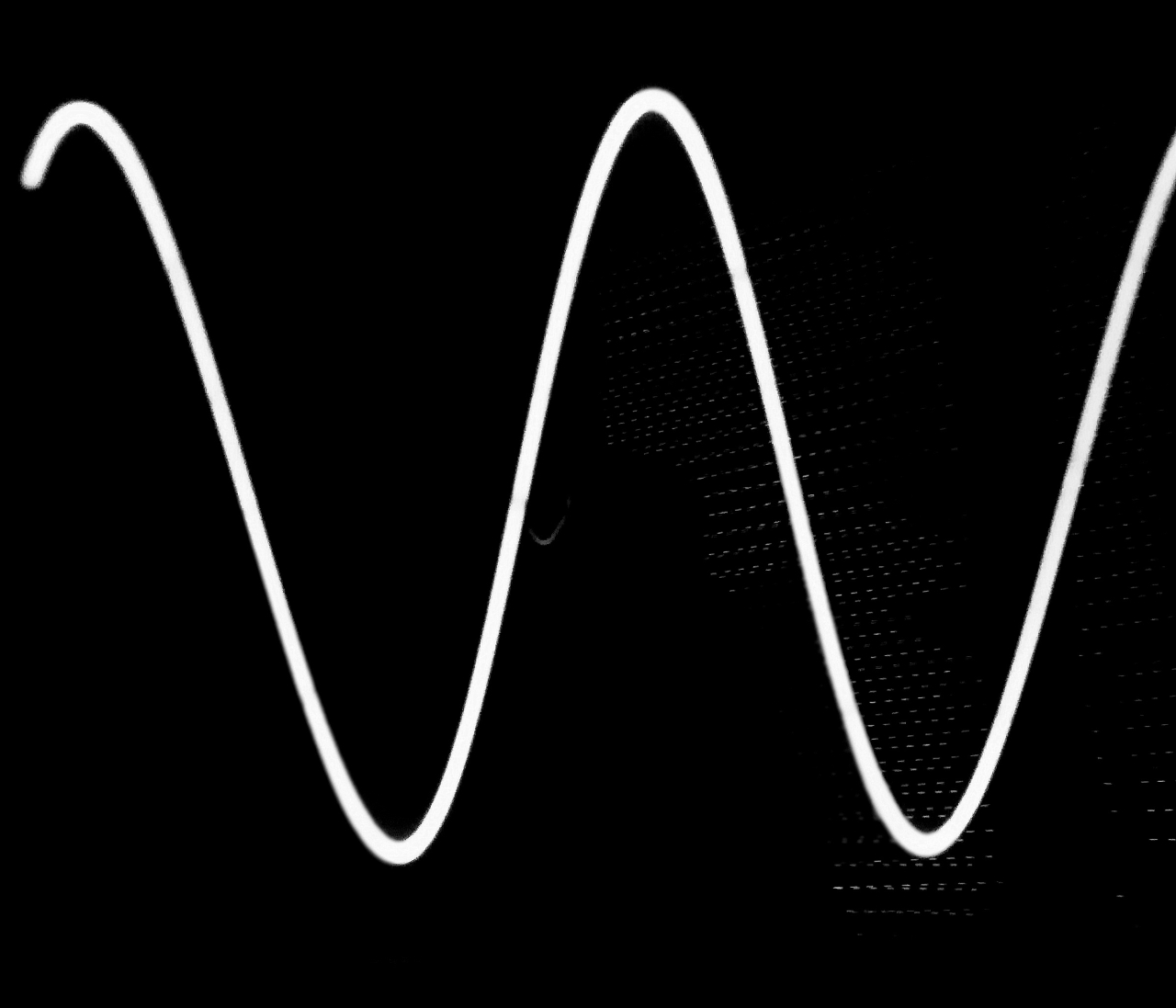

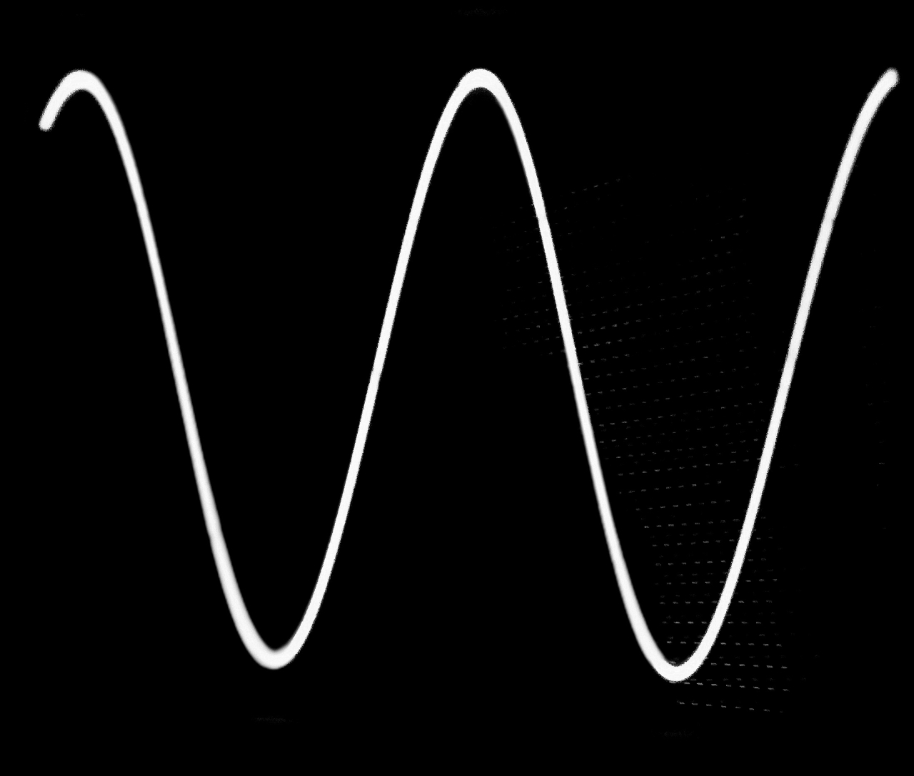

LM1875 in parallel configuration and used in a composite amplifier.
Have you looked at how the amp resists at capacitive loads. ( like 10nF // 8 Ohm )
Same, higher oscillation near clipping ?
At that time I did not. I knew there was a kind of capacitive sensitivity test but I did not know how much was realistic to add at the output in parallel with the resistive load. I asked at that time on the forum but got no reply. 10nF//8 Ohm sounds fine but do you know if these are common test values?
A forum search with "capacitive load", found few threads.
In this one: Phase margin with capacitive load
I see 100nF//8ohm.
Values depends of authors and their objectives.
I think 10nF is a good value to start with, and would explore in the range 1nF 100nF.
Many thanks for the important information. I will try that test when I find time. At the time with my first LM1875 tests, I tried with better decoupling of the LM1875 supply terminals but I did not have any real luck with the peak oscillations. I could make probably fake LM1875s work around +/-29V supply and with oscillation free clipping using a 16 Ohm load. With an 8 Ohm load, oscillation started from above +/-24V supply. From that I assumed that I could get away with 10 Ohm loading per LM1875, in particular with genuine LM1875s. Perhaps it is not that simple.

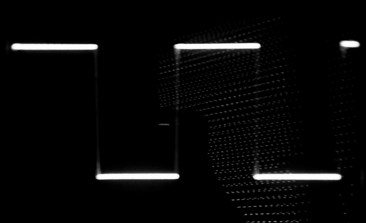

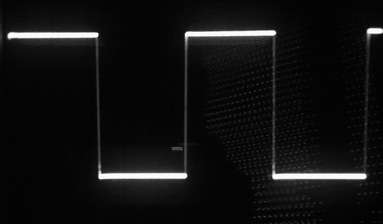

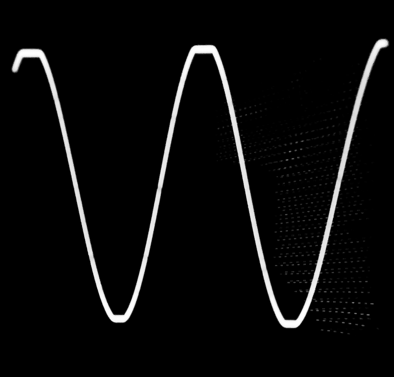

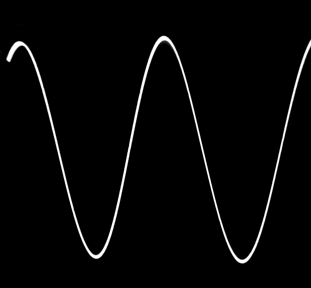

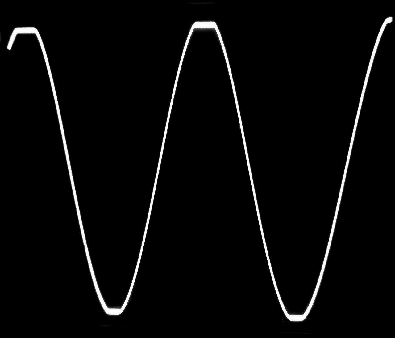

I modified the component values of my test LM1875 power stage to those shown in posting #239. Then I tested it, as suggested by mchambin, with capacitors in parallel with the load. I used my on-board 10 Ohm load (not 8 Ohm) and first 10nF in parallel, then 100nF. I noticed pretty little changes with the capacitors. My output sine-wave peaks also become "woolly" very near to clipping. Below clipping the sine-wave is correct.
1KHz signal. +/- 24V supply.
Picture 1: 10nF in parallel, just before clipping.
Picture 2: 10nF in parallel, starting clipping.
Picture 3: 10nF in parallel, square-wave 20Vpp.
Picture 4: 100nF in parallel, just before clipping.
Picture 5: 100nF in parallel, beginning of clipping.
Picture 6: 100nF in parallel, square-wave 20Vpp.
Picture 7: No parallel capacitor, Thiele network inserted and clipping.
The picture quality is pretty poor such that you do not see fine details. Sorry!
The Thiele network was 2.2uH in parallel with 10 Ohm.

Looking pretty good, FF! Almost too good to be true... Try to add 1uF and see if that makes a difference for the square wave. You won't see much on the sine wave, except for some spurious oscillations (and of course heavy oscillations when the capacitance is much too high).
I agree, seems too good to be true. The LM1875 is fake but does not oscillate when the datasheet indicates it should. Normal output offset. Is pretty unimpressed with capacitive loading.
It feels like receiving a letter from the tax department informing you that you will have money returned from last years taxation. Am I dreaming or awake?
I had prepared the 1uF but exceptionally much rain made my attention elsewhere necessary. Tomorrow.
