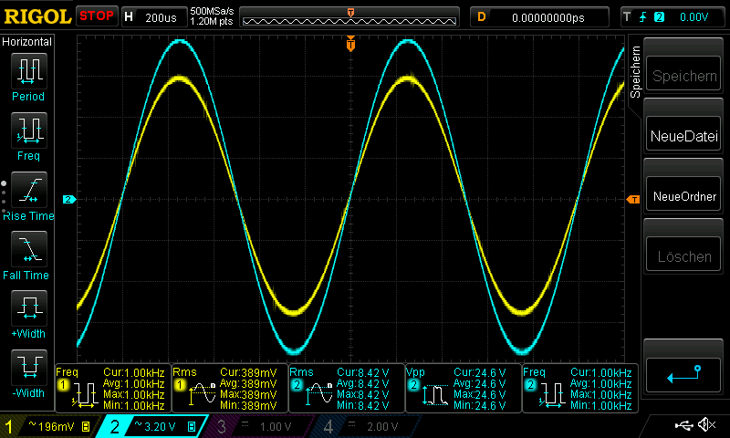

Good morning
i did the test with lower supply voltage +8R load:
+/- 20V supply at 360mVrms in 1khz output fine with 7,58Vrms - 7Watt, no other tests
+/- 18V supply at 400mVrms in 1khz output with 8,38Vrms (26,3Vpp)- 8,7Watt but i got on the positive rail the top end oscillating. according to the datasheet its the max because Vout = Vsupply - 10V. if i lower the input voltage to 380mVrms in i still have this oscillating.
+/- 15V supply at 300mVrms in 1khz output with 6,51Vrms - 18,9Vpp - 5,2Watt - i got again the clipping (cut the top end of the sine) on the positive rail. so its the other rail which is cut now. - pic
for me this LM1875 is "thermal cracked" - maybe it was my fault to cool it not enough with a fan during my test...i don't know
chris

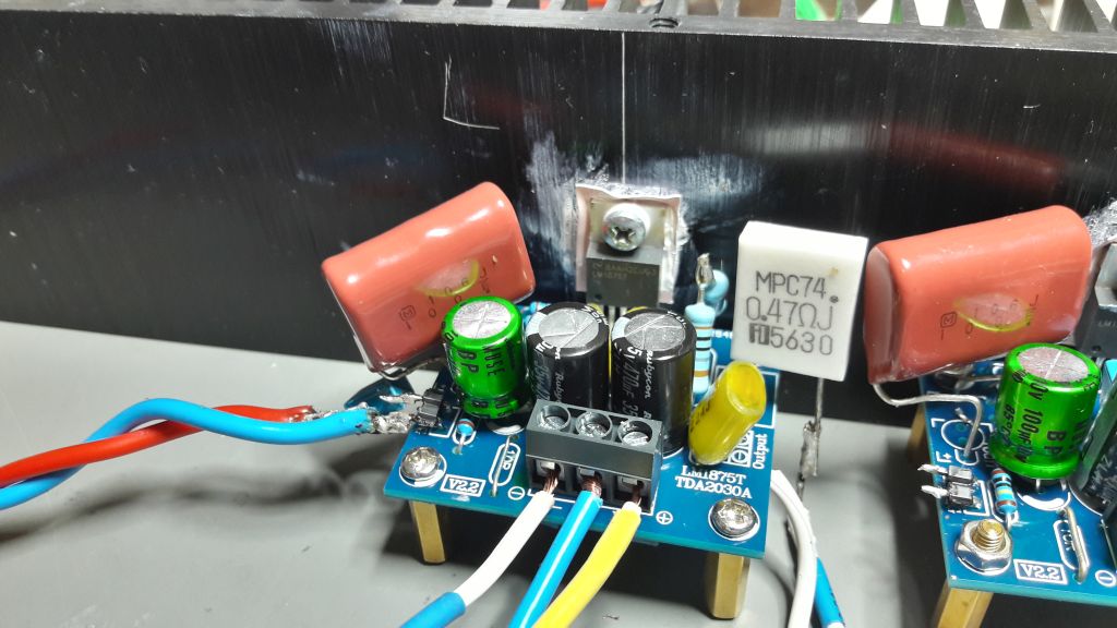

Hi Chris,
As the two amplifiers are mounted on the same heatsink BUT THEY ARE NOT CONNECTED with one another through the 0R1 balancing resistors at the outputs (I assume), one amplifier works but the other shows oscillation at certain non-obvious supply voltages, it's time to move on. Replace the seemingly flawed LM1875 with another "genuine" LM1875 and try again.
The 0R1 resistors are pretty small in value. Try 0R5 or so if you want to connect them in parallel again.

LM1875 repaired...
Hi
i desolder every componentn and re check them. because of bad quality of the PCB during desoldering i use a new board. as FF wrote i changed all load sharing resisotrs to 0R47 (0,47R) and tested the new board. every thing fine.
pic 1
+/-20V supply , DC offset -1,6mV i got into 8R with 480mVrms in (1khz) 9,89Vrms /28,9Vpp out = 12,2Watt- scope looks fine without clipping or oscillating. a bit more and the LM1875 starts slightly to oscillating on the positive sine wave top end.
+/-25V supply , DC offset -1,9mV i got into 8R with 570mVrms in (1khz) 11,9Vrms /35,1Vpp out = 17,7Watt- scope looks fine without clipping or oscillating. a bit more 580mVrms input - the LM1875 starts hard to oscillating on the positive sine wave top end. with 650mVrms in i got hard oscillating and 13,4Vrms / 39,1Vpp into 8R = 22,4 Watt

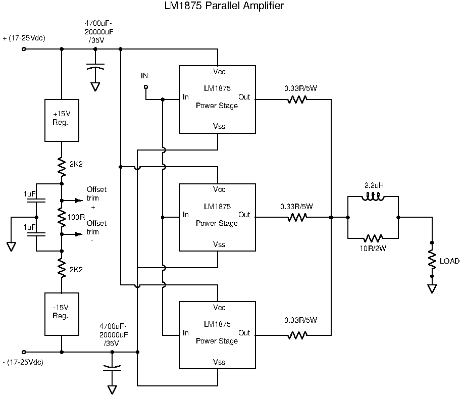

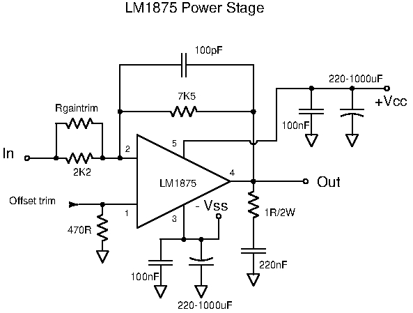

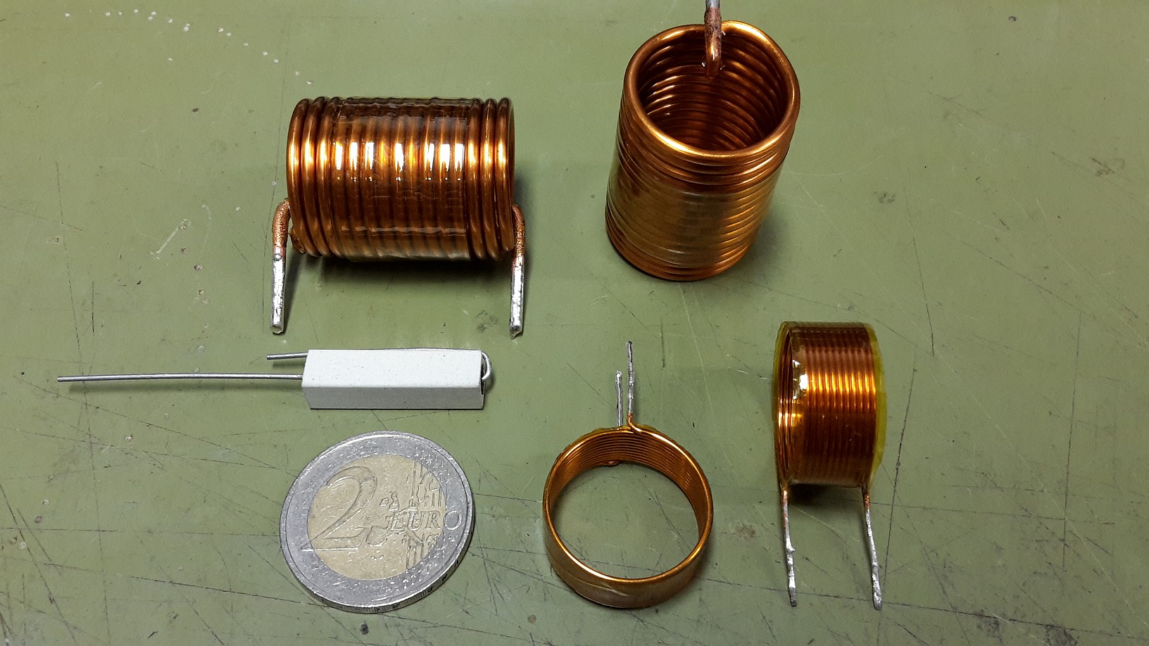

Coil winding experiments
I tried to make some coils with the wires that I have at hand: 0.75mm and 2.0mm diameter enamelled copper. Aimed for 2.5uH, which calculated to 11 turns for 0.75mm and 15 turns for 2.0mm, both on a 20mm wide piece of plastic tubing as a coil former. Used some Kapton tape to keep the windings together. "Substantial" is a nice word for the huge coils, they're quite heavy actually!
I don't have an LCR meter handy, but I guess they'll all just do fine.
You are a talent. They look really professional. I have ordered some with the ferrite rod inside. If curious enough, you can connect them in series with a known capacitor, find the resonance with your signal generator and calculate the value.

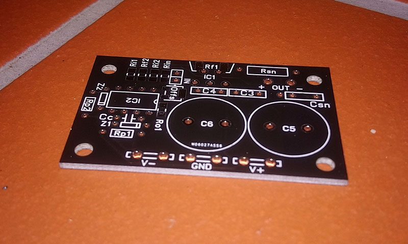

Sorry for the question but I am fascinated by this effort. Is there finalized PCB design? I could not see it within the 233 posts. Could someone fill me in on the status of the project?
Not even close to finish yet.
I have just received a couple of proto PCBs to test the 1875+5534 combination alone...
Still a long way to the parallel bridge from here.
The phases are:
1) Decide on a design for a parallel LM1875 power amplifier (mono/SE configuration).
2) Build the parallel LM1875 power amplifier (mono/SE configuration) and test it.
3) Design and implement (with test) a controlling OP-AMP loop for the parallel LM1875 power amplifier, forming a composite amplifier.
4) Build a second parallel LM1875 power amplifier with a composite amplifier controlling loop. This one with signal inversion.
5) Use and test the two simultaneously in a BTL configuration.
There are initial PCB layouts already on their way but they are meant to experiment with the OP-AMP controlling loop.
At present we are close to finishing 1) above. Yes, it is not going fast but an aim is also to discuss design parameters and trade-offs such that other less experienced members have a possibility to understand why this became the final design and can perhaps themselves make similar designs. On top of that Christmas, New Year, trivial illness etc.......

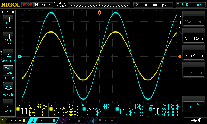

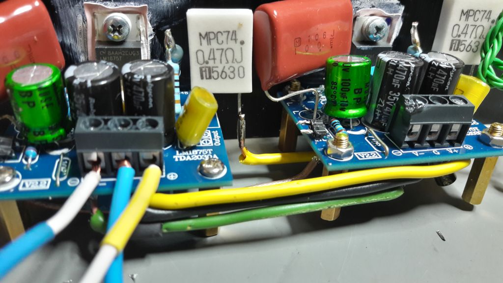

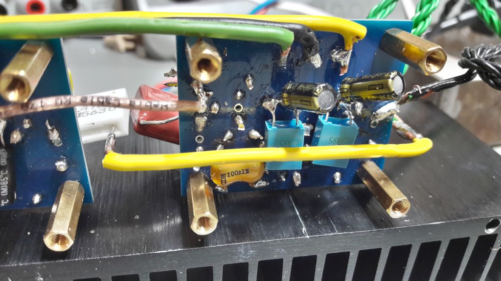

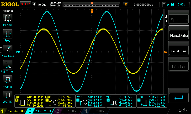

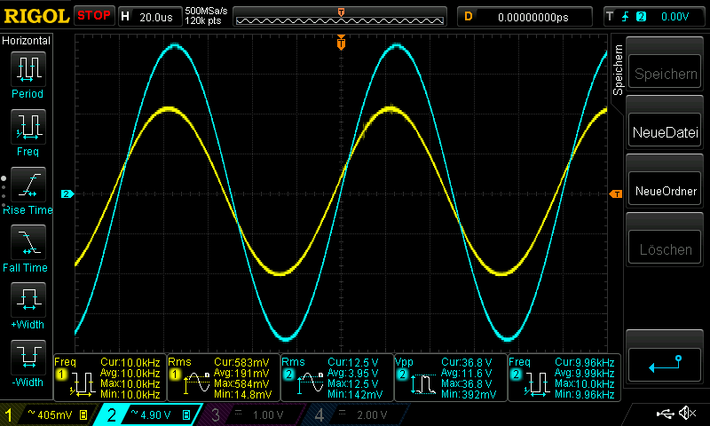

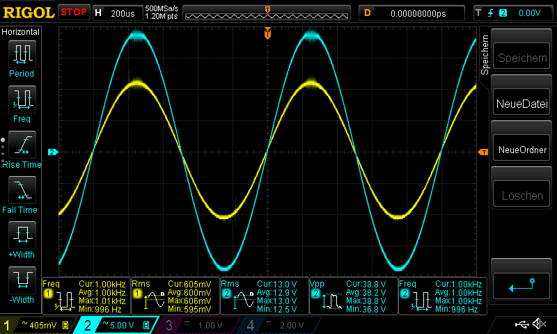

...paralleling 2 1875 ..test and measurments..
Hi
after illness (again) i do some first test with my left side of 2 1875 parallel.
as good as i can measure with my LCR Meter i choose a resistors for the gain setting as exact as possible and i was lucky from my 30 pcs for each value.
load is 4,459R
DC offset -1,9mVrms
pic 1 +2 are the soldering. i use 1,5mm ^2 stiff cables for the psu and the RG178(coax) for the signal, to connect the amps together with the load sharing resistors 0R47 i use the 1,5mm^2 stiff cable too.
idle with +/-25V rail from DP802 supply 90mA each rail = 2,25Watt each rail
at 400mVrms in @ 4,459R load = about 15-16Watt - consumption is 0,97A = 24Watt each rail
at 600mVrms in @ 4,459R load = about 35 Watt - consumption is 1,37A = 34,25Watt each rail
at 620mVrms in @ 4,459R load = about 38Watt - consumption is 1,41A = 24Watt each rail --> at the top sine wave was oscillating small but between the 2 amps output - so no 0R47 resistor - i got at 600mVrms just 0,3mV !! (yes milli Volt) difference !!

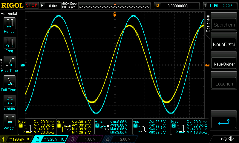

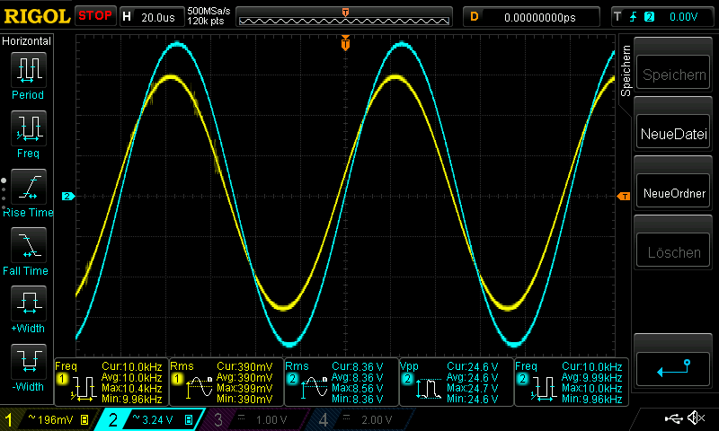

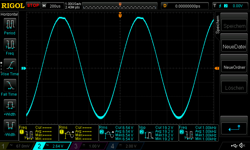

pic 3 400mVrms in 1khz at 4,459Rload - about 16Watt = 1,9Amps
pic 4 400mVrms in 10khz at 4,459Rload - about 15,6Watt
pic 5 400mVrms in 20khz at 4,459Rload - about 14,6Watt
pic 6 600mVrms in 1khz at 4,459Rload - about 35,6Watt = 2,82Amps
pic 7 600mVrms in 10khz at 4,459Rload - about 35Watt
pic 8 600mVrms in 20khz at 4,459Rload - about 32,8Watt
start of oscillating on the top positive sine
pic 9 620mVrms in 1khz at 4,459Rload - about 37,9Watt = 2,91Amps
any additionally test i should do?
chris
Hi
load is 4,459R
DC offset -1,9mVrms
chris
Hi Chris, good initiative.
I am disappointed that you start having oscillation on the tops already when two amplifiers share 2.91Arms.
Do you have the 100pF across the feedback resistors? If yes, try to remove them and see if that helps on the oscillation on the tops.
Do you have a Thiele compensation network between the amplifiers and the load?
I tried to sum up the last weeks results in updated circuit schematics.
Shown is a version with three LM1875 in parallel. Two can evidently also be used. With two, I suggest to use 0.25 Ohm load balancing resistors.
At a moment in near future we will have to close the LM1875 parallel amplifier design phase and progress to implementation and test. We need not all build the exact same circuit as long as we tell what our results are based on.
Most of us building the circuit will also need to procure some of the parts.
It seems at present that Chris has some oscillation problems that may need further attention.
Hi FF
it is still the normal schematic without opamp in front of the LM1875 - it is just the ebay kit amp.
yes i have the 100pF across the feedback resistor. i try at the weekend to change it.
No,i do not have a thiele compensation network.
My impression is that the LM1875 gets very easy at it´s max. into the internal heat problems and then start oscillating - the TO-220 housing has its thermal limits. - so its better to use 3x1875and share the current.
chris
