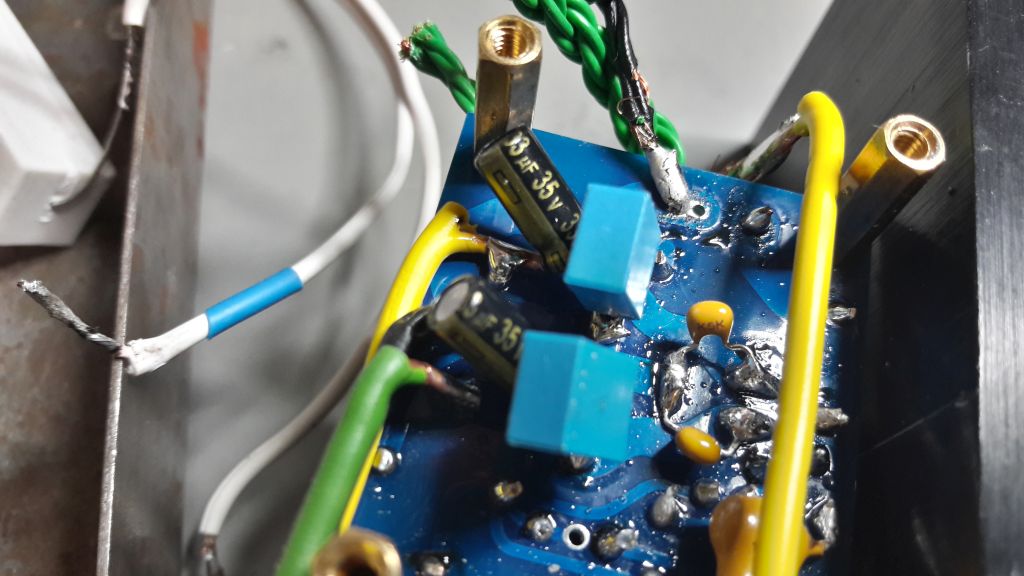

After looking at Chris' photos again, the decoupling might actually be a problem. I can see two electrolytics and one film cap on each rail and each module. Elvee always writes that putting capacitors with a ratio bigger than about 10:1 in parallel almost always leads to more problems than it solves. Most of the time it seems that you can simply get away with it, because literally everyone seems to do it. OTOH, why not just try something different? Sometimes less is more.
Try putting the film and small electrolytic on the underside of the board directly to the supply pins of the LM. Use a thick wire for the ground connection. Then try again with the big caps removed from the board, so there's only little capacitance left.
The very first important thing is the 0.1μF decoupling caps at GND to V+ and V - of LM1875 leads.
Caps with low ESR at HF.
Caps as close as possible....Soldered on the leads.

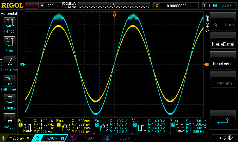

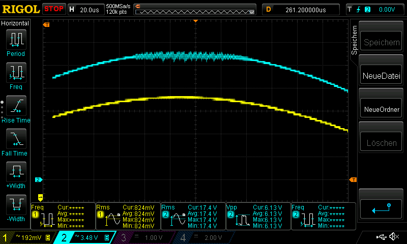

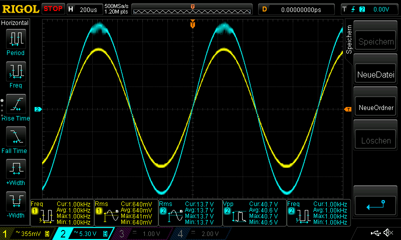

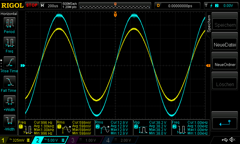

Hi
start of oscillating on the top positive sine
pic 9 620mVrms in 1khz at 4,459Rload - about 37,9Watt = 2,91Amps
any additionally test i should do?
chris
Sorry my ignorance if this was explained earlier, but do I assume right if I assume that the yellow scope trace is the input signal?
If so, isn't the oscillation already visible in there, and is not necessarily caused by the 1875 at all???

Hi palstanturhin
Yes it looks like the input signal is really not "clean".

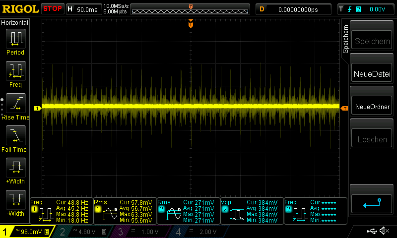

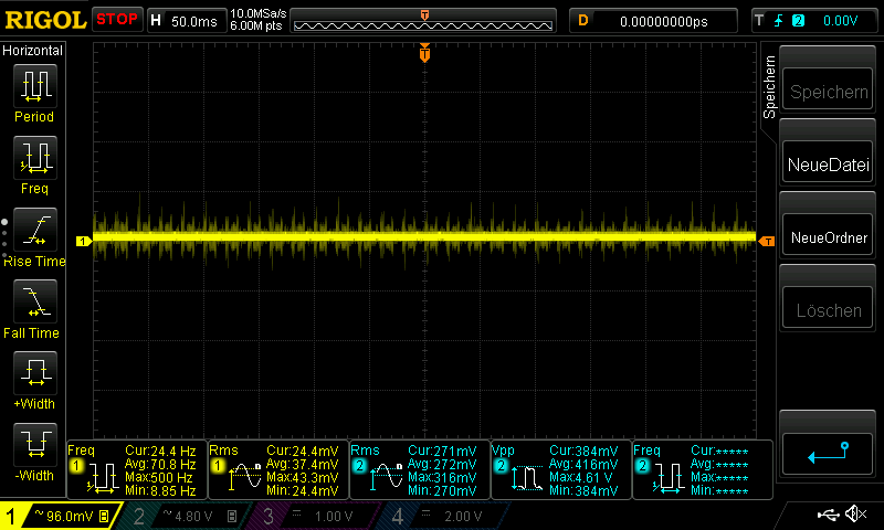

i found that my rigol supply do some high freq. spikes into my environment.
...and i totally forgot the us an additionally 10µF at the input (after the freq.generator)🙄
pic 1 -3 are the bad spikes from the psu without 10µF after the freq. generator
pic 4 is with the additionally 10µF...little better
chris

oscillating:
if i remember right from the test of the amp kits from the other thread...here..
https://www.diyaudio.com/forums/chip-amps/341675-ebay-mono-lm1875-kit-29.html#post5966025
post 284 ....

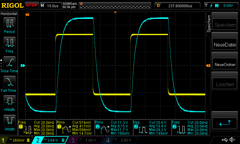

I want to stabilize at square wave input + reactive load C (220nF later with 440nF). I tested some kits with different components - now i use the better parts and get little bit "late" and not so heavy the oscillating. for me its really a behavior of the chip.
sine wave - still oscillating - no changed values (100pF at the Fb resistor)

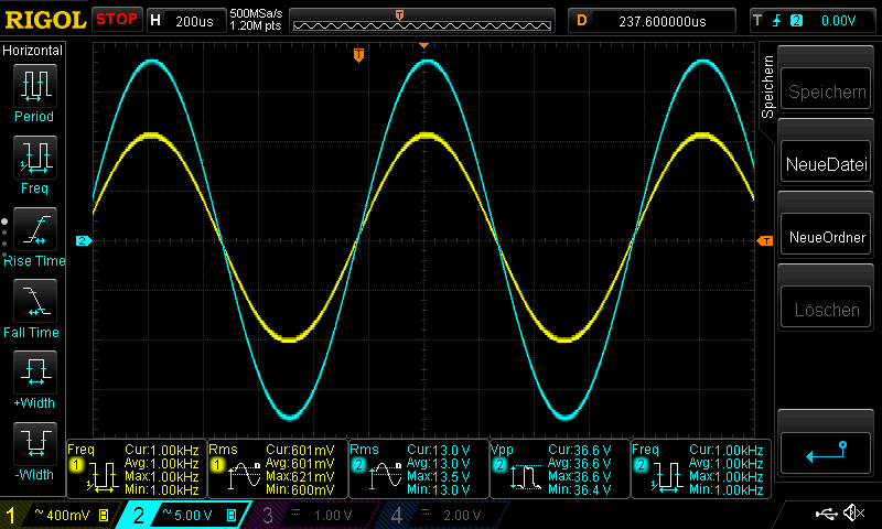

pic 1 2x1875_0R47_590mVrms in 1khz at 4,459Rload - everything i fine

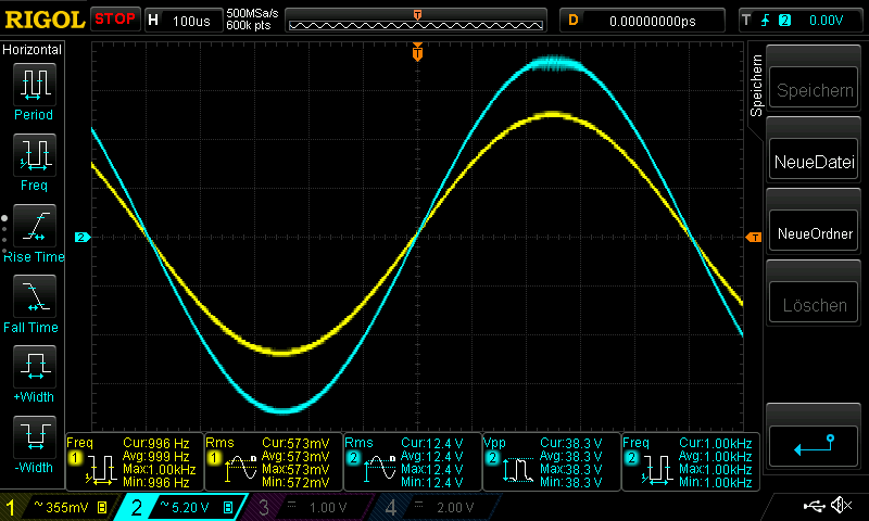

pic 2 + 3 2x1875_0R47_620mVrms in 1khz at 4,459Rload- oscillating

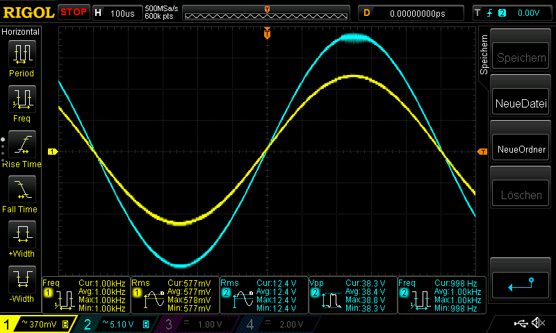

pic 4
2x1875_0R47_660mVrms in 1khz at 4,459Rload - heavy oscillating/clipping
look here: different components - same results = oscillating over 600mVrms at gain of 23 (27dB)
https://www.diyaudio.com/forums/chi...ration-composite-amplifier-9.html#post6013653
to stabilize under square wave FF helped me to use finally a 100pF at (parallel) the feedback resistor(22k).
https://www.diyaudio.com/forums/chip-amps/341675-ebay-mono-lm1875-kit-36.html#post5995120

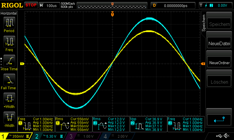

now my results: i decided to use the input level under the "critical" level of 600mVrms in = I used for both measurements 580mVrms input with 20kHZ
pic 5

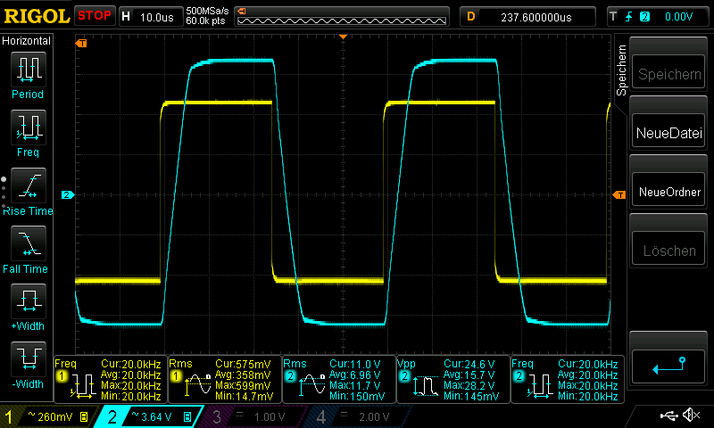

square 580mVrms input with 20kHz at 4,459Rload and 220nf
pic 6
square 580mVrms input with 20kHz at 4,459Rload and 440nf
chris
pic 4

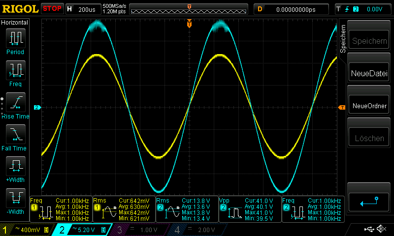

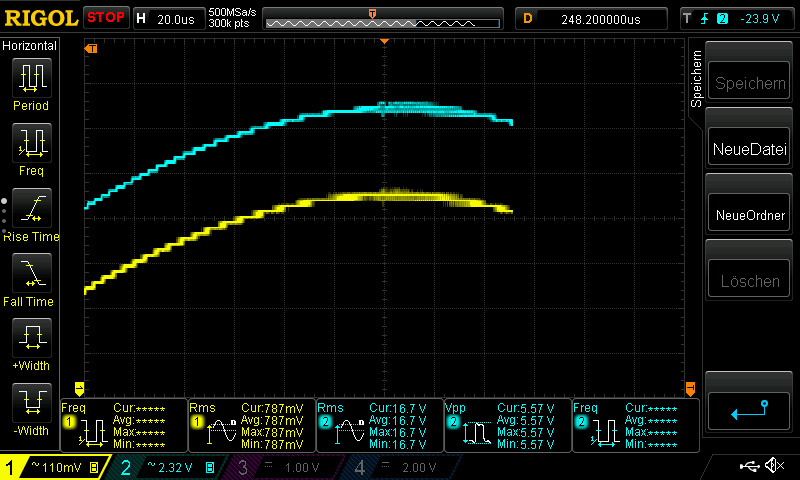

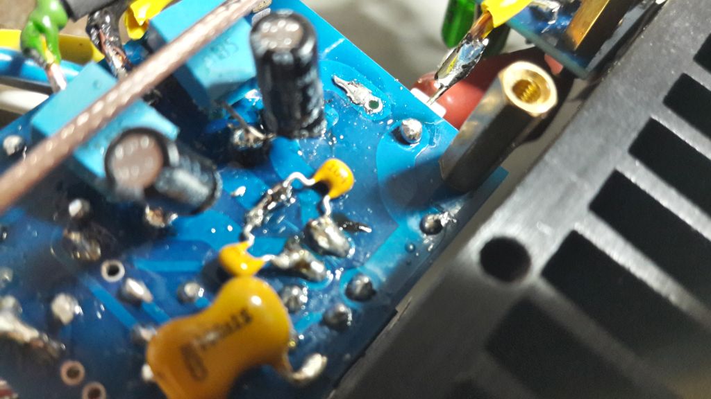

Hi

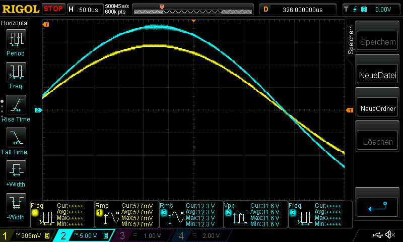

i pick up the idea to use a 0,1µF directly at the V+ - GND -V pins at the LM1875chip. i used the Kemet C322C104K5R5TA - its a X/R ceramic cap.
pic 1 + pic 2
measurements are with 590mVrms in, 600mVrms + 660mVrms - no different to the post 249
maybe it is "lost of time" with this PCB layout to solve this oscillation??
chris

Tough luck.Hi
Well, at least you know decoupling is not the cause of the trouble, it had to be tried.
My favorite caps for this are multy layer chips, giving very quiet rails.
Those X7R are usually multi layer chip ceramics.
Try removing the other caps that you added to the underside of the board.

once i built a lm1875 on perf-board (gain 27k+1.2k+22uF; psu decoupling caps only 2x47uF)........had a look at the oszi.......
just before the clipping zone it begins to oszillate similar to your pictures.....
i guess it is the "normal behaviour" of this chip amp........

OOOH thank you MJF...that what i am thinking too !😀

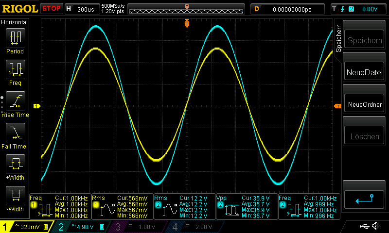

here are the rusults without my additionally caps under the pcb.
so its 470µF/35V ZLH series from rubicon on the top of the pcb and directly solder at the +V and -V at the chip 1875 -- 0,1µ X7R caps.
--> same result - input signal 1khz
pic 1 590Vrms not ok ---580mVrms input would be better - limiter LED
pic 2 620Vrms not ok
pic 3 660Vrms not ok
pic 4 600mVrms not ok
chris

If this oscillation only occurs at clipping and goes away immediately when going out of clipping, I think it is acceptable.
I presume clipping with or without this oscillation makes no audible difference.
I agree that very near to clipping and with clipping, the distortion is anyway high and a bit of oscillation on top does not spoil the whole thing. I have had more, even "fake" LM1875 clipping without oscillation and an electrical phenomenon for which I am not sure of the nature and how to control irritates me.If this oscillation only occurs at clipping and goes away immediately when going out of clipping, I think it is acceptable.
