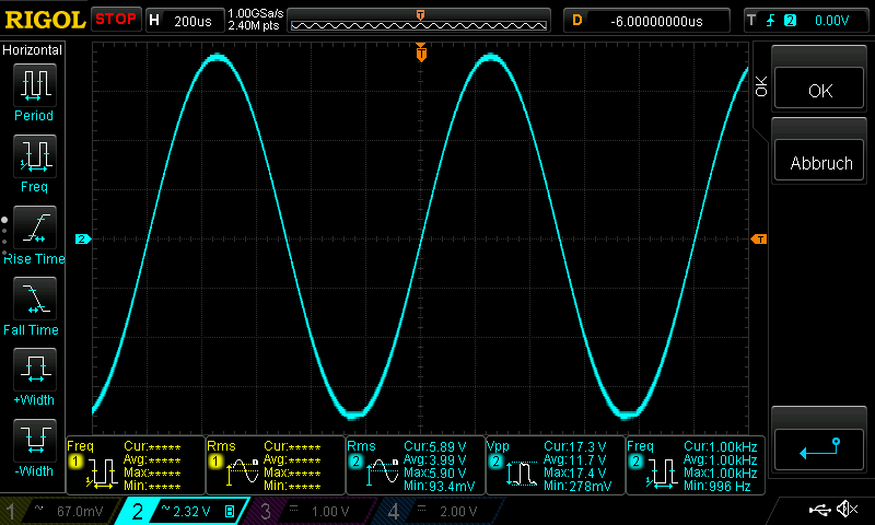

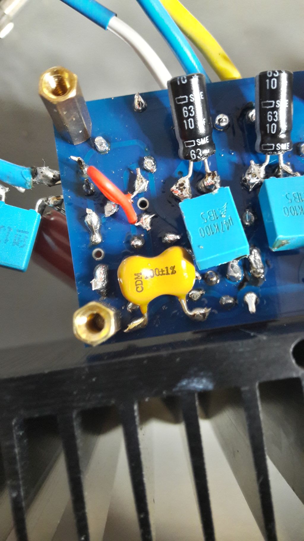

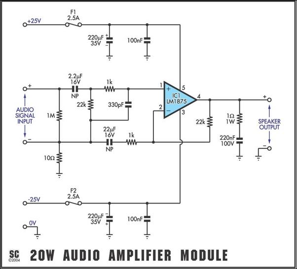

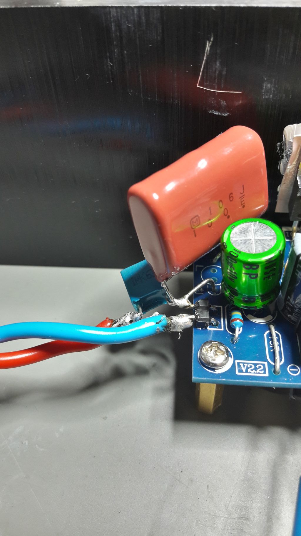

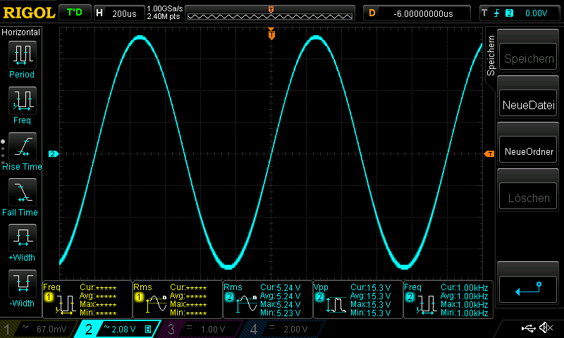

LM1875 with bad negative rail....
Hi FF
Sorry that i am too late to check this failure...
at post 196 you gave me the advice:
short the NFB cap = 100µF UES (green nichicon) = pic 1
no DC input at the signal input of the amp = i add a 1µF foil cap = pic 2
you remind me that a DC coupling at both = non-inverted and inverted input is a must - that s done by the 22kR at the schoolie´s amp - ebay kit = pic 3...right?
i did the test :
+/-25V supply from my lab PSU - Dc offset with shorted input was nearly 0mVdc, without shorted input i got 1,9mVDC offset. during shorted the input i see that if i touch just the positive input = = signal in the amp is oscillating "loud" - the a output goes up to 5Vrms !!! - ok ..so far...because its the same as i touch with the finger the signal i (+) i think that the trick if you want to see is alive.
i go up from 50mV input to 240mVrms input and there is the first time you can see the negative rail is going to clipping (cutting the lower sine wave) = pic 4
at 270mVrms in = about 5 Watt into 8R its clear visible the clipping. = pic 5
what i still not understand is what is the difference between my first test (post 170) and then the next day its not working correctly. i suggest a "overload" of the NFB cap with too much power at the ouptut?? - the NFB cap is a 100µF /10V...

Hi Chris,
My advise was concerned with testing this LM1875 you thought could be "dead".
You showed a sine-wave curve with asymmetrical clipping which means it is not dead in a normal sense.
While an LM1875 can die (fully) if treated wrong, it is very rare it is permanently harmed "a little". If you suddenly have a smaller mal-performance, it is very often due to the external circuit.
Then, you bring the LM1875 into a very simple configuration (with the NFB cap shorted it is a simple non-inverting amplifier coupling) and test it like that. Still asymmetrical clipping?
Hi FF
sorry to badger you...but this is what i exactly did:
thanks preamp...
i check the rails at the chip....

Hi FF
thanks preamp...
Sorry, I misunderstood.
As you say: check the supply voltage rails for asymmetry when loaded, check the output offset without input signal and take the output to real clear clipping at 1KHz.
NB: Could it be that you have offset your sophisticated oscilloscope screen with a voltage such that what we see is the scope saturating and not the amplifier? Try putting your probes in 1/10th and AC-coupling for a moment to see if it changes anything.
my probe at the ouput is done with a differential probe (20x)
