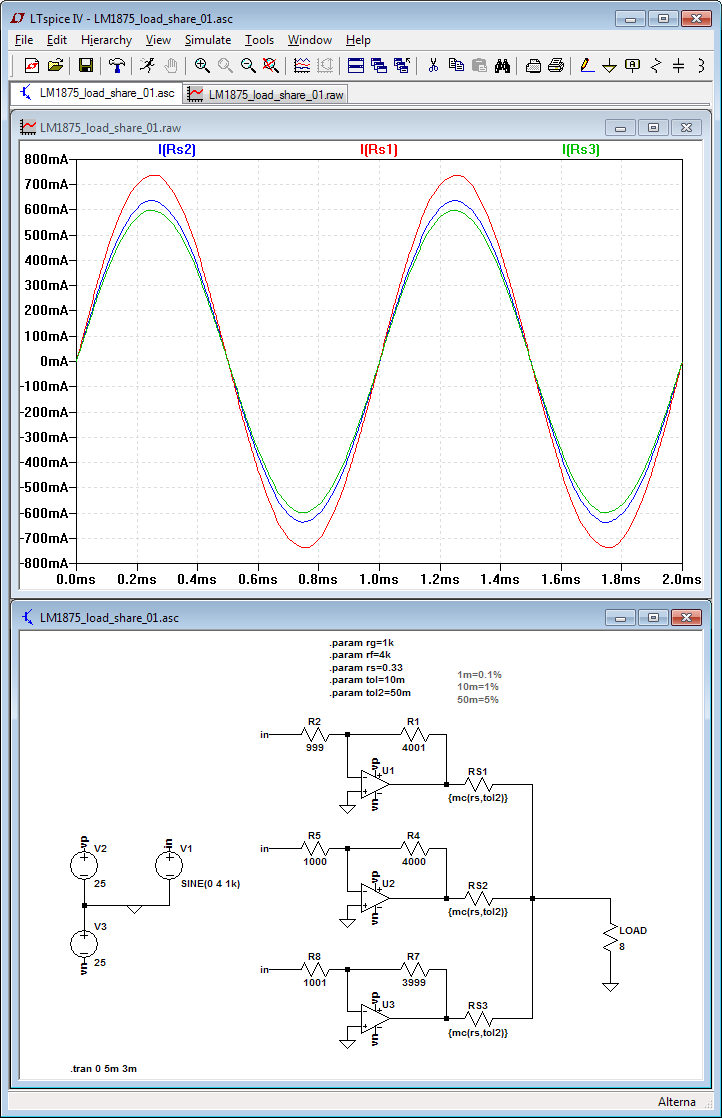

It makes sense to preselect (match) the gain setting resistors such that trimming of them becomes unnecessary. The low resistance (power) load sharing resistors should not be corrected as they are difficult to adjust and trimming would only influence load sharing moderately. Keep the load sharing resistors standard 5% as concluded by Preamp.
oh...yes thats logical...and i understand.
If you change the 100 Ohm into 8 Ohm, the relative difference in LM1875 currents become much less.
That's not the case, at least with my simulation. Reducing the load to 8R and reducing the input level to 500mV yields about the same result as before. With an input level of 3Vp into 8R, I get almost 1.5Ap load current, split to 0.234/0.333/0.911Ap respectively (without anything clipping). The split ratio remains the same, and one amp does most of the work. When that one runs into clipping, things start to become ugly.
Increasing the load sharing resistors helps in any case. Trade-off is their increased dissipation of course.
This is what things look like if you can select the resistors to within +-1R. Shown are the worst-case combinations of 999R/4001R (one low, one high) and 1001R/3999R (one high, one low) as compared to a perfect 1k/4k for 2Ap into 8R. Doesn't look too bad and should be realistic to achieve in practice. But again it's one more step that needs manual labor and that should not be skimped on.

Yes and no... Up to now I have omitted the input offset in my simulations. After including it now, the results look a little different.
With a rather stable DC voltage on the input of the number of LM1875 power stages arranged in parallel, leaving an output voltage in the order of 15Vdc, the LM1875 output with the highest voltage can be identified. (...) Could that be a useful procedure?
In theory this should work. The simulation result for my worst-case scenario with 0.1% resistors yields a maximum difference of 26mV for 20V output. Unfortunately you also get a difference of 20mV when one amp has a voltage input offset of 2mV and the other one has -2mV. With just measuring the output differentials you could not discern between what is due to input offset and what is gain mismatch. Which makes this a theoretical attempt only and seems to be of no practical value.
That would be another reason not to skimp on gain resistor matching in the first place, so that the gain mismatch is no problem anymore. Now, how would we tackle the offset problem then? On a second thought, the input offset is probably not a constant value that is specific to each device, but varies with temperature and whatnot. That would leave us with basically two options: 1) hand pick the LM's with the lowest offset, use them and live with whatever performance that brings. This would require another test rig and obviously a bunch of devices to pick from. Doable, but you can't just simply buy 3 parts only for one channel and be happy with it. 2) Use a DC servo for each amp. Which brings us back to the start, with a much more complicated design overall.

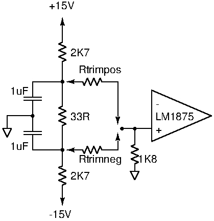

A solution involving trimming of input offset is technically not very complex. Please see the schematics appended. A slight positive voltage and a slight negative voltage are created such that these voltages can be used with voltage dividers to compensate the input offset using the non-inverting input of the LM1875.
The relevant one of Rtrimpos and Rtrimneg is chosen such that the input offset (up to 15mV) is compensated.
Chris has done valuable work showing that in many cases the input offset is so low that no trimming is needed. What we should provide is means to trim the offset voltage but ONLY IF needed.
With trimming of both input offset and gain, the procedure becomes:
1) Connect all inputs of LM1875 power stages to ground.
2) If an LM1875 output exceeds 2mV, choose either Rtrimpos or Rtrimneg such that the output voltage becomes less than 1mV. Install that resistor value.
3) Connect all inputs of LM1875 power stages to 4.5Vdc relative to signal ground.
4) Identify the LM1875 output with the highest voltage. Connect one voltmeter test-wire to that output. Connect the other voltmeter test-wire in turn to all other outputs with a positive voltage.
5) If the voltage of an output deviates from the voltage at the output having the highest voltage with more than 5mV, find a resistor which in parallel with the input resistor reduces the voltage difference to less than 5mV. Install that resistor in parallel with the input resistor.
6) Identify the output with the most negative voltage. Connect one voltmeter test-wire to that output. Connect the other voltmeter test wire in turn to all other outputs with a negative voltage.
7) If the voltage of an output deviates from the voltage at the output having the most negative voltage with more than 5mV, find a resistor which in parallel with the input resistor reduces the voltage difference to less than 5mV. Install that resistor in parallel with the input resistor.
What-about-such-a-solution?
