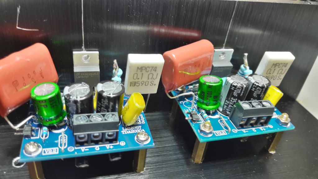

Hi FF
i wanted to go ahead with my normal mono kit (ebay kit) with the best parts to use 2 chips per side. see pic. i made the experience at this pcb that shorted the input signal or leave that input open but connected is a very similar. So i just power up one board and look without signal at the DC offset after the 0R1 resistor....e.g. -2mV. then i push an input signal into the amp and tried a sweep...then i saw the DC offset was going up/down.
as Preamp remind me i forgot to couple my frequency generator with a cap. so yes my freq. generator produce DC offset. my suggested 30mV was too much because with gain of 22/23 .
i had at the max point 62mV DC (650mV input 12khz)- i have to recheck my scope probe/measurement.
it looks like a higher gain (mono ebay kit) is more stable and not so critical as a composite amp with gain 2-4 LM1875.....but thats not our target here...😉

From your photos it looks like the amps are capacitor coupled already, so the DC offset can not be from your generator. Probably just the multimeter that can not cope such a huge superimposed AC while in DC mode?
Higher gain (like 30x compared to 3x) mostly helps with stability, yes, but usually has worse noise and distortion performance.

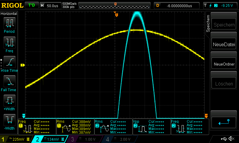

The scope-probe can remove the small DC but how are you going to remove the larger AC signal so you can see the small DC level?
i used a input signal with 400mV rms in = its a bout 9Vrms out into 8R...and I switched the voltage base in a finer region and use the horizontal trimmer to look at the upper point. (you have to scroll a lot..) then i switched between DC and AC.
pic 1 DC the blue line is on the top of the scope Voltage/div is 134mV
pic 2 AC the blue line is not on the top so its about a half of the 134mV = 65mV
is that a correct methode😀
chris

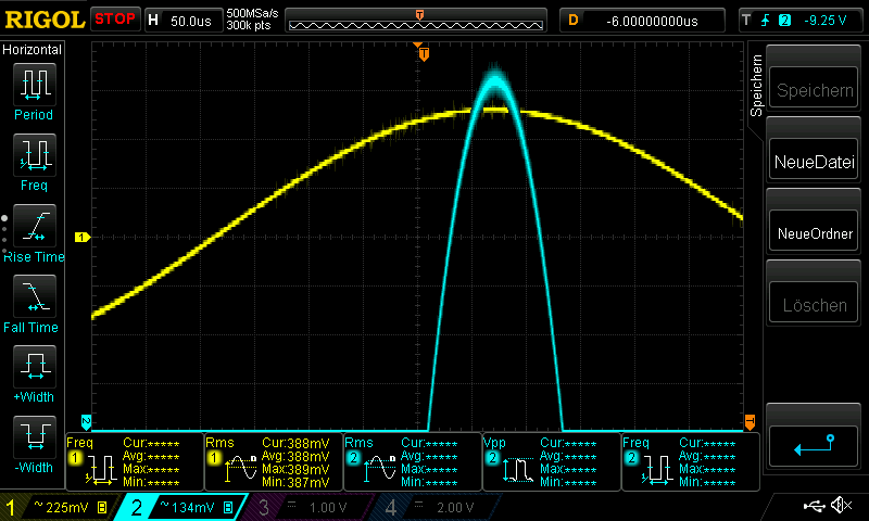

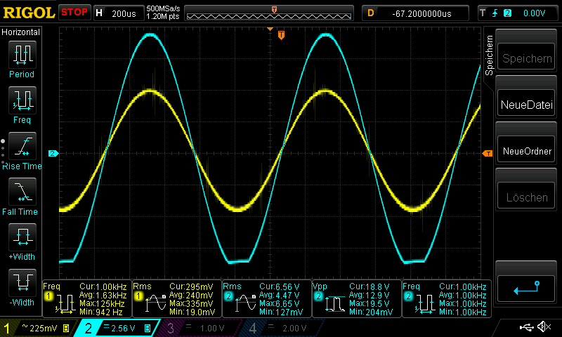

...amp dead ???
Hi
i found a maybe a dead chip. this chip i tested yesterday at post 170.
at the beginning everything looks fine but after 2 minutes the negative half is going to clipping. and keep this .....input is about 400mVrms so about 5Watt into 8R.
i changed nothing...chip dead?
chris

The chip is obviously not "dead" as you still have an output. The chip may have a degraded performance. The curve you show, is that this LM1875 alone without any connection to the second LM1875 board?
Is there a possibility that you have a DC offset in your input signal?
I guess you have a capacitor in the line from the LM1875 inverting input to signal ground? Such a capacitor may be the reason for a small offset voltage I believe.

The LM1875 you just mentioned that clips at negative voltage before positive voltage may also be the result of an asymmetrical operational point caused by this capacitor. To check that seemingly degraded LM1875, we have to take it out of a parallel circuit with the other LM1875 board, temporarily deactivate the capacitor by a short circuit and test the LM1875 with a sine-wave without DC-offset. Still asymmetrical clipping?
Hi FF
the amp is "alone" not in paralleling with the second amp. the cap is exactly like the ebay (schoolies amp) board schematic. (nichicon ues 100µF)
chris

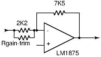

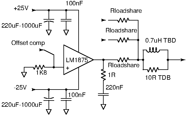

Miscellaneous.
In order to compensate for common-mode bias currents at the two input terminals (inverting and non-inverting) of amplifier chips, I have learned to use impedance balancing. Bias currents at the two inputs will, with resistance at the inputs, transform into offset voltage at the inputs. The trick with common-mode input currents is to have the same resistance seen from each of the two input pins such that the change in offset voltage is the same for both inputs and turn into a less problematic common-mode voltage.
With 2K2 as input resistor and 7K5 as feedback resistor, the inverting input sees a resulting resistance of 1K7. 1K8 is the closest standard value and will be used at the non-inverting input.
For the Zobel network used at the output of an LM1875, 1R and 220nF in series are recommended. During my test of a single LM1875 in low gain configuration, I experimented a little with the Zobel network as well. 1 Ohm for damping seemed the best but the 220nF could be reduced to 100nF without negative effects. I propose to keep the initial values of 1R and 220nF as they seem quite appropriate in practical test.
For power line decoupling, the LM1875 datasheet recommends a 100uF capacitor in parallel with a 100nF capacitor for each rail. The 100nF probably serves to prevent HF-oscillation in the LM1875 chip. The 100uF prevents LF-oscillation and provides general energy storage. 100uF does not allow for much energy to be stored and the total capacitance on each supply rail should be considerably higher to ensure good bass performance. In order to prevent the LM1875 from oscillation, a part of the total supply rail decoupling needs to be physically close to the supply terminals of each LM1875. This means that two electrolytic capacitors with moderate diameter have to be placed near the 100nF capacitors and as close to the LM1875 supply terminals as possible, for each LM1875. Such two capacitors, I would choose in the range 220uF-1000uF and with a voltage rating of 35V minimum.
Depending on the output power of the amplifier and the power source used, a total of 4700uF-20000uF is needed on each supply rail. Most can be located at a further distance from the LM1875 chips.
During my test of a single LM1875 in low gain configuration, I experimented a little with an eventual capacitor across the feedback resistor. With a square-wave signal as input and at the output, a small 100pF capacitor would make the square-wave at the output look more perfect without tendency of overshoot. I suggest adding such 100pF across the feedback resistor. At least I will try when a more permanent version of the parallel power stage has been build.
A Thiele compensation network serves to compensate for capacitance at the amplifier output, often caused by the speaker cables. For the component values I had to seek guidance in datasheets. In the LM1875 datasheet I found no hint to such a Thiele compensation. Anyway, it would have to be a Thiele network for two or three LM1875 in parallel, not just for a single LM1875. For the LM3886 chip I found some guidance advising 0.7uH in parallel with 10R/(5W). If these are optimum values for our use I cannot tell and any knowledge on the matter is highly appreciated. Do tests with capacitance at the output need to be carried out to determine the values? One Thiele compensation network will be used on the common output of all parallel LM1875 power stages.
