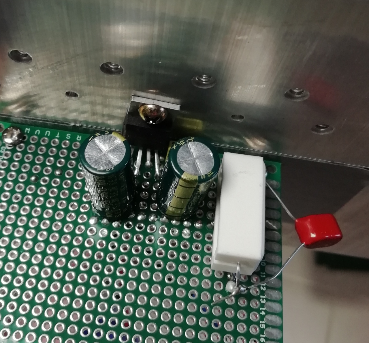

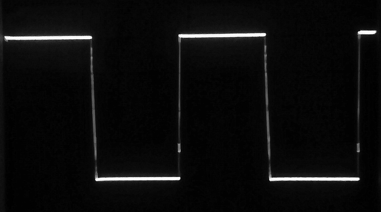

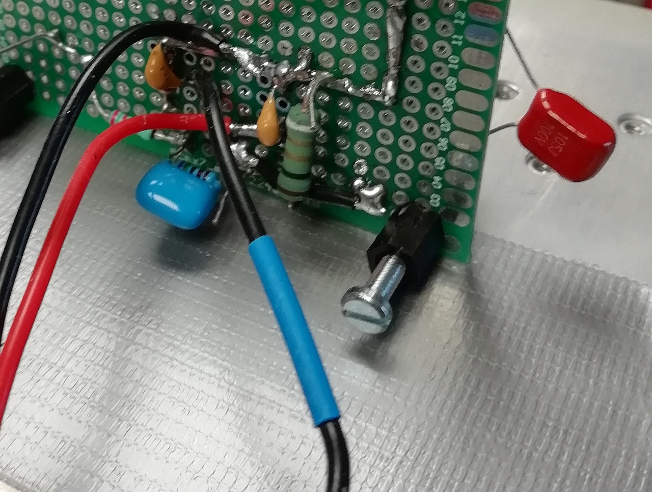

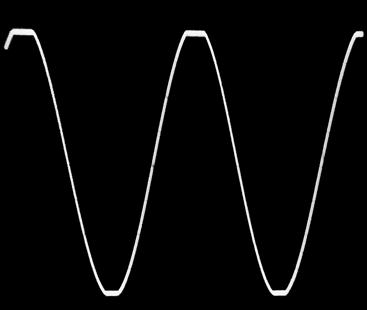

This is not good for my credibility:
1uF film capacitor across the 10 Ohm load resistor, 1KHz, 5V per division on the oscilloscope. 2 photos with the 2.2uH//10 Ohm Thiele network, 1 without the Thiele network.
Photo 1: 1uF in parallel, Thiele network included, 20Vpp.
Photo 2: 1uF in parallel, Thiele network included, clipping at +/- 19.5Vp.
Photo 3: 1uF in parallel, NO Thiele network, 20Vpp.
Photo 4: Test amp side 1.
Photo 5: Test amp side 2.
Photo 3 was taken with the oscilloscope probe directly on the 1uF capacitor terminals.
Not easy to scare that IC!

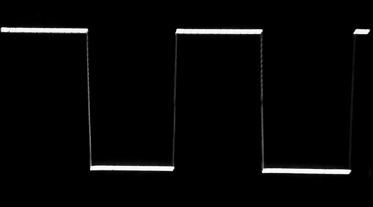

First test!
8Vpp sqr-wave 20kHz. Thats it sofar...
Compensation capacitor 10pF at 5534, no other compensation.
Voltage gain 31x. Of which 1875 was at 2,2x.
As can be seen, ringing but no oscillation. Sinewave is of course clean.
Will do more tests tomorrow. THD, measured with the scope, was 0.001%, which is the bottom limit of it. Need to measure it with something else... My soundcard can do 0.0005%...

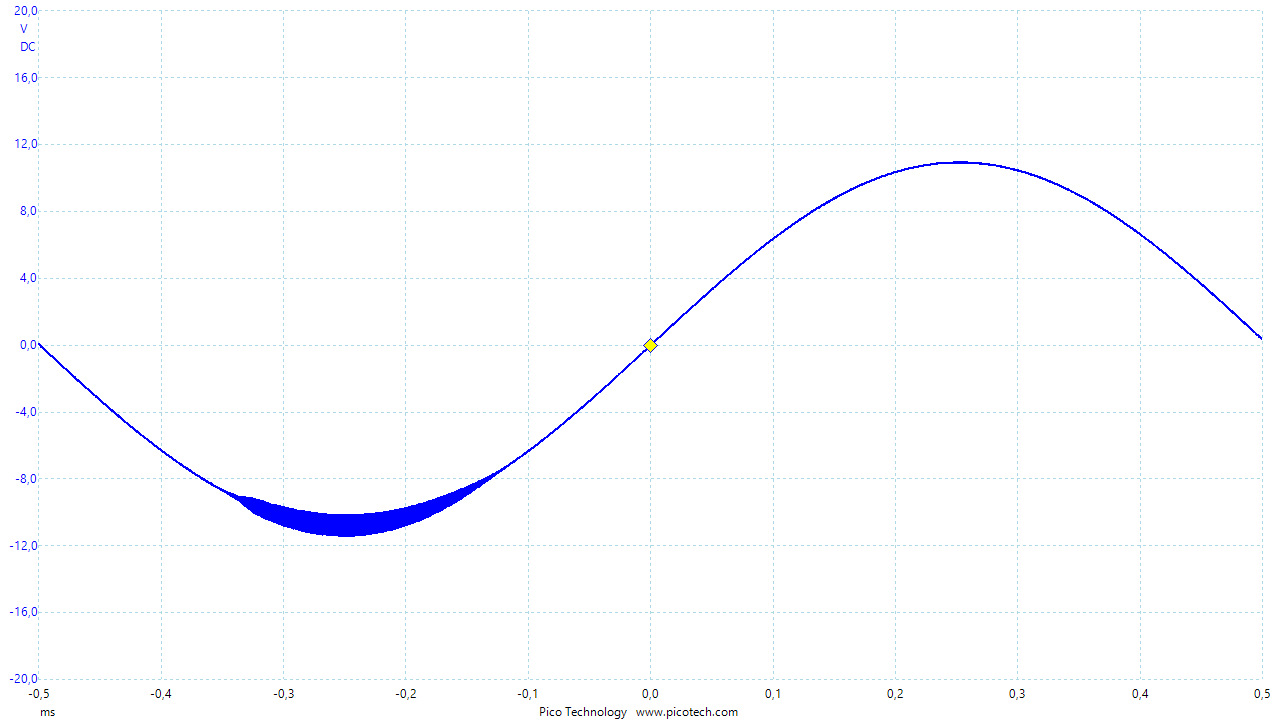

Hi
According to the oscillating issue i tried to use the same paralleling board with different supply voltage. sorry i do not make a scope pic - so you have to trust me😀
me thinking is that the oscillating is "just" before the clipping event therefore i try to find a "relation" between supply voltage and the point when the oscillating is starting.
Here are my results: (supply with Rigol DP832)
+/- 18V supply - input 1kHz 440mVrms - output 9,22Vrms/27,1Vpp
supply - Vpp = "loss" --> 36 - 27,1 = 8,9V (24,72%)
+/- 20V supply - input 1kHz 490mVrms - output 10,2Vrms/29,9Vpp
supply - Vpp = "loss" --> 40 - 29,9 = 10,1V (25,25%)
+/- 25V supply - input 1kHz 590mVrms - output 12,3Vrms/36,1Vpp
supply - Vpp = "loss" --> 50 - 36,1 = 13,9V (27,8%)
+/- 28V supply - input 1kHz 6300mVrms - output 13,2Vrms/39Vpp
supply - Vpp = "loss" --> 56 - 39 = 17V (30,35%)
What do you think??. I remember on rabbitz recommendation to use the LM1875 just with 1%AC --> 21VDC..22VDC

Your results are not much different from mine. My oscillation appears the moment I notice the top of the sine-wave starting being flat from clipping. Your oscillation seems to start a bit before mine. You use genuine LM1875, I probably fake. You have a gain of just above 22 in a non-inverting configuration, I have 3.5 in an inverting configuration.

I have rulled out some of the possible causes:
Not a power supply, or decoupling issue.
Not a signal generator issue.
Removing the dummy load (8R, resistive), solves the oscillation problem completely????
So it must be some kind of a current issue?
Then about the gain at the 1875:
Reduced the gain from 2.2x to 1.5x.
Majour improvement to the squarewave response! Some overshoot but almost no ringing!
Also shifted the oscillation issue from -11V peak to -14V.
I will try with an other 1875, to rule that out...

Reducing gain under 20x is an experiment, but no solution. You can not reduce it to some kind of current amplifier and let the separate OP-amp do the voltage. The OP-amp for gain is a part of the chip´s structure.

Just to clear, we are on negative gain here. The 1875 operates in its inverted mode.
No problems with the positive rail on my proto.
Have it up and runing with a new 1875 in just a minute...
