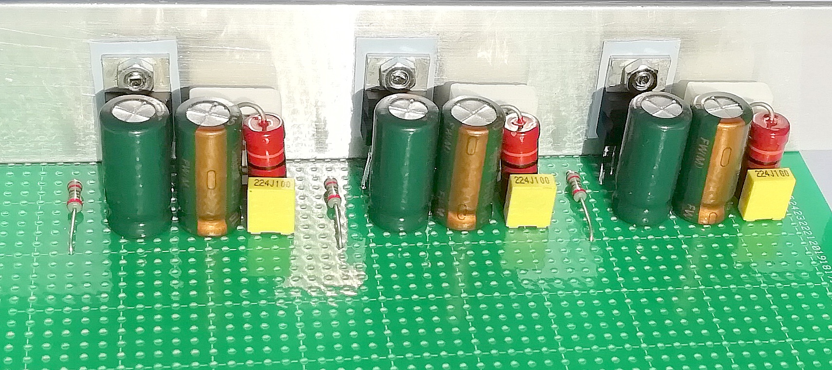

We are still alive! For the time being I am building a triple-parallel LM1875 power block. palstanturhin has already done experiments with the controlling OP-AMP in a composite amplifier configuration and rather quick experiments indicate fine results. Chris has done experiments with connecting LM1875 in parallel, which can cause unforeseen dynamic effects such as oscillation. We have all experimented with the stability of LM1875 and TDA2050, both genuine and fake.

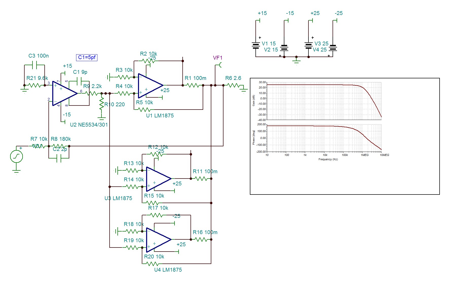

FF, I have posted in 2016 this circuit as enhanced My Ref . The sound of this amp is very particular. As you see the opamp can load several Holloway amps which can be paralleled . I can replace the LM3886 by 1875 if you want.

You could fool around a little bit more with this circuit. Change the gain of the 1875 to -3.5x, and see what you can get out of it?
Lets forget high gain at the 5534 stage also, if needed. We may be forced to use a preamplifier.
Minimum gain without oscillations at the negative channel seems to be -3x at the 1875.
FF's wild guess -3.5x was quite accurate.
I am not able to filter out all the ripple with less gain.
So, FF, when you build your parallel proto, use -3.5x gain.

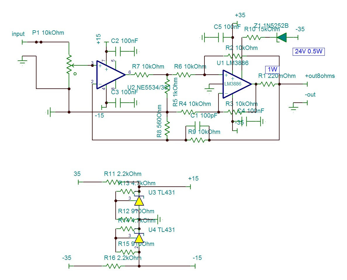

Kokoriantz,
I heard the two music pieces on YouTube and you are right, they sound very fine though I assume YouTube use compression.
This composite amplifier I suggest is left using LM3886. LM3886 has the advantage that one is sufficiently powerful alone (no need to put more in parallel). As I can see, the LM3886 is used in a coupling with both negative and positive feedback. That means the transfer function is (much) more complex to understand. It may be a very relevant option for later.
A first version of our composite amplifier should be straight forward such that it is easy to understand, easy to test and easy to modify. The experiments done by palstanturhin indicate that as a first version we can use a power part which is DC coupled and linear until the bandwidth limitation. That means, even persons without an oscilloscope can design and test the power part statically with a DDM. Then, the power part can be used with an outer controlling loop that for a start can be left DC-coupled as well and tested statically with a DMM. In the end, the input can be AC-coupled.
If the power part is configured so simple as a linear inverting or non-inverting amplifier, most can experiment with own designs around this concept.
The LM3886 is an obvious candidate for future versions.
The gain will be -3.5x. Though I understand if you start doubting how much work I in reality do, there is actually some progress (see below).
I use low impedance connections as mentioned by Turbowatch2 and Kokoriants. This way I should have no new oscillation effects. Adding the low impedance lines (power, ground and output) took me quite some time.
I hope finishing tomorrow evening.
Test should be from Monday-Tuesday. If the LM1875s just don't fight with one another, I can soon continue with the OP-AMP part.
Testing will be low-risk first.

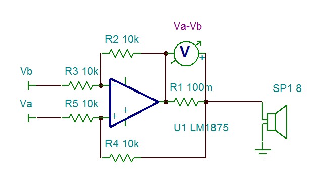

Holloway

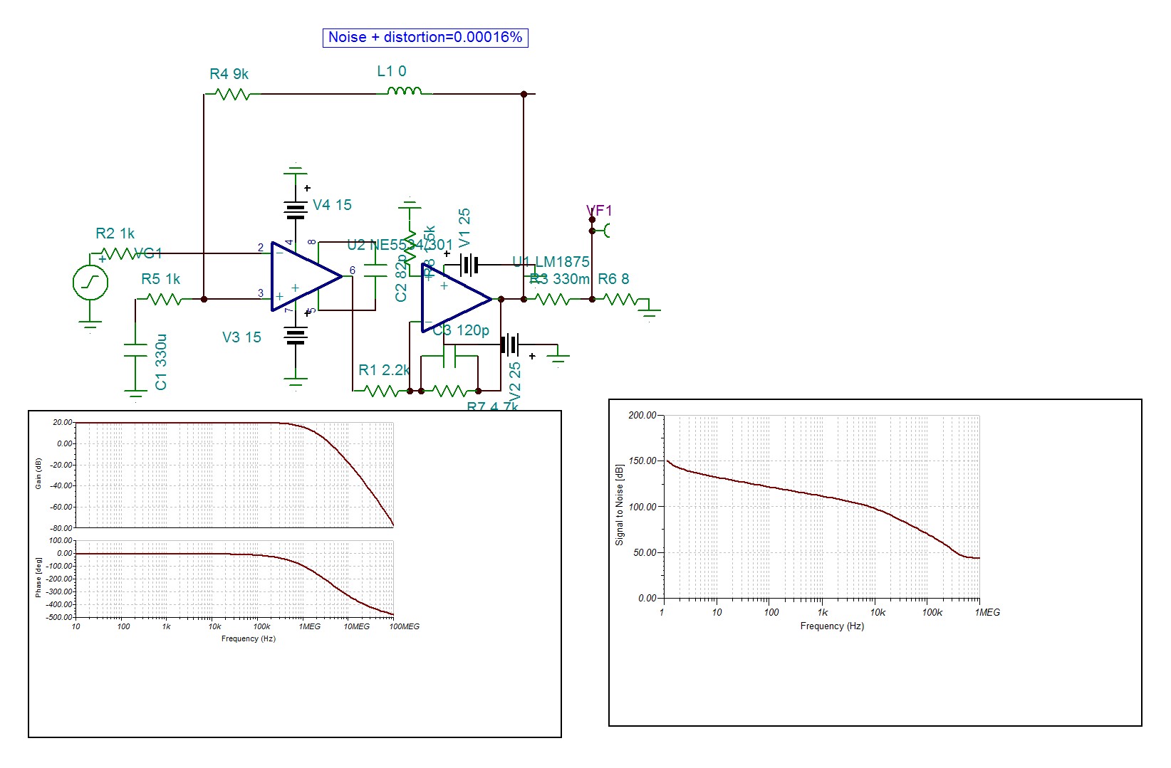

The Holloway circuit is very simple . The differential voltage of the inputs find it's way across the weighing resistor R1. By this the amplifier outputs a current equal to (Va-Vb)/R1. The load sees the output impedance as 20k.
Here what it gives with triple LM1875 .
The compression on the YouTube is not a matter of MP3, it is due to AGC of the recorder.
