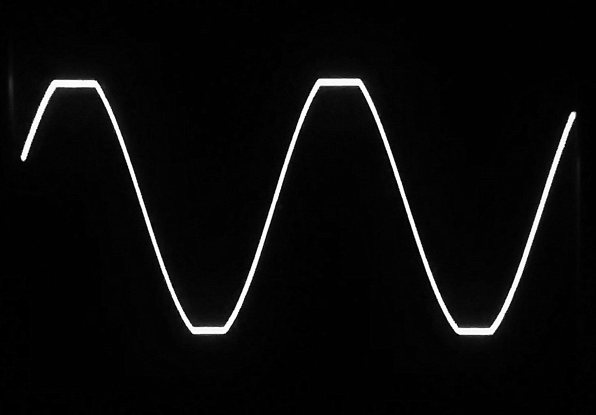

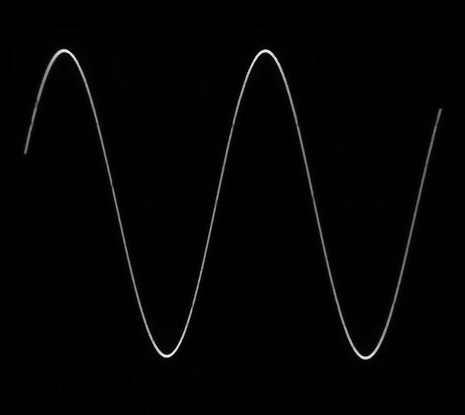

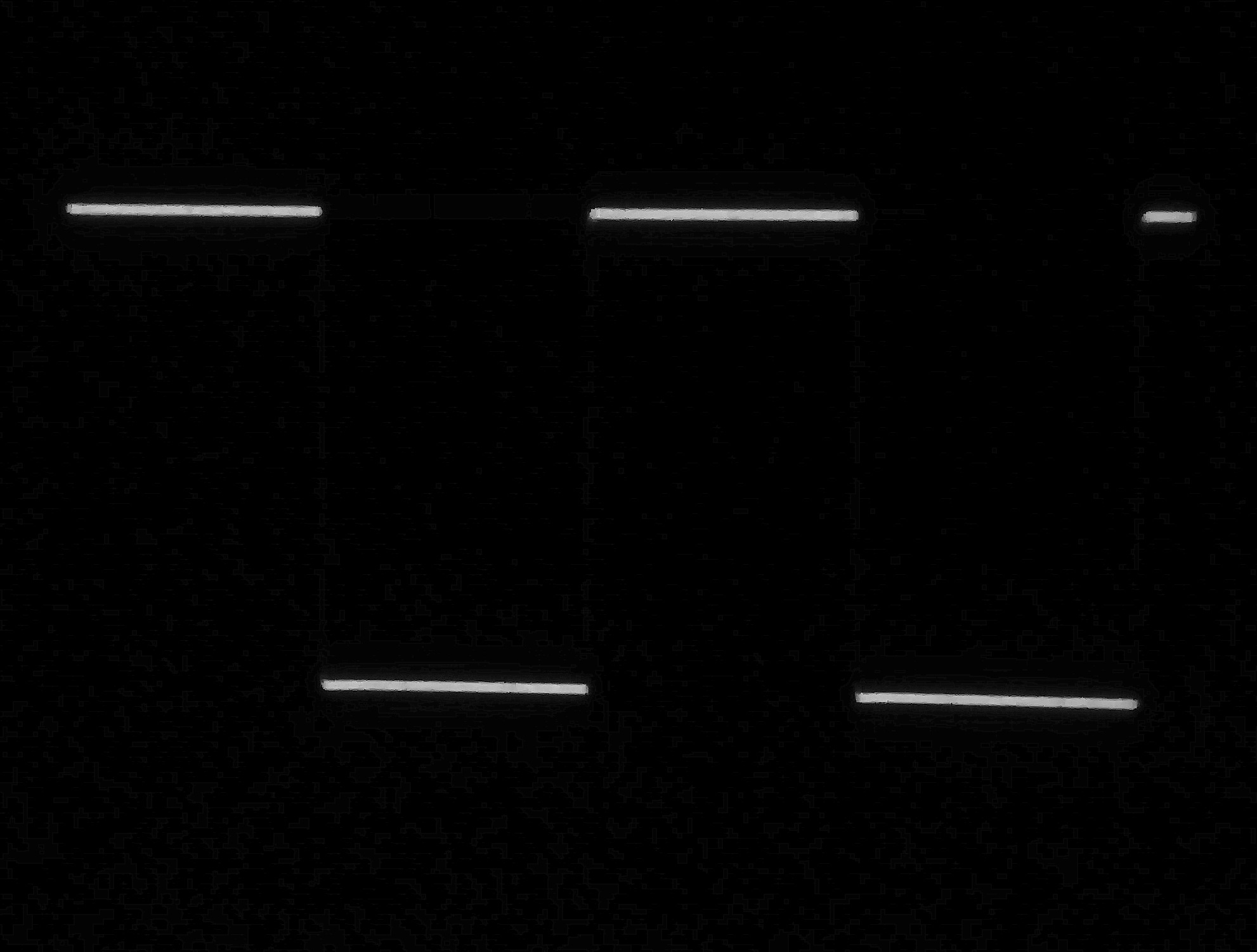

Hi

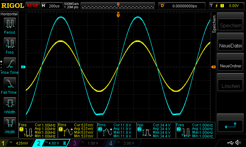

i build 3 days ago the amp but i got strange outputs. the reason is not evaluated by me and actually i have no idea.
what happened:
i installed successfully the psu and it worked.
from previous test both amps (2 boards in parallel) l+R are working good at 4,459R load.
i installed everything checked some point about shortcuts...etc...and switched on and want to measure the DC offset but i got out of range at the mV setup at my DMM !!!😱 + i see my cap bank led´s soft blinking/bumping. i switched every thing off.😕 the voltage during this at the rails are jumping from 22-26V up/down. i found no high temperature at the chips. i installed the scope to look at the output.

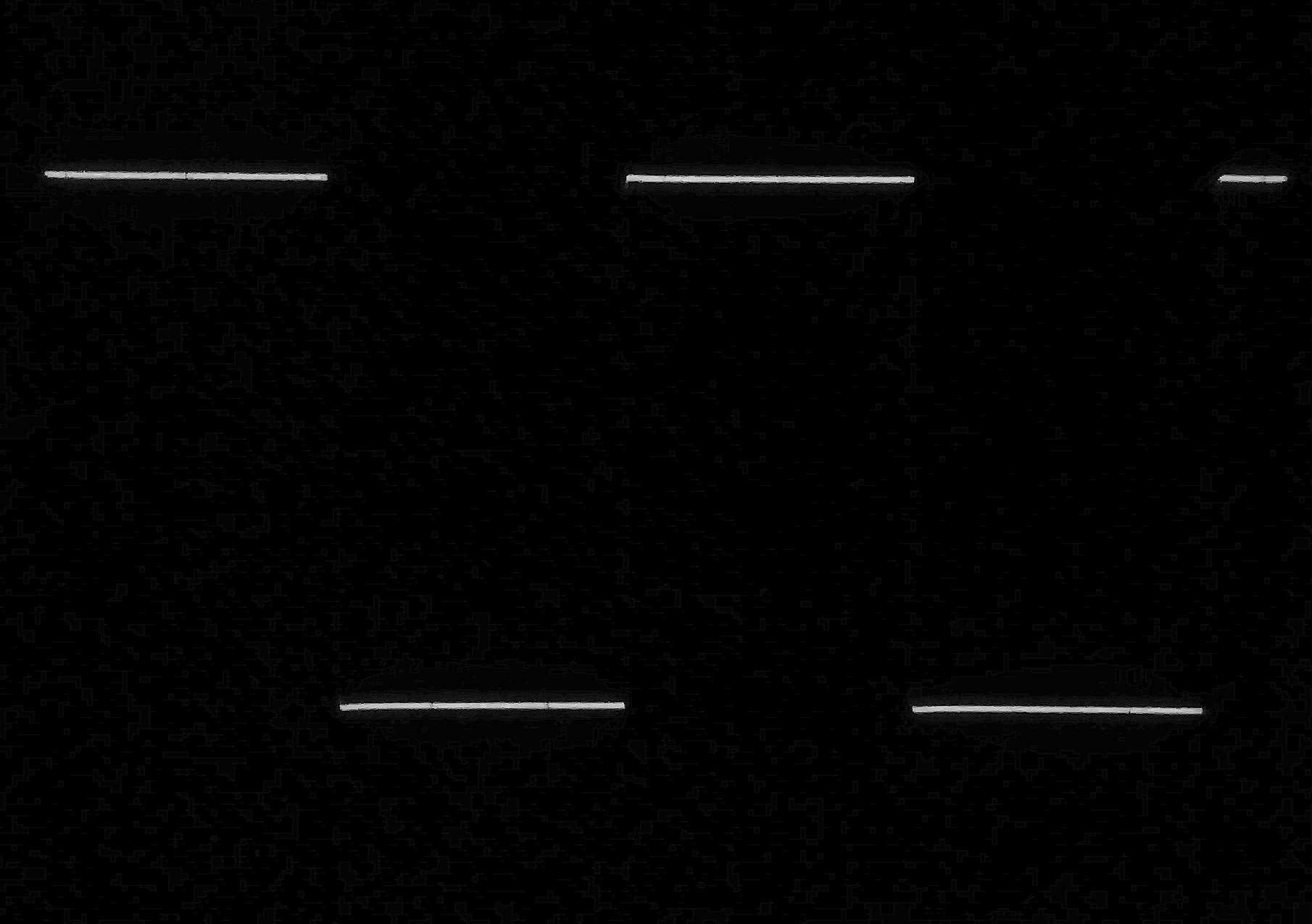

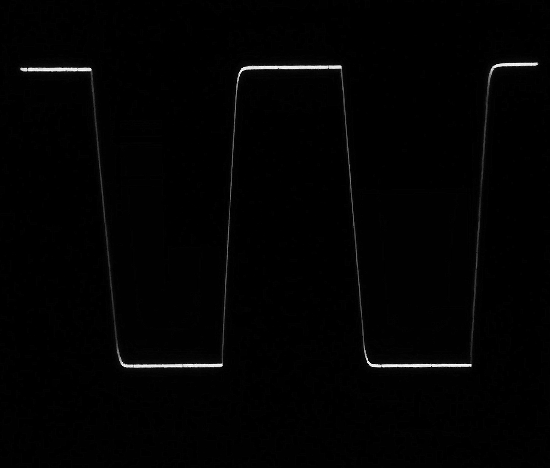

pic 1 Lchannel with 300mVrms input with 1khz - negative rail is cutted?
pic 2 Lchannel with 500mVrms input with 1khz - negative rail is cutted?

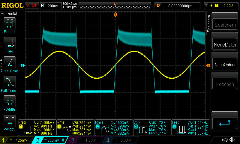

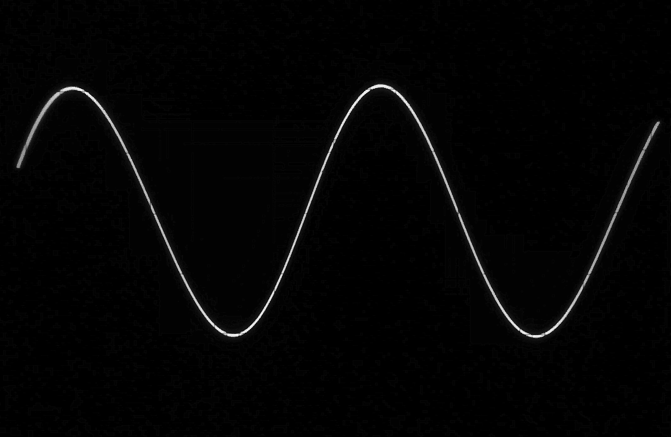

pic 3 Rchannel with 300mVrms input with 1khz - what´s that? -looks like curent protection
it was a very disappointing moment and I have no energy to look at the amp...

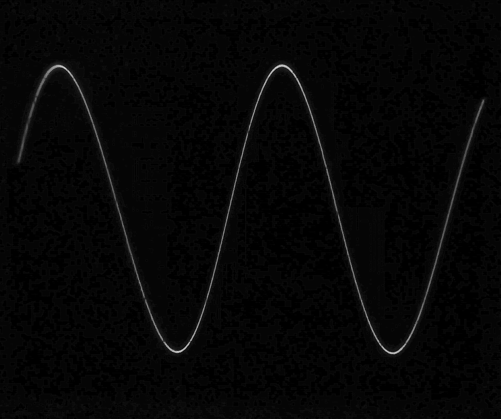

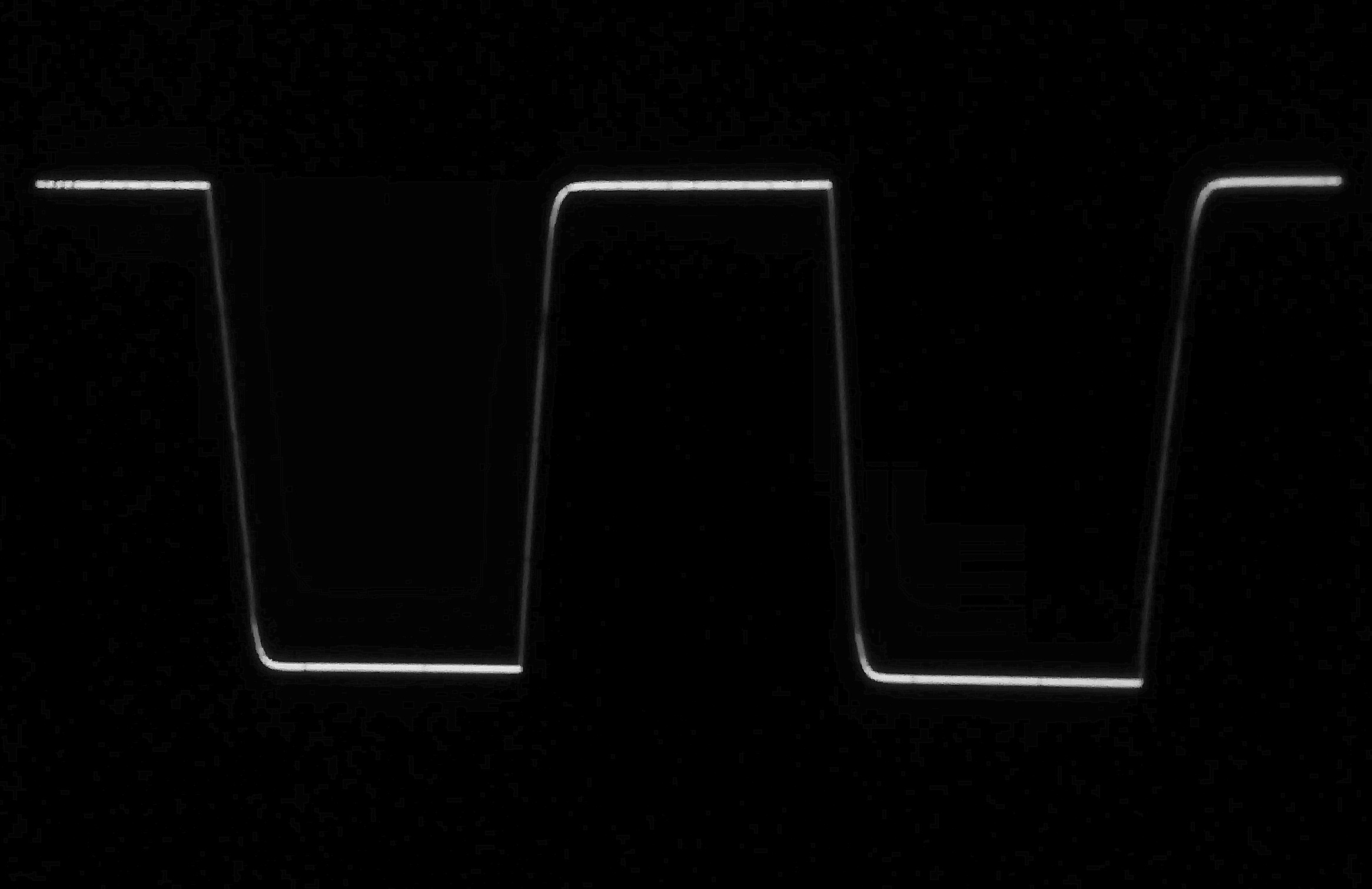

.....but today i looked and de-assembling everything and looked at R channel first. i disconnect the parallel cable to check ampR1 and ampR2 separate. ampR2 is dead. no input signal will be amplified

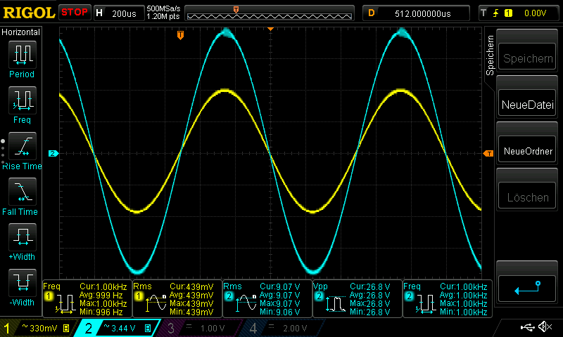

ampR1 looks good up to 440mV then it start to oscillating (too early because if you remember its starts about 570-590mVrms input)
pic 4 ampR1 1khz 440mV input at 4,459R - starts to oscillating
with lower frequency it gets worse!!!

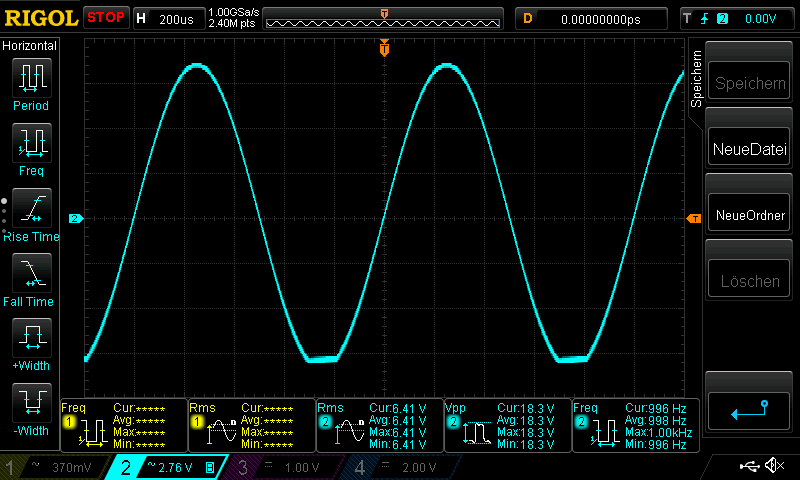

pic 5 ampR1 100hz 450mV input at 4,459R - starts to oscillating

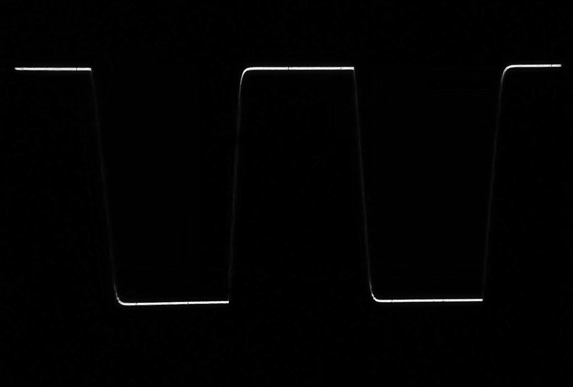

pic 6 ampR1 10hz 450mV input at 4,459R - starts to oscillating
so i guesstimate that this amp is "cracked" - ampR2 give no reaction.

Chris, sorry to hear about your trouble.
Making two amplifiers with a gain of 22 work in parallel when you have a frequency dependent transfer function (the capacitor connected to the inverting input) is much more difficult. If you want to do parallel LM1875 as well and have two LM1875 boards in spare, prepare two boards in linear DC-coupling with a gain of -3.5, if possible. It will be much easier to handle and prevent from breaking down.
Your PIC 3 looks like my first amplifier where one side would collapse in HF oscillation and the chip get very hot very fast.
Fred's experiments with UPC-TDA2050 have convinced me that this is a better chip for our use. The same sound, same pin-layout, much cheaper in purchase, better current margin, temperature + current-overload protection and "genuine" (predictable behavior).
Count how many genuine LM1875 ICs you have left. Make sure you have at least one set of "best performance" LM1875 mono boards to be used in the future as a reminder of all your LM1875 work. Leave one LM1875 IC as spare for the future. Then, count how many LM1875 you have left for parallel experiments.
As you may already have got the feeling of, years of DIY amplifier experiments will leave you with far more amplifiers than you can use daily. Therefore, imagine a way where you can replace one amplifier construction with another amplifier construction in the same chassis such that chassis and power supply is reused for more amplifier boards during time.
The chassis and power supply are the expensive parts and should be reused. Obsolete (at least for a while) amplifier boards can be hidden away in a box in the basement such that your wife no longer notice them. A number of unused amplifier chassis stored away will leave your wife with the impression that this is an expensive hobby ("why do you need another?"). Boards in a box will catch no attention.

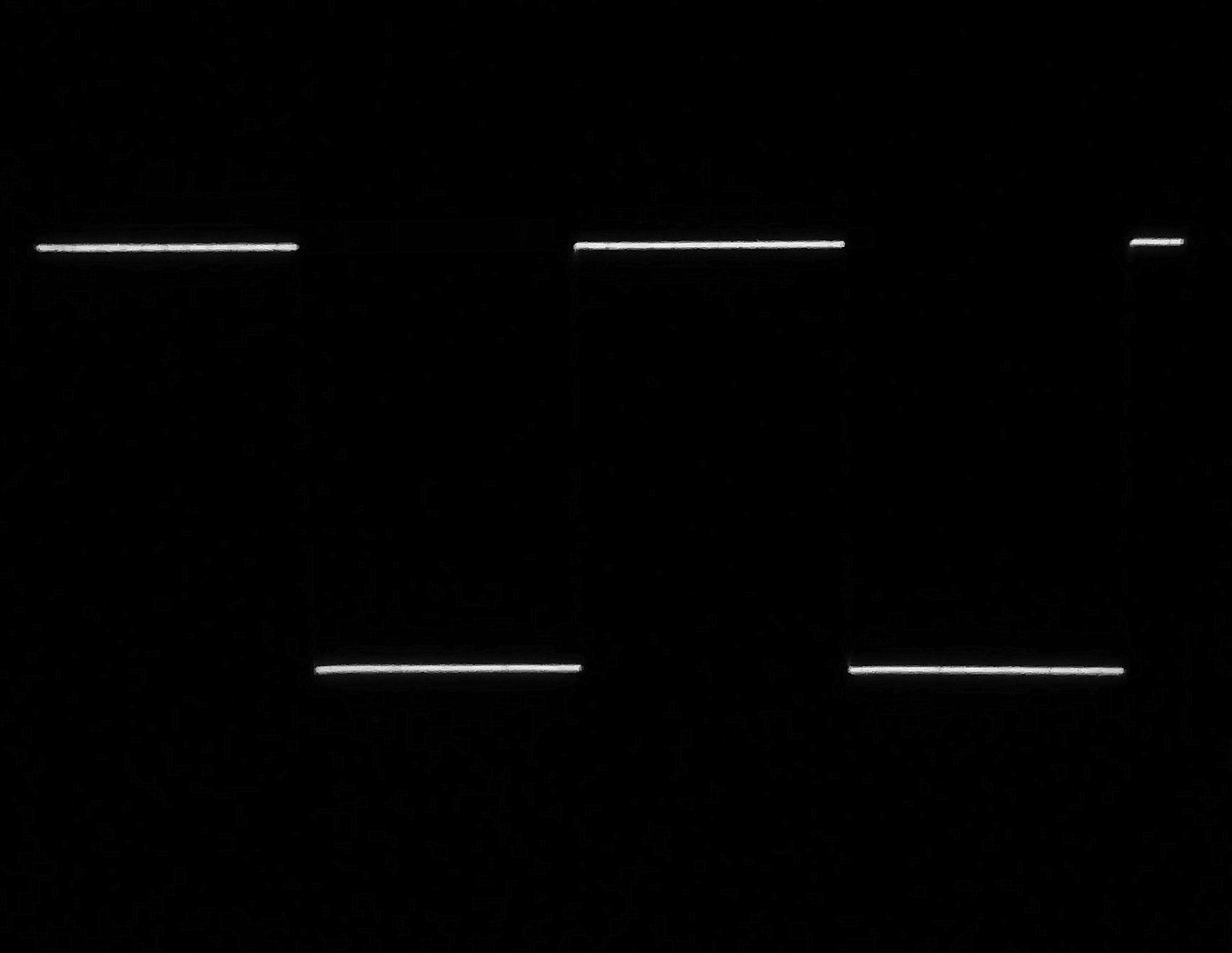

Tested my triple-LM1875 this morning for output off-set. Inputs shorted.
With my +/-18V supply, I had +2.7mV / -1.0mV / +5.4mV off-set at the three LM1875 outputs (before the load balancing resistors).
But, the output off-set is supply voltage and temperature dependent. So I had to use my +/-24V supply.
With the +/-24V supply, I had +5.2mV / -1.5mV / +5.2mV off-set at the three LM1875 outputs.
This is fully within the LM1875 specifications having LM1875 gains of 3.5 times. But, it is a bit more than I hoped and compensation should be done before real power tests. That requires I implement the +/-15V regulators on the board and do the adjustment.
Again I deviated from disciplined behavior and tried the triple with the now +/-24V supply and the 10 Ohm loading. The common output passed to clipping at 21.5V without any sign of oscillation. With the light 10 Ohm loading, I hardly noticed any fine oscillation at the flat clipped tops. The fine oscillation at the tops may come with increased loading.
I now also have to make a 4.0V reference for adjusting the gain of the three LM1875 to be fully equal (for best load sharing). I will make the reference with a TL431.
Please be patient with me for some days before I am ready to continue with the real power tests.

Self oscillation is vicious in the sense that it can be triggered at any moment (if potentially unstable) by start-up transients, signal spikes or temperature changes that previously did not cause problems.
In earlier LM1875 experiments, I noticed very fast heating of LM1875 ICs when such oscillation started. It seems likely that with such oscillation, you can no longer rely on proper protection from features implemented in the IC because the circuit itself is paralyzed by passage of high current from the supply without the usual circuit control.
Thus in short, you need not look for a mistake you made to explain the unfortunate outcome.

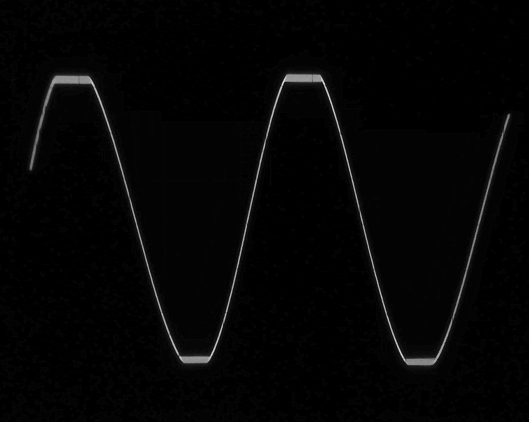

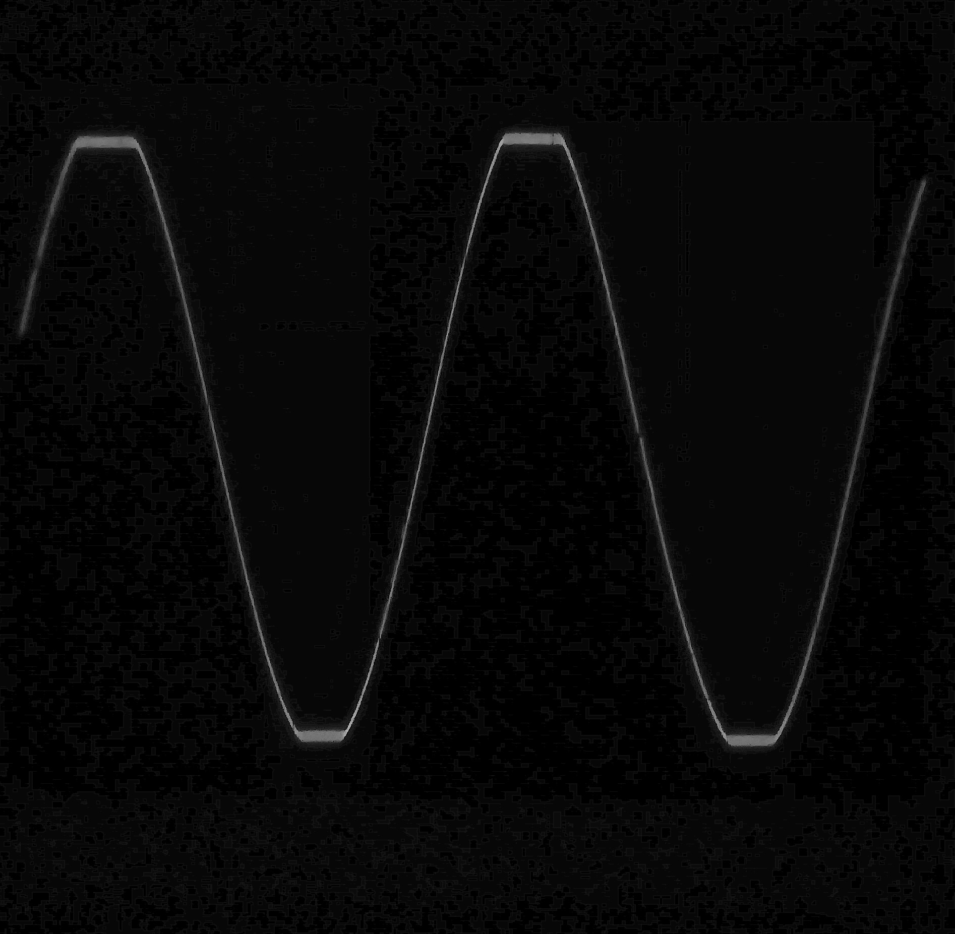

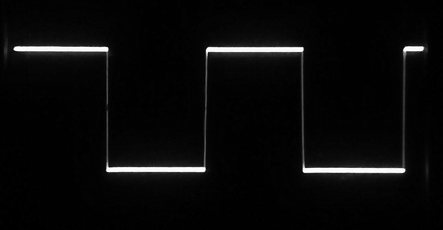

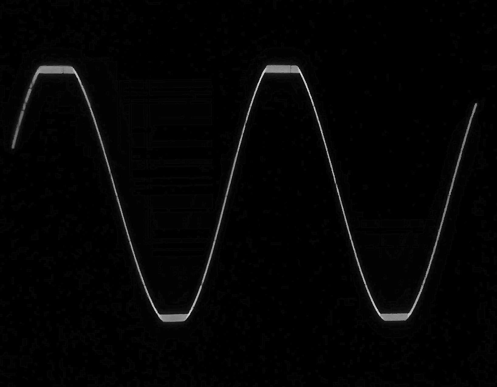

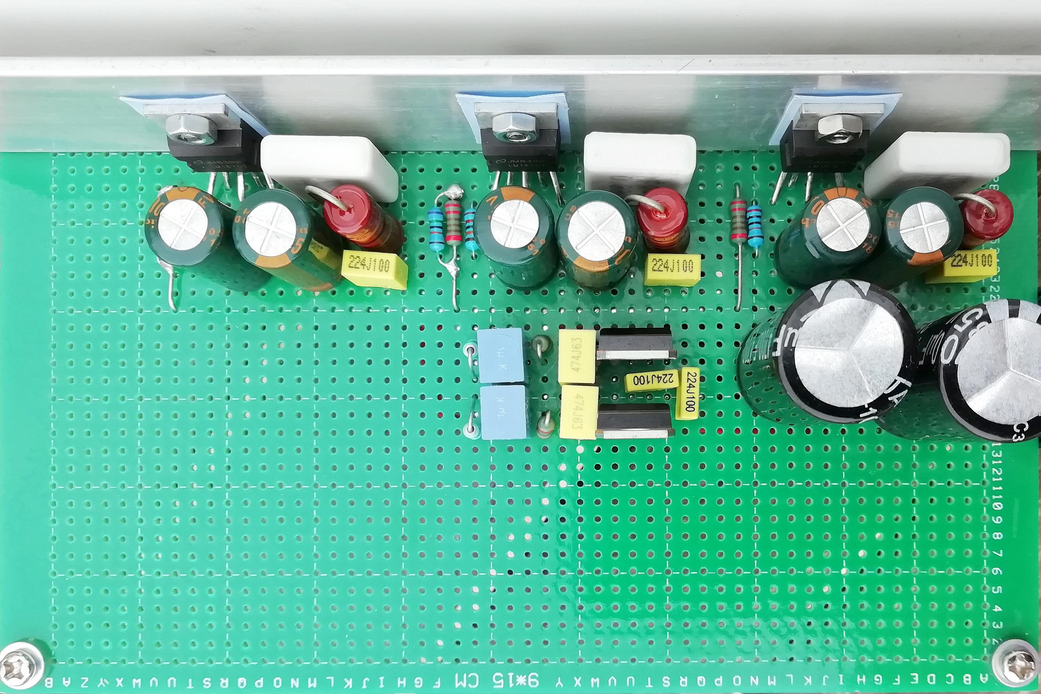

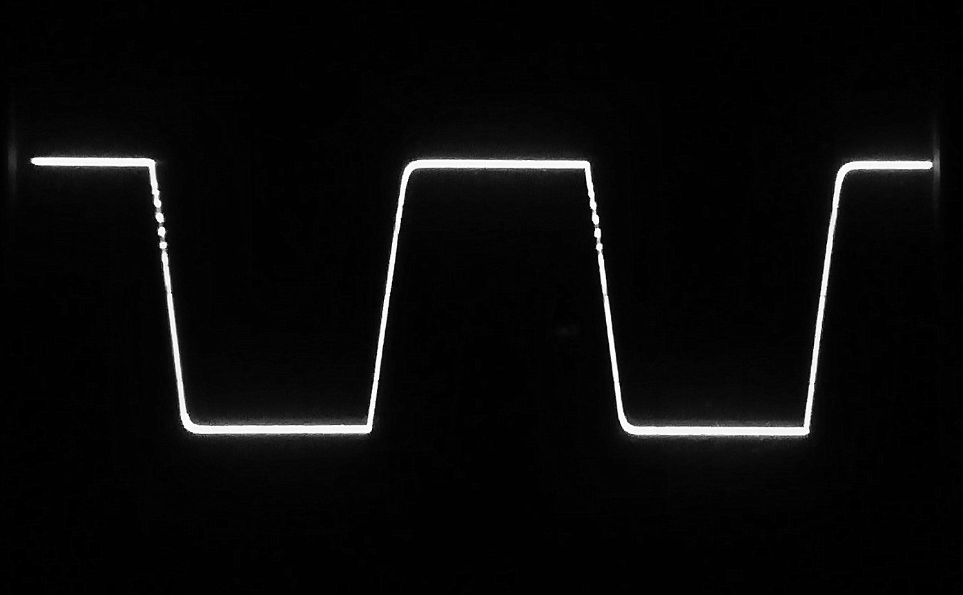

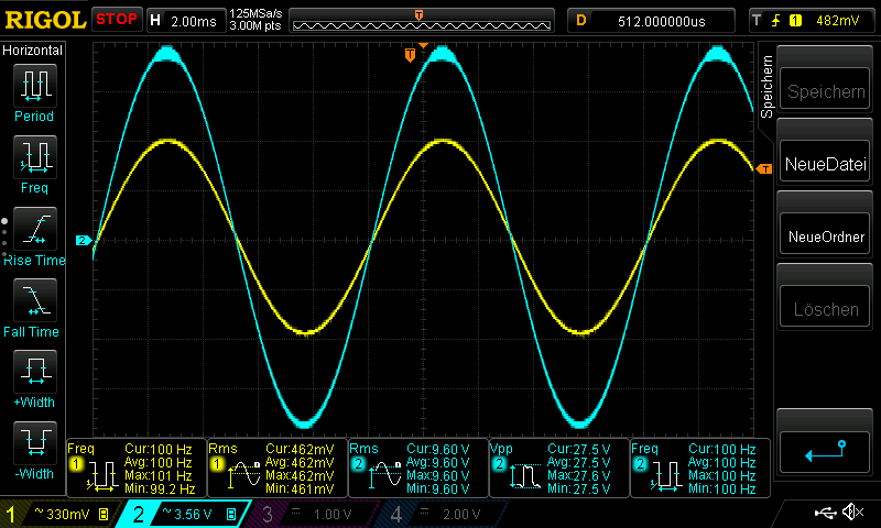

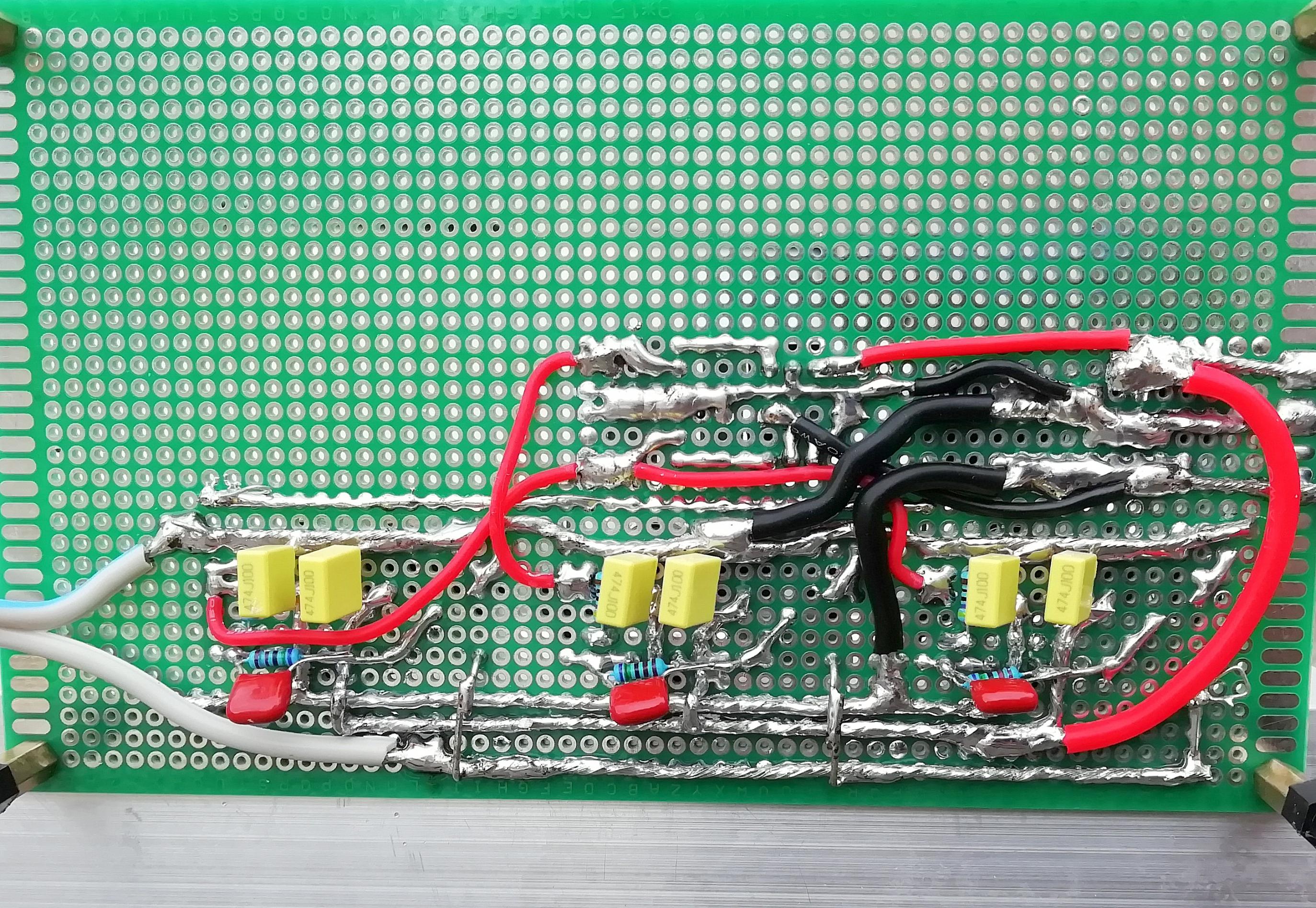

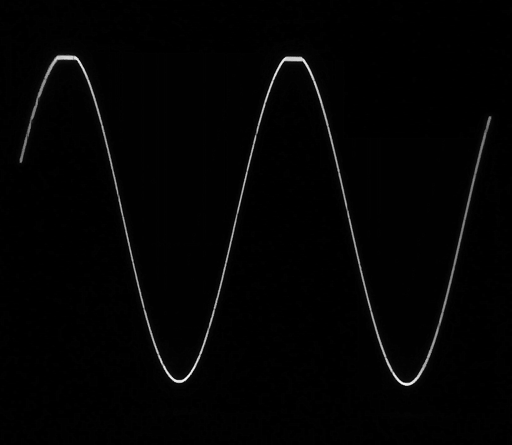

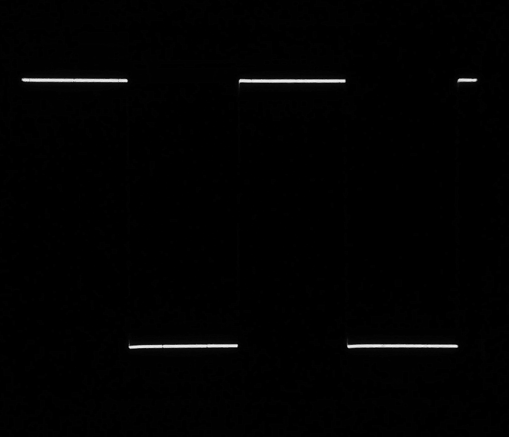

Today I managed to have my triple LM1875 amplifier adjusted. Both for output off-set and gain match.
The output off-set was compensated with fixed metal film resistors. After an hour of work, three compensation resistors were found and mounted. After adjustment, the off-set of each LM1875 was 0.7mV, 1.1mV and 1.1mV.
For the gain adjustment (static), I prepared a voltage reference with an output voltage of 3.93V. Using this voltage reference at the input of all the LM1875 simultaneously, I had individual output voltages of -13.42V, -13.38V and -13.39V. A voltmeter was connected between the output of the LM1875 with the highest output voltage and the output of the two other LM1875 in turn. By putting a high impedance resistor in parallel with the input resistor of the two LM1875 with less output voltage, it was possible to increase the gain a little and achieve the same output voltage as for the LM1875 with the highest output voltage. At the end, I read 13.43V at the output of all three LM1875 when the voltage reference was used as a negative input voltage. Check with a voltmeter between two outputs directly showed voltage differences of 3-4mV.
The amplifier was ready for a first test.
Pictures 1-4 are with an unregulated +/-24V power supply and no loading of the (common) output:
Picture 1: 1Khz, 40Vpp, no loading.
Picture 2: 1KHz, 46Vpp and saturation, no loading.
Picture 3: 1KHz, 30Vpp, no loading.
Picture 4: 10Khz, 30Vpp, no loading.

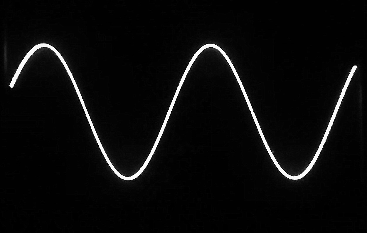

Pictures 5-8 are with an unregulated +/-24V power supply and 8 Ohm loading of the (common) output:
Picture 5: 1Khz, 36Vpp, 8 Ohm loading.
Picture 6: 10KHz, 30Vpp, 8 Ohm loading.
Picture 7: 1KHz, 30Vpp, 8 Ohm loading.
Picture 8: 1Khz, 41Vpp and saturation, 8 Ohm loading.
Still only very little oscillation at the clipped (saturated) tops.
Tomorrow, test with 4 Ohm load and 2.7 Ohm load (three 8 Ohm power resistors in parallel).

More Triple-LM1875 test results. 4 Ohm, 2.7 Ohm and 2 Ohm loading. Still using my +/- 24V unregulated power supply that sagged a lot in voltage for the 2.7Ohm and 2 Ohm tests.
Pictures 1-4:
Pict 1: 1KHz, 24Vpp, 4 Ohm load.
Pict 2: 1KHz, clipping at 35Vpp, 4 Ohm load.
Pict 3: 1KHz, 24Vpp, 4 Ohm load.
Pict 4: 10KHz, 24Vpp, 4 Ohm load.
Pictures 5-8:
Pict 5: 1KHz, 20Vpp, 2.7 Ohm load.
Pict 6: 1KHz, clipping at 32Vpp, 2.7 Ohm load.
Pict 7: 1KHz, 20Vpp, 2.7 Ohm load.
Pict 8: 10KHz, 20Vpp, 2.7 Ohm load.
(Rail voltages sagged to +/-19.7V at output clipping level)
Pictures 9-10:
Pict 9: 1KHz, clipping at 29Vpp, 2 Ohm load.
Pict 10: 1KHz, 24Vpp, 2 Ohm load.
(Rail voltages sagged to +/-18.5V at output clipping level)
Conclusion:
My unregulated power supply that starts at above +/-24V and ends at +/-18.5V is too weak for real power handling tests. I will use my more powerful regulated power supply later.
The triple LM1875 can handle down to 2 Ohm loads corresponding to a 4 Ohm load if used in BTL coupling. The output power capacity needs to be tested with a better power supply. Take into account that for my LM1875 chips the protection cannot be relied upon.
At no moment was the amplifier unstable. The "wool" at the clipped tops increased with loading but behaved very predictable.
Before taking the amplifier to the limits, I will implement the OP-AMP control (composite configuration) similar to the one palstanturhin uses and actually try to listen to the amplifier.
Square-wave tests indicate a surprising stability and tolerance to capacitive loading.
I may try the 10nF/100nF/1uF capacitive loading first.

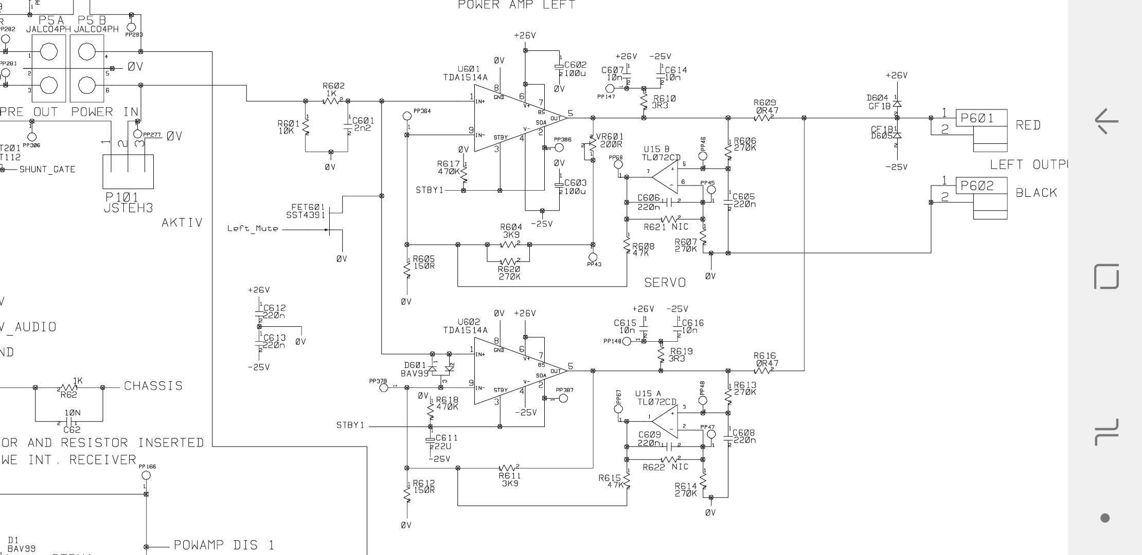

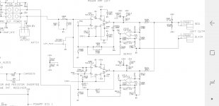

This is great progress!
Three comments:
1 Linn used a small trimmer (VR601) to balance the gain of the two parallel TDA1514A in the Majik. After 20 years it is still reliable, I think concerns about small trimmers being unreliable are unfounded, and it would be easier to adjust this way and zero out parts variations. It would satisfy my urge to dial things in to a null. I think their strategy of using a very low value trimmer in series with an "almost there" resistor looks correct, because it will give the most useful range.
2. If you have a variac, you could crank up the voltage a bit and get more representative two ohm tests
3. Am curious what are the -3dB limits? The 10kHz square wave shows a touch more slope than I thought it would, while still looking excellent.
See attached Linn circuit for reference
Three comments:
